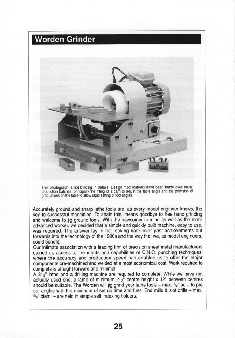

                        My understanding of the Worden design philosophy is that it was an attempt to harness modern manufacturing techniques to produce a tool that could be made quickly and easily which does rather run counter to the motivation you suggested.
                        I believe that under the present owner the trend has been to simplify the construction of parts of the Hemingway range.

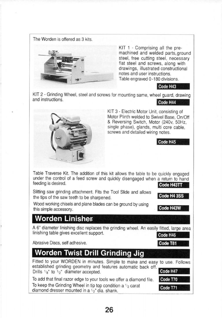

                                        Some interesting comments about the Worden. Here are further extracts from the 1995 catalogue:
                                        The table is said to be engraved; another "turn of phrase"?
                                        I think I once knew why the Worden was so called; can anyone remind me?

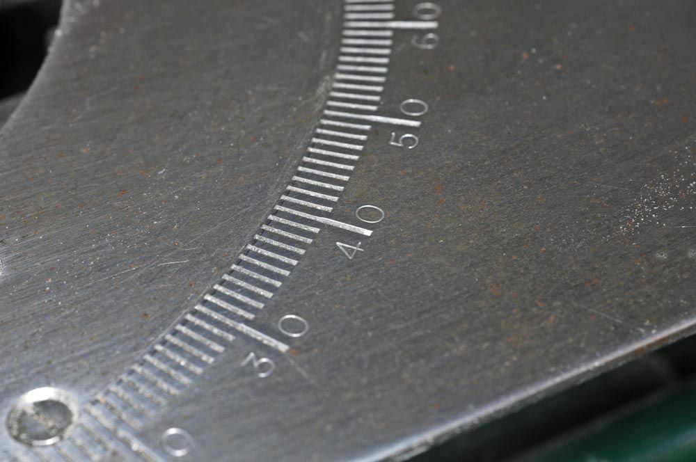

                                          Here's my Worden table:
                                          The tenths lines look like they have been punched by a chisel tool and the tens by a slightly bigger tool on a larger radius. The numbers were added by me using, if I remember correctly, a jig suggested by Tony.

                                            Roderick Jenkins:
                                            Thank you.
                                            Thinking about Leyland vehicles makes me wonder if there is something about the air in that part of the country!
                                            PS The number punching on your table has come out very well and, I assume, without loss of flatness. It helps to have the digits separated by the line.

                                              I bought a Worden kit second hand, so am unaware of the age. On mine, the table was engraved with degree marks and numbers.
                                              Maybe cost reduction deleted the numbers on later production? The Hemingway marque has had at least two more owners since the original design.
