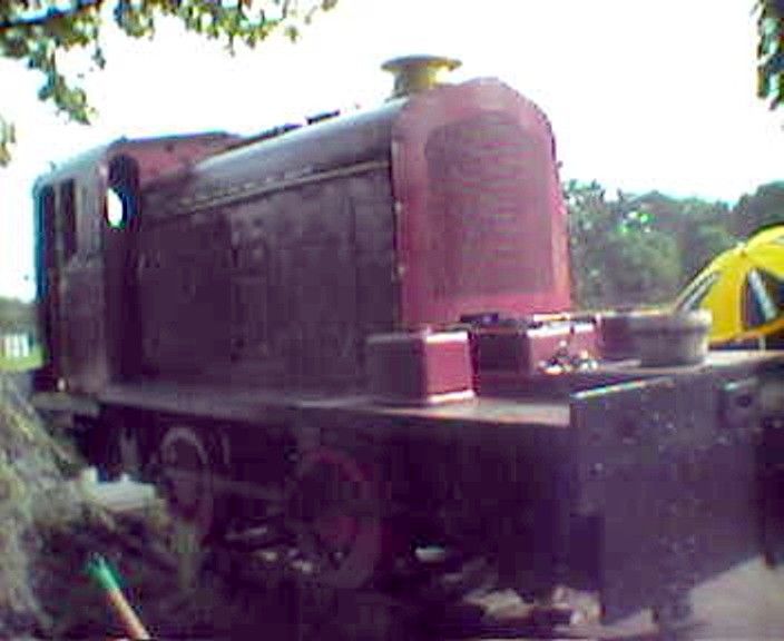

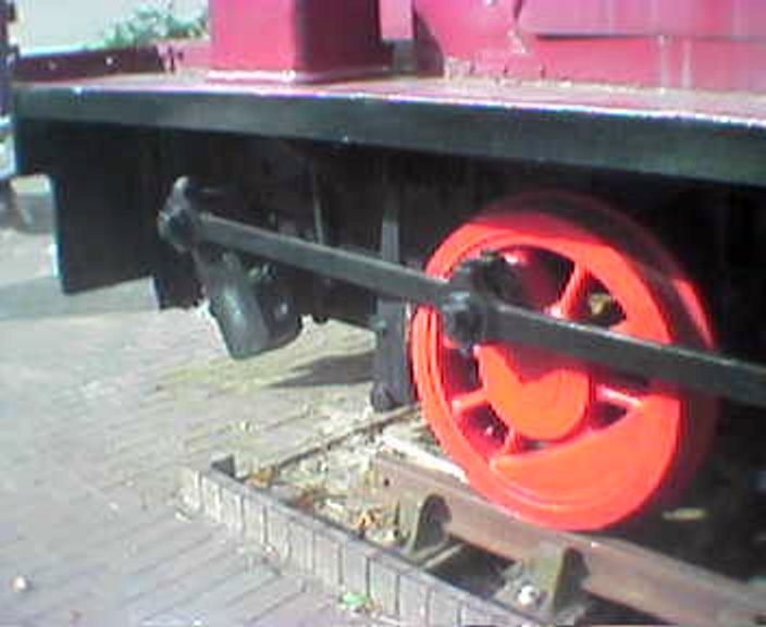

                  That’s really encouraging advice. I even have a set of bevels from a late, lamented angle grinder, together with two 7AH SLA batteries and a large motor from a narrowboat shower pump (it’s about 4.4″ x 3″ diameter, but I have now idea of the power, slow revving but appears powerful).
                  It is quite small, I estimate just under 12″ long, so I will have to keep the batteries in a driving car and I doubt it will reach 18kg, even with some added ballast. Here’s a couple of pictures, from one of those keyring digital cameras from the days before our phones wer better than our slrs:
                  Yes, it DOES have a brass chimney! It’s outside a pub near Ufton in Warwickshire. IIRC they have something like a gauge 1 railway going around the opicture rail too. I think it may be called ‘The Railway’ the other pub nearby has an Iguanadon on its sign, the Jurrasic or something like that. It’s years since I lived/worked near there.

                    Blessed be the Googlers for they shall discover much data!
                    It’s a Hudswell Clarke shunter of 1936, number D604. They built the first diesel hydraulic engine in just 1932, and it was steam outline for a minature railway in the northeast!
                    Sadly(?) it appears that a private collector from Ely bought it several years ago and its location is now unknown. I found a couple of much better pictures on a shunter website (though they have many copyright warnings ) I also found a couple of other similar engines which help a bit too. There is an engine called ‘mighty atom’ from Harwell nuclear power station that is almost a twin of this engine, but has added bits.
                    I now have plenty of detail of things like the missing buffers and couplers. The one thing no photo shows is the springing arrangement or any detail of the hornblocks. It’s clear they must have poked down below the bottom line of the frame, but I will have to guess the rest. I’m using a set of Tich hornblocks, as they are for 2″ diameter wheels and I think that I will probably use a spring set in the top of each axlebox acting against the inner top of the hornblock.
                    Can anyone advise how much travel I should aim for? Is about 1/8″ under load enough, or sd I go for 1/4″?
