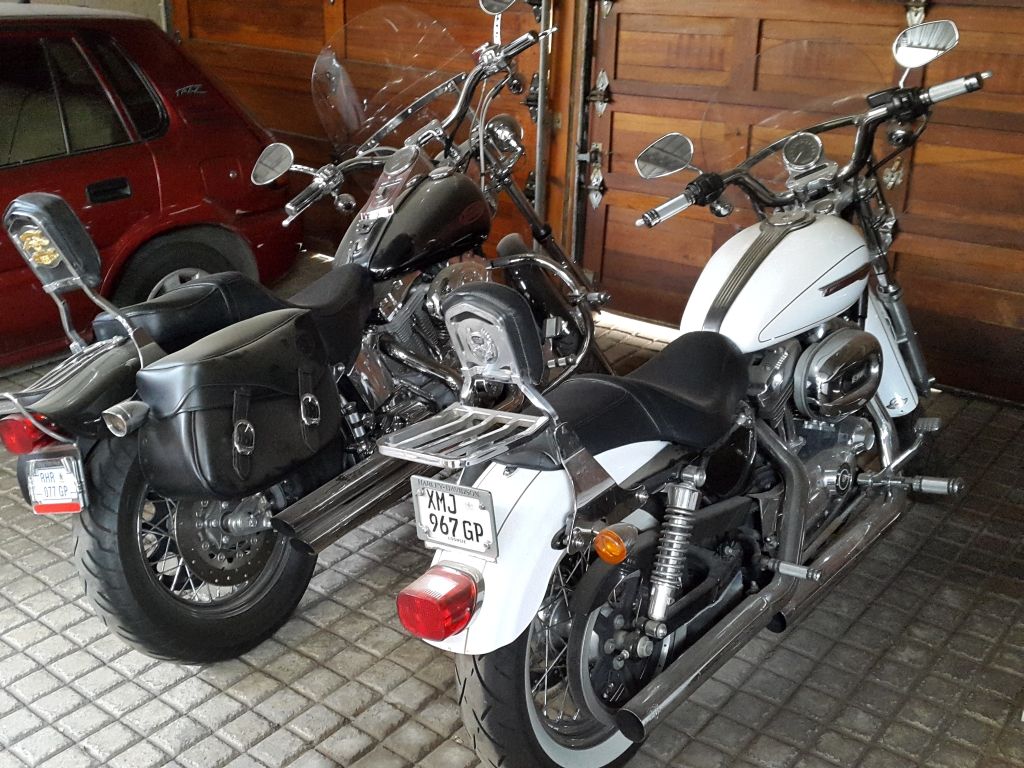

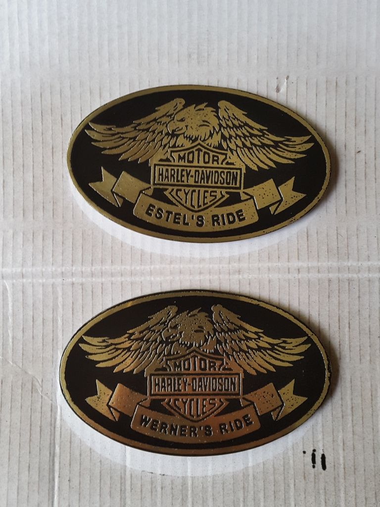

        My neighbour has gone away for a little R&R and left his two Harleys for safe keeping at my place, with the express instruction to give them a go. Won’t argue with that; and as a thank you I quickly made up a pair of backrest name plates for both bikes… Some real customizing!

            They look good, would you be willing to share details of how the artwork was produced, how it was applied and what etchant?

              Hi Brian, of course! I did a full write-up on my method in Model Engineer some time back (not sure of the issue number though). Basically it’s an electro-stripping process with a toner print on a transparency (or any other flat plastic) and transferred on a stove. My article says to use a cell phone charger and CuS but these were rather large and I doubt the power and volts would have been adequate, so I used an old power supply (12v) from a computer. They roughly the size of the current emblems on the bike…

                Sorry, artwork was done in ms-word, with images from the web superimposed onto each other and the names simple built in word-art overlaid on the group.
