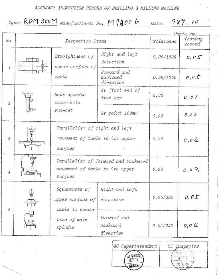

                                      Hi I have the test report from the factory for my rdm350 with the specs that the mill should be when new the run out should be a max 0.02 at the top of the test bar and a max of 0.03 at a point 100mm below the first point.
                                      Hope this helps

                                        Interesting to know Kim,did you get a manual with yours?

                                              Hi Yes it did come with a manual and test report however the manual was for the rdm 400m/500m/500mf
                                              the manual has been edited in pen where there are differences I think the manual was the same for all as far as I can tell I think the main difference between the 350 and 400 was the table being slightly wider. I can't seem to upload an image of the test report which i have found useful in the past
                                              Edited By Kim Garnett on 26/12/2022 11:08:40

                                                Good to see your report Kim,incidentally does the manual cover much in depth?,does it tell you the t nut size for the table slots?

                                                  I also have an RDM350. It's a nice compact machine. Interesting to see the spec sheet Kim. I'll use it to assess mine

                                                    The manual is not much use it very generic it has 8 pages and 2 of these pages has the parts diagram and parts list I did manage to download a copy of this manual off the web I think I got the link from this site. there are no table slot dimension in it see link below
