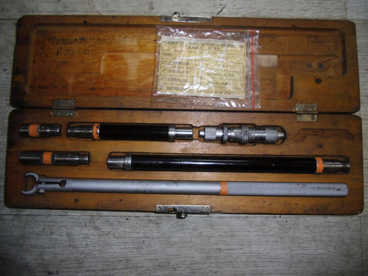

      Hello all, Back again to acess the knowledge

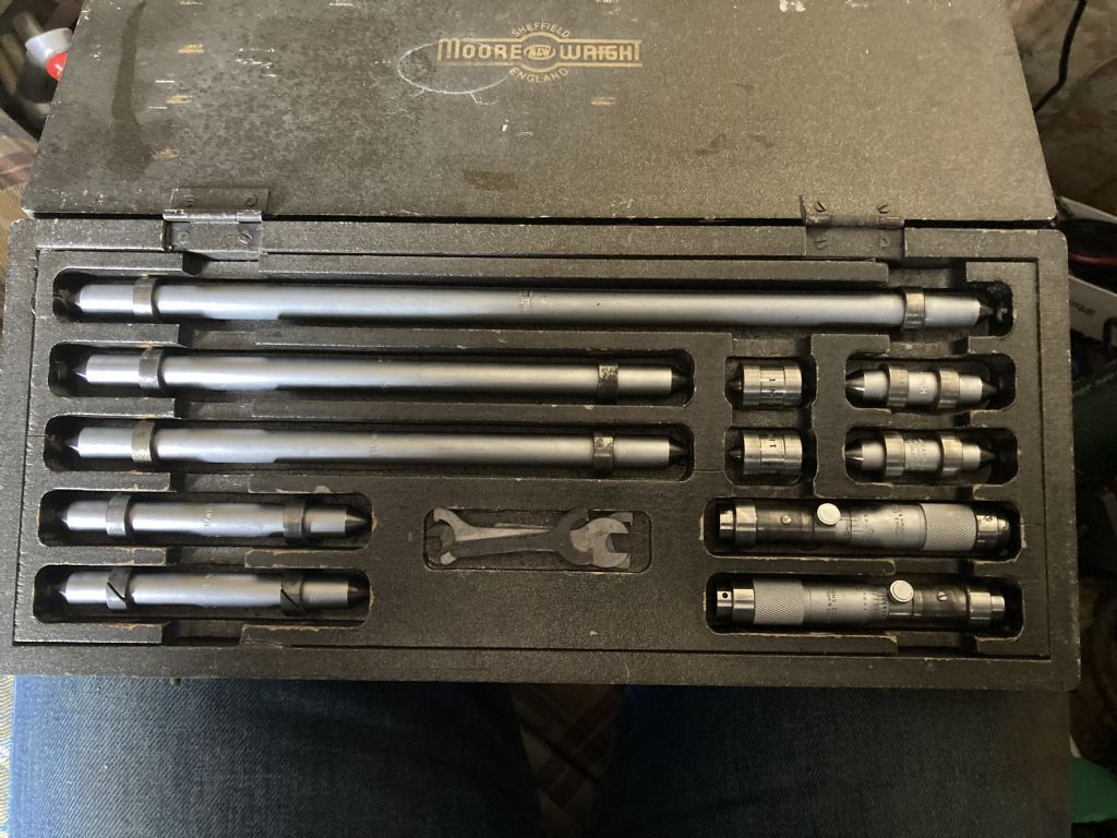

      These rods are marked with sizes, yet the tduplicate wo inch and one inch are consistently two thou over ie 1.002 and 2.002.The two micrometer heads have domed ends and are graduated for tenths.The rods have flat ends on truncated cones.Can anyone identify the name and use of these please?

        Help in identifying thuis set of tools please
        #541669
        Paul Barter
          @paulbarter66156
          Just to add to my post the two adjustable heads measure 3.625 when set to zero on the barrels were these for some very particular measuring process like go no go gauges?
          Thanks again for any suggestions Paul

          Howard Lewis
            @howardlewis46836
            Most probably an internal micrometer set, possibly with the heads in need of resetting to remove the 0.002 error.
            Which raises the question, before making ANY adjustments, of how accurate are the devices used to measure the overall length?
            Have they been checked against length standards or slip gauges, to confirm their accuracy?
            Do any, or all of the other extension rods show the same +0.002" ?
            If adjustment is required, the spanners with which to do it are there
            Howard

            Nick Hughes
              @nickhughes97026
              They are End Measuring Rods, used on a Jig Boring Machine.

              Paul Barter
                @paulbarter66156
                Thanks to you both or the swift response, the rods are not adjustable and were measured with Mitutoyo micrometers set to to slip gauges so I am surprised at the consistency of the apparent error. also the rods marked 8 and 4 inch are also duplicated. A Jig boring machine is beyond my skill set, but how would these be used please Nick? is 3.5/8 of particular significance and why two?
                Thanks again to you both Paul

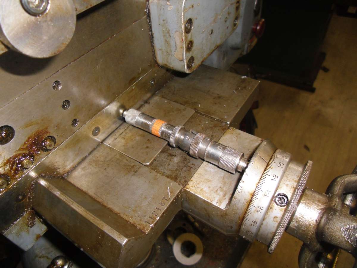

                    Clive Foster
                      @clivefoster55965
                      As Nick says these are used in jig borers to accurately set distances. Often toolroom class milling machines had a trough on the front of the table to carry them when doing accurate work. Even Bridgeports had an accessory to enable their use.
                      The adjustable heads are nominal 3.625" long. They should be set to read 3.625" on zero by the usual method of turning the micrometer sleeve. However some firms preferred to leave the sleeve in a fixed poistion and note the error. My set, obtained for a specific maybe job but never used, has calibration labels for the two heads. One says 3.6258 an one 3.6250. If I ever use them I shall sort that so both are calibrated to 3.6250
                      The length bars should be accurate to ± 0.00005" at standard temperature. That equates to less than 0.0001 error band. No idea why you are measuring one or 2 thou over. That said out in the real world you'd expect regular calibration with last time details to be in the box
                      These would normally be used with a tenths thou indicator. See the picture half way down this page :-
                      **LINK** , http://www.lathes.co.uk/bridgeport/page3.html for the Bridgeport accessory set up.

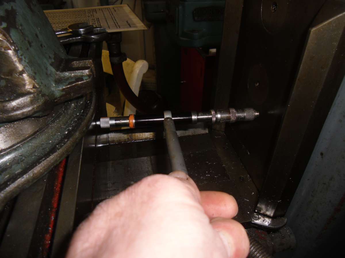

                      #541709
                        Posted by Nick Hughes on 26/04/2021 15:52:58:
                        Have a look from page 10 and on of this Pratt and Whitney brochure :-
                        Clever use of the dial indicator :

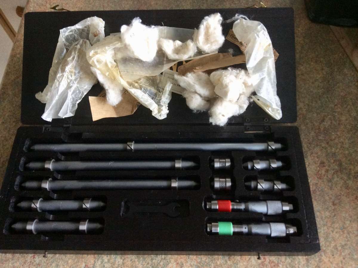

                          Dropped on my doorstep this morning, its brand new but actual M&W information is scant to say the least. Cant think of a use for it in the average model makers workshop can youIMG_3447
                                  The original post in this thread notes that two of the length standards appear to be oversize by 0.002″. Could you check your one and see if the mystery from 2021 could be advanced.

                                          DC31k, The red one is on the money at 3.625″ and the green one is 3.6255. Does this help?
                                          #714040
                                          bernard towers
                                            @bernardtowers37738
                                            DC31k, The red one is on the money at 3.625″ and the green one is 3.6255. Does this help?. The 1 inch pieces measure 0.99976″ and 0.9999″ and the 2 inch ones are 1.995″ and 1.996″. This all done with non certified measuring gear!.

                                                Red and green are Go/no-go calibrations.

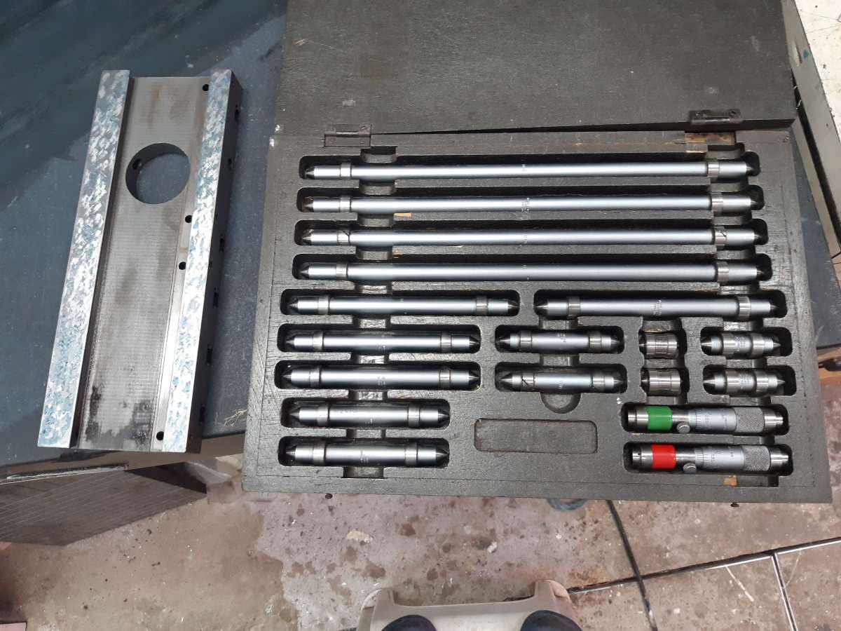

                                                      20240215_174041
                                                      I was also wrong in my assumption about go/no-go calibrations 🙂 . They were an impulse buy a number of years ago and help to stop the other little used metrology tools getting lonely.
