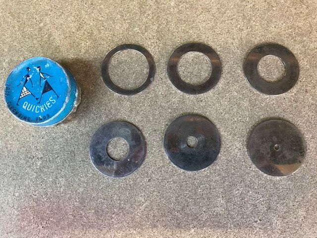

      I inherited these discs from the boiler house work bench where my dad worked about seventy years ago. Curious to know what they were used for. The holes seem to be accurately made in quarter of an inch steps from 1 1//5 down to 1/4 and the last one at 1/8 in dia. They were in a small tin labelled "Quikies" – my wife knows what they were, but my understanding of a quikie was somewhat different!

          Could they be restrictors.
          Steve.

              Hi, I think Steve is correct, they would be placed between two flanges in a pipeline to control the amount of fluid flowing through a system. It says on the tin that the Quickies are face cleansing pads, so nowt to do with the holy discs.

                I'm with steviegtr or commonly known as snubbers

                        Orifice Plates?
                        Pressure difference across a given calibrated plate will give an accurate flow measurement.
                        #590706
                        Nicholas Farr
                          @nicholasfarr14254
                          Hi, yes, Orifice plates, we used to make them a keyhole type shape, much easier to change and get the hole central in the pipework.

                                  I've seen similar rings used In drafting to produce a offset line inside or outside a straight or irregular shape ,it works the same as the offset tool in AutoCAD by putting a pen or scriber inside the ring and rolling it around the shape ,I have used it on jobs and it works well

                                      I suppose a restrictor is a good idea. The boiler did actually supply steam to a Turkish Bath. Wouldn’t want to scald the clients. Still not sure weather the grease monkeys were that bothered though, although they did entertain a very small boy 👦
