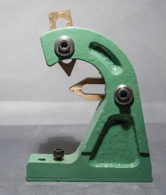

        I have just bought a travelling steady from chronos for my myford super 7 lathe, & it's to big. It states on the box ML7 , is the ML7 one larger? Or am I fitting it wrong? I noted on RDG tools site they state steady to fit ML7/super7 so I thought it would fit , it is too high, 3 inch from base to centre, & I think I need 2inch. Help please.

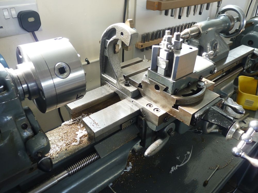

          Hi Rob,
          Are you trying to mount it on the cross-slide? It should bolt onto the chuck end of the saddle using a tapped hole there. The 3 inch height will be correct then.

                John Baguley
                  @johnbaguley78655
                  Does this help? The tapped hole on my ML7 is approximately in the centre.

                    The hole you require is right at the front of the saddle (chuck end) low down and approx. half way across the bed. It is tapped 1/4" BSF and probably has a hex headed blanking set screw in it.

                    #124711
                    NJH
                      @njh
                      Rob
                      If you are dissatisfied with the one you have bought you can make your own. College Engineering sell the castings/materials and it is an good exercise in some simple machining. Here, as they say, is one I made earlier! It was originally for my ML10 and you may note a piece of M/S fixed to the bottom to allow for the increase in centre height when I upgraded to a S7. The downside is that I think that the cost of the casting & materials is about the same as the finished item from one of the suppliers mentioned. On the other hand think of the satisfaction in making it yourself!
