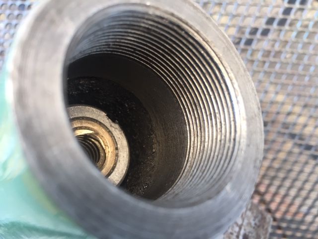

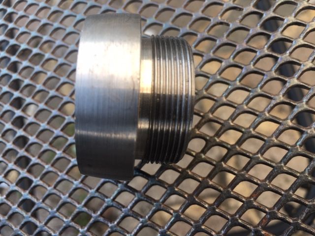

      Good evening everyone; this is my first post on this forum so apologies if my question has already been covered (I could not find anything). I'm not an expert by any means but enjoy pottering with Stuart castings and such like.
      I have a Super 7 that has worked very well but at the weekend I somehow managed to disengage the tailstock quill from its screw. I could not seem to get the screw to re-engage so I took the end cap off to try and make things easier. The cap came off fairly easily but try as I might I cannot get it back again.
      I have cleaned the tailstock and the cap threads; they seem to be in good order with no signs of cross threading. I can rotate thecap for 1.5 turns by hand and a further half turn by using a tommy bar, but beyond that its virtually impossible without undue force.
      I have:
      cleaned and checked the threads for signs of cross threading
      lightly oiled both parts
      run a fine point round the thread to make sure it was clean
      heated thetailstock casting with a hot air gun (this enabled me to get a couple more turns)
      Put the cap in the freezer for a short while (made no difference).
      Plan B would be to take a gnats eyebrow off the thread but I really don't want to go there – that seems the wrong thing to do.
      So I am stuck! 1.5 turns is enough for me to get the tailstock working but its obviously not the solution. Problem is I don't know what else to do! Any hits or tis would be welcome. I'll post a couple of pics to illustrate the problem.
      Thanks
      Trevor

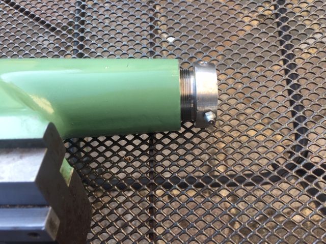

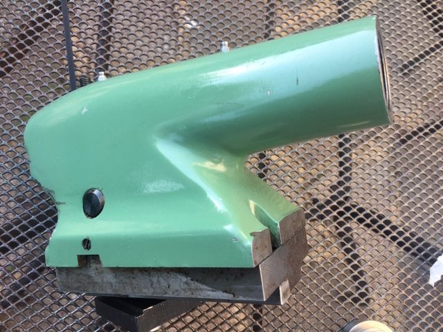

          img_2385.jpgimg_2383.jpgimg_2382.jpgHere are some photos of my errant tail stock capimg_2381.jpg

                  Thank you Martin and Robert. I spent another couple of hours tonight and really dont get it. As Robert says, it came out okay but it beats my logic as to why it won't go back. I got it to go two full turns without force but thats about as far as I can get. I have got the thing working for the present and will weigh up the options if I get any more replies.
                  #469662
                    If the cap came off ‘fairly easily’ it should go back with similarly little effort.
                    [ you know how much that is, but unfortunately we don’t ]
                    This indicates that you ‘must’ have a tiny burr, or some debris, in male and/or female thread[s]
                    I would advise very scrupulous inspection and cleaning before you even consider applying great force or removing metal.

                        Posted by Trevor Rushton 2 on 06/05/2020 19:46:25:
                        Forgive me please, if I am preaching, Trevor … But I’m pretty sure thatI can see burrs or debris in that male thread from here !
                        Any of those could be sufficient to jam a closely toleranced screw.

                            PPS Having seen your photo I would take some light oil and a tooth brush to that male thread and perhaps follow up with a blast of air (bike pump if you have no compressor).

                              The thread does look as though its got debris or burrs in it I agree, but I cleaned it before I tried again and satisfied myself that it was clear.Perhaps I just need a better pair of glasses! I will have a look at the tailstock again tomorrow; its not so easy to see the thread there. I think I may have underestmated the effect of tiny defects.

                                            From what I can see in the tailstock housing photo the thread seams to be full of small particles of swarf.
                                            One thing I would do is with a single point internal screw cutting tool, is to clean out the thread with this. A single point tool used methodically will show up any defect in the thread which can be scarped away using the tool.
                                            Then it needs to be clean, really clean. Start with an old tooth brush dipped in white spirit regularly. Mop up the accumulation from the bottom of the bore as you go, don't allow this to flow towards the tailstock barrel. If you have, Isopropyl, brake drum degreaser use this with the tooth brush afterwards, but watch the paint on the body of the tailstock. It might be wise to wrap some masking tape over this and around the edge to protect it.
                                            Finally with some cotton material from an old Tee shirt, wrap a strip several times around a piece of small diameter, plastic, or steel bar. Work this around the thread to remove the last bits of debris. This might need doing several times.
                                            My hunch is the female thread is at fault, but just to be on the safe side, put the male housing on a mandrel in the lathe. Running in backgear with a half round Swiss needle file run up the flanks of the thread using the flat of the file. Then pay attention to the crests of the thread again with the flat of the file. You are looking to remove damage not a load of material. Coating the thread with felt tip marker will show where you are taking material/damage off.
                                            Don't be tempted to use a 3 square or Triangular Swiss needle file, this is the wrong included angle, and please be sure to have some protection on the Swiss needle file handle. I saw one lad at school with the handle of the file under the skin of his right palm like a large thorn.
                                            Then clean this thread as above. A trial assembly without any oil should see the thread screw in further than before. If this happens replace the feedscrew and then lightly oil the thread which should go fully home now. If you have to use the Tommy bar it needs more work I am afraid.
                                            My feeling is that when you unscrewed the thread it actually "picked up", not your fault these things are sent to test us. As you say you had to use the Tommy bar to release the housing. Once the housing had been released it should have unscrewed by hand, the grease nipple providing all the leverage needed.

                                                FWIW my take is that you have the symptoms of a piece of debris jammed in the cast iron thread, about 1-1/2 or 2 turns in. Brushing with a tooth brush won't shift it. Cast iron, being relatively soft, will be locally bruised allowing the fleck of debris to nestle in a crevice, jammed in place by trying to force the male over and past it.
                                                Borrow a small mirror, go looking down the thread for a foreign object. It will be obvious because it will be a different colour to the adjacent cast iron, having been burnished by running the male thread up to it.
                                                Once you've found the bit, it'll take some shifting. Think pointy something with a 90 deg bend in it. It'll be surprisingly reluctant to let go.
                                                Don't go cutting or filing, you know it fitted before, it'll fit again but there is a mechanical obstruction.
                                                Once you've got the fleck out of the surface of the thread, go looking for another!

                                                  Looking at your photo's the 2nd one down of the external thread it looks to me as if the
                                                  first two threads have become a little rounded on the crests and in the 3rd photo
                                                  the thread looks a little deformed the first thread in at about the one o'clock position.
                                                  I took my 7 tailstock apart to have a look more clearly at this and noticed the the external
                                                  thread was very sharp with no lead in chamfer , if yours is the same it needs to be dressed
                                                  down ,i used a three edged diamond file this one was from Arc euro these are quite
                                                  good for this as they leave a clean polished edge.
                                                  In my photo you will see a thread cleaning tool that i use for cleaning the internal chuck
                                                  threads ,i think this came from Sparey's Amateur's lathe book it is made from 1/8 inch
                                                  welding wire , this also fits the thread in the rear of the tailstock as i have already tried it.
                                                  When you get the thread started at least 2 threads in and you can turn it in no more lock
                                                  the tailstock down to the bed and using a flat piece of hardwood resting on the end
                                                  of the end cap and with a small ball pein hammer give a sharp rap and see if it
                                                  moves around a little more,don't go pounding it with hammer blows just one at a time
                                                  and carefully ,it wont be quick but will free up the thread eventually , you can carefully
                                                  lightly tap around the sides of the cap four places using some wood to protect the
                                                  surface again don't overdo this and keep the cap on the move ,you must make sure to
                                                  clean the threads often whilst doing this cellulose thinners and a toothbrush.
                                                  These parts do fit together quite well ,there is little clearance in these threads
                                                  so care is required.
