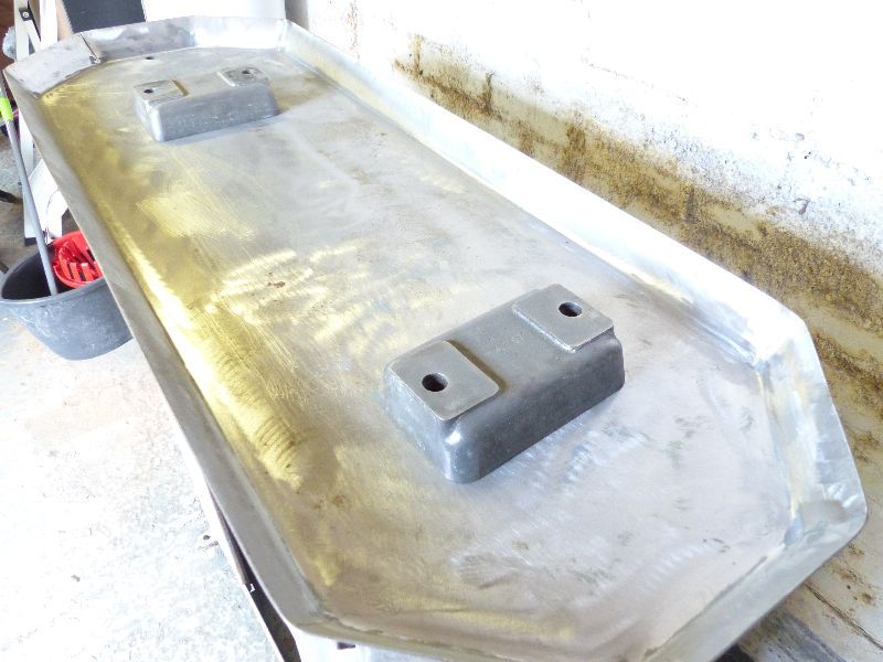

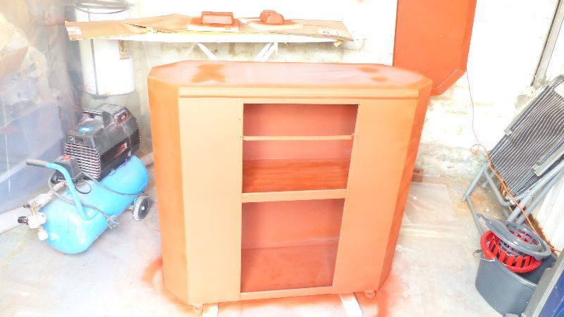

                  A bit of progress, and a few pics:-

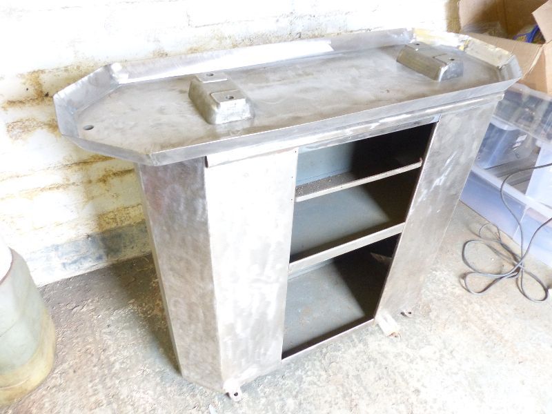

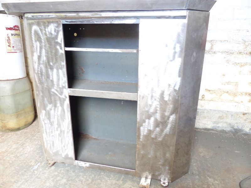

                  It was a long job sanding the paint off the stand and tray, I used paint stripper on the raising blocks and the paint just fell off on it's own, followed by buffing up with a rotary wire brush but the stripper did'nt touch the paint on the stand and tray. I sanded this off with a non-woven abrasive disc,
                  I am using Paragon synthetic enamel paint throughout,starting with anti corrosive Red Oxide.
                  I found the paint easy to use, but had to thin with 25% off their PT8 thinners, they reccommend 10-15% but I could not get it to flow cleanly at that ratio. 5-10% seems to help with brush painting,which I did on hard to spray inside areas.

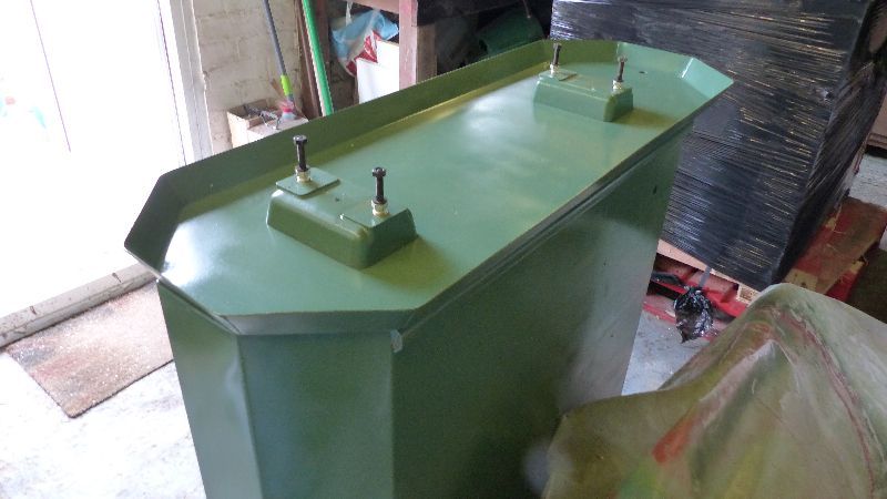

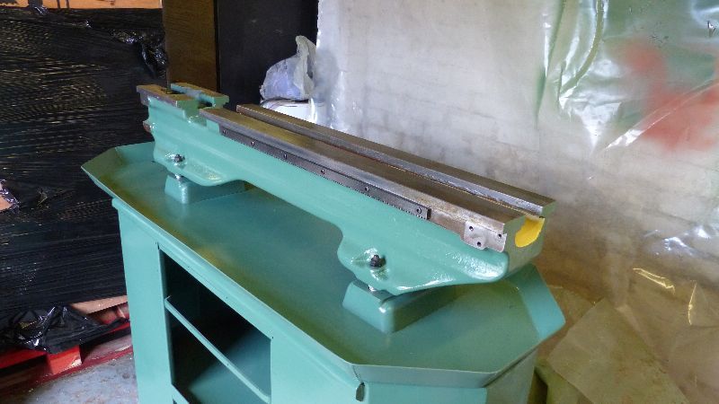

                    Anyway, I managed to get a coat of paint on the stand etc., Hope to rub it down tomorrow and re-coat it so I can move on.
                    I won't get the whole job done before the cold weather stops Me, but hope to get the bed sorted before then, and pick up the job in the spring.

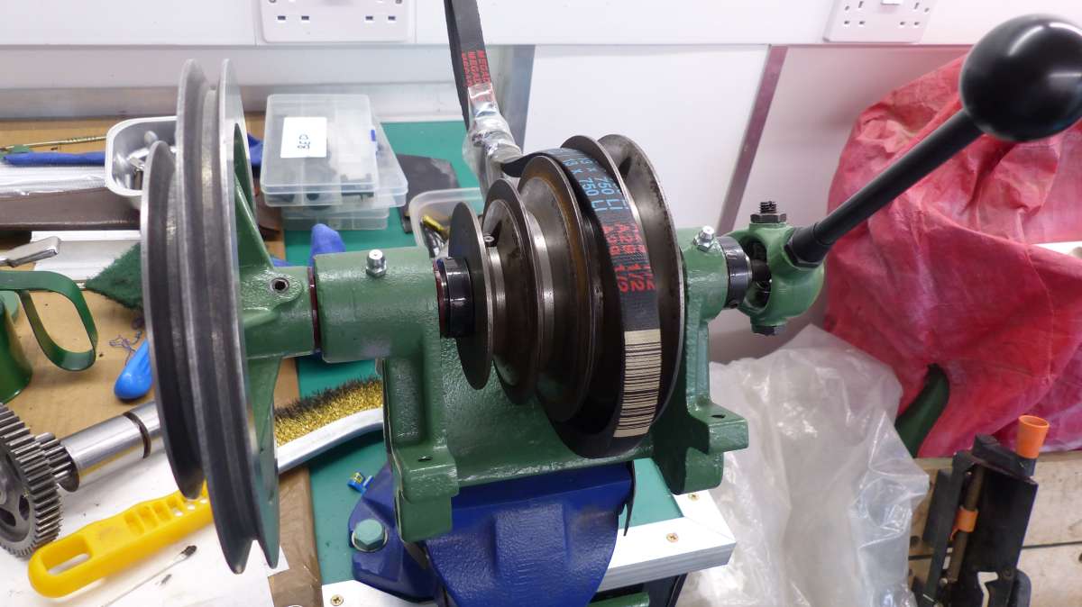

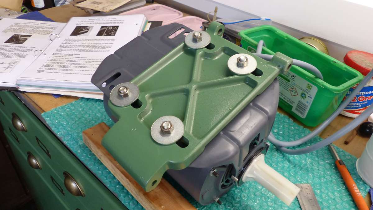

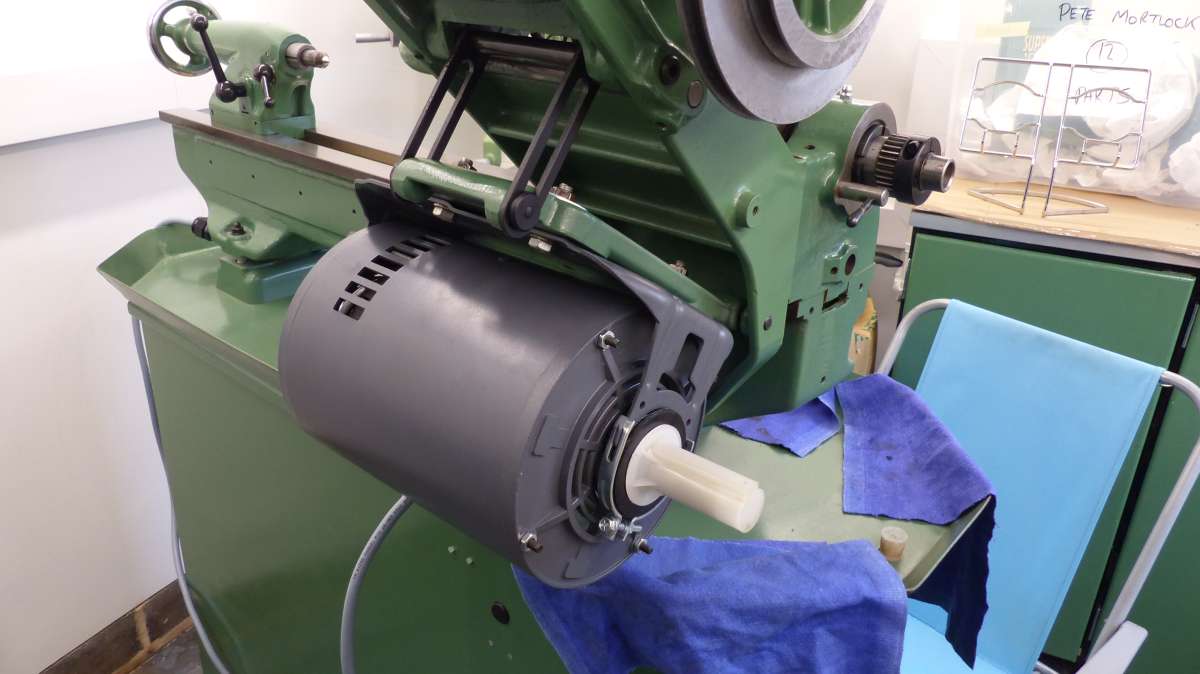

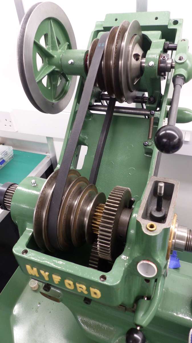

                                              Morty
                                                @morty

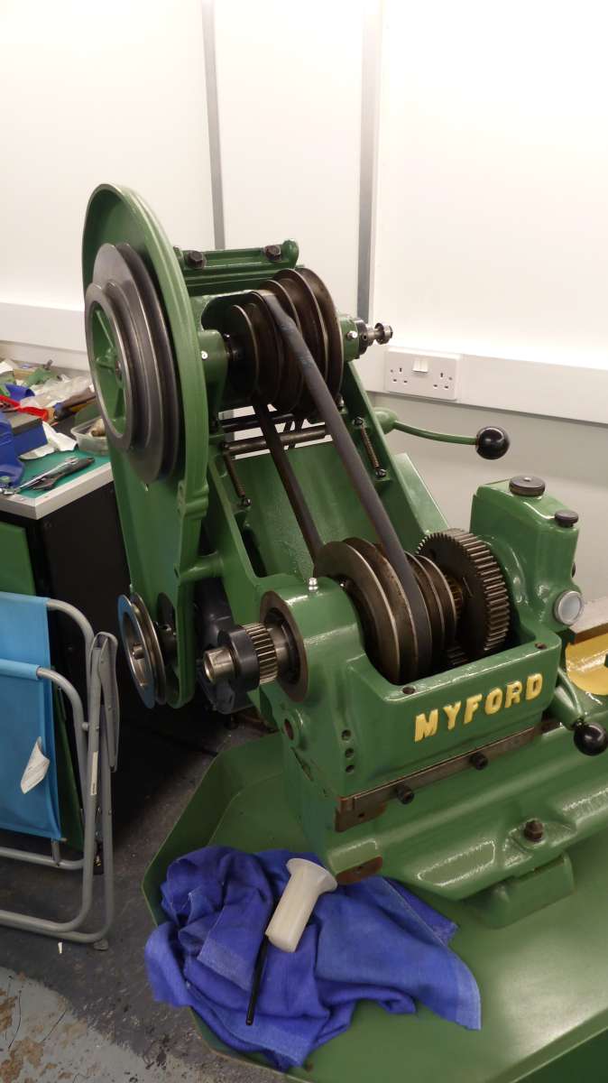

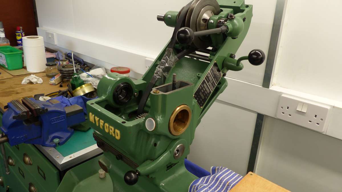

                                                Hi Everyone!
                                                I hope everyone is well and keeping busy!
                                                I could not believe it was so long since My last post until I checked, but the good news is the Myford is finished bar setting up, and the rest of the workshop is done,bar laying a floor covering, which will be inter-locking tiles.

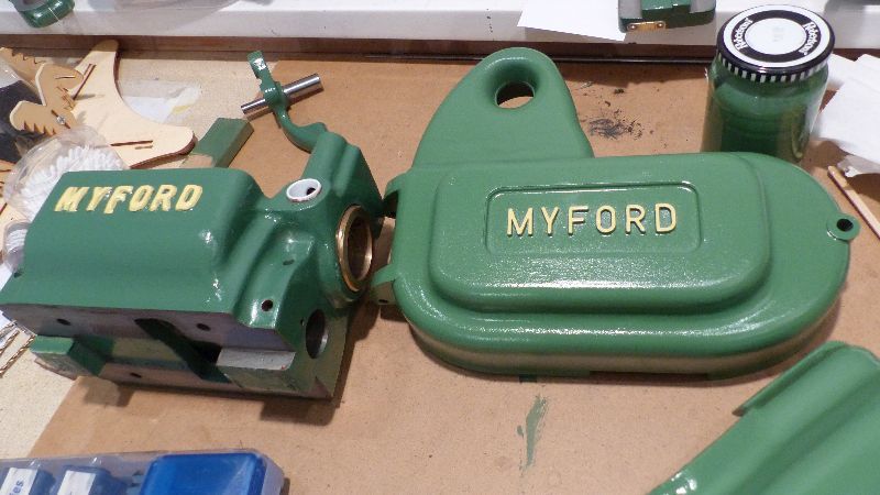

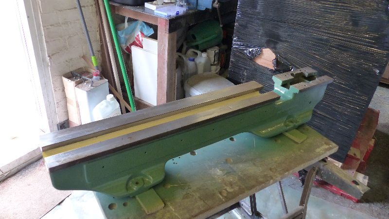

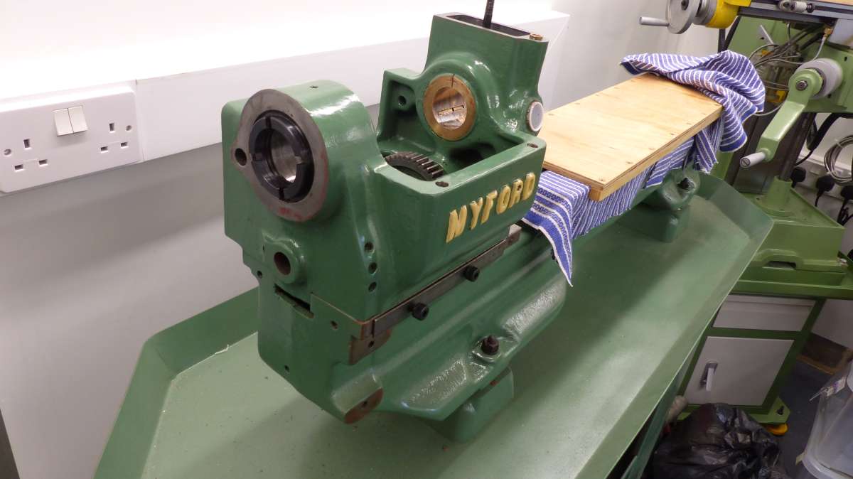

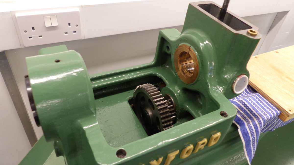

                                                I have been making use of ‘Beachcomber Bobs’ YouTube videos to guide Me through the process, including the early Gearbox, and highly recommend anybody undertaking a restoration to follow suit. Down to earth and clear explanations of the steps needed, I would only be repeating what He said if I gave a Blow by Blow account on here,   Many thanks Bob!
                                                I will post photos of My restoration, with notes where needed, and will split over about 3 posts due to the ammont of pics.

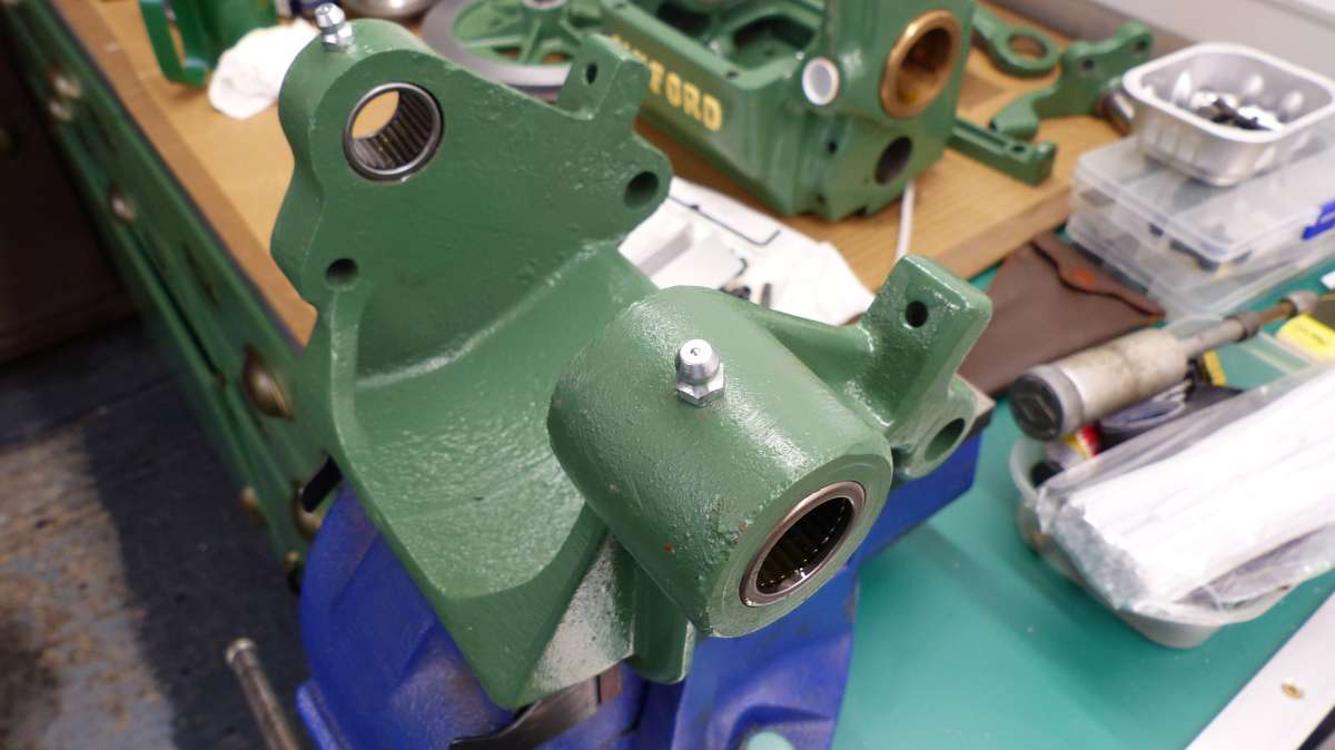

                                                New needle bearings fitted to countershaft housing,use the type with a lube hole drilled where needed:-
                                                (Holes are £5 extra by the way!!)
                                                89
                                                88
                                                9293949899101102104105106

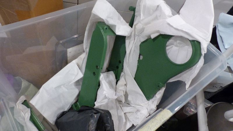

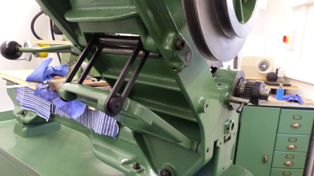

                                                Clutch went back together fine and works OK,all bearings in clutch and headstock replaced while I had everything in bits.

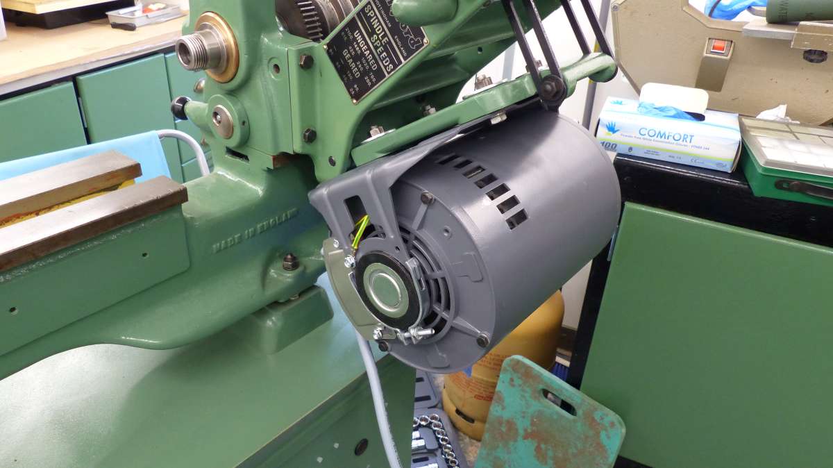

                                                New motor and control unit from Newton Tesla fitted, very easy to fit and runs very smoothly,  I will fit a revcounter to the rear of spindle in due course to make use of the variable speed.

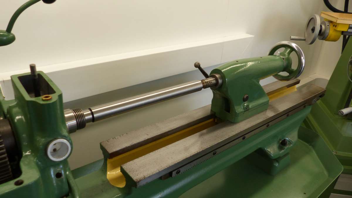

                                                Headstock set up in line with bed, using test bar to zero the tailstock.
                                                New belts fitted and tension set on countershaft cradle Adjustment bolts.
                                                Headstock bearings set up by following instructions in Myford Manual.
                                                Phillips Gun Blueing used to re-finish parts when cleaned up.
                                                Drip feed oiler works well and can be adjusted to keep a fine flow to keep reservoir constant.
                                                Will post more pics tomorrow, thanks for looking in!
                                                Cheers,   Morty

                                                  Robert Atkinson 2
                                                    @robertatkinson2
                                                    Lovely work.
                                                    Glad you went with the 3 phase and VFD conversion. Apart from the frightful original electrics, V8eng was totally correct, they make the the lathe quieter, smoother and easiler to use.
                                                    One thing I don’t understand is why NT supply the open frame motors. Maybe its to look like the “traditional” type but a totally enclosed fan cooled (TEFC) motor is a much better choice when there is swarf flying around. OK the 3 phase motor does not have an exposed centrifugal switch but swarf, particuarly chips, can lodge in the windings and eventually wear through the insulation due to vibration.
                                                    Robert.

                                                    DMR
                                                      @dmr
                                                      Hi Pete,
                                                      Long time, no see. I put in a few clues way back in 2020 and I must admit you fell off the radar. I don’t seem to have our PM communications from those days, though I have got others from a lot further back. Did I supply my tables for screwcutting info on the early gearbox? Drop me a PM if not as I can’t put them on here.
                                                      I have to add that you cannot say the early clutch “works OK” until you have it under load conditions. I found mine had to be tightened up so much to eliminate slip that it then dragged when de-clutched. I fitted a modern clutch, thus eliminating a lot of troubles and never looked back. Also, whilst you have aligned the tailstock with the headstock horizontally, have you checked the vertical (top to bottom) alignment along the length. The tailstock sole plate was selected for height by Myford when new. Any fiddling since can affect that.
                                                      Finally, the headstock oil tap (as Myford called it). On mine, I initially set it for the odd drip but found oil seeping out underneath when not in use. So I took to closing it after use. Later still, and since our use is hobby related. I applied a few drops when I started to use it and then closed the tap. I have used that approach ever since and had no problems. There is no point in having visible oil in the sight glass.
                                                      Please, stop glorifying it now and get it running. You will not want to scratch that paint job which will will deter you from enjoying it. I did much the same as you, but now mine looks used again, as it should do. Also you may find things that require rework which be off-putting.
                                                      Get using it, Dennis
