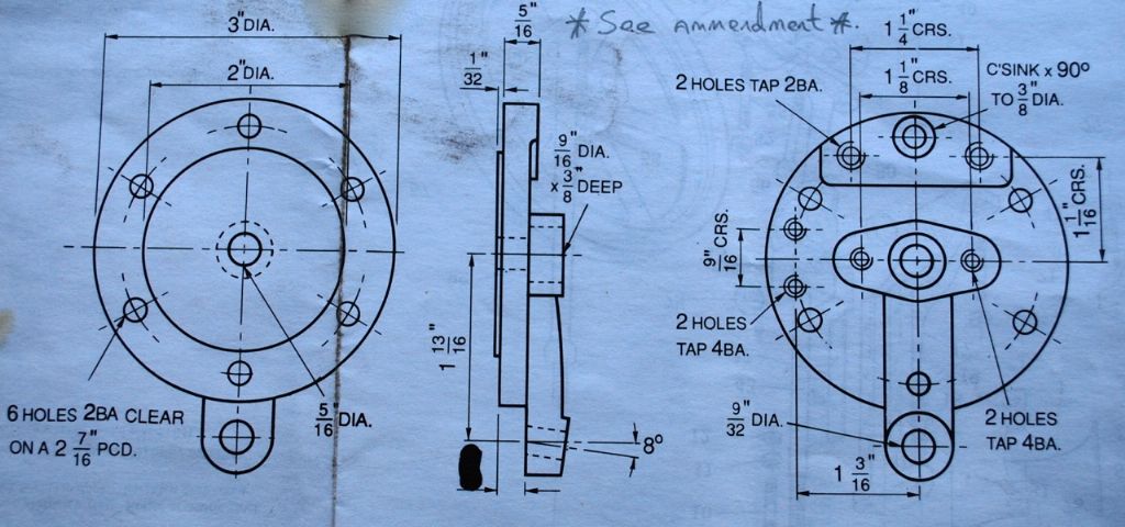

      Just a couple of pics of the next step in case anyone following finds interesting..
      Please excuse the state of the drawings, I have them pinned up behind the lathe and they get splattered in oil. Looks like there is maybe a mistake on the drawing as only one of the 2BA holes shown may need countersinking (one of the two 2BA holes takes a stud I think – 13 studs supplied re fixing the covers & only 1 2BA 1/2" screw also confirmed in the stock list on the drawing. At least I have a note to double check when I come to do it..)

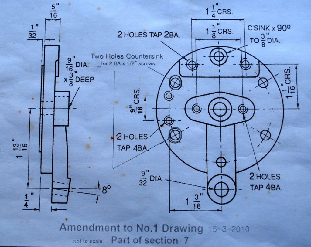

      The Bottom Cylinder Cover Drawing.
      The Bottom Cylinder Cover Amendment Drawing. This was included.

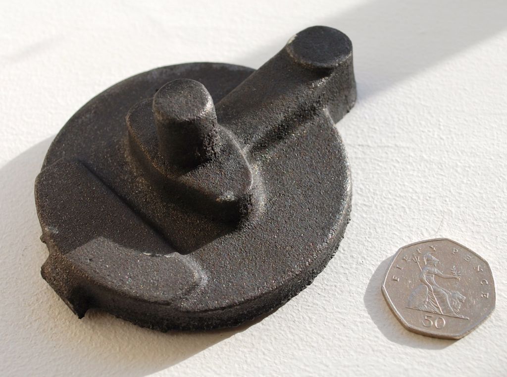

      The Bottom Cylinder Cover casting as supplied 1.

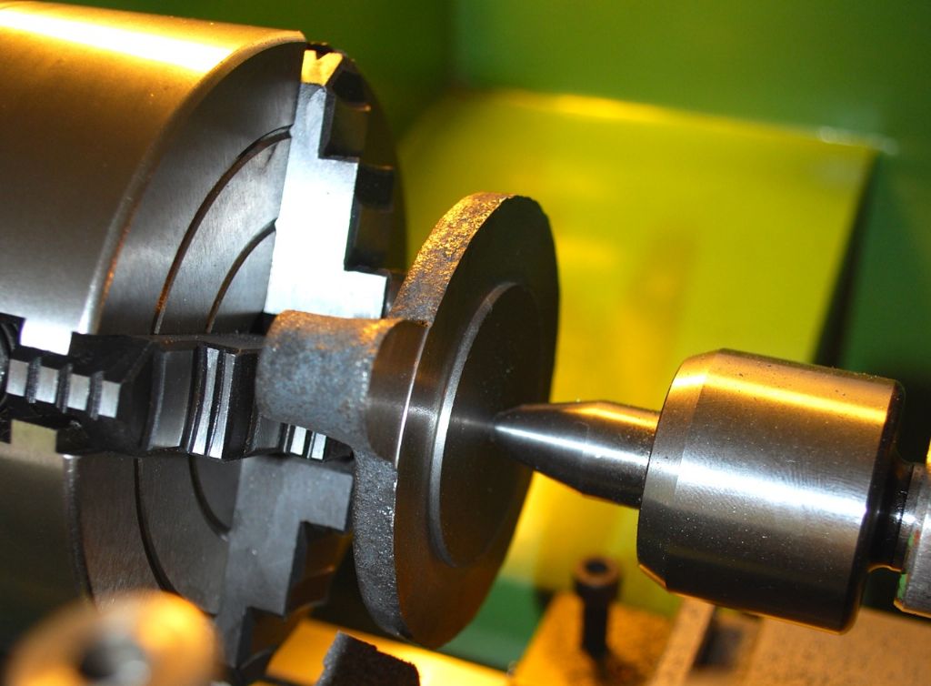

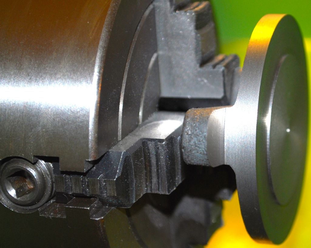

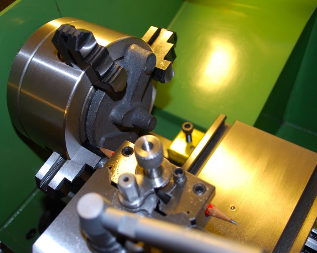

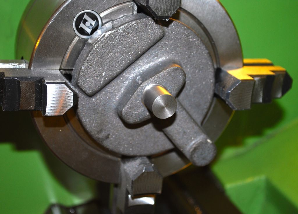

        Didn't get much time today, just managed a start on the bottom cylinder cover..
        Setting the outer rim of the cover to run true as poss. Cant believe I've struggled doing this kind of thing for so long when all I needed was a pencil – works brilliantly! Thanks again Jason and Chris, I've had so much help and good advice on here but this maybe the best / most useful yet..
        The Chucking Spigot turned..
        This was as far as time allowed – now holding on the Spigot the Cylinder locator turned to 2" and a start made on the excess casting around the Column support boss.
        Cheers.
        Allan.

          A little more work done on the Bottom Cylinder Cover.
          The turning to size finished.

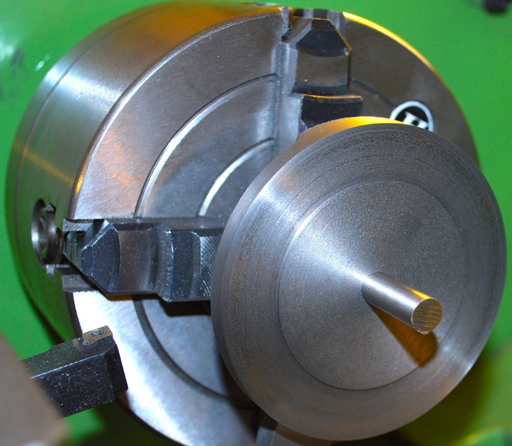

          After drilling – test fitting the supplied 5/16" Stainless Steel bar to make sure it didn't need skimming. The slight score mark is on the 2 7/16" PCD for the fixing holes etc – to aid marking out later

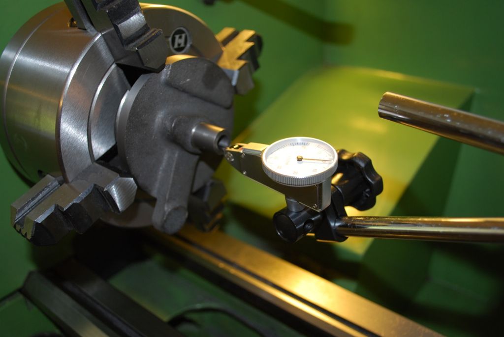

          After reversing in the chuck – setting the hole to run true.
          After initially turning the chucking spigot and then reversing to hold by it should i have used the 3 jaw? When setting up by holding on the spigot there were no machined surfaces to set to run true with the DTI so I set the outer rim of the casting to run true in the 4 jaw. I can see now that the central hole is slightly out through the spigot as a result I guess. I've set up now to continue after reversing by setting the hole to run true with the 'finger gauge' and it [the hole] looks to spin perfectly, I know the chucking spigot is to be cut away shortly, just wondered if I have gone about it the right way or if it matters? Hope that makes sense.
          Thanks for any advice.
          Regards
          Allan.

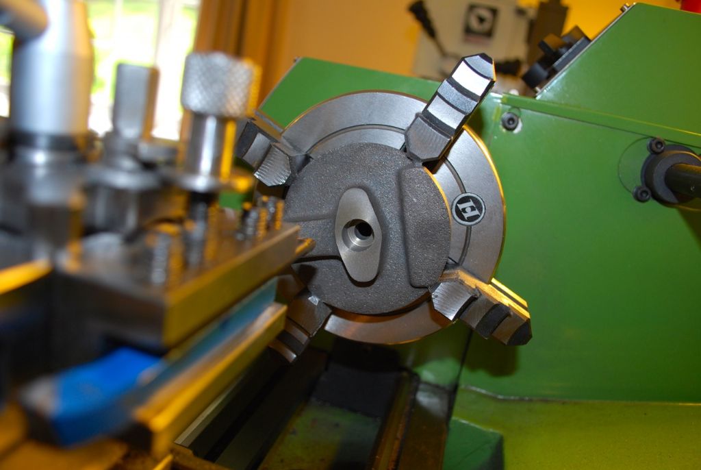

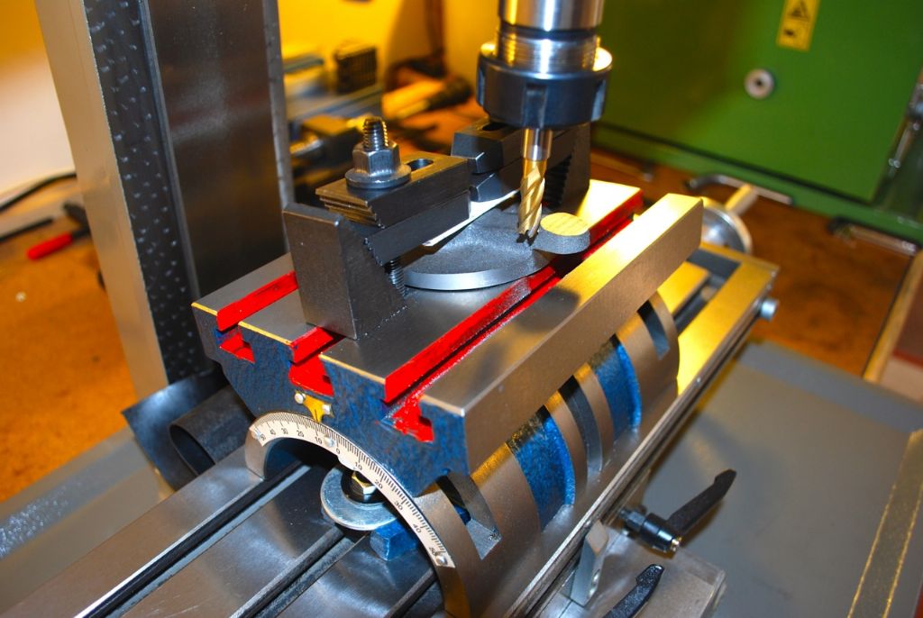

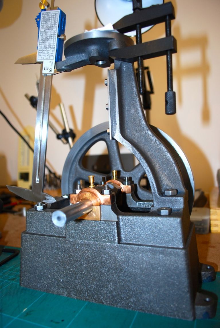

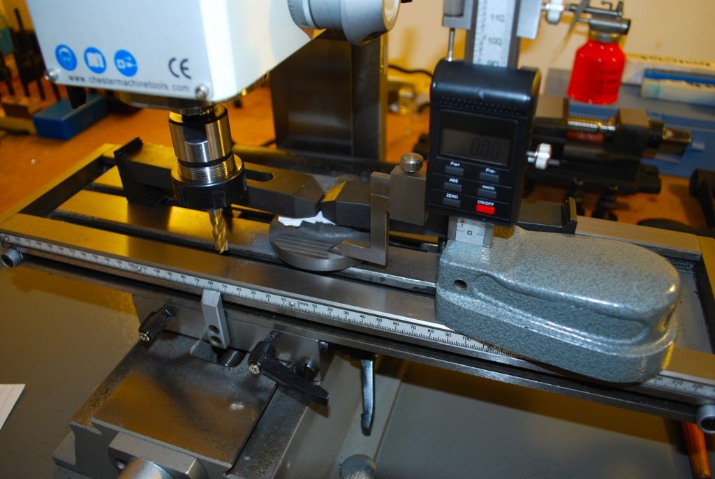

                A little milling before breakfast sees the Standard seating milled to size..
                Milled down to size.

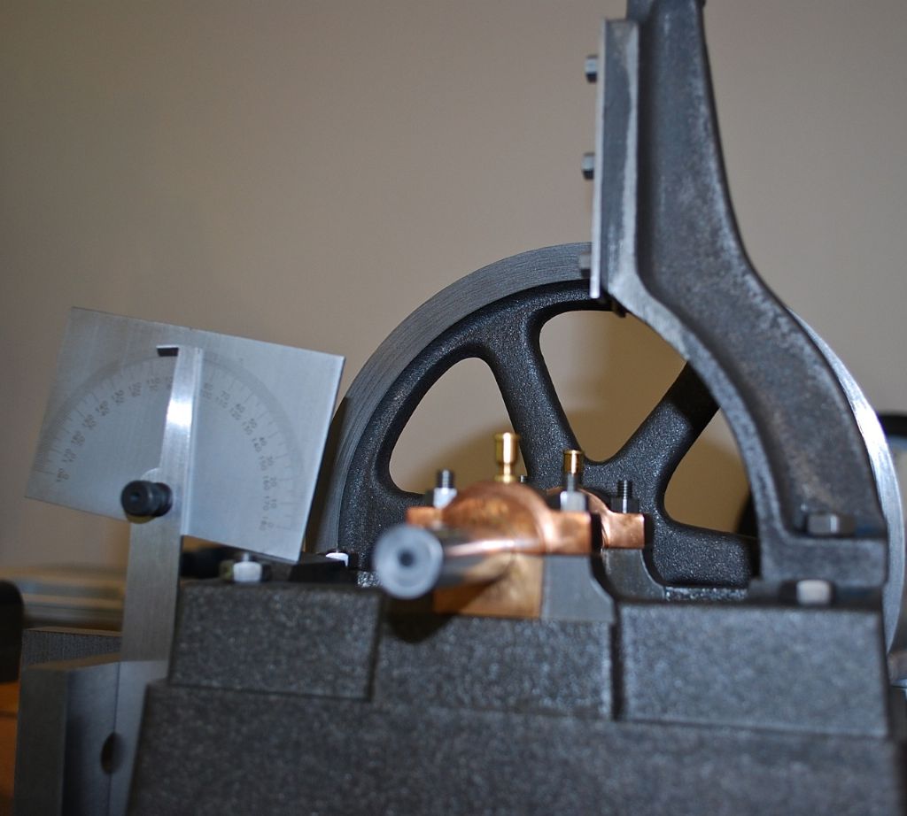

                Checking the Angle for the Column Support seating – I've changed my Tilting Table since I did this (it was difficult to set the angle as the scale was not the best) and I didn't have a protractor then, still lacking the basics sometimes – the angle was supposed to be 8 degrees but I now make it 5.5. I'll do the boss on the Cylinder Cover the same now..
                Cheers
                Allan

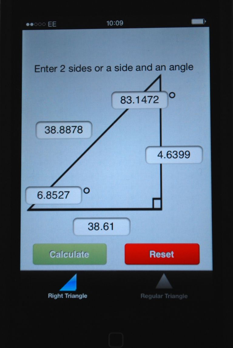

                #187148
                GarryC
                  @garryc
                  oops again – I've realised since the last post I need to change the sole plate angle for the column seating to 8 degrees as per the drawings… Something I can do more accurately now..
                  Cheers.
                  Allan.
                  #187194
                  roy entwistle
                    @royentwistle24699
                    Allan Can I suggest that you draw acurately the base with the angle youve got and the cylinder cover with the angle youve got in thier relative positions and then check the angle you need on the column I think that if youve not got the correct angles on the sole plate and the cover you are going to need a different angle on the column
                    I could be talking throuigh my ****** but check anyway
                    Roy
                    #187197
                    GarryC
                      @garryc
                      [Hi Roy – we seem to have posted at the same time. I'll read your post carefully when I get back later, thanks very much.]

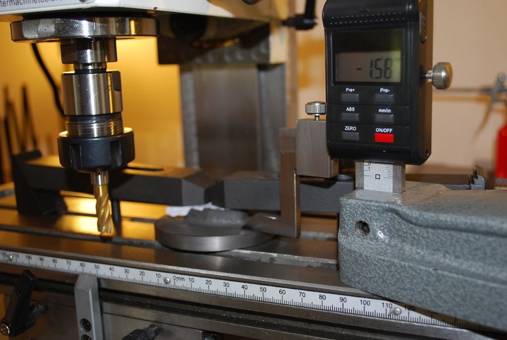

                      Having to make do with very small sessions at the moment but like to keep going forward most days if poss..
                      Milling the correct angles for the Support Column. This 'new' tilting table has a much better (accurate) scale and is a bit larger than my old one – nice to use.
                      Before I start drilling holes at the wrong angles just checking the two Column seating faces are at the right angles (8 degrees). Both faces of the Calliper are lying flat, looks good to me..
                      May get some more time later on with a bit of luck..
                      Cheers
                      Allan
                      Edited By Allan. on 21/04/2015 09:37:14

                        That tilting table looks a neat item, better than some I've seen. could you enlighten us to where you bought it from. Your overall build is looking good to date, I've yet to start on my Stuart kits, need to get the 'finger out' syndrome into touch.

                        #187251
                        GarryC
                          @garryc
                          Hi Roy
                          Thanks for your post, your advice is very much appreciated. I made a silly assumption yesterday that I just needed the same angles both sides for the column seating – I only later realised it needed to be the specified 8 degree angle – what an idiot! Sorry for the confusion. It looks fine after milling to the 8 degrees – believe all is ok to go ahead now.. Please let me know though if you still think there may be a problem.
                          Hi George
                          Yes I like this tilting table, I bought it recently from RDG **LINK**
                          The calibrated scale is nice, can be set accurately and locks easily – unlike my old one. I can't fault it.
                          We had a member of the family having tests for cancer today, been very unsettling… Puts all this into perspective..
                          Regards
                          Allan
                          #187254
                          roy entwistle
                            @royentwistle24699
                            Allan Yes if both angles are as stipulated on the drawing you should be OK ( assuming drawing is correct )
                            Roy

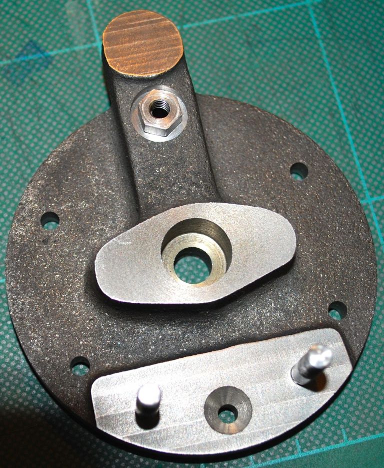

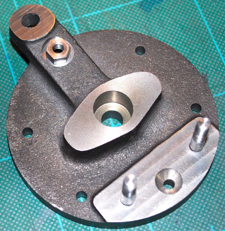

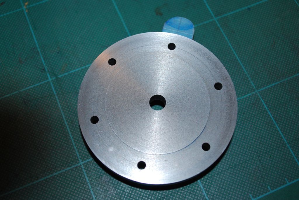

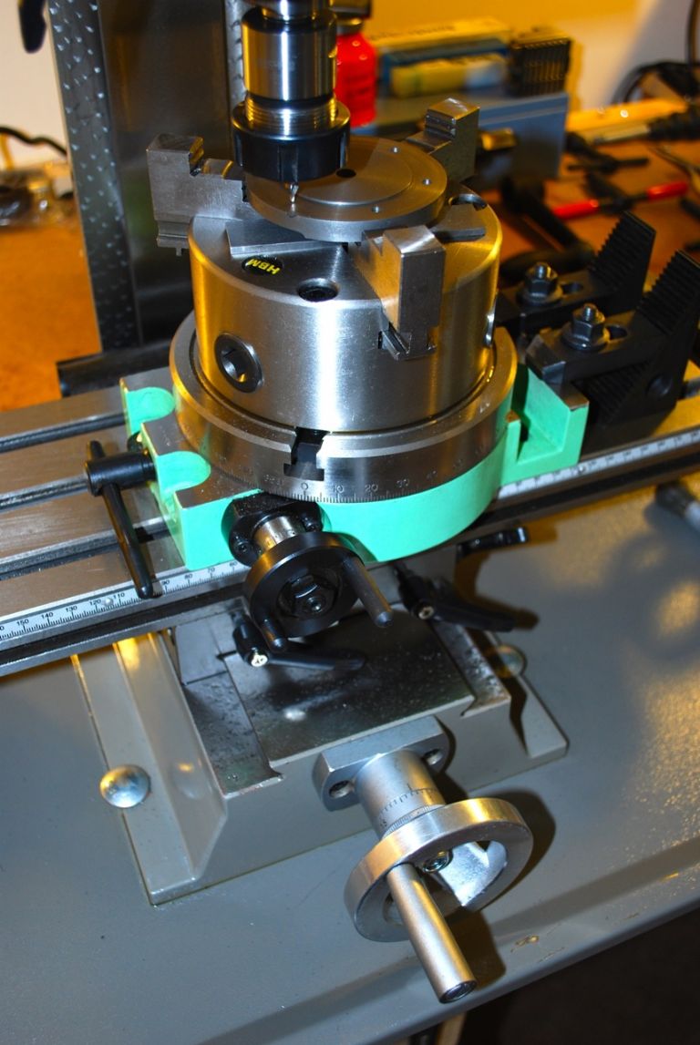

                                  Just a couple more photos of progress with the bottom cylinder cover..
                                  Drilling with the rotary table the 6 holes 2BA tapping size for spotting through to the Steam Cylinder later – opening to Clearance Size afterwards
                                  The Bottom Cylinder Cover so far 1.
                                  The Bottom Cylinder Cover so far 2. The 3/8 diameter countersink is ok but I went a bit oversize in the Column Support Arm..
                                  Next to try drilling the hole in the Column Support boss 8 degrees.. The rest of the holes in the drawing need to be spotted through when the parts are made later…
                                  Cheers.
                                  Allan.

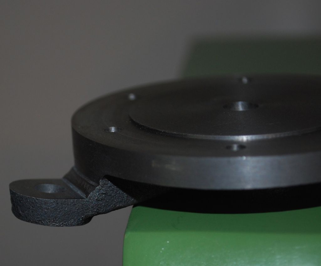

                                  #187600
                                  GarryC
                                    @garryc

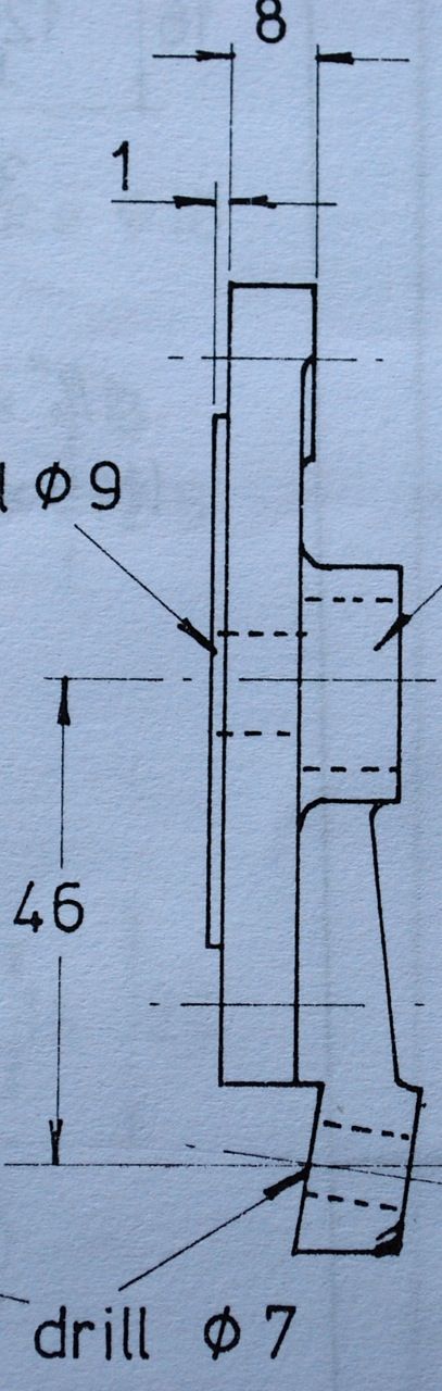

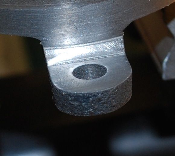

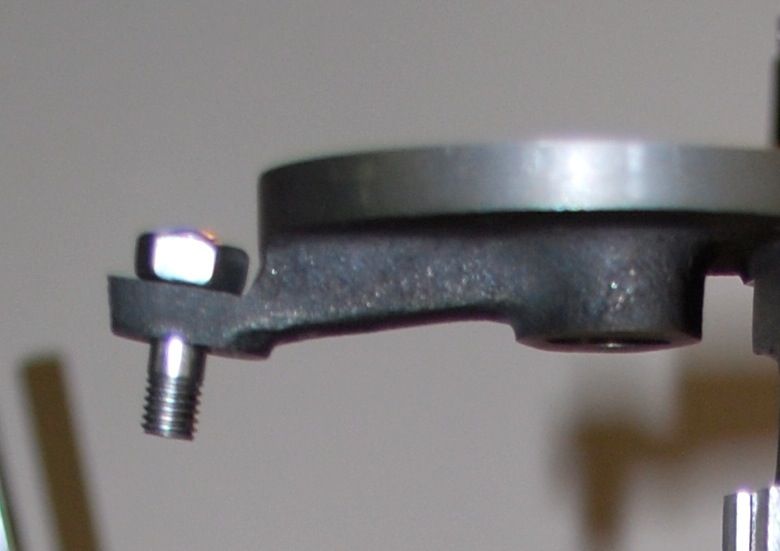

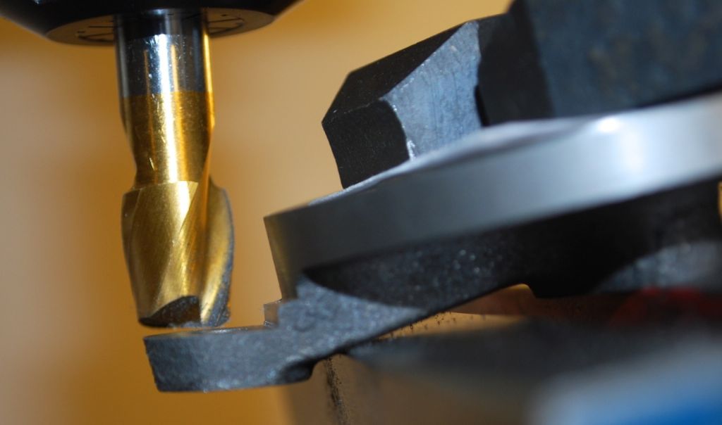

                                    Thought I may have had trouble getting this hole right, but that went ok – it was facing the top side of the Column Support arm for the Column nut to sit properly that I found difficult. The Assembly Drawing shows a spot facing in the top but I couldn't seem to get the angle for that being so close to the cover rim, so I tried to go with the method used by Andrew Smith in his guidelines on building the engine – but I'm left with an awkward little step to cleanup. I need to get some small files for it..
                                    Showing the difficult angle in facing the top of the Column Support Boss 1.. The Drawing by Andrew Smith.
                                    Showing the step left in facing the top of the Column Support Boss.. The picture makes it look worse than it is but I want to get rid of it if I can..
                                    The Bottom Cylinder Support Cover so far..
                                    Cheers.
                                    Allan.
                                    Edited By Allan. on 24/04/2015 13:13:34
                                    #187601
                                      Comming on Allan, I think I would just take a small round file to it and create a fillet which will be stronger than filing back to a right angle as the drawing shows. Dremel with a small grinding bit will do if you don't have teh small file.
                                      If you do want to get in and machine under the overhanf a suitably ground bit in a flycutter will do the job.
                                      Edited By JasonB on 24/04/2015 13:27:07
                                      #187602
                                      GarryC
                                        @garryc
                                        Thanks Jason, I do have a tiny round file I'll have a go with that. Still haven't replaced by Dremel that went pop yet..
                                        edit – wow just seen the photo of the Flycutter, I just knew there would be some clever way to it. I do have some flycutters now, I've not used them yet. Think I had better stick to the file for now – but thanks for showing that, very interesting.
                                        Cheers.
                                        Allan.
                                        Edited By Allan. on 24/04/2015 13:31:45
                                        #187624
                                        GarryC
                                          @garryc
                                          After a little time with the small round file and some tape to protect the adjoining surfaces….
                                          I can always take it back more later if need be, hopefully ok though.
                                          The awkward step removed 2.
                                          Cheers.
                                          Allan.

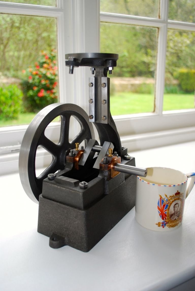

                                          #187710
                                          GarryC
                                            @garryc
                                            The Bottom Cylinder Cover in place, nice tight fit on the Standard.. (Nuts not screwed down)
                                            The Support Column nut now with enough room and sitting properly.
                                            Next to do the tapered Column.
                                            Cheers.
                                            Allan.

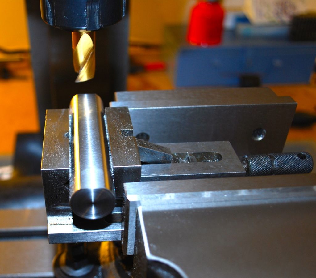

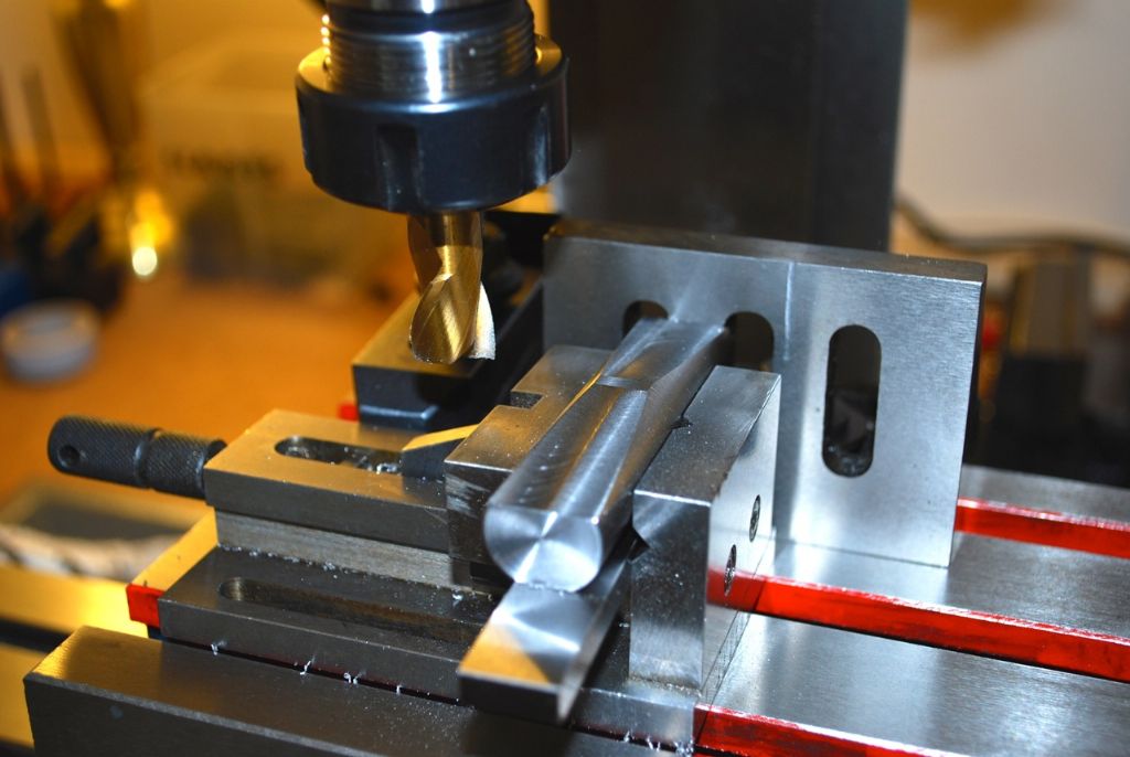

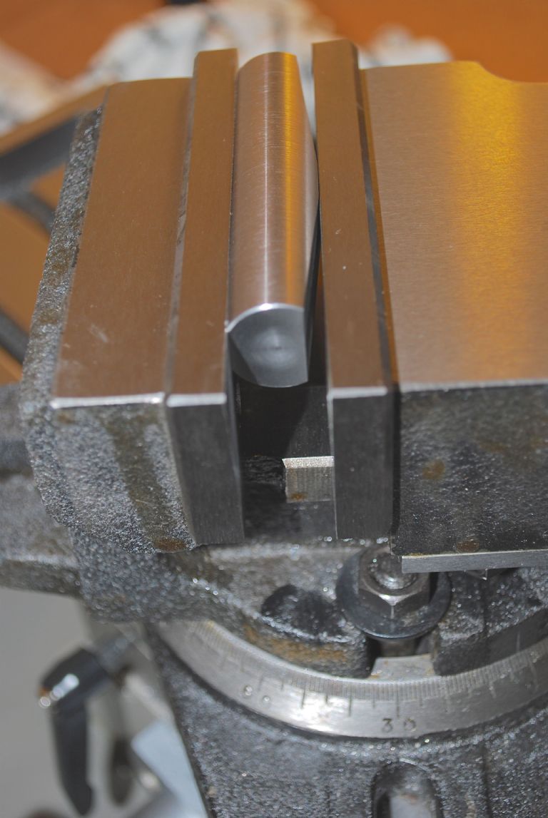

                                                Time to get back on with the engine. After watching Eric's video's its clear that earlier in the build I didn't square off the bearing blocks properly which I think contributed to the solder failing when tightened in the chuck. They were definitely not square, out by a tiny bit – "that's the best the equipment can do" I remember thinking and I thought they would be ok at the time – hopefully I know better now… So anyways I thought I would make the little 'holding' tool / bar that he was recommending before going about squaring the supplied bar for the column and using his method. Its just a piece of bar with some flats – 2 parallel and two tapering for supporting a part when squaring off..
                                                It didn't take long to do and should get lots of use I hope. I'm sure there are lots of different ways of squaring a part off but this looks like a good idea to me and you have to start somewhere. It doesn't have to be sized exactly but I need the practice… First time I've tried for a nice finish on the new lathe and easily the best I've ever achieved – indexable tip but with the tool angled over to the tailstock CCMT 06/04/02 I think. I can't get them to give any kind of finish if presenting at 90 degrees to the work which seems odd somehow..
                                                Putting the flat down one side of the bar – this side goes against the fixed vice jaw (.the back one)
                                                Didn't have to do this but decided to aim for the tapered flat going to 25% depth of the diameter – so used my little Trig App to get the angle, aiming for the tapers to meet tin the middle and then to put a flat across them. This small flat sits against the part. The 6 degree angle was the one I needed to find. I'm not saying the figures are exact, but for anyone interested in the figures – from my scribbles I can see the bar was 77.22mm long. The two sides at right angles are the known ones.. Diameter 18.57mm.
                                                Putting in the small flat parallel to the long one.
                                                The finished tool / bar.
                                                The tool / bar in the vice jaws. Vertex Vice.
                                                Still working on the assumption of course that its only other beginners who will look at this thread…
                                                Sorry if I've waffled on a bit over such a simple thing..
                                                Hope it was of interest to someone…
                                                Next to grind a tool for the flycutter to use on the bar for the column – I've not used one yet..
                                                Regards
                                                Allan.

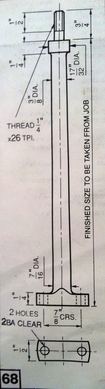

                                                    GarryC
                                                      @garryc

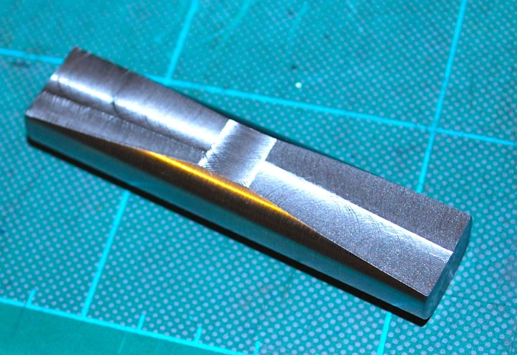

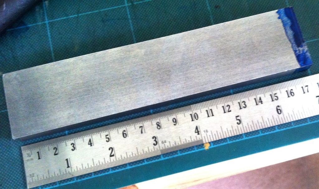

                                                      The Column Drawing.
                                                      and the supplied bar is just over 7 x 1.5 x 0.5 inches. Was going to try some Flycutting but again the supplied bar is found to be already slightly undersize.
                                                      To keep the machining to a minimum (as much is interrupted cuts) I cut off the excess length with a saw and thought I would grind down a bit closer to the line. Only the third time I have used the grinder – I've been lucky so far with buying tools as cheap as possible, but not this time – first time I've showed it a piece of serious steel…
                                                      Ah well what can you expect for £15… I'll need to get a decent one now, maybe not from Amazon this time though. I don't think its worth fixing as it'll never be up to any serious work.
                                                      I'm going to drill and cut away as much of the bar as I can before it goes on the Lathe.. Seems very wasteful.
                                                      One thing I was going to ask is whether going back 100 years or so it was common to leave centre drill holes in round bar ends or parts in general or were they usually faced out afterwards? I must get around a few museums and have a look at such things..
                                                      Cheers
                                                      Allan.
