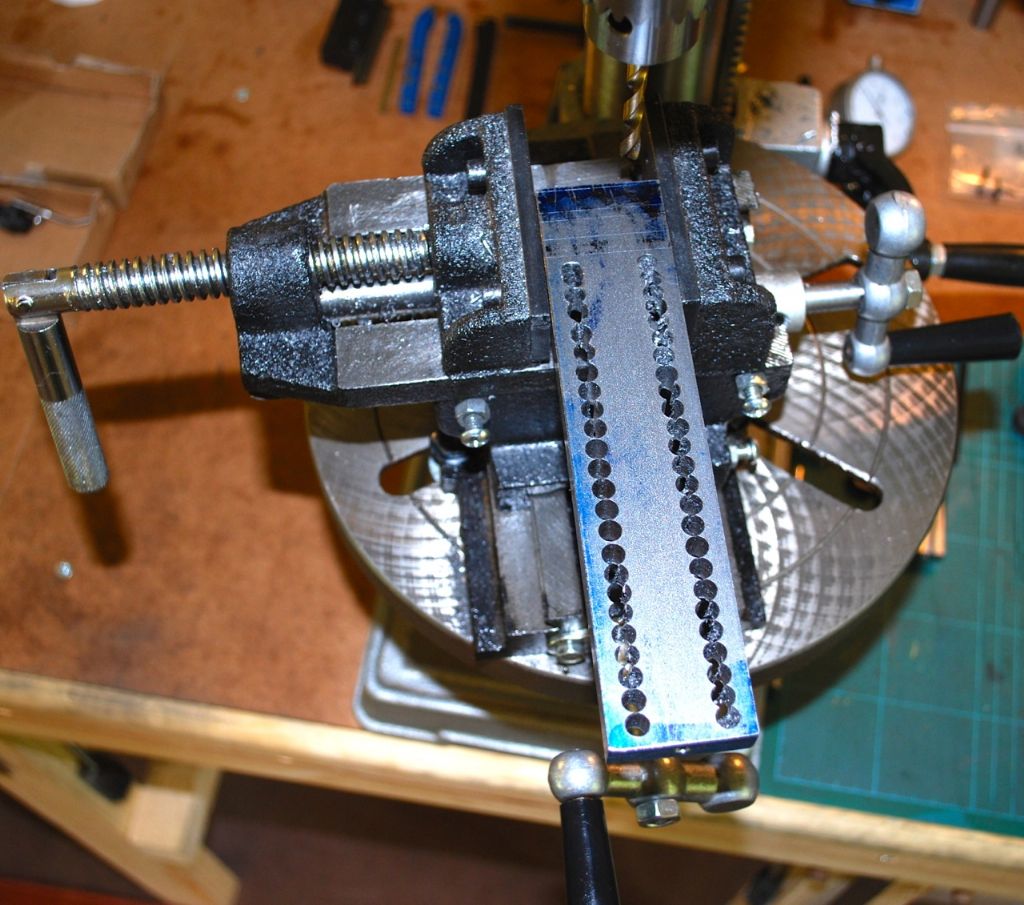

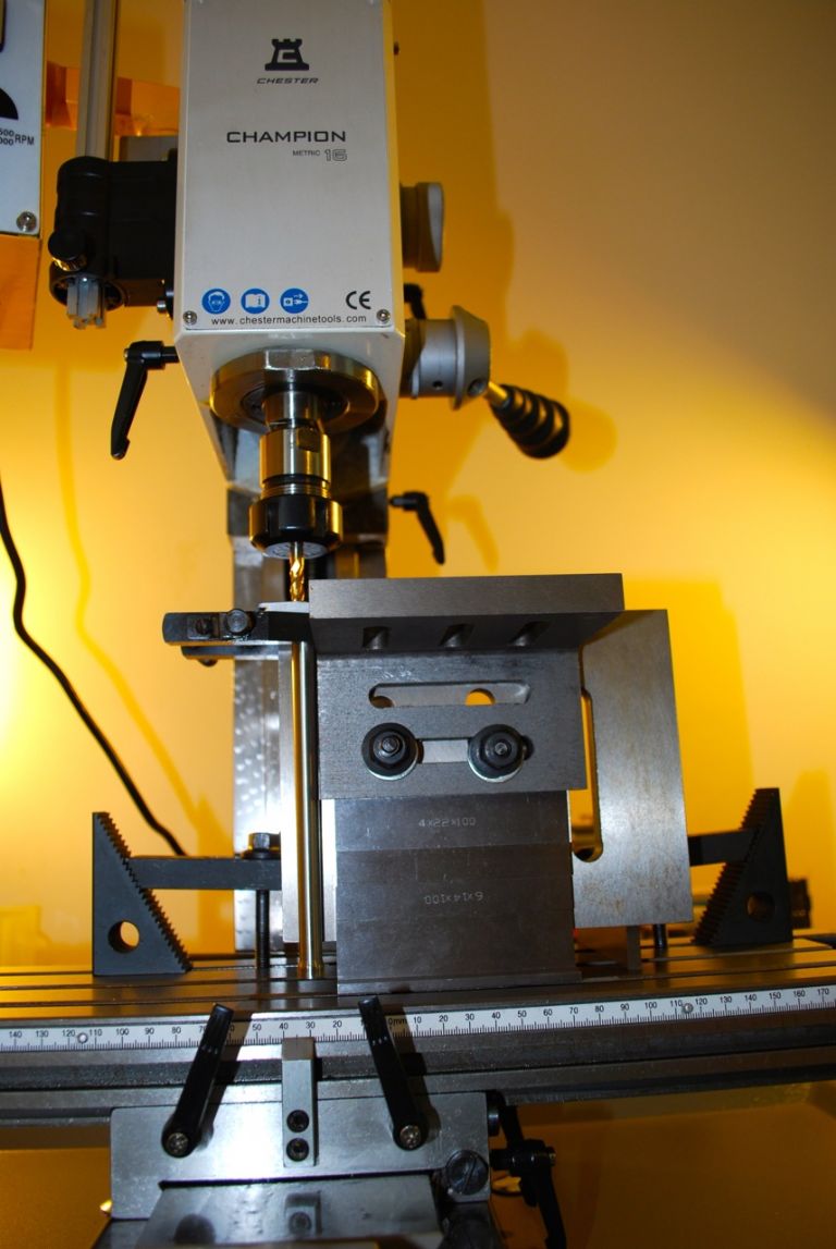

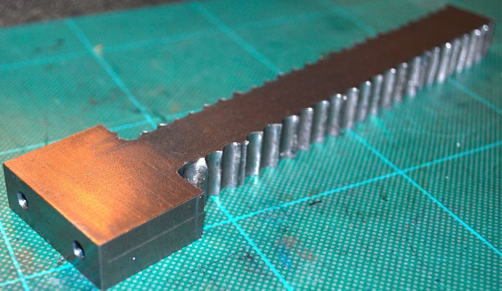

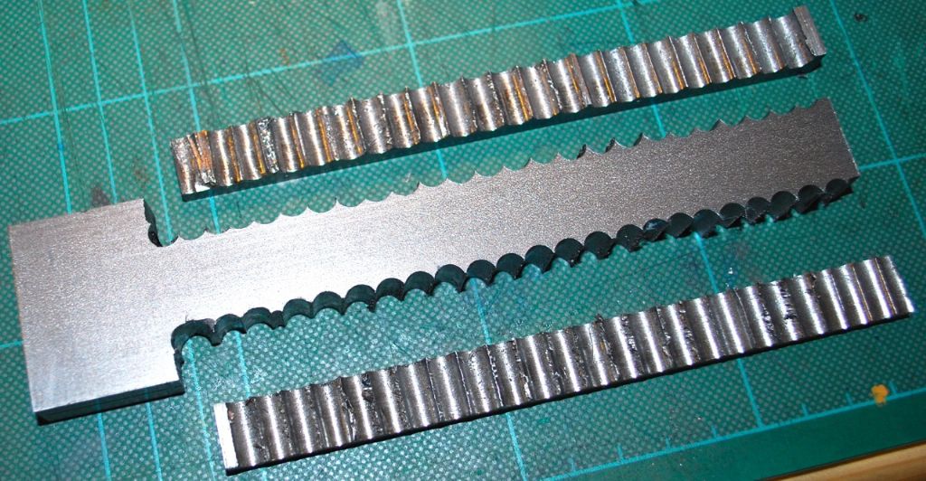

                                    I've decided to try the column from one piece putting a 1/4" BSF Stud in the top. If the supplied bar had been longer I would have tried to do all in one piece – but this way I have more to hold on to in the chuck. Thought I can use a steady on the 'collar' to support for drilling. I've already put in a centre and drilled the foot holes on the mill. So If I clock down the face when I put in the lathe I hope it will turn out ok – excuse the pun.. Have to cut away to size the foot at the end.
                                    Some photos's of the stitch drilling of the Column. I did it on the drill press and the Warco 'cross vice' was fine (I did remove the sliding jaw when it arrived and filed a bit to get to fit better though). I can see it would have been easier, quicker and much neater on the mill – but its good to spread the wear and tear around. I used the same 6mm drill bit for all the holes with no problem – its one from my cheap set, they average out at 29p each – what a difference it makes with a bit more knowledge and experience using them after all my early drilling woes. Held the drill as short as possible and didn't use a centre drill, just straight through with the 6mm – it didn't need to be very accurate. I'll get some stub drills though for the future.
                                    Had to move the bar along in the vice once or twice but all the holes were drilled in between the vice jaws (ie. not overhanging)..
                                    It didn't take very long at all to do and has saved lots of machining of the interrupted cuts on the Lathe. Well worth doing to say the least.
                                    Will probably try it straight on the Lathe now, if it seems a bit rough I can mill it down a bit..

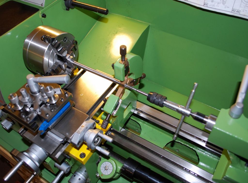

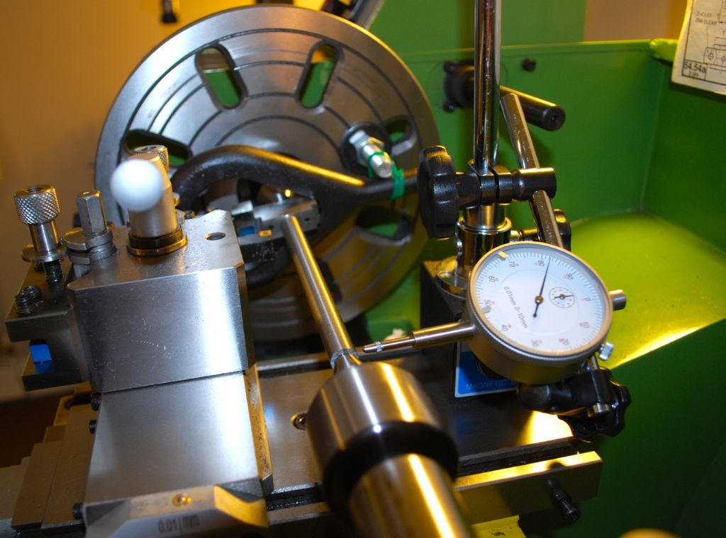

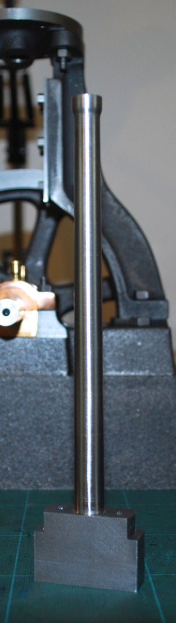

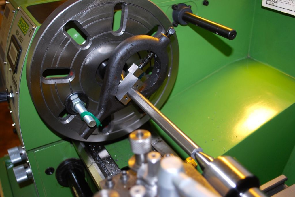

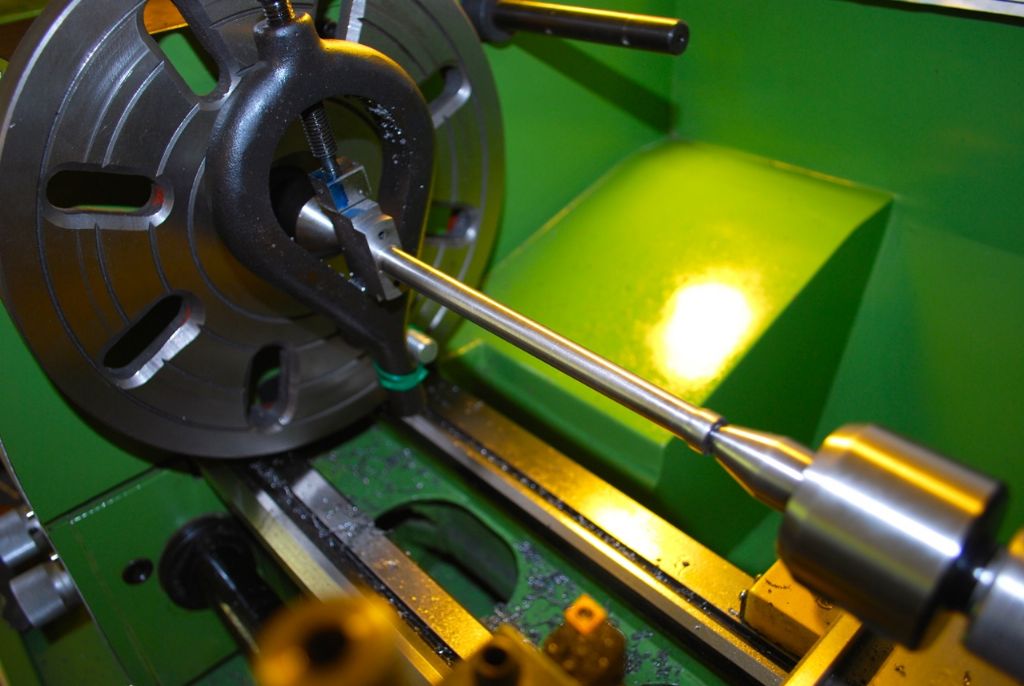

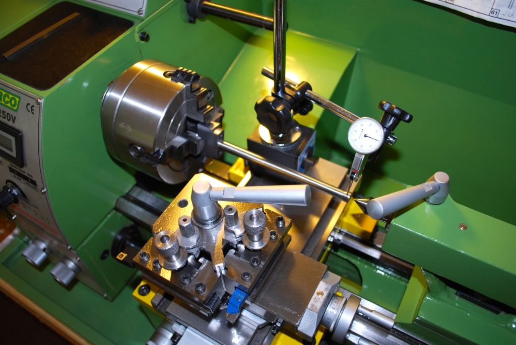

                                        A bit more progress today.
                                        After turning the diameter to 1/2" and rounding off the foot ends the tailstock was put over 0.8mm to do the taper. I know this does not need to be spot on but when learning its good practice to try and get as close as poss with all of it I think..281. putting the tailstock over for the column.jpg
                                        Turning the Column taper and very enjoyable and interesting as another first it was too (with the tailstock over). The finish looks ok with the eye but the camera makes it look not too good. I must get some HSS tools asap to try also some different types.
                                        The Column so far.
                                        No problem for the lathe doing the foot ends and was done in a couple minutes it seemed – its dawned on me that my first intermittent cuts earlier were with the crankshaft assembly which made it seem worse in that situation . The foot ends I did manually and the lathe steady as a rock..

                                          Just a bit more this morning..

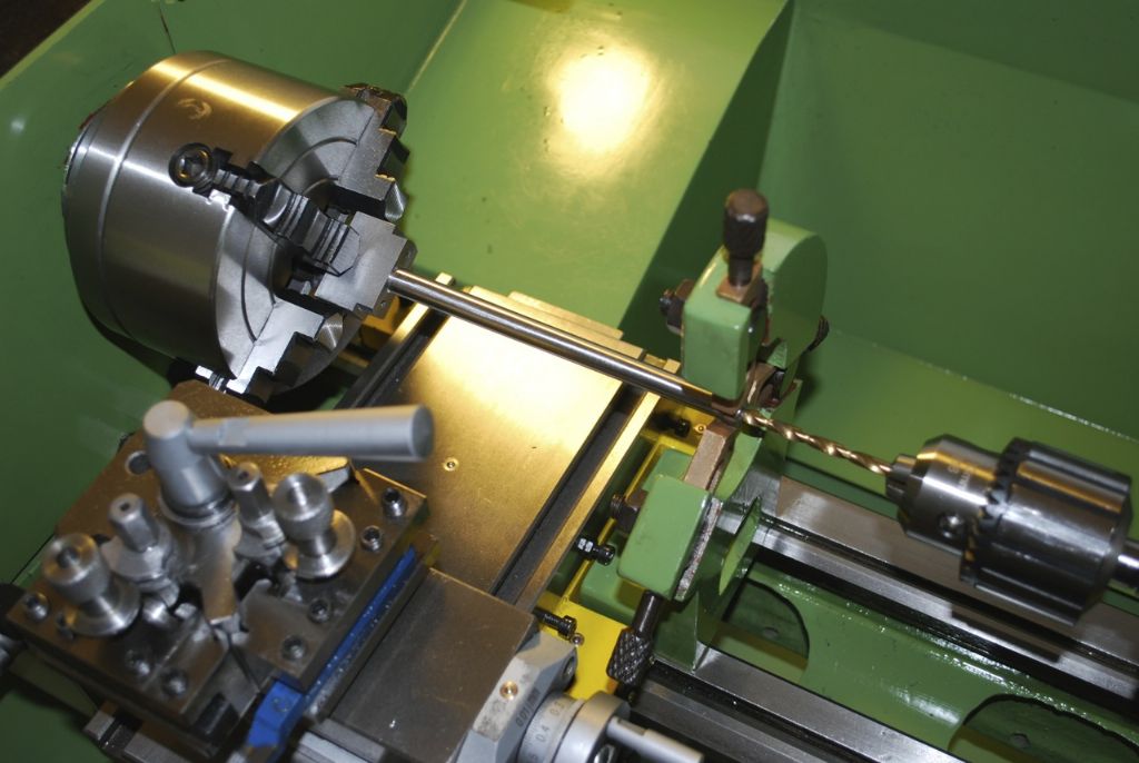

                                          After putting the tailstock back with the test bar the column went into the 4 jaw for drilling using the collar to set it up. Wouldn't be without the test bar now – have the lathe set with my ( cheap!) DTI showing no deflection at all along the bar now I did have it down to under 1 thou now its 0, great!
                                          Drilling for the 1/4" BSF Stud.
                                          and tapping..
                                          I'll need to run the thread down a bit more and maybe shorten a bit when it gets fitted.

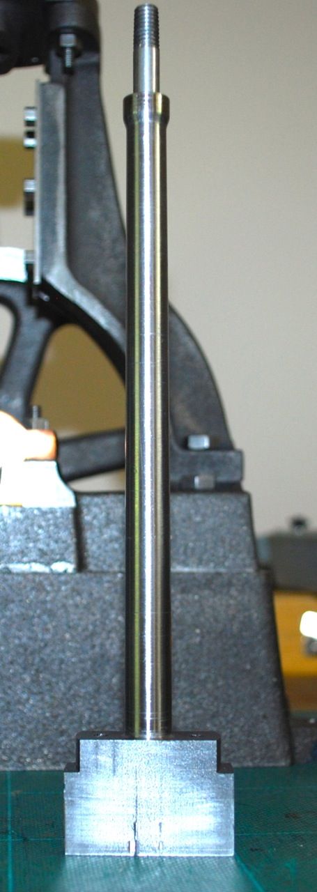

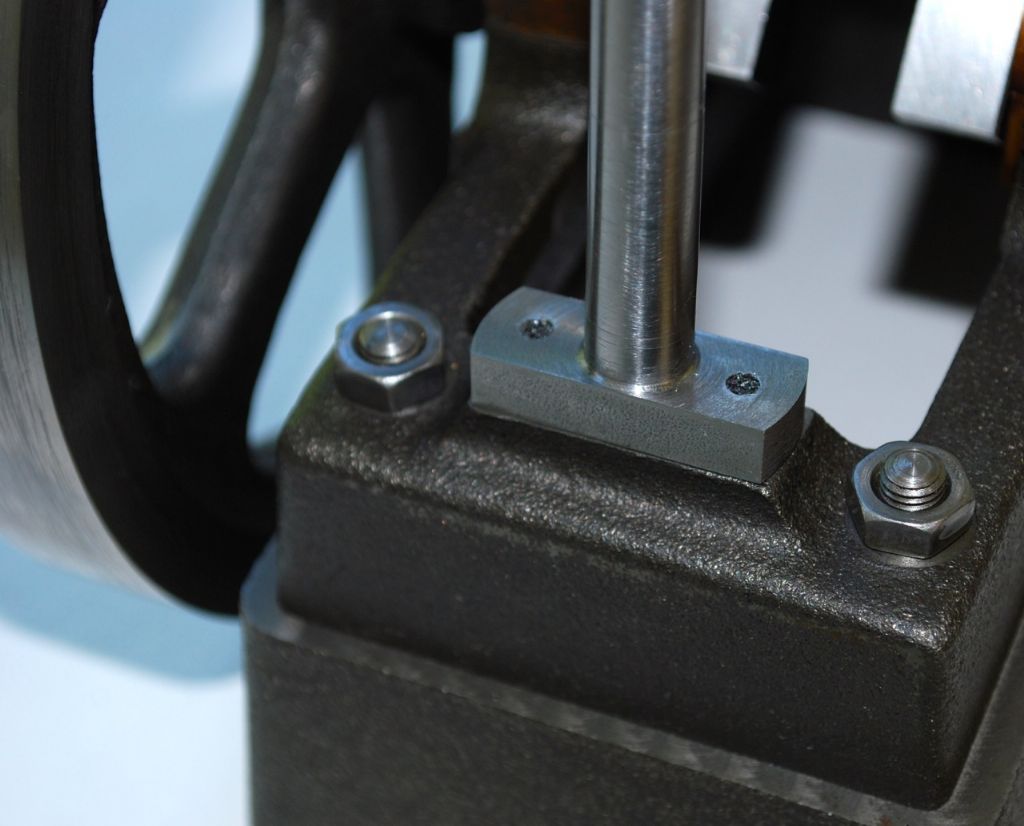

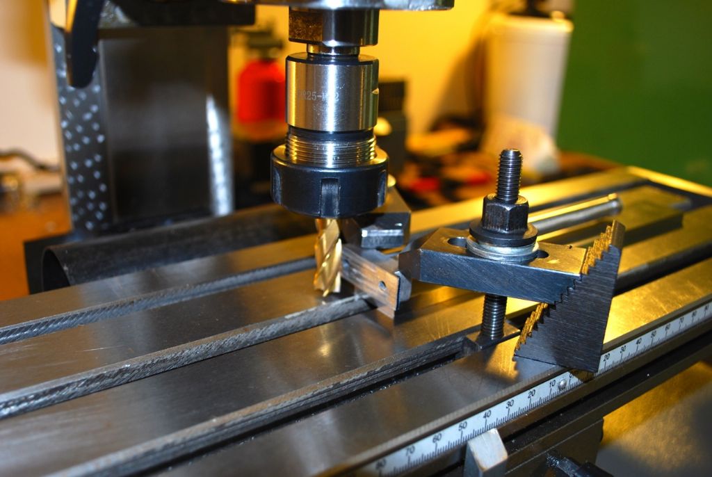

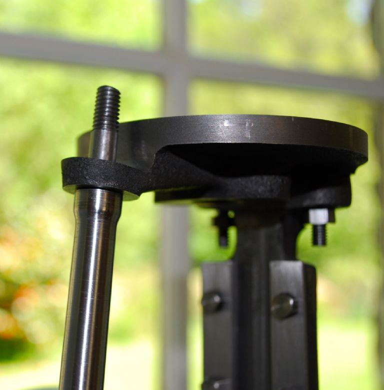

                                            Almost done with the Column now. Its turned out not too bad, not perfect (as usual) but looking ok, I'm tempted to say I'm improving but lets not tempt fate!..
                                            It was awkward to hold with the taper to do the foot and I didn't come up with a very good solution. The bottom face that had to be sized down was square for setting up but I there was a lot of material to come off and I wanted to cut it away with the saw but how to set it back square again to mill to size afterwards – gave me a headache. In the end I did as below with very very light cuts just to get the edge square again for a a different and more secure setup. I didn't realise just how tight you can hold with a little toolmakers clamp, impressive – so using the square upper face of the foot to set it square against the angle iron it worked ok…
                                            Then used the now square again bottom to side mill and that was fine. Taking the locked callipers for sizing checks it went straight off the table and onto the engine with a really nice close fit. That was satisfying..
                                            Its not perfect but looks ok. I'll extended the thread and shorten the stud when I'm fitting to the sole plate..
                                            Just waiting on a set of transfer punches to arrive now to fit to the sole plate.
