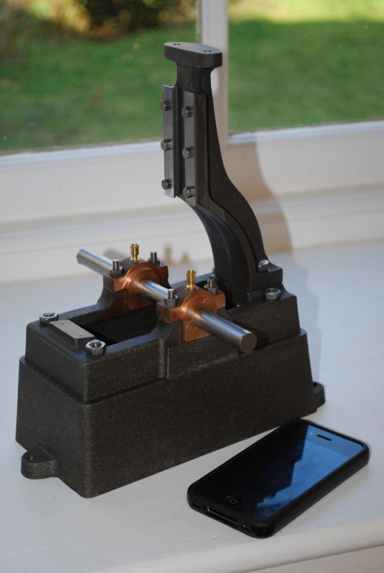

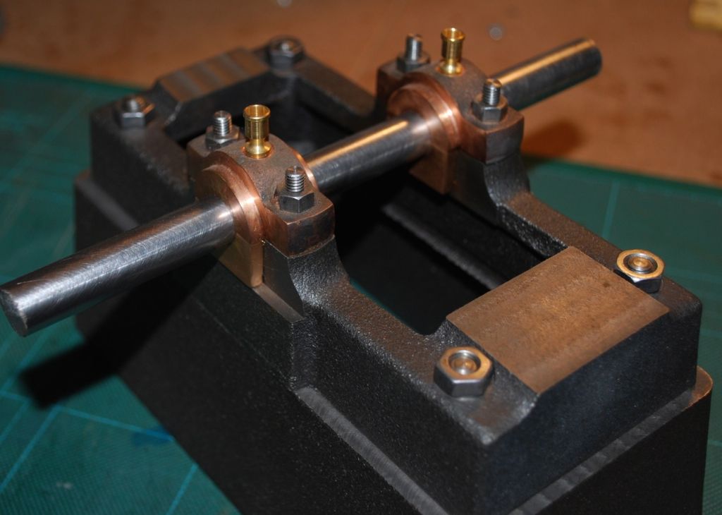

      Hope its ok to create a new thread here to continue with my ‘Stuart No1’ build.
      I’ve only just started with it really having some months ago done the Sole Plate, Box Bed, the Bearings and started some small work on the Crankshaft – for anyone interested details can be seen in a thread of the same name in the ‘Stationary Engines’ section of the forum.
      This is all I have done so far.
      Hoping other forum members will look in from time to time and point out my many shortcomings – I'm still very much struggling with the basics.
      Thanks.
      Regards
      Allan.

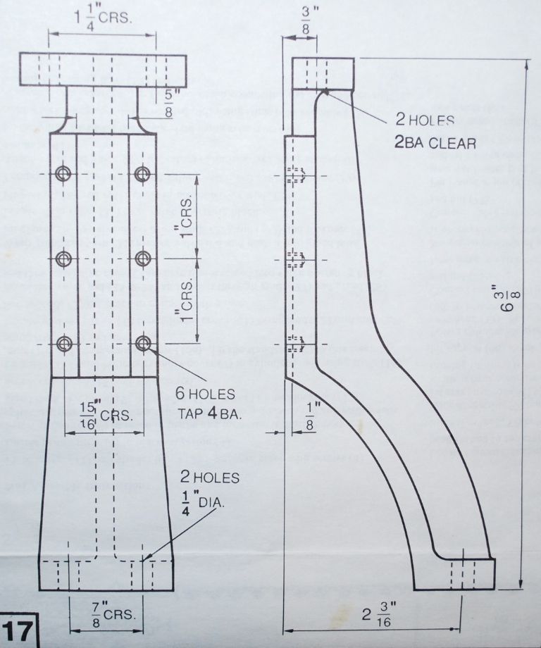

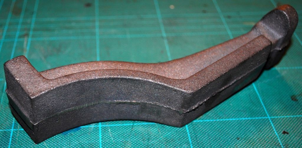

          I thought I would make a start / continue with the 'Standard'.
          The Standard Drawing.
          The Standard casting as supplied.

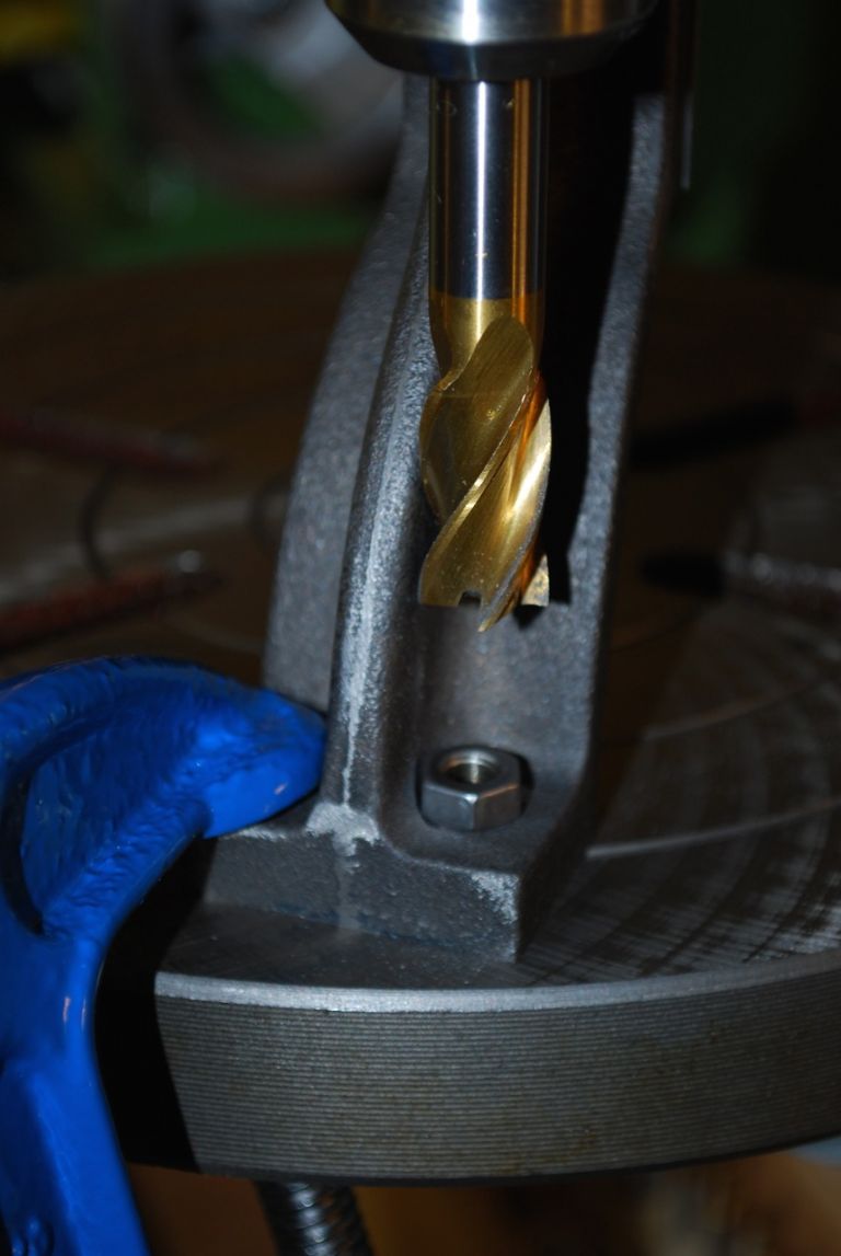

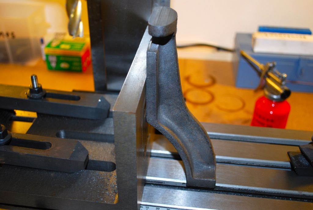

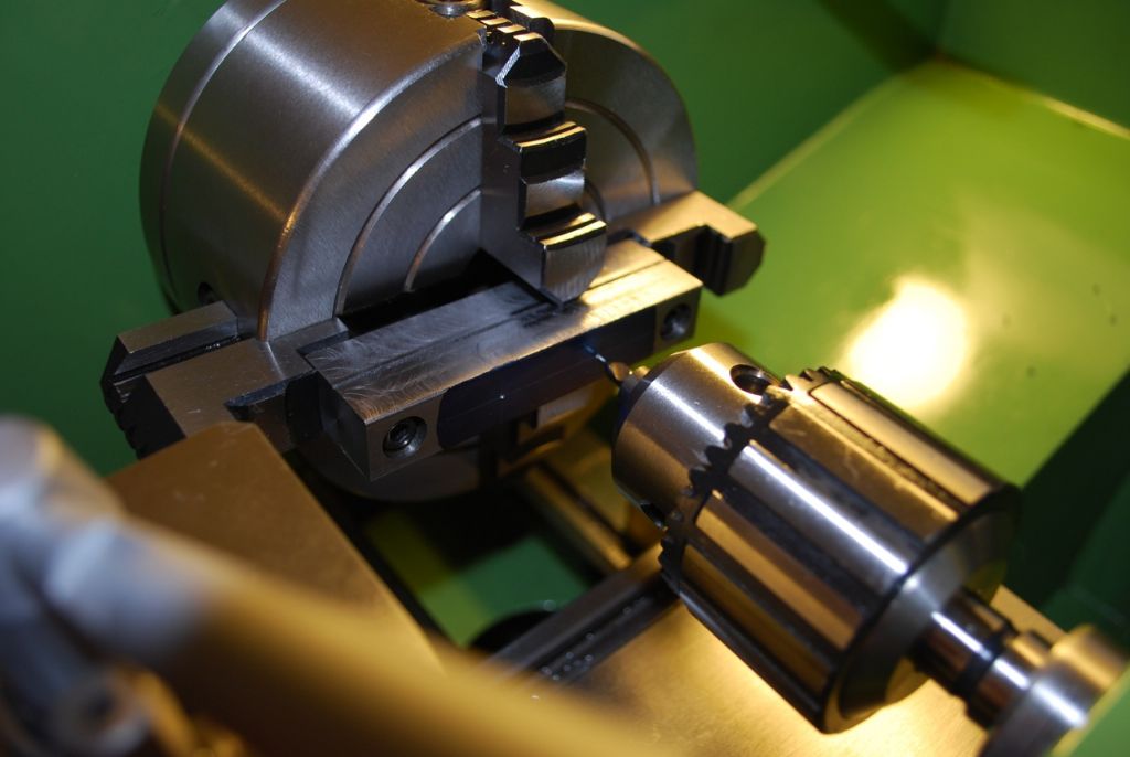

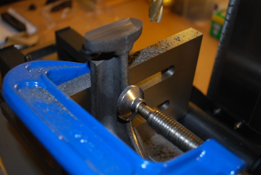

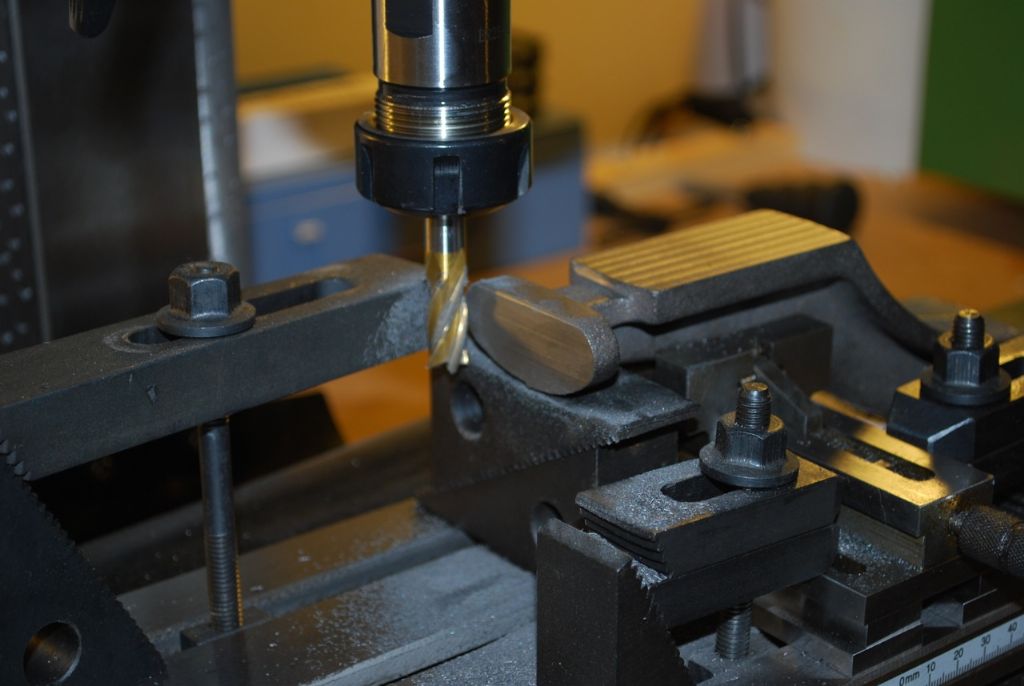

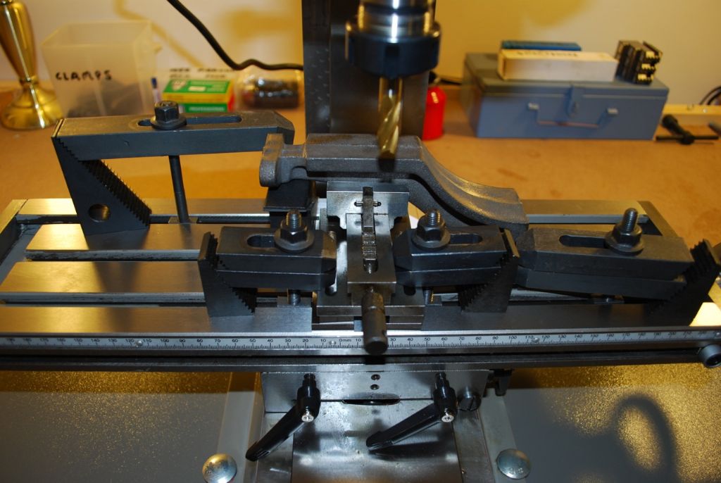

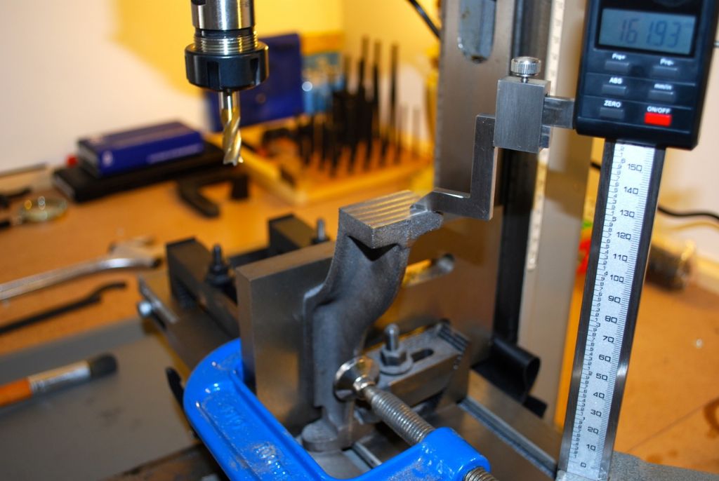

          Setting up to machine the Standard.
          I intended to machine the vertical face to size and then side mill around one of the horizontal faces to get the surfaces at 90 degrees. This turned out to be a mistake as the resultant horizontal face did not mill true, I think due to the tool deflecting, so I had to correct as below. (didn't help as the cutter was quite short leaving not much in the collet to be able to cover the work face, my fault of course for trying it).
          I still don't have a fly cutter, must get one – so I used a small end mill. The finished surface was nice and smooth to the touch, if not looking great.

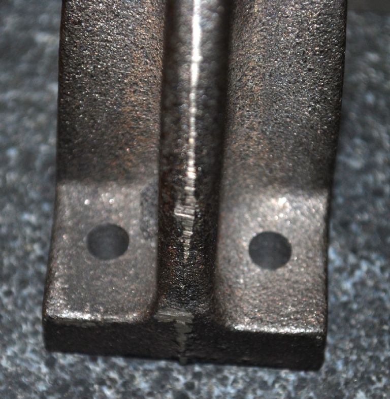

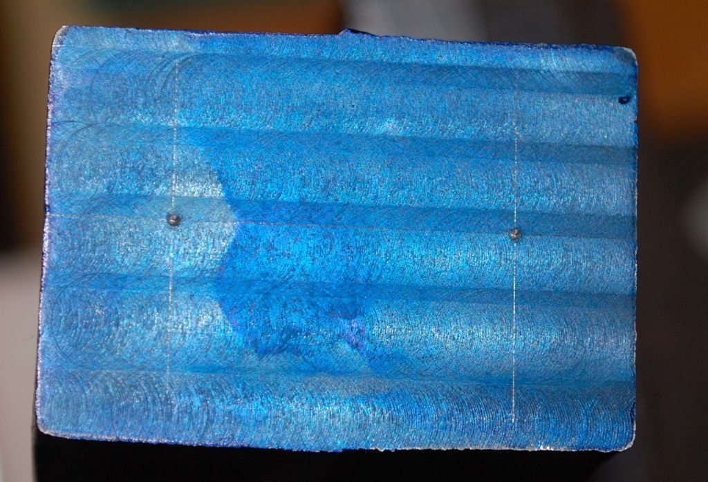

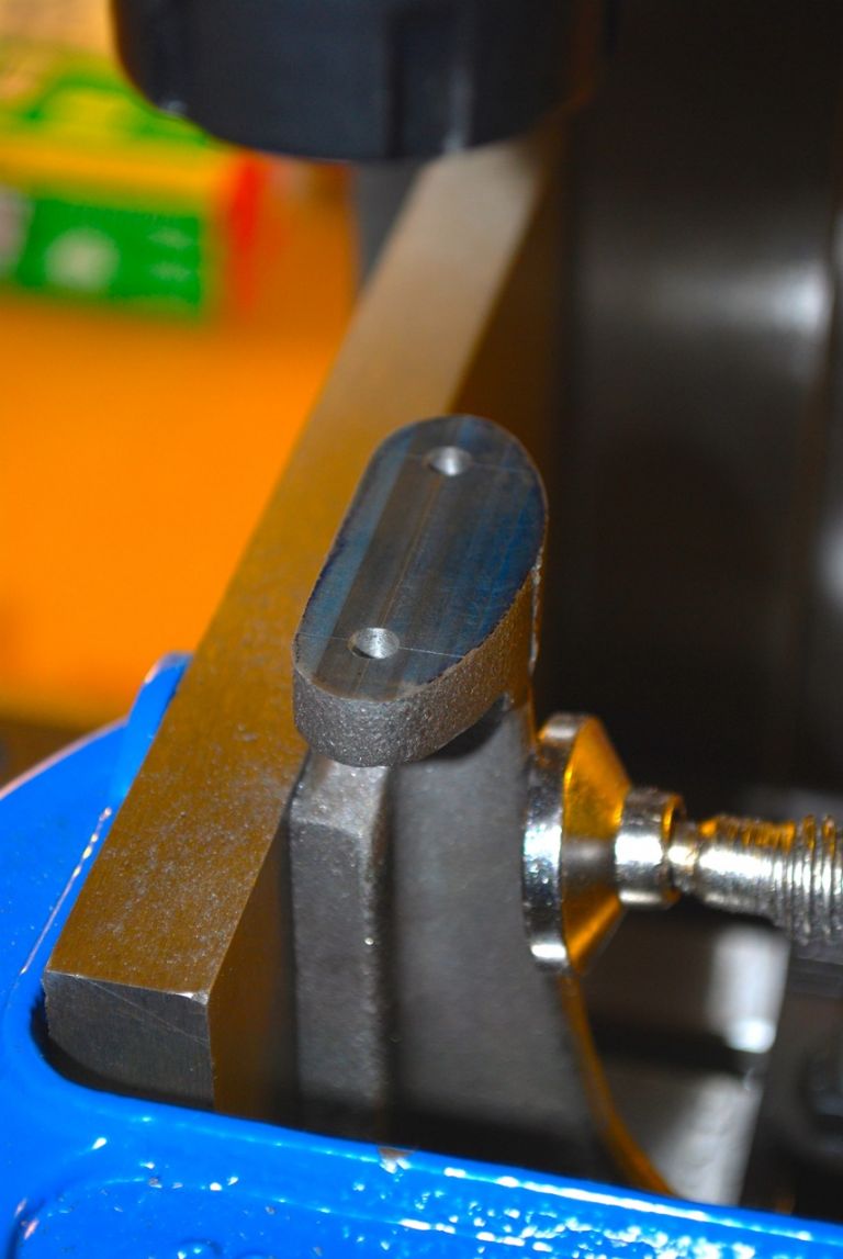

          This was a mistake – side milling.
          180. one of the horizontal surfaces lightly side milled to be in truth with the horizontal on the standard..jpg
          Showing the error after side milling – can be seen clearly when using the end mill here.
          Testing the face after correcting the error – perfect now..

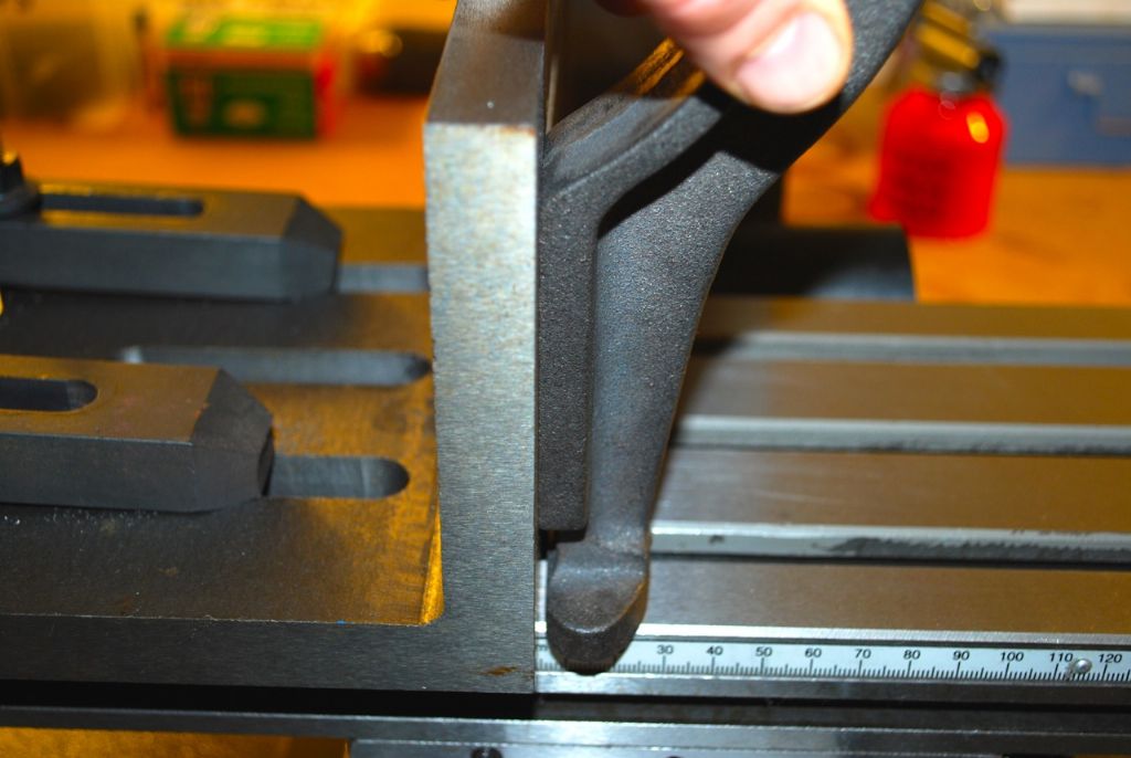

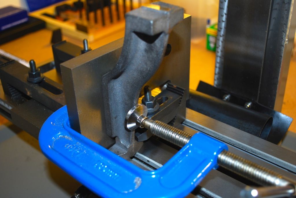

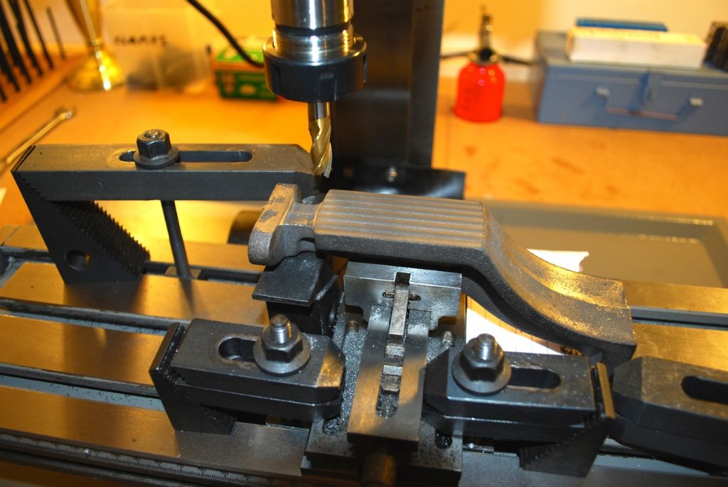

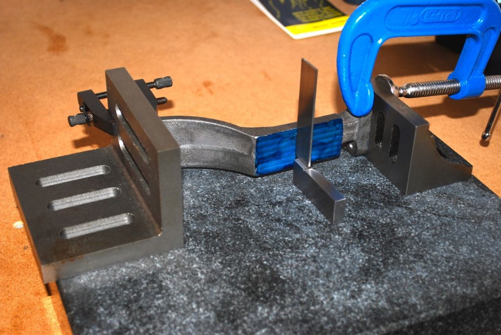

          The setup used to do the other end of the Standard.
          The Standard milled to length.
          Checking the other end of the standard – seems perfect.
          Any pointers and criticisms would be very much appreciated.

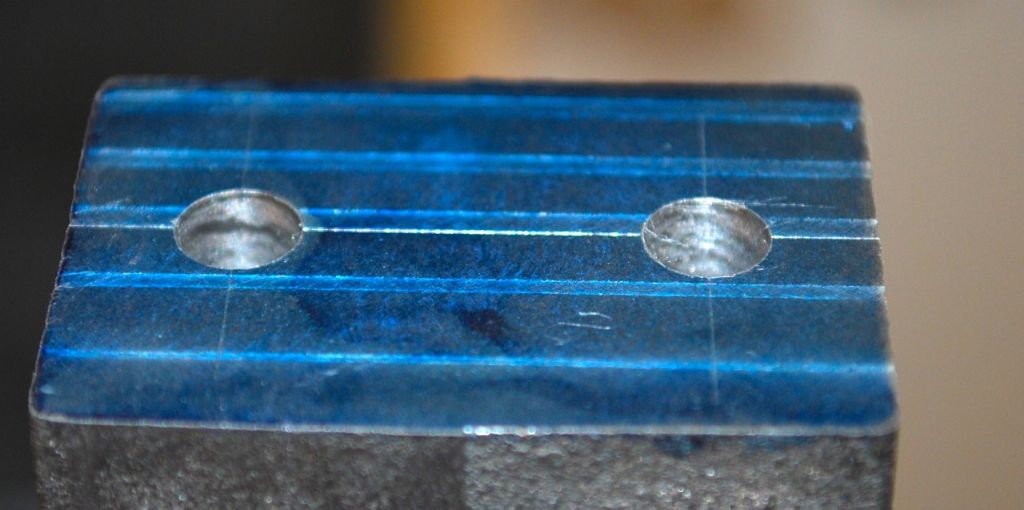

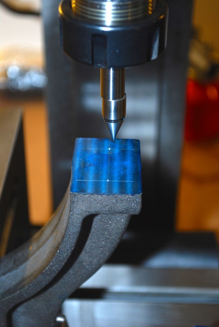

                        I've put in a little more time on the Standard today with some marking out and drilling of some of the fixing holes.
                        I found it a bit of an awkward shape to hold square.
                        The Punch Marks on the bottom of the Standard – one good one not so good I think. I seem to remember that with Victoria lots of the 'connecting' holes were able to be spotted through. These holes on the Standard have to be drilled separately and spot on (according to the book 'Building the Stuart No 1 I am following). Its easier to see in the photograph than when I was doing it – I could have pushed one of them over slightly If I had seen it was out..

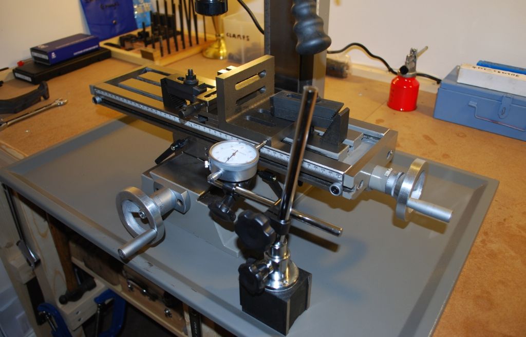

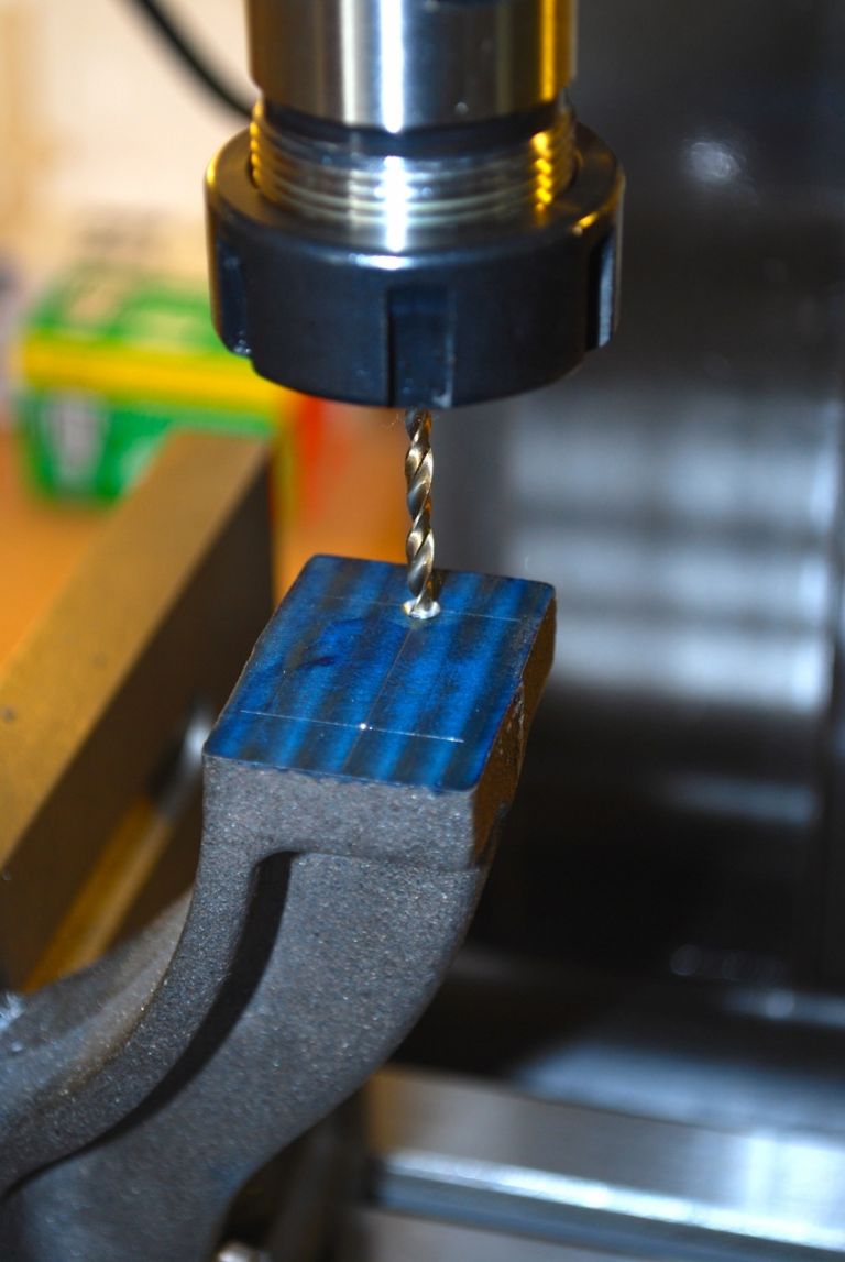

                        I've been struggling with hole placement from the beginning – so I've recently bought a Centering Indicator to see if it will help. I couldn't use in on the Standard ends though as my Mill was not 'deep' enough. No point though unless I can get the Punch Marks right in the first place.. Looking forward to having a go with it soon though.
                        So I used a more basic Centre Finder.. This does a good job as well I think.
                        Drilling the Standard – I used a Centre Drill then 3mm, 5mm and 1/4 inch drills.
                        The two 1/4 inch finished holes..
                        193. the two 1:4 inch holes drilled in the standard..jpg
                        The two 1/4 inch holes from the other side of the Standard. I was wondering about spot facing them as its difficult to get a drill / mill in from that end due to the central web – but on checking the nuts seem to sit nice and lie flat as is..
                        I took the advice of the book and increased the hole ctrs from 7/8 inch to 15/16 inch to allow a bit more room for the nuts, good thing I did I think. Have to do the same when I drill the Sole Plate of course..
                        194. the two 1:4 inch holes drilled in the standard 2..jpg
                        Hoping again some will find it interesting..
                        Regards
                        Allan.

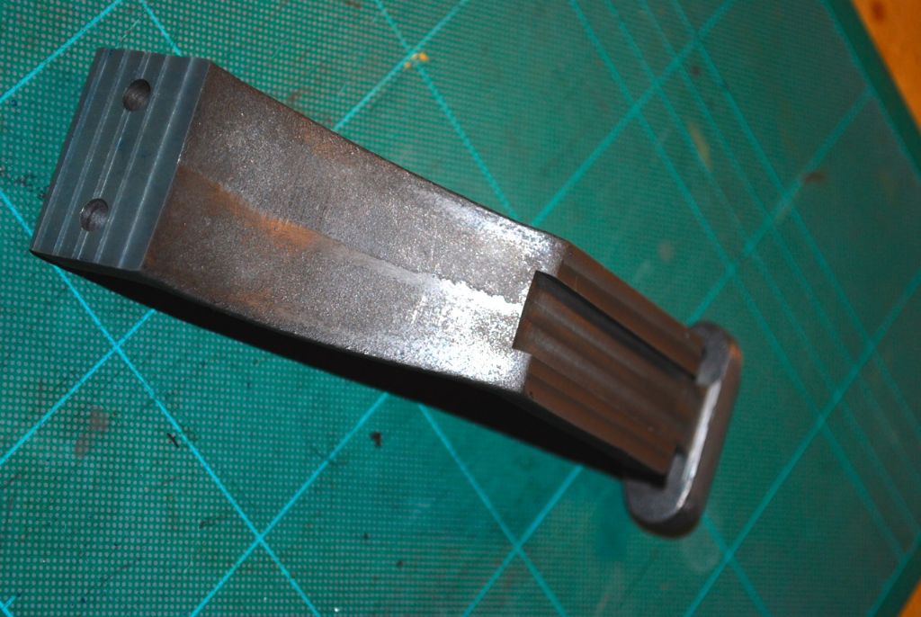

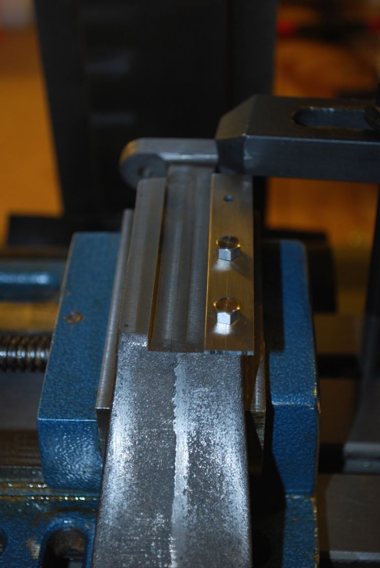

                              A bit more work done on the Standard today – as much as I can do I think for a while on that now, the 4BA holes I'll spot through when I have done the Guide Plates.
                              The 2BA holes in the top I've done today, using the same set up as for the bottom holes.

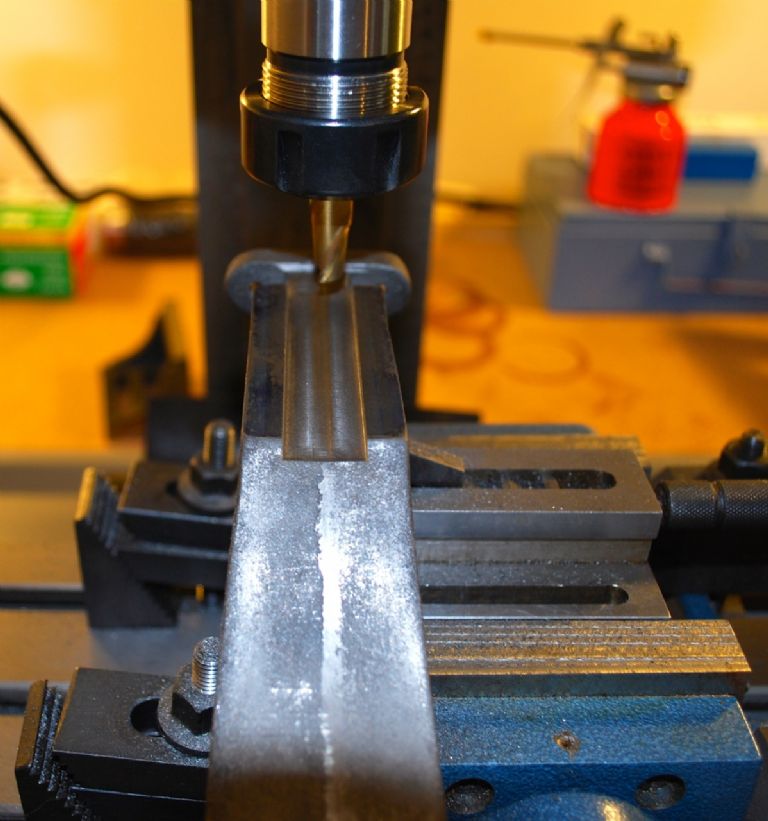

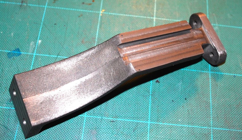

                              Marking out the channel for the Crosshead in the Standard.
                              Milling the 5/8 x 1/8 inch channel in the Standard. Used a 10mm Slot Mill and have ended up 1.4 thou under depth so I can skim that again if need be – but 4 thou over width.. I guess I can allow for that when I make a the Crosshead..
                              The Standard so far 1.
                              The Standard so far 2.
                              Regards
                              Allan.

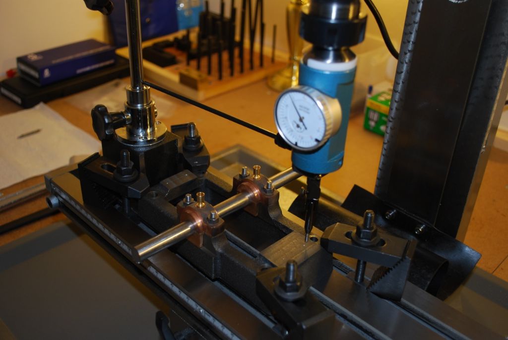

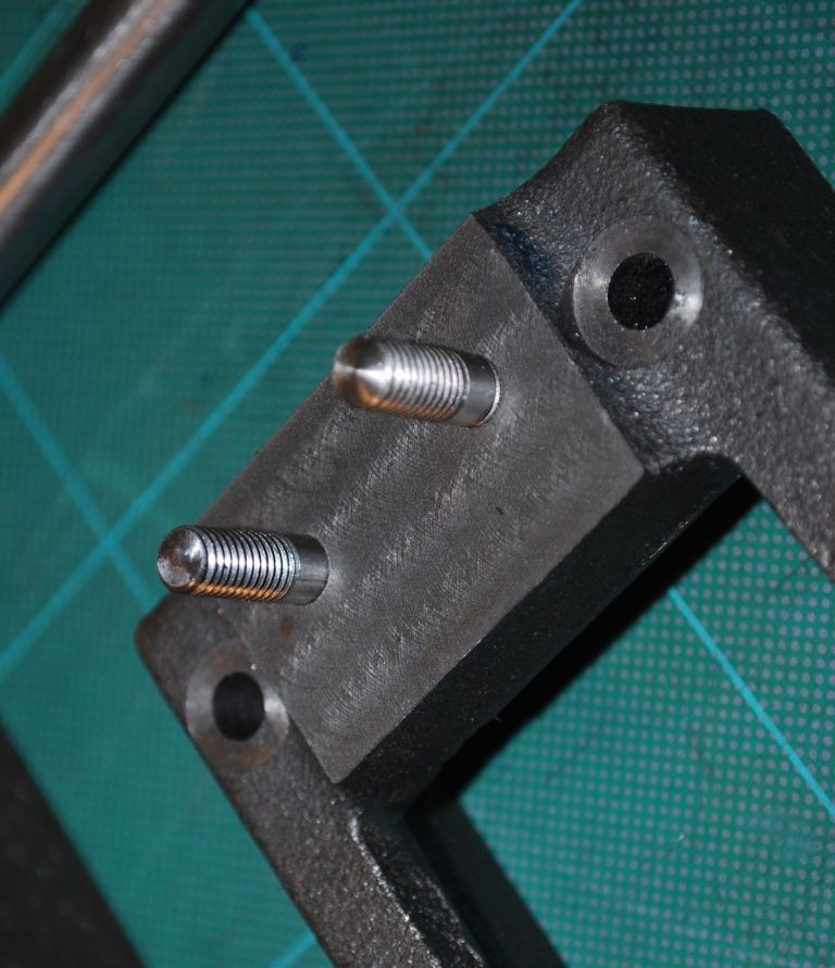

                                Time's not been my own this week, back to normal now I hope. So I've not made much progress….
                                I've marked out and fitted the fixing studs for the Standard.
                                The Centering Indicator has been a bit of a revelation for me and since using it holes have been perfect – to my eye anyway, well pleased and its nice and easy and quick to use. I enjoy drilling much more now…
                                The fixing studs for the Standard in the Sole Plate – measured from the centre of the Crankshaft.

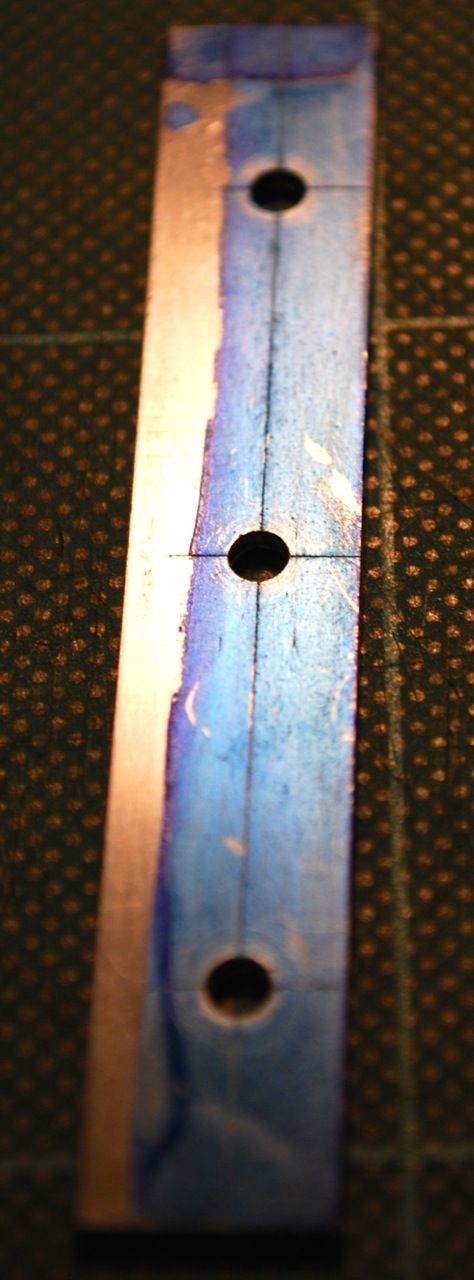

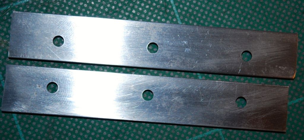

                                One of the Guide Bars marked out and drilled.
                                Both Guide Bars drilled 4BA tapping size, ready for spotting through onto the Standard.
                                The Guide Bars so far – one almost fitted. I will file to size to suit the Standard after they are both in place.. They need to overlap the channel sides by 1/16" to leave 1/2" for the Crosshead.

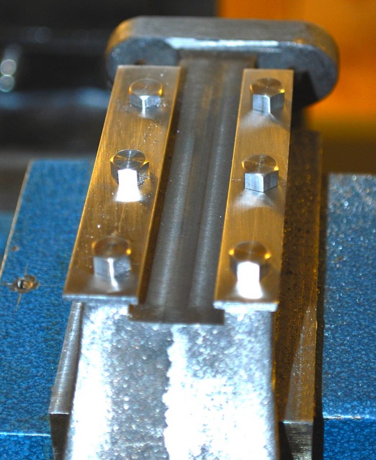

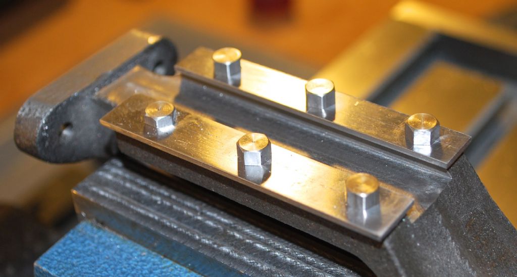

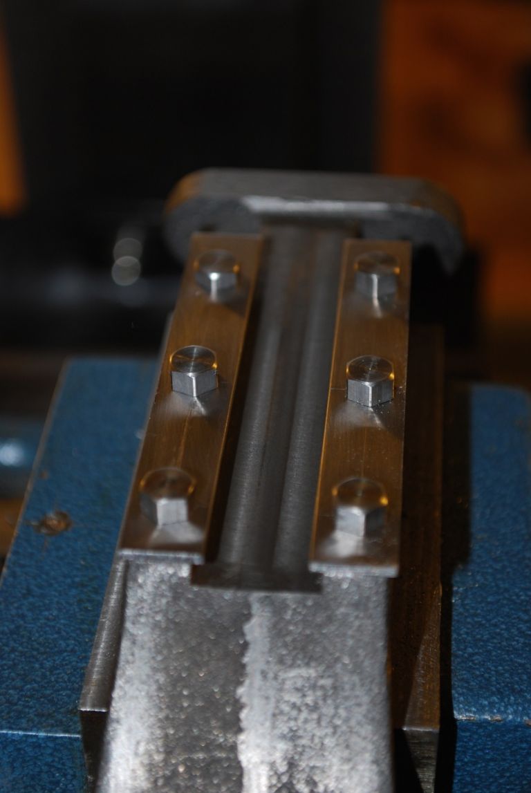

                                  Just a bit more time spent on the Guide Plates today..
                                  Finished drilling the Standard for them. They just need filing to size… [Screws not tightened in the photo].
                                  Found I was short of one of the 6 4BA screws and had an 'odd' one in the pack with the head at half thickness (top left one in the photo) – emailed Andy at Stuart Models to see if he would send a replacement or would I need to order one. Had a reply within 5 minutes to say he had put a couple in the post (foc) – can't beat that for a response!
                                  Have the right (in the photo) Guide Plate filed to size now I think…
                                  Just another view 1. Showing the 1/16" overhang.
                                  Just another view 2.
                                  Sorry too many pics showing the same thing again I'm sure..
                                  I make it a 4 thou difference in the channel width between the Guides end to end at the moment. So dare say will need to softly run a file down them when fitting the Crosshead later..
                                  Regards.
                                  Allan.

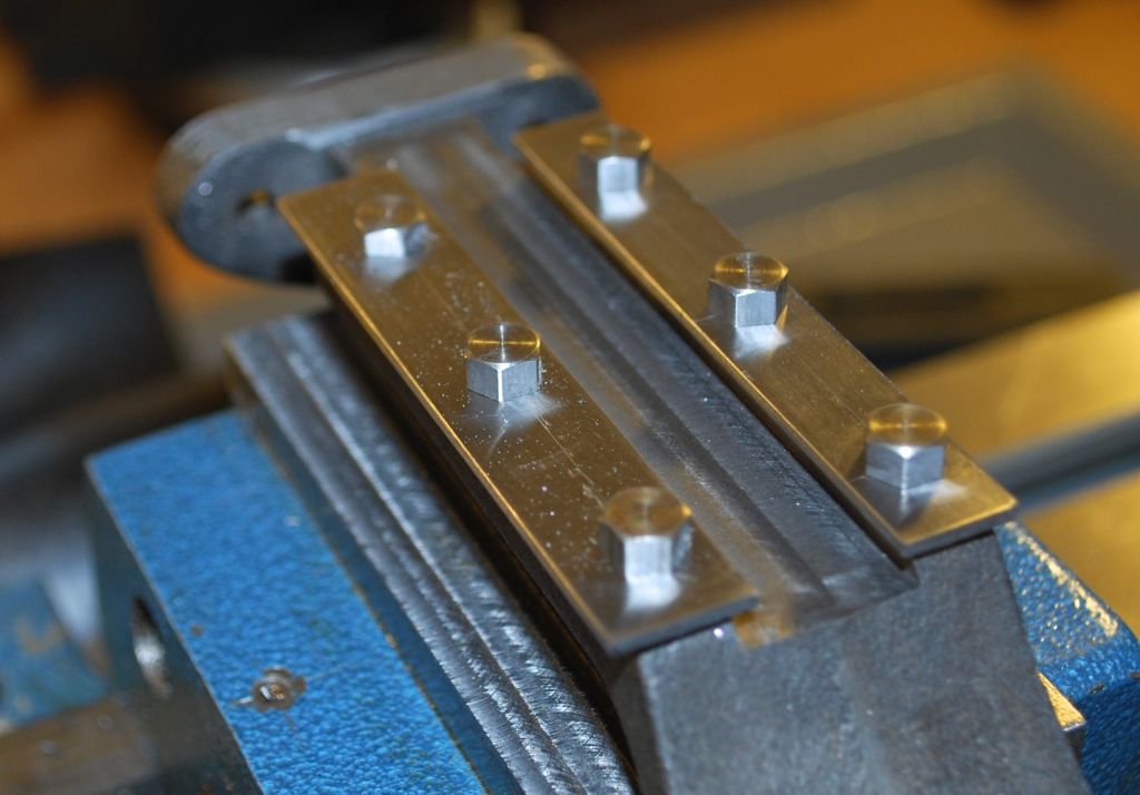

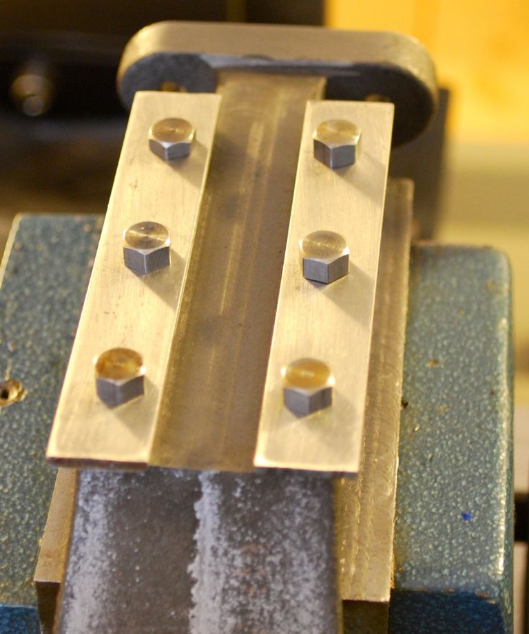

                                    Guide plates finished today and the Standard in place.
                                    Going to have a go at the Crankshaft next and looking forward to it. I'll probably struggle with it and may need a few attempts though – I won't inflict any more of my misdoings on the forum so will post again when I have some success.
                                    Its a great project, really enjoying it…
                                    The finished Guide Plates. (The replacement BA screw has arrived & in place since this pic).
                                    I was wrong about not having to spot face the Standard. The only way I could do it with what I have was to use an end mill in the pillar Drill going as slow as possible. It only needed a slight touch and has done the job ok though – not much room due to the central web of the Standard – couldn't use the Mill.
                                    Progress so far..

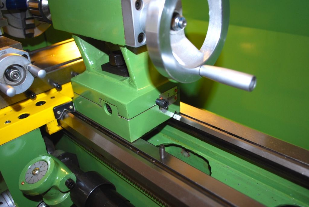

                                            Just a little update to say that at last I'm now ready to start the Crankshaft. Been spending some time first in getting used to the new Lathe, a Warco WM250V which I think is brilliant… My previous tiny Sieg SC4 was also a great machine but this seems like a good step up, although its still a little un – I'm really pleased with it.
                                            Its taken some time with some difficulty in setting it up and testing – I couldn't work out for ages what was going wrong until only this morning I realised that the tailstock was moving around intermittently. There was a small (and cheesy) M6 grubscrew in the back of it to secure the offset setting and it was just not up to the job (on mine anyways) and once I replaced it with a cap crew that could be tightened properly all was fine and completely solid. Lovely smooth and quiet motor, heavier built and with more facilities than the old lathe.
                                            Tailstock Grubscrew (back end) replaced with a Cap Screw. (Original grubscrew on the bed).
                                            All I've done so far is to get the Crankshaft Webs screwed and machined together and I've made one of the two throwplates… The screws holding the Webs together will be cut away once drilled and reamed.

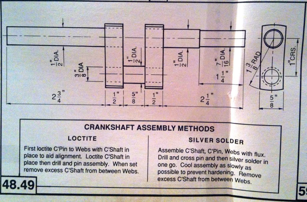

                                            The Crankshaft Drawing.
                                            I'll use a new piece of bar for the shaft so that I can turn all in the same setting (not the one I already have to the larger diameter size)..

                                                    @garryc
                                                    Thanks All.
                                                    Will do Martin.
                                                    Neil, yes the g-clamp can be a bit iffy sometimes I agree – I only had one toolmakers clamp until recently (just bought one to try out), they are definitely really useful and I've got a couple more now..
                                                    Jason, I've got some Loctite 638 which I hope will be ok (and will pin).. I don't think I ever moved the tailstock offset on my Sieg – I'll be keeping a close eye on it now for a while thats for sure – and make sure everything is tight, although since I replaced the end screw no probs at all, and its all very nice and smooth to use in comparison to the old one..
                                                    Cheers.
                                                    Allan.
                                                    #183512
                                                    Ian S C
                                                      @iansc
                                                      Toolmakers clamps are a good exercise for a beginner in the workshop, I made mine from some salvaged 1" high tensile bolts, machined them to a square section, cut the threads on the lathe, I used 3/8 UNF. I think it took an afternoon to make a pair.
                                                      Ian S C
