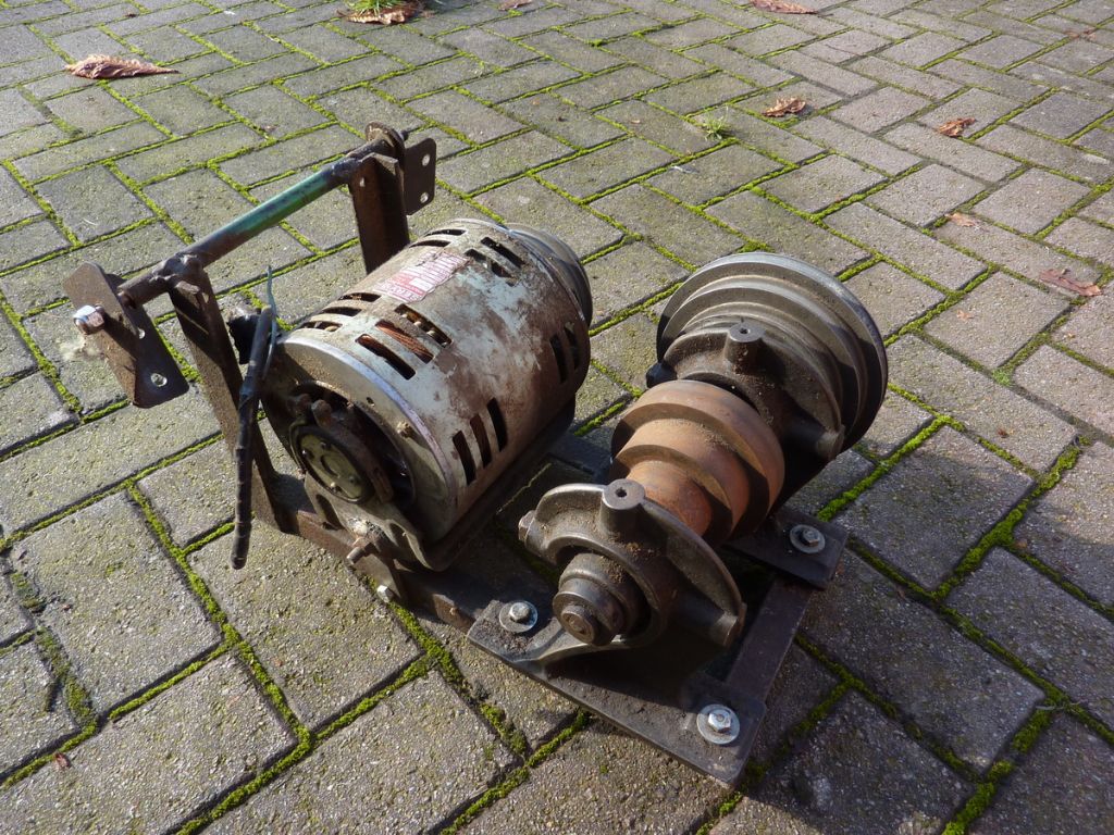

        I suspect that Century were active in the UK and made motors specifically for this market. Scanning around the net also turns up examples in Australia.
        There are design variations in these motors. One is only visible when you take the thing apart – the arrangement for tensioning the spring in the middle can be either a threaded collar with a locking clip or a (probably cheaper to make) simple 'C' shaped collar that fits into one of a choice of slots cut at intervals along the shaft. Mine has the latter which I think is a later cost saving arrangement.
        There was one on eBay recently that has a slightly different casing – the three holes at the top of each end housing are omitted – presumably this reduces the amout of crud entering the motor… albeit at the cost of looking less stylish. My guess is that this is a later change. By the late 30s the casing was changed completely to something more sleek and less fussy. Shades of art nouveau vs art deco… if you can apply either term to motor design.
        So my guess is that my motor sits somewhere in the middle of the time range… but it really is just a guess.
        The lubrication arrangement also varies. Some have oil rings and some have wool packing. Mine has the latter but whether this tells us anything about date is not clear to me.

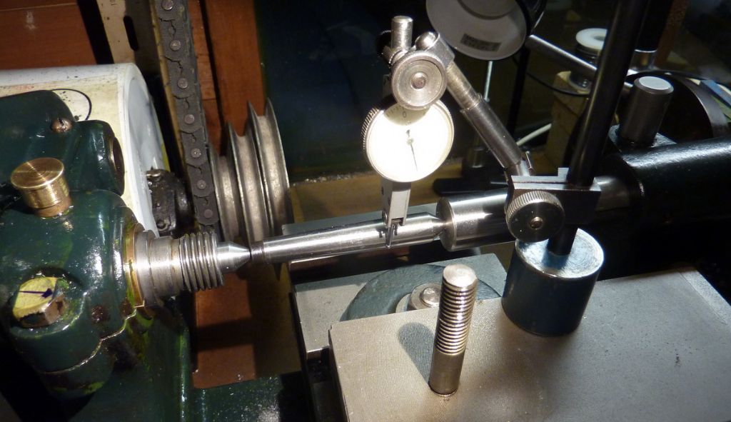

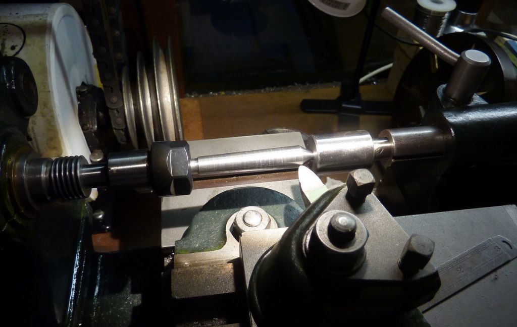

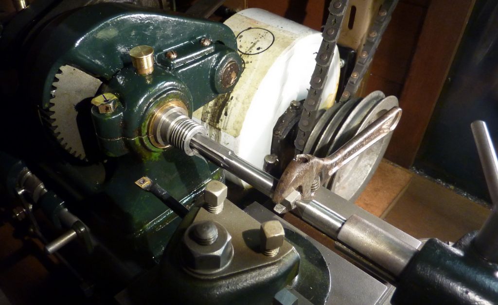

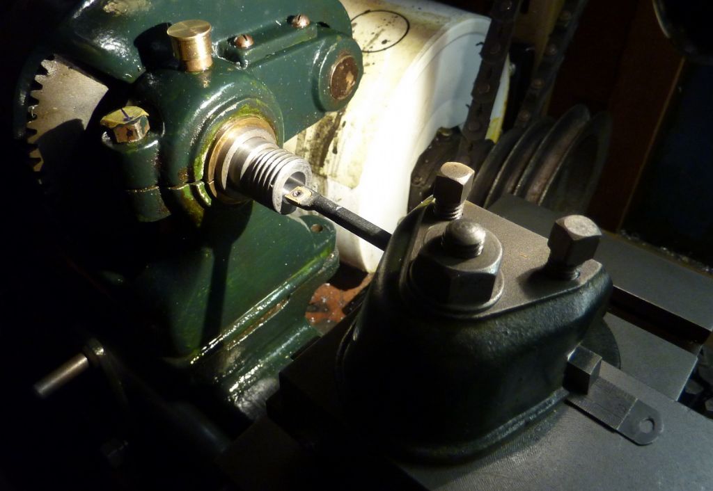

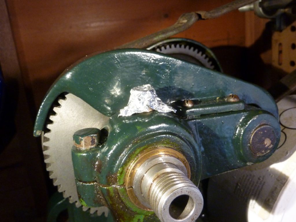

                        Now that the weather is warming up I've bitten the bullet and sorted out the damaged spindle taper on my Faircut. In the end it was much more straightforward than my previous job making a 'mystery taper' centre, probably because I can start setting up by clocking a known MT1 centre…
                        Actually that wasn't quite the start. First I had to carefully check and adjust the headstock and tailstock alignment. The headstock alignment tends to go out of adjustment when I do any milling because it's only held by a single central bolt. There is also a hole for a locating pin that should help it to stay put… when I get around to making a new pin.
                        Then the RDG boring tool was used to lightly bore the taper, taking light cuts progressively until the tool was cutting along the whole length of the taper. This left some scoring – maybe pre-existing or maybe because of tool chatter (the overhang is pretty big).
                        Finally the MT1 finishing reamer (from Chronos) was used until the taper looked nice and smooth. There is still a little scoring visible some way down the taper but I didn't really see the need to continue until all scoring was removed – I can always come back for another go.
                        I then made a drawbar for my cheapy Chinese MT1 ER16 holder which now fitted in the taper and clocked at sub half a thou of runout. While the compound was set up I re-cut the taper on my home made soft centre using the ER16 holder and a stub arbor to hold it. I really need to make a new one because this one now slightly disappears inside the spindle.

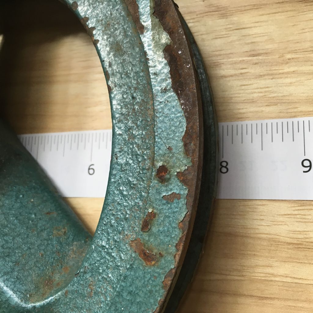

                                                I still need something like a 7 or 8 inch vee pulley to replace that 4 step Picador one.
                                                Regarding the pulley … What belt section do you need ?
                                                Hi Michael,
                                                The belt measures 13mm on the thick side, so I assume it is an 'A'.
                                                Regards, Andy
                                                Apologies for the delayed response, Andy … I failed to notice your reply blush
                                                I have ‘safely stored somewhere under the bench’ a very good quality pulley, which I think might be just what you need.
                                                I will dig it out and post a photo later

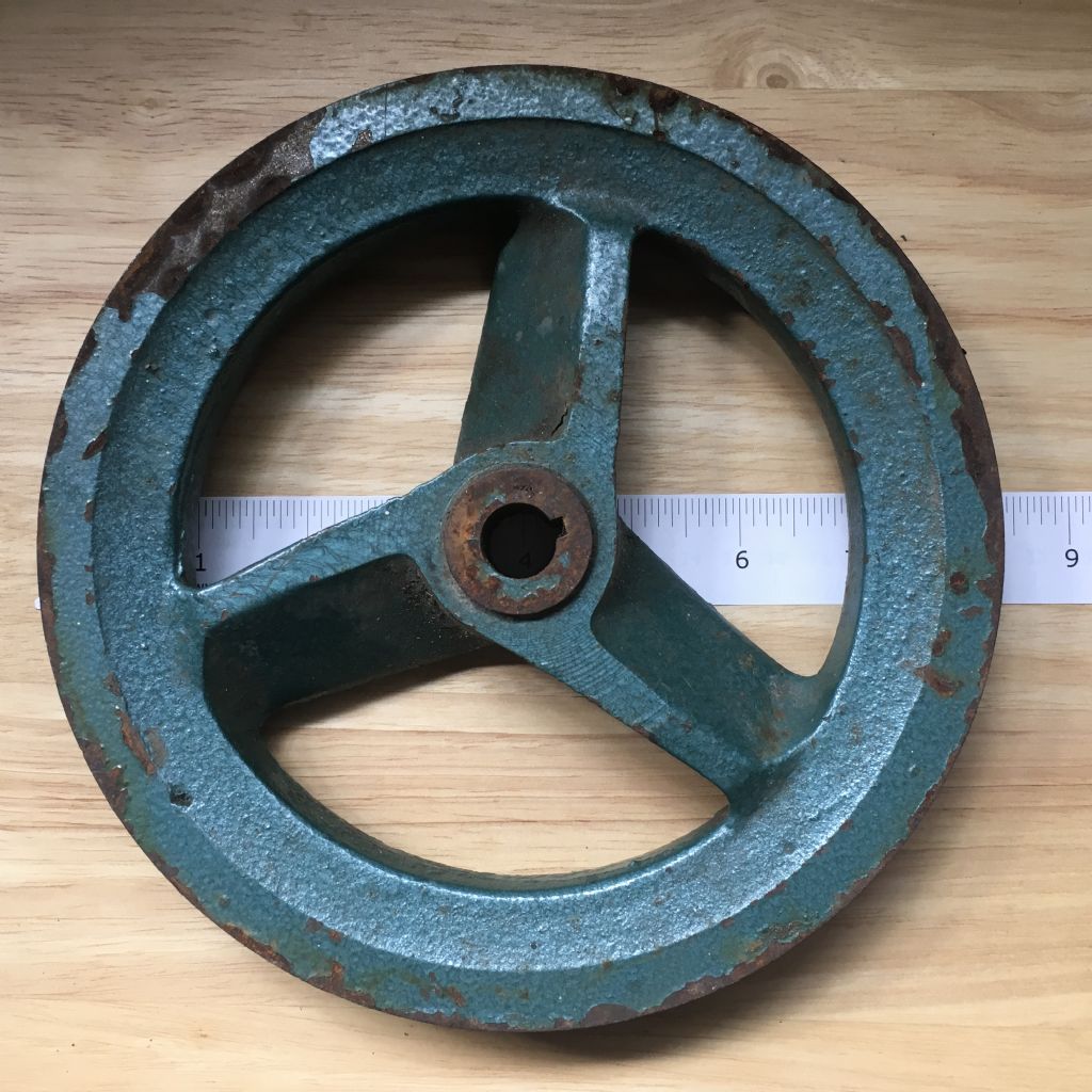

                                                #469811
                                                Andy Carlson
                                                  @andycarlson18141
                                                  Posted by Michael Gilligan on 07/05/2020 11:56:17:
                                                  No worries Michael – thanks for the msg. When you find it can you please let me know the OD and I will check whether it will fit in without clouting the shed wall. I can mess with the flat belt length a bit which will help but it's all a bit of a squeeze.
                                                  Regards, Andy
                                                  #469837
                                                    Here you go, Andy:
                                                    Sorry about the colour balance [the close-up one is correct]
                                                    As you can see: according to the ‘Calibrated by IKEA’ tape, it’s just under 8” diameter
                                                    If you think it suitable, drop me a PM with your eMail address and perhaps a realistic offer
                                                    Note: it weighs a little over 2.1Kg so probably best to use Parcelforce or Hermes

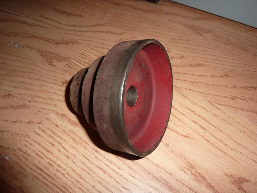

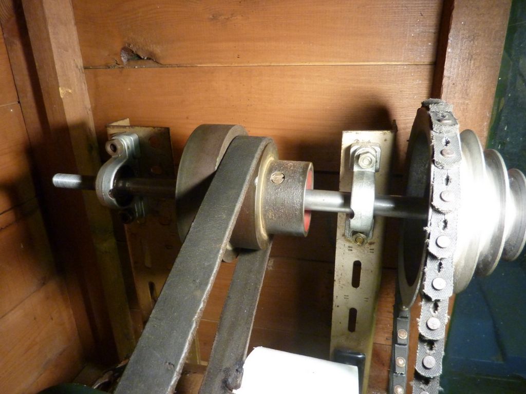

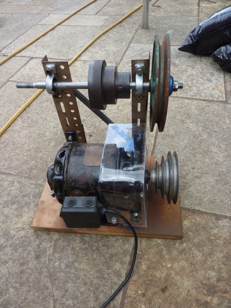

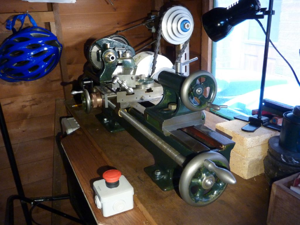

                                                      Some more modifications to the drive system over the past week or so. Until now I have avoided using the top speed on the flat belt pulleys because the vee belt pulleys did not have enough reduction meaning that I would be running the lathe at a higher speed than it was intended to use.
                                                      The (max 5 1/2 inch) Picador cone pulley has now been replaced with the 8 inch one bought from Michael Gilligan.
                                                      The clamping arrangement needs some more work but I could only find one decently thick half inch washer in my various stashes today. I was hoping to get the motor pulley sorted today as well, but as usual, things took longer than expected… mainly shoving the countershaft bearings 25mm along the shaft to make everything line up again. I've moved them three times now and still have not found a good way to do it.
                                                      The previous addition of the cast iron flat belt cone pulley added a good deal of weight to the countershaft and resulted in some wobble. At least some of this was side to side so I added a diagonal strut made from some square tube recycled from an old lawn spreader. The wobble is now much reduced… a good thing since the cast iron 8 inch pulley has added more weight.
                                                      A cut down plastic bucket had been a temporary (but long lived) solution to keep swarf out of the rather open air motor casing. I finally got around to making something less ugly. The cover is made from some 2mm acrylic that has been lurking in my garage for many years. Google searches turned up lots of info saying how easy it was to bend acrylic with a paint stripping heat gun. It's one of those things that turns out to be not quite so easy when you try it. I managed a reasonable one after destroying the first attempt but it's pretty uneven in places.
                                                      There is still more to do… a quick test with the flat belt on the highest speed pulleys quickly showed that the belt was fouling the backgear shaft so I need to lower the countershaft a little… not by much though because otherwise it will not clear that new acrylic cover that I just made.
