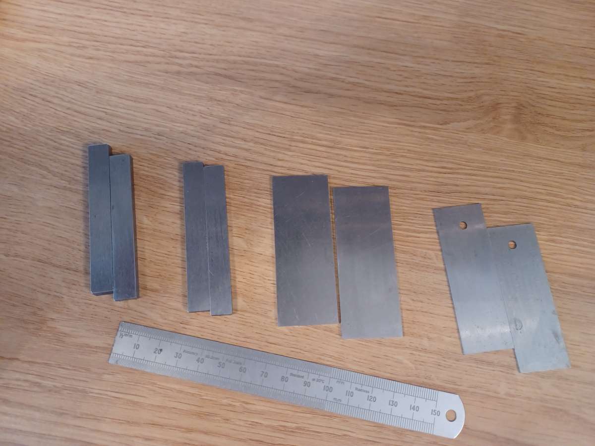

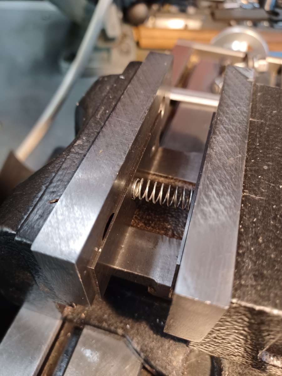

                    I have a set of small parallels which were made from gauge plate hardened and ground. They were made whilst at work in a toolroom but they were sent to a professional hardening company which means there was little distortion whilst being hardened and I had a surface grinder to finish them on. these are 0.032″ x 0.985″ x 3″    0.0625″ x 1.125″ x 3″   0.125″ x 0.375″ x 3″    0.187″ x 0.375″ x 3″
                    Parallels
                    20250529_081222[1]
                    These are absolutely essential to me and especially the thin ones which I use  with a spring between them to hold them in place whilst loading as they tend to fall over otherwise. You can buy gauge plate which is ground already and doesn’t have to be hardened for the use that model engineers and as long as they are cut from the same piece of material will be more than adequate. I have a few parallels which are just gauge plate cut to size length wise and are just as useful you just have to check them for dings and dents with a fine stone occasionally as any swarf could damage them in use.
                    David

                      Hadn’t thought of the spring. I think that’s worth the Tip-of-the-Month thread (even though I don’t use very thin parallels much).

                        Thanks for the suggestions everyone.  I like David’s idea of using a spring, or springs, to support thin parallels, but I rarely seem to have any the right size, especially when the parallels are close together.  In such cases I use “closed cell” foam mat (cut from a sleeping mat) that can be easily trimmed to size.
