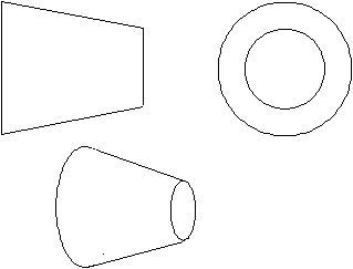

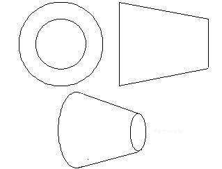

      I must admit that I also was wondering what those strange marks were on plans. And after seeing the explanation on the other thread I'm afraid I'm non the wiser embarrassed
      "Hi,
      The 'two circles' and 'trapezoid' are the standard symbols for indicating the drawing layout of the different views, i.e. first angle or third angle. Imagine the 'trapezoid' is a tapered cork and that you are looking at it. That is how the drawn views are oriented. It can make a great difference as to how the drawing is read.
      First angle Ortho (as previopusly used in the UK) –
      Third Angle Ortho as is normally used now (aka 'American' layout) –
      first angle.jpg"
      They look the same to me??

          OK ignore the 3D views.
          Take to top example and using the side view, that's the one on the right, 'roll' the cone to the left and you will get two circles, both visible. One roll so that's First angle projection.
          Now take the second example and to get the side view to resemble the end view you have to 'roll' it 3 times, hence third angle projection.

            Not quite, the concentric circles are at opposite ends of the side view for first and third angle, that's the key.

                  Oh well, let me try my definition.
                  We have two drawings of the same thingie, one to the left, the other to the right.
                  First angle: the picture on the right side shows the item as seen looking from left.
                  Third angle: the picture on the right side shows the item as seen looking from right.
                  In the case of that truncated cone it does not make much difference, but this also serves only to show which type of drawing it is. As was already told, in drawings of more complex nature it can make all the difference.

                      It hasn't been made clear that the PURPOSE of the symbols is to show how the different views are arranged.
                      It isn't hard to imagine a drawing with a front view, plan and two side views, where it isn't possible to be sure which of the two side views goes on the right and the left of the object.
                      If you know the projection used, then it is easy to work out which is which.
                      With third angle each side view is next to the end of the elevation it represents and the plan is above the top of the object. You can imagine folding them back around a box to make a 3-d model of thE object.
                      With first angle the views are adjacent to the side opposite the one they represnt. As has been mentioned you can imagine turning the object through 90-degrees to one side, and drawing the view that faces upwards.
                      The little sketches are just an unambiguious way of showing which projection has been used.

                                    one system shows "side elevation" the side you would see it from
                                    the other shows the "projected" view on the far side
                                    As to first ,second ,third and fourth these refer to the quadrant represented by the drawing of a 3d object projected onto three othogonal planes ; both 2nd and 4th are "valid" but unused ( we seem to have enough fun with the other two )
                                    1st angle uses plan under elevation and side elevation the farside you are looking from,
                                    (projection "puhes" )
                                    3rd angle uses plan over elevation(eek) and side elevation the side you are looking from
                                    (views from)
                                    THATS WHY IT IS SPECIFIED…It has wide effects on the interpretation of the drawing.

                                                      Wolfie,
                                                      The graphic on p38 shows:
                                                      First Angle … Object inside the corner of a box with [let's say] cardboard walls
                                                      Third Angle … Object inside the corner of a box with [let's say] tracing paper walls
                                                      In photographic terms it would be the difference between using "Front-Projection" and "Back-Projection" screens.
