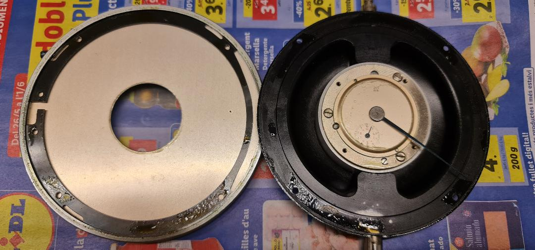

      I found a ridiculously large dial indicator ~11cm in diameter. I couldn’t resist buying it. In general it measures as accurately as the digital indicator. But unfortunately when it reaches 0.68mm it locks and then jumps to another position. From what I understand is not ok to lubricate dial indicators with oil? Because I have a feeling that some WD40 will fix this.

                    I had a look inside and I noticed two things. First, it is the most complex dial indicator I saw. Second, somebody flooded it with high viscosity oil.
                    There is also a lever that should press on a small wheel. But it is bent and was pressing in the wrong location.
                    There are also some adjustment screws. This is serious stuff not something to fix quickly at midnight. I’ll have a look in the next weekend.

                          Now:
                          1. Dismantle it carefully, taking notes and photos as you go
                          2. Clean all that filthy thick oil off every part
                          3. Reassemble it dry, and check that it works properly
                          4. … any slight lubrication can be considered after you know it works
