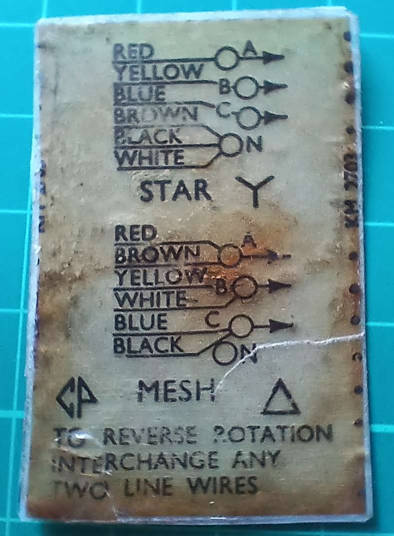

                                                Hi Andy, thanks, I’d forgotten about that article, but I have been a bit busy with other things just lately. I dug the three phase motor that was on my Boxford, and it is dual voltage, with it being wired in star.
                                                Lable
                                                All the coils measure the same with a resistance check, and no short to the casing, Looks lioke Transwave will be at the Midland’s show, so I might be able to have a word with them.
                                                Regards Nick.

                                                  Hi Nick, following the article there was some discussion on this forum regarding the safety of installing inverters, probably worth having a read of that thread. Basically it was recommended that the inverter should be in an enclosure with the actual function being controlled by a remote pendant.
                                                  Andy.
                                                  #802810
                                                  not done it yet
                                                    @notdoneityet
                                                    Change that word ‘should’ to ‘must’ if any conductors, that are touchable, have less than two layers of insulation.  Nearly all chinese VFDs fall into the ‘needs to be in an enclosure that is not easily opened by someone other than a competent person’ category.
                                                    #802819
                                                    Robert Atkinson 2
                                                      @robertatkinson2
                                                      Another simple rule is if you can see a blue or brown wire insulation (never mind bare conductor) It’s not safe.
                                                      This a key part of the ITEE (formerly knonwn as PAT) visual inspection.
