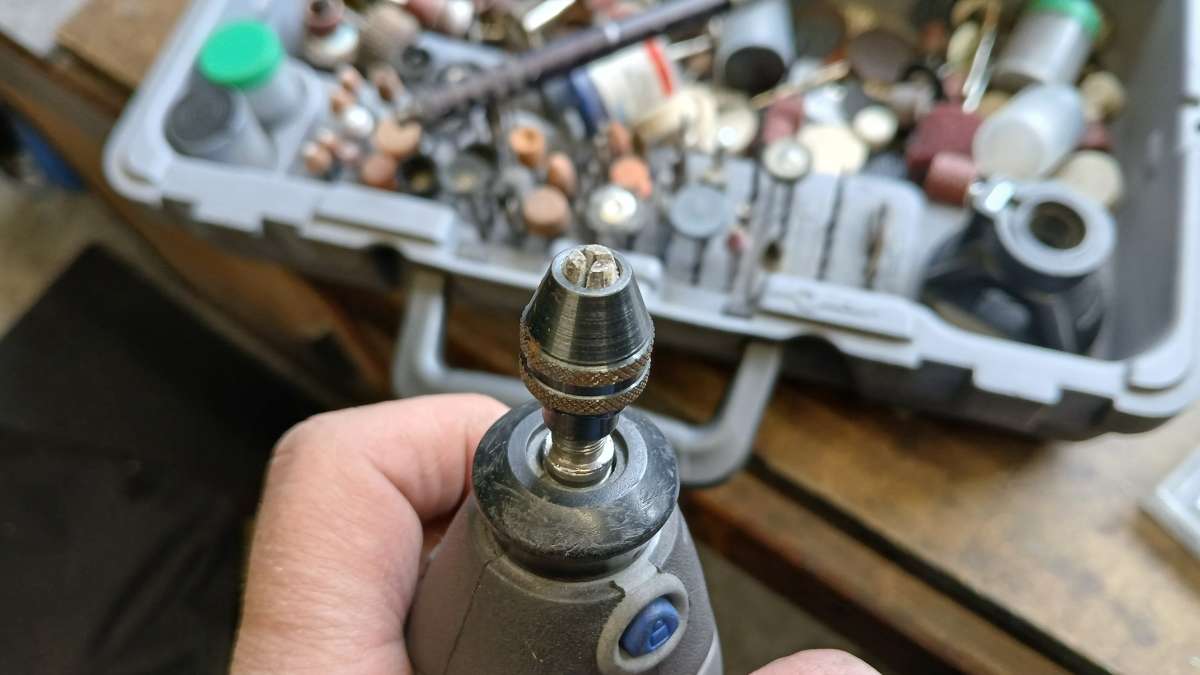

      Are there available for purchase very small DREMEL type collets for small drills – #80 – #60 (0.0135″ – 0.0400″). Currently I use a pin vice and a cordless drill, but you loose the “Feel” of the drill.
      #800141
        I’ve got a 3-jaw for mine that just replaces the collet & nut and will close right down
        20250528_155555

                  The small dremel drill chuck is really good for the small drills. I use the dremel with the flex shaft to drill 0.3mm vent holes for vacuum form tools, has the little drill chuck on it.

                    As the collet has slots in it to allow it to collapse, there would be a lower limit to the diameter of item it would hold.
                    That would mean for really small diameters, it would need a collet with non-standard slots (or varying width slots across the collet size range), which is not something economically viable in the market in which Dremel places itself.
                    A three jaw chuck has naturally-varying gaps between the gripping surfaces.
                    #800253
                    Speedy Builder5
                      @speedybuilder5
                      I think the Dremel chuck may be the answer.
                      Thanks for the replies.
