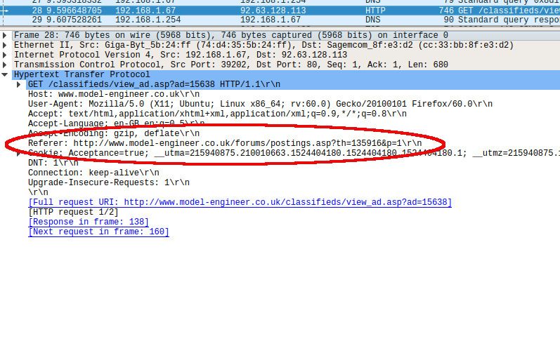

                        #355133
                          Posted by Raymond Berry 2 on 24/05/2018 10:09:11:
                          What more can I do do?
                          The error is occurring in you server system.
                          Ray
                          'Bad Referer' is usually caused by something at the client end; proxy, security/privacy setting, corrupt cache etc. I doubt it's the server, more likely something wonky between it and you.
                          Try accessing the Archive from a different computer.
                          Download Wireshark and have a look at the failing request to see what the Referrer contains. Here's what I send when asking for 'Experimental Flashsteam' in the For Sale section:
                          As you can see, the referrer in my example is this forum page, which is correct. Interesting to see what your machine sends when clicking to get to the archive.
                          PS 'Referer' vs 'Referrer' is a special treat for spelling pedants and paradox fanboys. It seems both spellings are simultaneously 'correct' and 'incorrect' because the words first use in a technical paper was misspelt, or was it…

                                  Posted by DMB on 24/05/2018 14:23:07:
                                  Would/could the use of a VPN be causing the prob?
                                  Yes, but not necessarily. A lot of things can cause this error. Most likely is a corrupt cache on the client, but there's a whole bunch of other stuff between Raymond and the Server that might malfunction. Kate is much better placed than we are to diagnose what's adrift because she has access to both server and Raymond. (And knows what she's talking about, rather than relying on my aged memory!) Be interesting to know what caused it if they ever find out. Bugs like this often disappear because something in the chain refreshed automatically and ditched the junk data. Very frustrating!
                                  Firing up Wireshark on my network revealed that I've got a problem too. Although everything seems to be working OK I'm seeing excessive repeats and out-of-sequence packets that suggest something in my home network isn't well. And the cat's been sick!
                                  Ho hum, back to work.
