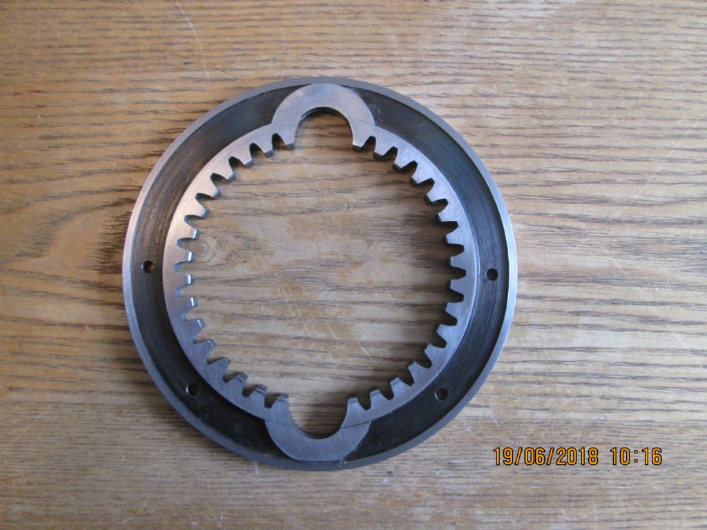

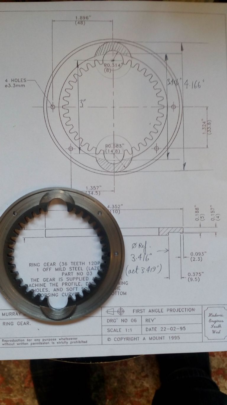

                    Right. Still haven't got to gasket-making stage yet.
                    Yesterday I was making the reinforce arcs for the laser-cut ring gear supplied wi' kit. I've drawn in the arc where they meet the inner toothed ring when machined to the drawing, and shaded in the bits I gotta make. reinforces in loose.jpg
                    Oh, momma, I really hadda do some baad things here…laugh
                    In order to get the arc radius right(-ish) at the base of the reinforce, the only easy way I could see to do it was to use a long 3/16" toolbit in my boring bar/flycutter, set out to the 1.708" radius of arc, then set a turned blank in the vice 1.5" above centre height – pretty close to the top of my vertical slide travel.
                    Shape of the toolbit reflected my earlier punt at doing a sort of interrupted trepanning cut through the face to save chopping away all the metal on the underside. I didn't think I'd get away with that, and when it became clear I wasn't going to I abandoned it before I broke the tool or wrecked the blank.
                    So then I let down the slide 20 thou at a time and bored out the arc on the slowest feed longitudinally. Took Gawd knows how many cuts.
                    But eventually it worked, as you can see in the first pic. I was offering up the turned ring gear to see if the workpiece would fit between the inner and outer diameters over the last 10 thou or so, and it came right within about 2 thou of the expected vertical slide setting.
                    Then I could carefully part off the 2 reinforces on a slow-speed interrupted cut.
                    Now I gotta soft-solder the things in place prior to a final face skim to clean up.
                    'Spect that might be another story… frown
                    Edited By Mick B1 on 16/06/2018 10:32:09

                      I couldn't get the flux-cored soft solder I use on electrics to take properly, so I tried silver solder.
                      That worked, but I've got a couple of stray blobs oozed out. They won't (AFAIK) interfere with owt, but they look untidy. blush
                      Think I'm gonna hafta Dremel out as much as I can with those little rotary diamond file affairs, then finish off with the point of a Swiss file ground like a watchmaker's turning tool.
                      Unless anybody would please tell me a better way? angel

                        Well, the Dremel (actually Rotacraft) didn't really work – there was too much risk of carving into the steel underneath the silver solder – but I found a titchy little parting tool I'd ground for titanium earings I was turning on the little Sieg C0.
                        So I mounted that in the Warco pointing at the chuck, gripped the inner gear ring on the outside jaws, set the tool to kiss the recessed face and rotated the chuck by hand until the reinforce hit the tool. It peeled off a strip of silver solder. I had to back off a bit on the thickest bit of the blob and do it a few thou at a time, and of course it left a tiny triangle untouched where the flat-faced tool couldn't reach, but maybe 20 minutes' work cleaned off almost all the blobs. Then I blacked the part with gun-blue creme, washed it and emeried the o/d and front face.
                        Maybe my standards are low, but I think that's now OK. I wish I could get rid of the joint line on the lower reinforce, but I'm not yet sure I care enough to take the trouble – I thought about filling it with soft solder but there's probably some solder-hostile crud in there by now so I don't know how easy – or risk-prone – that might be.
                        Maybe I'm making a meal of stuff some of you probably think is nursery-slope work… laugh
                        #358440
                          Looks good to me, you can always leave the crank arm over that joint when the engine is on displaywink 2. Even if it had soldered up a bit tighter the silver solder can tarnish over time and leave a black tell tale.

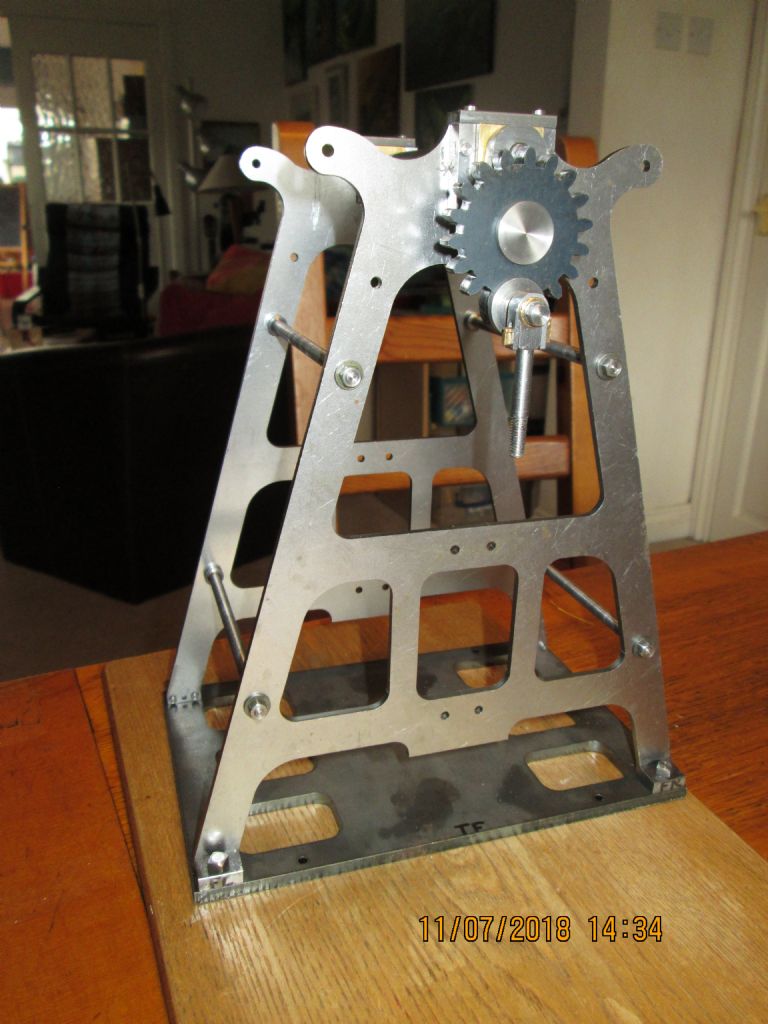

                                Think I'm just about finished for piece parts now, except for the soddin' frame feet, which I think I'm going to bolt on rather than silver solder, after the last nail-biting experience.
                                I simplified the main bearing housing to a square u-shape and again bolted that on, there being no discernable reason not to.
                                I saved myself a 48 mile roundtrip or two-day delivery wait by drilling the tapping holes for the 8BA main bearing retainer bolts 1/16" instead of the proper 1,8mm, and it's cost me not 1, but 2 broken taps. Stupid of me to try it, really – I get away with it once, and then think it's an acceptable technique. Blind holes – not a hope in Hades of gettin' 'em out. And I couldn't be ar$ed to remake the bearing housing – not at this stage – but I did find I could resharpen what was left of the broken plug tap. And if I drilled 5/64" or 2,00mm for tapping, the thread cut much easier and was still strong enough (which I hadn't at first expected).
                                So one of the bearing retainer bolts is in a bit of a 'not to drawing' position. Whether or not I ever fix it probably depends on how persistently it embarrasses me to see it later… blush

                                  I've done the feet, bolted them to the A-frames and to the baseplate, also done a casual assembly with 4 of the longitudinal tiebars.
                                  There's 2 thou clearance between the crankshaft diameter and the holes in the bearings, which are 4 inches apart, and it just slipped through and turned freely, just like that.
                                  Now, it's true that the Polly Models kit has some of the fastener holes and the bearing box cutout already in place, but there are still a lot more than enough places you can introduce variations to build up some problematic cumulative errors.
                                  So, at the moment that's looking good. Still plenty of opportunities to screw up yet, though… embarrassed

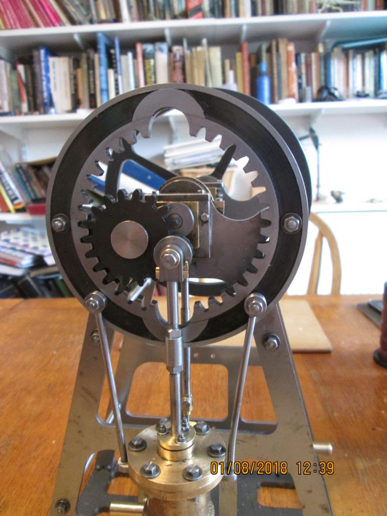

                                    Right. 'Tis done – more or less. I might make oil cups for the main bearings and eccentric strap, and I'll probably paint the frame, cylinder and the flywheel except its rim, but it runs from a big bicycle pump – though my 12V tyre inflator doesn't seem to shift enough air. Unsurprising as the cylinder swept volume's much bigger than my Sturat Beam, which it can just operate.
                                    Took me several tries to get it running.
                                    First I tried a Nylon 66 piston ring. Maybe that would've worked if I'd worked up a mirror-smooth bore, but as it was I couldn't get an air seal without a tight frictiony fit. So I took some cotton kitchen string and smeared it with LM3, and that finally gave a smooth-fitting seal.
                                    There was a few thou shimmy on the eccentric because I'd started it from a bit of CI that was pretty much exact length, and that was just fouling the protruding tip of one of the bearing support bolts once per rev, till I found a way to chop the tip off without dismantling the whole thing.
                                    The Loctite 271'd interference fit of the mainshaft to the crank throw wasn't up to the torque, and shifted – so I drilled 3/32 through both and pinned it with silver steel. Meant I had to fiddle the valve chest cover with its 11 x 8BA studs and nut off and on again so as to reset the lost valve timing. Growled away half a morning on that.
                                    But the stupidest issue was my inlet assembly. I had a hollow hex tube feeding the valve chest, and a plain inlet pipe screwed in at a right angle to that. Screwed it in so far that it completely occluded the 'ole into the hex tube, didn't I? So the compressed air wasn't even reaching the valve, never mind the cylinder. I really don't wanna say how long it took me to find that. Duh.
                                    There are two weird-shaped tie-rods from cylinder to stator ring. Only the Michigan original has these, and I can't really see the point of them in the model as the four 5BA bolts holding cylinder to frame should easily be adquate. The drawing's not completely dimensioned and there's no obvious easy way to calculate the compound angle, so I fabricated them from steel components screwed together, which took quite a while as suck-it-and-see seemed the only method.
                                    So. I've got a nice new model now.
                                    Is it because of the laser pre-cut frames and gears that I now feel a bit of a cheat? I strongly doubt that I'd ever've worked up the commitment to build such a thing without – dunno how I'd've done the gears at all with the kit I have.
                                    Thanks to all who've answered questions and provided advice, even if I haven't always followed it. smiley

                                      Whoopee doo!
                                      It wasn't that the little inflator didn't have the puff!
                                      It was that I should've retarded the timing by about 10 degrees instead of cracking the inlet ports at the deadcentres. Thunk that thought drifting off to sleep last night after another pointless, meandering episode of Dicte on the telly.
                                      Carol's delighted that I don't now have to buy an expensive compressor… angel (we'll see later)
                                      Anyway, here's a video of it running:-

                                      #365505
                                        That runs nice and slowly, smooth as well even with what is quite a small flywheel.
                                        You have done a neat job with the metalwork so leaving bare would certainly be an option, If you decide to paint than I think these early engines look good in a satin black which is not unlike the finish already on the flywheel, gears and base plate.
