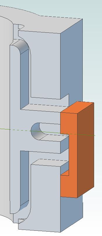

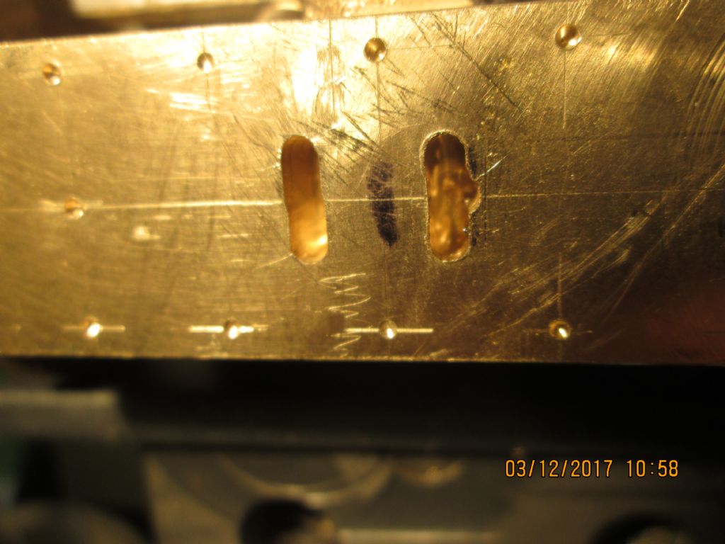

                  OK, so I've made my first mistake.
                  Cutting the valve ports on the steam chest face of the cylinder with a 3/32" slot drill, I've placed the outside edge of one of the inlet ports about 15 thou too close to the other inlet port.
                  I think that if I enlarge the port to bring the edge to the right place I'll unbalance the piston strokes because that port will be too big, and I might also get too much overlap on the stroke.
                  So I think the way to fix it is to reduce the eccentric offset by half the error, ie. about 7 1/2 thou.
                  Ah, and reduce the size of the pocket in the valve slide by the error.
                  Anybody got any comments? Thanks in advance. smiley
                  Edited By Mick B1 on 01/12/2017 16:29:00
                  #330124
                    So are you saying you have 0.094" between one inlet slot and the exhaust and about 0.70" between the other and the exhaust
                    #330132
                    Mick B1
                      @mickb1
                      Posted by JasonB on 01/12/2017 20:53:15:
                      If I'd cut the exhaust port, that would be so; but I haven't yet, so I can still aim to position it to split the gap between the 2 inlet ports evenly, and reduce the valve stroke and flow pocket correspondingly – if that makes sense.
                      #330149
                        That would be the best Idea, If I get a chance later I'll draw it out to check. Recess in valve will want reducing to match.
                        #330150

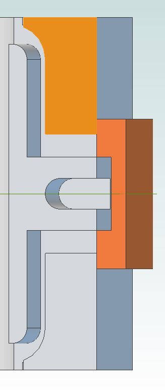

                          #330191
                            Looks like if you place the 0.125" exhaust slot centrally between the two inlet slots, reduce height of valve recess bu 0.015" and also overall height of valve by the same 0.015" you will be OK, eccentric throw stays the same.
                            Midway
                            Full travel
                            #330197
                            Mick B1
                              @mickb1
                              Thanks very much for that! 😀
                              I'll post further as I go.

                                Nice one Dr. B.

                                      #330269
                                        Post the actual sizes and a photo of the port face, only takes a few secs to alter the dims on the sketch.
                                        Not made it but have AM's book which it is in.
                                        #330310
                                        Mick B1
                                          @mickb1
                                          Posted by JasonB on 03/12/2017 07:24:43:
                                          Here's a brutally frank picture of the current condition:-
                                          You can see where the initial RH slotdrill plunge nearly touches the height-gauge-scribed line. Dimension across both slots into the arc on the RH one is .495" , 5 thou short of nominal. OAL of slots is .323" (L) and .313" (R) – both undersize but I can't see that mattering.
                                          Experiments with soft solder and a bit of scrap LG2 look promising, though I think I'd run a couple more trials before doing it for real. The engine will only run for tens of hours in my lifetime – maybe a lot less – and on air, so I doubt that soft solder would erode seriously.

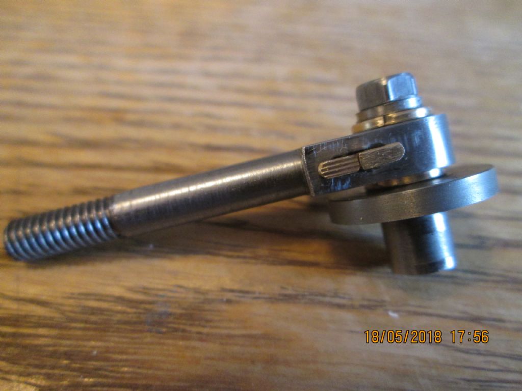

                                              I've now made almost all the piece parts, but I'm stuck for a method to make the slot through the piston rod end for the key and wedge that hold on the bigend strap.
                                              In the bigend strap, I could cut the 1/16 x 5/32 slot using the pilot of a centre drill, which cuts on the flutes as well as the lips. The strap is U-shaped and thin, so the pilot was long enough.
                                              But the piston rod end has a concave radius to fit the lower half of the split-bush bearing, and another 1/16 wide x 5/32 long slot right through the 1/4" thick flat, and the little centre drill pilots are nothing like 1/8 long so won't do.
                                              I haven't any spark-erosion kit. I'm wondering about drilling a line of contiguous 1/16 through holes, milling between them as much as I can from both sides with the centre drill pilot, then grind up some sort of punch with an angled face to try to chisel/scrape/broach away the hole segments the pilot can't get at in the middle.
                                              But that has every prospect of ending up looking like it was carved from an old potato by a drunken sailor.
                                              Anybody know of a simple way to do this?
                                              I'd post a scrap view of the drawing, but have seen that Anthony Mount posts on here and don't want to provoke any copyright issues… blush
                                              Edited By Mick B1 on 14/05/2018 19:55:07
                                              #354033
                                                The way I do these is to use a 1/16" drill to first drill out each end and then get as many holes in between as I can. I Then change to a 1/16" milling cutter and make a series of plunge cuts working along at about 0.010" for each plunge, I think Anthony suggested this method in more than one of his engine builds and it seems to work better than milling along the slot. If the slot is deep you may need to mill from both sides.
                                                This will leave you with a round ended slot and to make this square I have a warding (flat pointed) needle file that I have ground the teeth off of in the flat faces so I just have the edge teeth which means you don't make the slot wider while filing the ends.
                                                J

                                                Mick B1
                                                  @mickb1
                                                  Thank you for that, Jason.
                                                  Looks like I'll have to splash out on that 1/16 milling cutter (presumably 2-lip slotdrill?), then. laugh
                                                  I wasn't sure it was worth squaring off the ends – it might be easier to file radii on the key & wedge, but I'll jump off that bridge when I come to it…
                                                  I had been thinking about modding a flat Swiss file to make the rectangular punch affair I was proposing, and taking off the face teeth to stop it opening the slot is a good one – ta.
                                                  #354041
                                                    2 or 3 flute will be OK

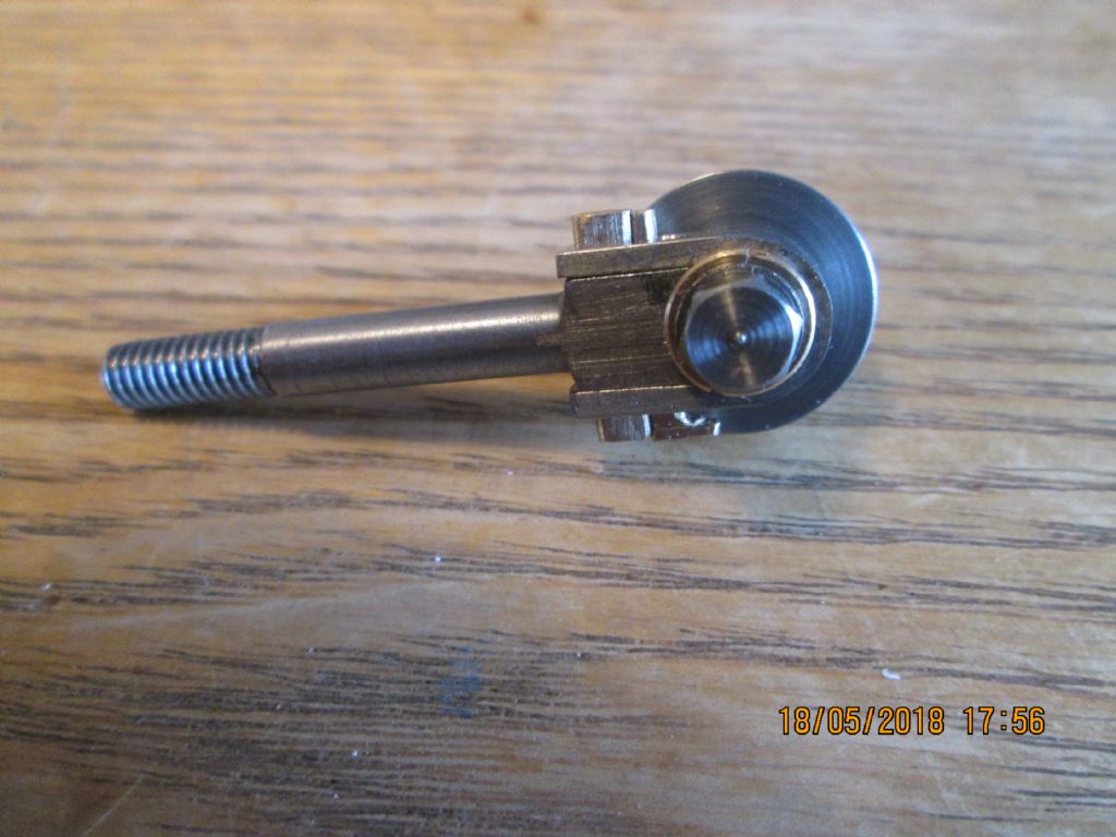

                                                    Mick B1
                                                      @mickb1
                                                      OK, so I bought a 3-flute 1/16 cutter – and, as I suspected I might, broke it on the second pass. Probably should've wound the speed up higher than the 1000-odd I was running at.
                                                      So I went back to plan A*, drilled 3 'oles and milled between them with the pilot of a BS2 centre drill. Broke the pilot on one end too, but carried on with t'other. Then poked out the tiny bit of remaining metal with a Swiss file and cleaned up.
                                                      The other mistake I made was misread the drawing of the crankpin, so the capped journal for the split-bushed bearing was too short. I could've, maybe should've, remade it, but I cheated and tapped it 5BA and turned the fixed cap down to journal size (3/16) and interposed a stepped washer so's it wouldn't bind.
                                                      Here's the resulting subassembly:-
                                                      As a macro shot it looks rather agricultural, but it's nice enough to normal vision.
                                                      Lotsa work to make 1/4 teaspoon of swarf… laugh
