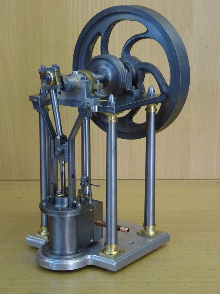

      With the build series for my rendition of Muncaster's "Simple" Entablature Engine about to begin in ME 4618 I have started this thread for anyone who may have queries or comments about the engine such as alternative materials or construction methods to suit what tools you have.
      Additionally I will post extra photos that would have possibly packed out the article too much but that may still be of use to those building the Engine. Martin is kindly publishing in consecutive magazines so that the build won't be spread over too long a period.
      For those that have not seen my previous posts of the engine here is a video of it running of 2-3psi of air to wet your appetite and hopefully tempt you to give it a go.
      The drawings have also been proofed by out occasional member "Gas Mantle" who is a relative beginner, this is a clip of his version running on the "hot stuff"
      The naked engine will give a good idea of what materials were used in it's construction

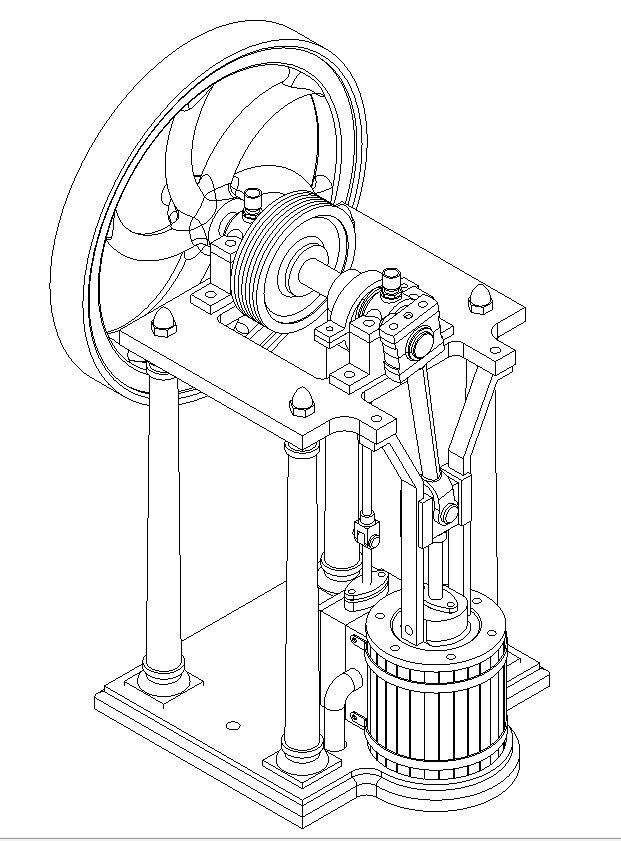

      And if you prefer a sketch to the 3D rendering that is shown in the magazine then this is for you

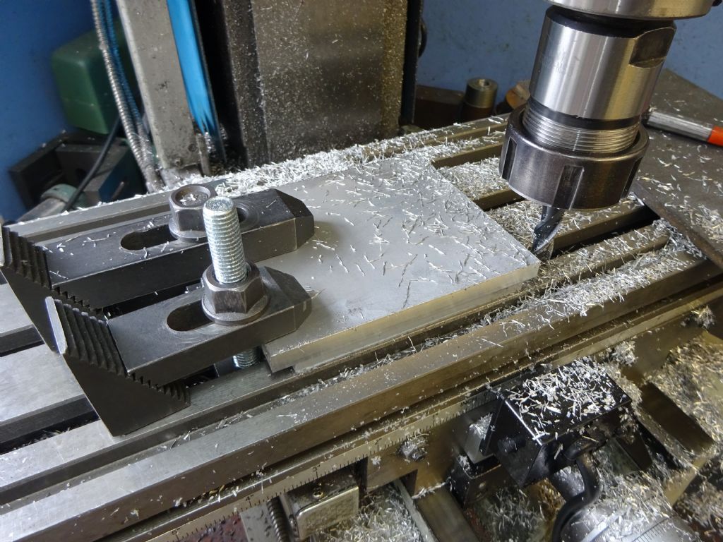

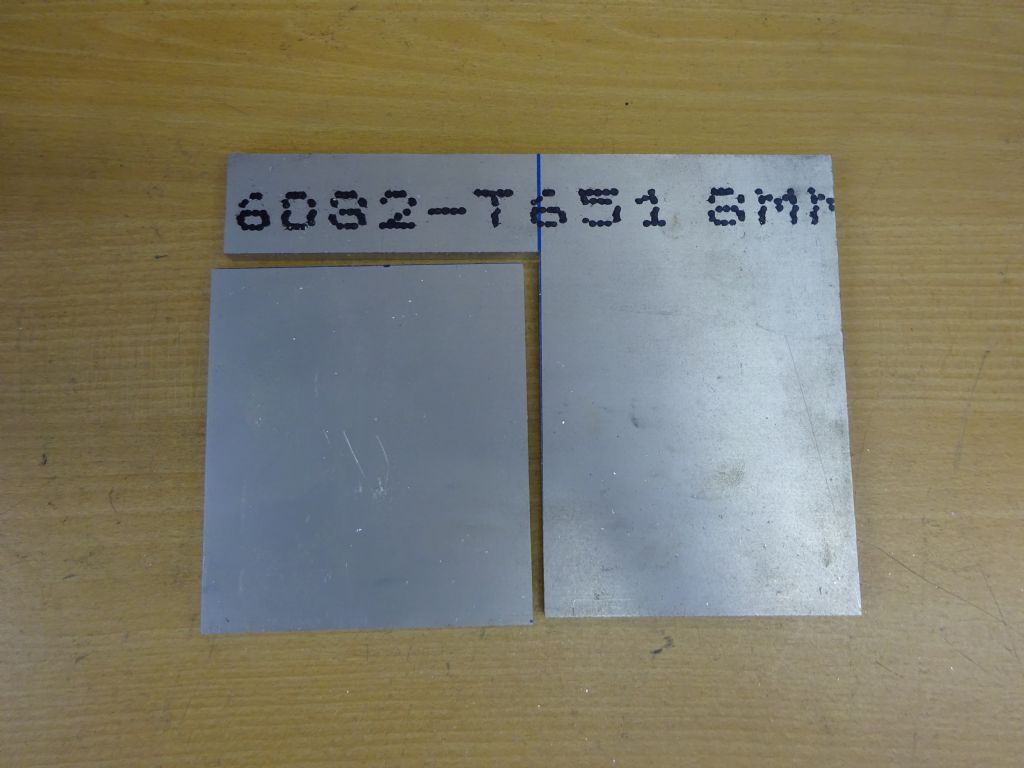

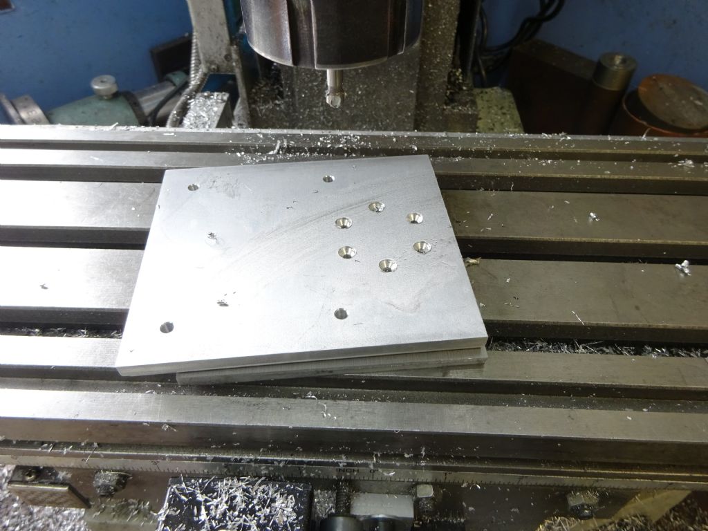

          Additional content to go with part 1

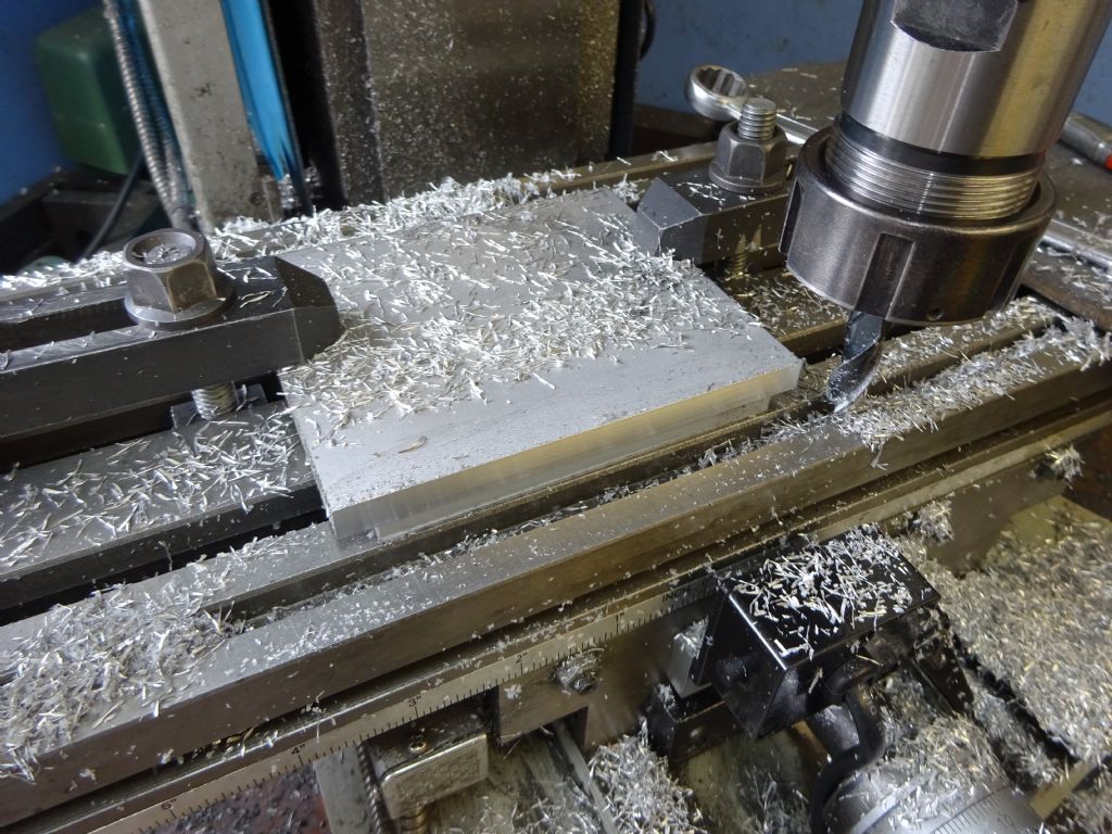

          8mm 6082-T6 aluminium plate with the material for the base Plate cut out.

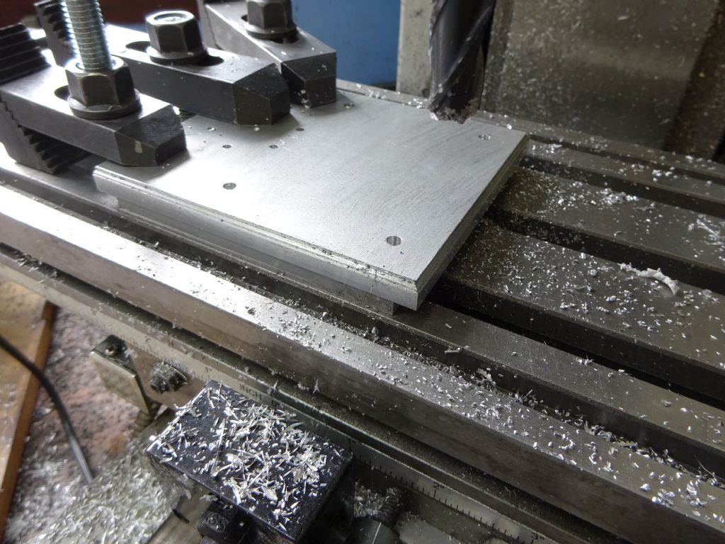

          Initial cuts to bring front and back edges to size
          Clamps moved to do the sides
          Freehand ground cutter used to form the 2mm radius decorative moulding, again clamps moved to suit.
          Countersinking the underside of the six cylinder fixing holes for socket head csk screws as they won't be seen.
          The almost completed base plate

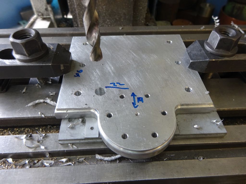

          Adding the exhaust pipe hole, other builders should do this at the time all the other base holes are added unless they want to use a different route for the exhaust

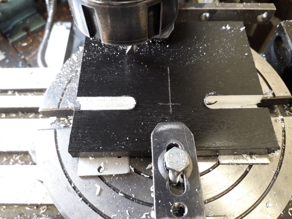

                                                    Posted by Colin Heseltine on 30/07/2019 21:05:38:

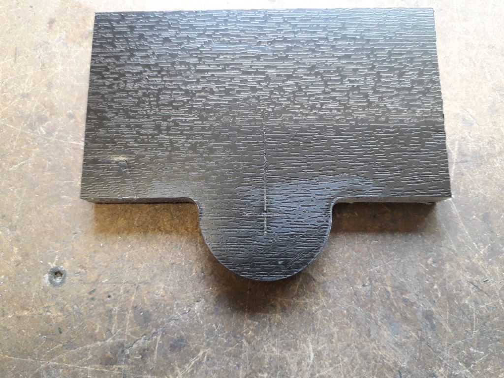

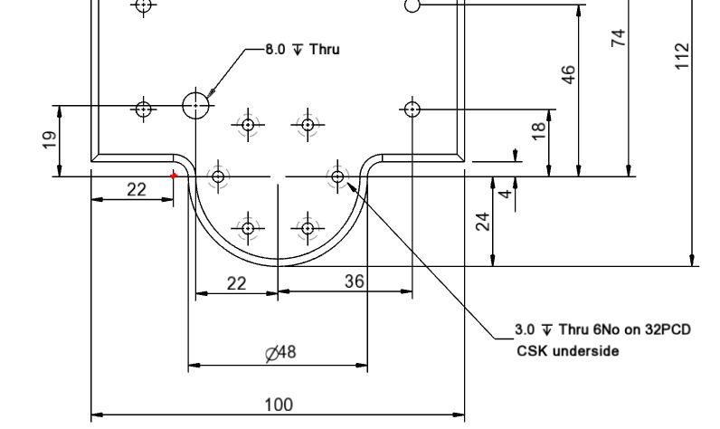

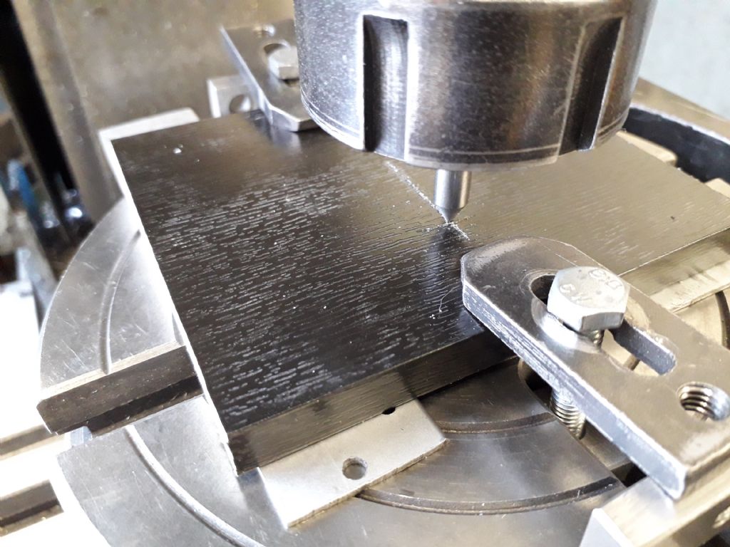

                                                    Do you have any video showing how you produced the radius around the cylinder mounting on the base plate and then changed from external radius to internal radius's and achieved it all nicely flowing from one radius to the next.
                                                    Looking at the drawing at the bottom left of the base is a dimension of 22mm in from the edge to the ctr of the internal corner radius which I have marked in red which gives a distance from the cylinder Ctr datum point of 28mm (half base width less 22mm) in the X-axis and zero in the Y-axis. As the front edge of the base is 4mm from this point an 8mm cutter can be used as per the text.
                                                    First thing to do is set the rotary table up on the mill with it's axis directly below that of the mill and zero your handwheel dials or DRO. Then turn the table until the scale reads zero and clamp the work to the table with some packing between and make sure it is square to the lathes axis and the ctr of the cylinder is lined up to the mill spindle.
                                                    Pop an 8mm cutter in your holder of choice, lock the Y-axis at zero and then cut in from each edge to 28mm from the cylinder ctr. Assuming a bench top mill then something like 1mm deep per pass will do or more if you have sawn away most of the waste before milling. You should then end up with two slots like this.
                                                    Reposition the clamps to the sides and you can now also lock the X axis at -28, 0 and bring the cutter back down to take your first cut around the curve which will start from zero degrees and end at 180deg, repeat this until you have cut ring through and hopefully have a shape like this. before rushing to admire your work run the decorative moulding around the curve and front edges while the work is correctly located.
                                                    Do not dispair if you don't have a rotary table, just mill the two slots and then saw and file the half circle. If you take this approach it would be better to build up the base from a piece of 6mm plate that can then have the 2mm moulding filed onto it and then add a 2mm thick plate ontop that is 2mm smaller all round to produce the quirk.

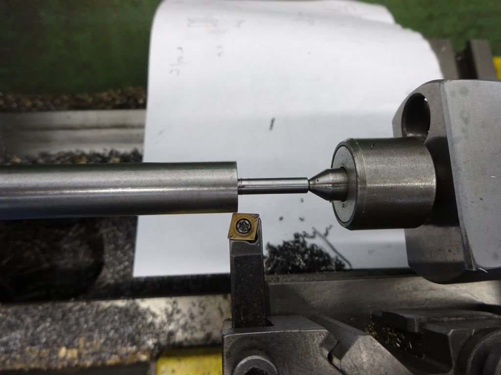

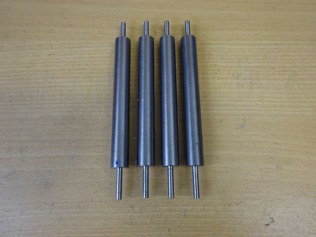

                                                      Additional content to go with Part 2.

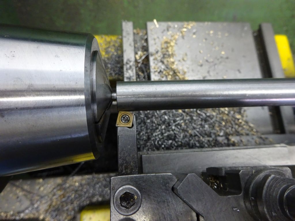

                                                      The four embryo columns with the end spigots turned and ctr drilled.

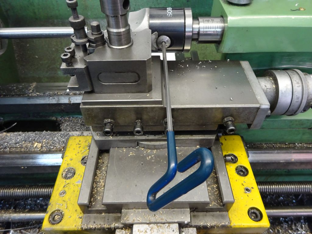

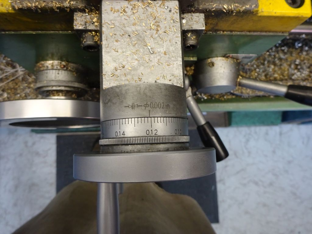

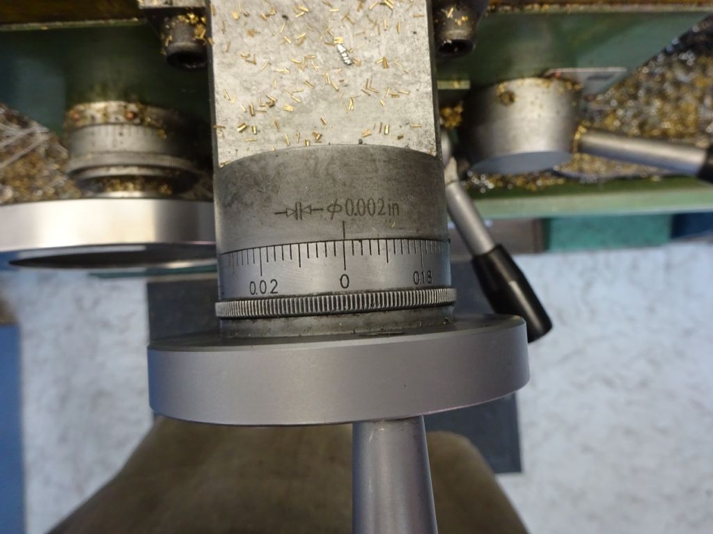

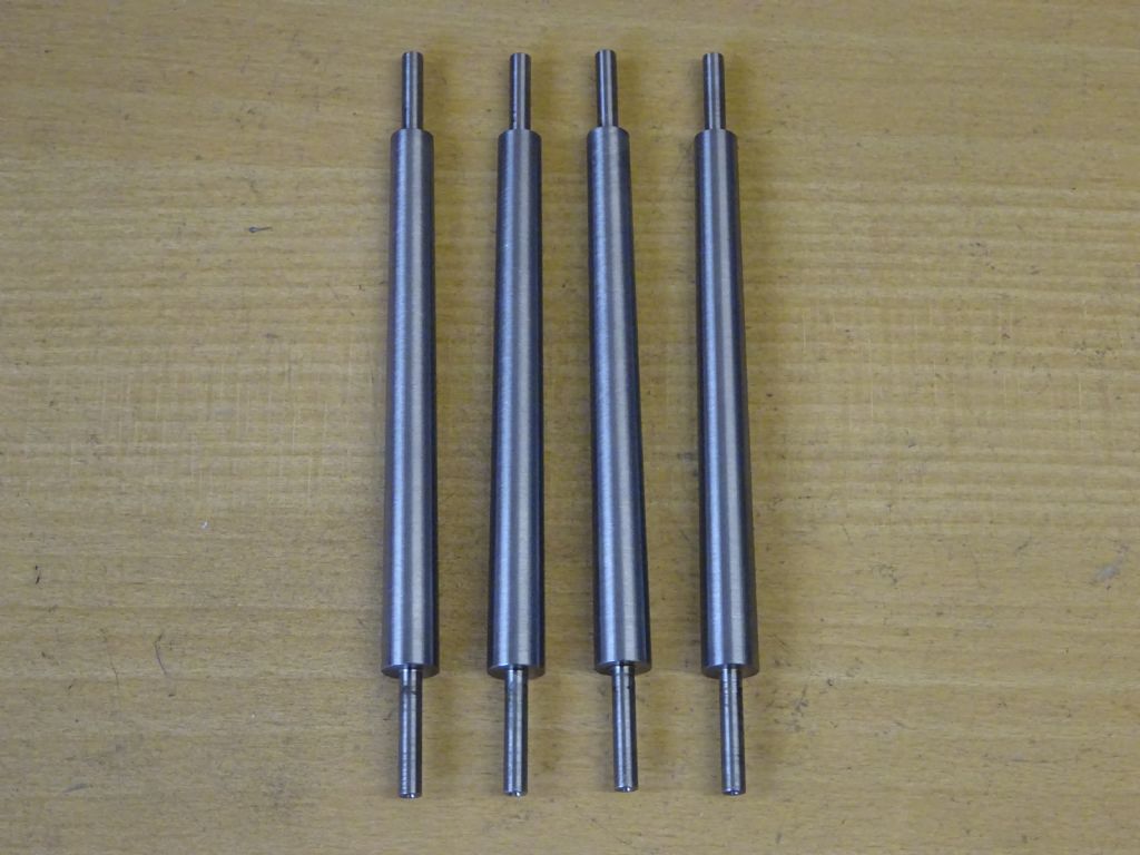

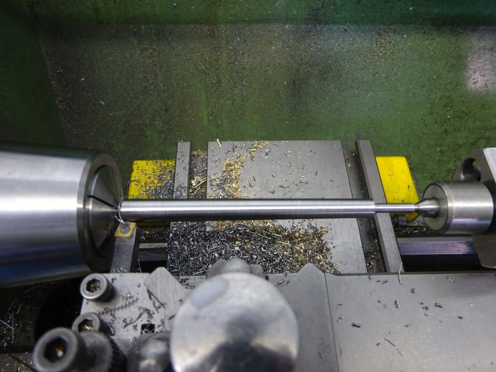

                                                      This is the method I used to cut the tapers using a boring head to offset the centre but the same can be done by offsetting the tailstock.
                                                      Hold by the bottom spigot with enough room to let the tool clear the cut and touch off against the 12mm diameter.
                                                      Zero the handwheel dial or DRO if you have one.
                                                      Wind the tool away by half the difference in diameters in this case 1mm [(10-8) / 2], my dial reads in diameter so I moved it 2mm (0.079" )
                                                      Now move the carrage so that the tool is at the other end of the work and you will see the gap
                                                      Now move the ctr towards you until the tool touches off on the work
                                                      It is now just a case of turning along teh length in a couple of passes preferably using power feed until your cross slide reads zero and you should end up with a nice taper.
                                                      Repeat for the other 3 columns
