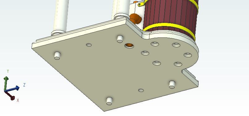

      I have just started the base today. Are the columns fixed to the base with nuts under the base? I can see that the holes for fixing the cylinder to the base are countersunk but the holes for the columns aren't.
      Thanks
      Stuart

            I have just started the base yesterday. Are the columns fixed to the base with nuts under the base? I can see that the holes for fixing the cylinder to the base are countersunk but the holes for the columns aren't.
            Thanks
            Stuart
            #439031

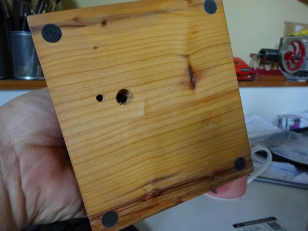

              Yes I just used nuts for them, you could leave out the CSK to the cylinder holes and just use some cap head screws for the cylinder but will have to cut some clearance holes in whatever wooden base you choose.
              I suppose the spigots on the columns could be made a little shorter and the holes counterbored for a nut and clearance for a socket if you want a completely flush bottom.

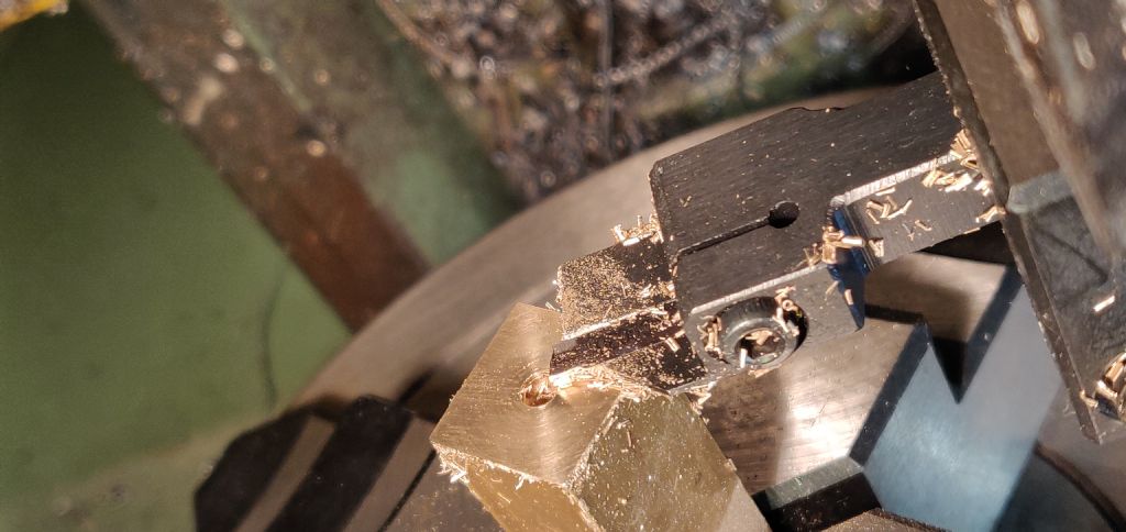

                Before and after taper
                Cutting the taper
                Parting off the square stock
                To cut the forming tool, I used a 5mm dremmel stone – sold for sharpening chain saw blades – worked perfectly providing a nice curved cut out
                Nearly there – not enough weekend days in a week!

                              The photos and drawings show a pipe connected from the valve chest to a hole in the base plate which is bolted to a wooden base. Where does the steam/air exhaust to ? Is this pipe not used when running ?
                              Paul.
                              #439383
                                Hole in the base is larger than the pipe and as can be seen from teh image of the underside that I posted above the pipe does not go to the bottom of the hole. This will allow exhaust air to freely escape, If running on steam then I would suggest plumbing into the boilers blast pipe via an oil seperator.
                                I also put small baize "feet" on the corners of my wooden bases which offers a second route for the exhaust air to escape.

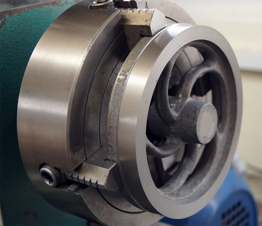

                                              Well surely thats a sign of a quality casting, just started on the flywheel (waiting for a new compressor for the Jowitt).
                                              I clocked up the inside of the rim or as near as for an unmachined casting and it took just 1.0 mm removed to clean and true the rim outer face and only 0.8mm to clean the rim side, I doubt it gets much better than that.
                                              #462778
                                                He does do a nice job of casting them and the iron is nice and easy to cut.
