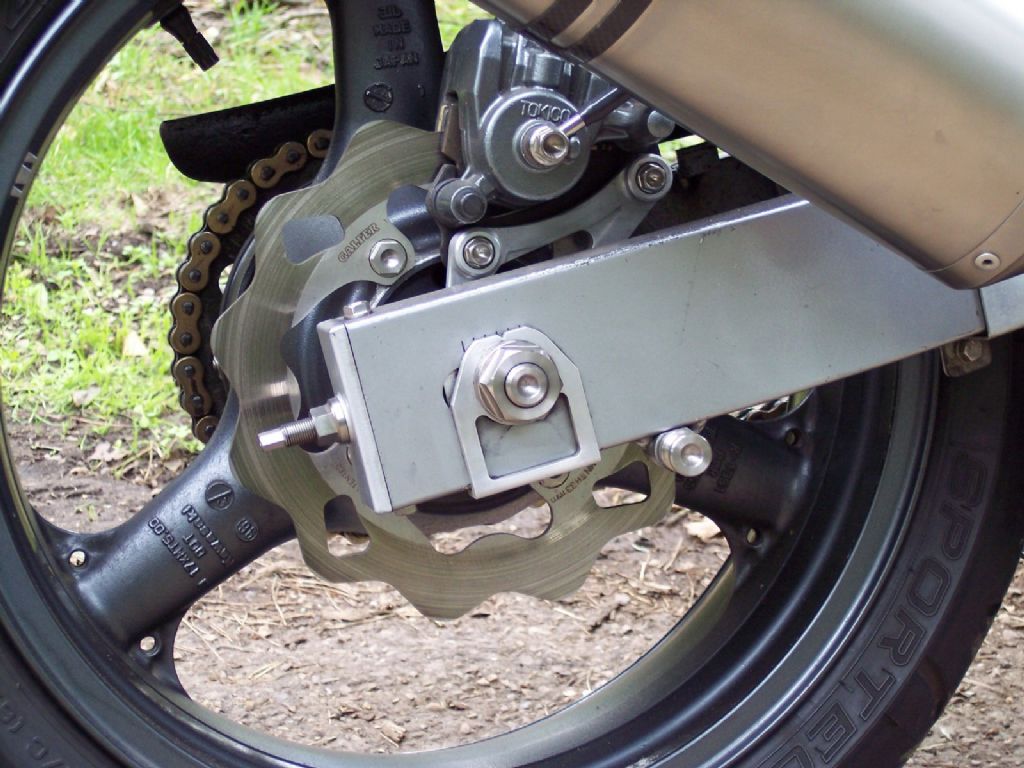

      I race motorcycles and I am upgrading to wider wheels, this requires a new wheel a spindle to be made, nominal diameter 17mm x 240mm long threaded at on end.
      What steel should I use ? I model engineering equipment not industrial so I need to be able to machine this at home but it has to be strong enough to do the job

                  I am fitting suzuki bandit front end and rear wheel into a race “Classic” YPVS race bike.
                  The rules don’t permit me to change the swinging arm but I am allowed to widen the one I have therefore requiring a wheel spindle approx 15mm longer than the standard one.
                  To answer the above question is no nothing lined up, the brake disc had to be moved 8 mm closed to the centre of the wheel,  talon have supplied a new engine sprocket with 9mm offset moving the chain 9mm outwards, The chain still did not line up so a new sprocket carrier had to be made out of alumimium billet (165mm x 35mm) this moved the sprocket 16mm nearer the centre of the wheel and still used the standard cush drive.
                  Making the new sprocket carrierr took 12 hours !!! on my chester model B combi machine but it did show just what can be made on basic machinery.
                  We are allowed to run titanium components but not wheels spindles or swing arm pivot bolts and this applies to all race bikes in this country I can only assume it must be on safety grounds. My brother had a set made in titanium and they saved lots of weight but scrutineers started using magnets to check they were steel so that soon put a stop to them.

                          The bible for this sort of thing is Volume 2 of the three book series "The Racing Motorcycle, a constructors guide" by John Bradley.
                          He recommends 605M36 in T condition for wheel spindles. That should be what you get if you ask for EN16T from a reputable supplier but I can't see the sense in asking for something that should be to a long obsolete standard and ought to be equivalent. Ask for the right stuff and be done with it.
                          Although you could use 080M40 which is what ought to be supplied if you ask for EN8 it's a bit lacking. Only goes to tensile range R at 19 mm diameter so limited to very small spindles. John says you need to make sure that it actually is heat treated to a sensible range and not just plain bright drawn or, worse hot rolled bar. Even in 2003 when that volume was published hot rolled EN "equivalents" could be pretty noisome stuff. Its only got worse in the intervening period. When was the last time you actally say EN8R advertised? Like John I reckon there is too much carbon in it for comfort.
                          If you only want a foot for a spindle might as well get summat a bit decent.
                          When it comes to safety related things like spindles the job must be done properly.
                          No excuses.
                          Ever.
                          You may know its for parade only at low speed with a careful pilot but no one else will care. Two part construction just won't do. Not forgetting the effect that silver soldering may have on the tensile range.
                          If I'm making a spindle I want the right material with certificates.

                                      Fundamentally the issue with wheel spindles is crack resistance rather than strength per se. Especially with threaded end ones that screw into one fork leg where the thread end creates a stress riser.
                                      Even then odds are is more a case of what happens if things aren't correctly installed with the spindle properly fitted into the master leg and the other settled into its natural position by bouncing the forks.
                                      Agreed that spindles are rarely destroyed in a crash. Seen plenty of bent ones tho'. Something I always check when involved with a bike whose history I'm unsure of. Mild bends are more common than I'd like. Regrettably seen some "professionally" fixed (not) bikes with handling or fork issues where the bend should have been obvious on installation.
                                      When you don't have factory or real engineering company resources / expertise to sort out and get ideal fit material for the job it becomes a question of what can reliably be got off the shelf that is known to be suitable for the job.
                                      605M36 in T condition with a certificate is. Anything else folk like us can't really be sure about. 080M40 in R condition with a certificate should certainly be up to the job on anything small enough to have a spindle under 19 mm diameter. I don't do ordering under an EN number, unless "a bit of steel sort of like this" is up to the job and the price is very right, because I can't get real certificates specifying the properties of what I've just paid for.
                                      Of course, like any sane Home Workshop guy I tend to duck jobs where "a bit of steel sort of like this" isn't an adequate specification!
                                      Stainless steels are a minefield. Pretty but you do need to know your engineering if applying serious loads. Crack behaviour and effects of certain chemicals can be a little surprising.

                                              Bottom line is any commonly available steel heat treated to T condition will be amply strong enough for spindle duties. When you look a tabulated properties there is no discernible difference so far as the likes of us are concerned.
                                              But I'd still rate 603M36 T (En16 T) over 709M40 T (En 19 T) and 817M40 (En 24 T) for this sort of thing because its a manganese-molybdenum alloy and so much less susceptible to temper brittleness than chromium alloys. Its also a somewhat tougher and more shock resistant at normal temperatures.
                                              709M40 (En19) is a chrome-moly steel and 817M40 (En24) is a nickel-chrome-moly steel so both can have temper brittleness issues at higher temper ranges if heat treatment is not done well. Pretty much unheard of in practice for 709M40 on suitable duties, especially since Euro Norms rationalisation has reduced the chrome content a little, even at the highest tensile range. T is pretty much bullet proof. 817M40 (En24) has an unfortunate history of occasional, inexplicable, brittle fracture even in T condition. That alloy is, and always has been, known to be sensitive to less than precise control of heat treatment conditions so best reserved for applications that need it. Not purchased on the "Its more expensive so it must be better." basis.
                                              What you are really buying with these three different steels is the maximum diameter at which a given tensile strength range can be reached. 605M36 (En16) manages 63 mm diameter at T, maximum practical is V at 19 mm diameter. 709M40 (En19) goes out to 100 mm diameter at T and can make W at 19 mm. 817M40 (En24) hits 250 mm diameter at T and 29 mm at W.
                                              Can't see any point in paying extra for properties at a size much larger than I plan to use.
                                              Its worth remembering that the Griffith crack length at which catastrophic failure occurs gets shorter as the tensile range gets higher. There is a double whammy in that steels capable of higher tensile ranges in larger sections tend to have shorter crack lengths too. Generally no great worry up to T condition but beyond that its important to pay proper attention to such things.
                                              As Mike says sharp edges and other stress raisers can cause things to break even when the official loads are well within limits. Motorcycle forks are surprisingly flexi. Even the hefty racer breed.
                                              Always a good idea to avoid seriously low temperatures too. Below -50°C or so unfortunate things start happening. I may be a 603M36 T fan boy but no way am I taking it to deepest Antartica winter as it seriously doesn't like getting really cold.
