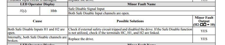

                                  I've added a couple more photos of how I've wired the feed to the vfd . It powered up but I get a H66 error on the digital readout ,the error code comes up as "Safe Disable inputs ". Think it might be time to call a halt to try and use this 3 phase motor , its kinda taken the fun out of things for me now  . 😔😣

                                    Looking at the instructions on page 245 Hbb seems to suggest that you may need to put a link into the safety interloc terminals as it thinks the circuit is open eg a safety microswitch is activated. I can't see a H66 code listed.

                                      Hi Jason. the error H66 is on page 180 table 5.5 ..

                                        Sean. Have you got links in place linking HC,H1 and H2 ?
                                        Martin
                                        Edited By Martin Cargill on 13/08/2017 11:52:01

                                          Posted by Martin Cargill on 13/08/2017 11:50:21:
                                          Martin
                                          Hi Martin ,no I haven't ,was waiting until the rain stopped to go out to the shed LOL

                                          Martin Cargill
                                            @martincargill50290
                                            Ok Try the links and see what happens. I'll PM you my mobile number, although I'm going out so I may not be able to answer.
                                            Martin. P.S. I think that some of your problems with the drive come from it being second hand. Whoever has removed it from its previous installation has probably removed all of the wiring, including some that should have been there when the drive came from the manufacturer (like links to HC,H1 and H2)

                                              Right …Am I linking HC,H1 and H2 all together ?
                                              Sean
                                              #311783
                                                I'm looking at the pdf that KWIL linked to this also suggests you need to link the same connections wheich would have gone to interlocks if you were using them
                                                If you look at the second column above or in your page 180 you will see the code is Hbb not H66, a six would have the bar along the top on a digital screen
                                                  Edited By JasonB on 13/08/2017 13:18:43
                                                  Sorry Jason your right

                                                    This is what you want, a couple of short bits of wire stripped at either end.

                                                      Thanks Martin really appreciate the help from you .
                                                      vfd now up and running
                                                      Sean
