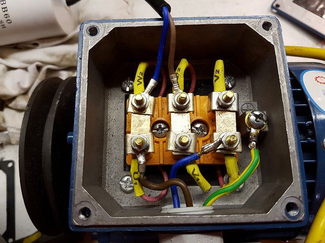

        Hi, just got the motor for centec 2 , the motor is turning the wrong way for the mill . I’ve tried changing over the capacitor wires but motor still turns the wrong way . Motor is a 1hp advantage lite 11, single phase . Heres how its wired just now https://flic.kr/p/WyAwZ3.
        Is there anything else I can try .

          You need to swap over the ends of the motor winding to which the capacitor is connected. Swapping the capacitor wires will do nothing.

                Thanks guys ,I changed the blue wire of the capacitor to the opposite side of the red wire and hey presto motor now turns in the direction I need.

                  The motor is mounted onto the mill now ,so I gave it a wee test run cutting some delrin to start with for about 10-15 min and I noticed the motor started to get warm then hot untill I could barely put my hand on it . Could it be possible seeing as I changed the direction the motor turns this is the cause of the motor getting very hot or is it just goosed .

                    Sean – I assume that your motor was a capacitor start machine. I can't tell from your photo what the various wires connect to in your motor, but it's possible that you have got it connected so that the start winding is permanently energised and not being disconnected by the centrifugal switch (or other starting cut out). I suggest you trace ALL the wires out to see where they are going/coming from. Having the start winding permanently connected will result in overheating and burning the winding out.
                    What you need to do from your original set up is to reverse the polarity of the start winding relative to what it was when you first got it.

                      The opposite side of which red wire? There are 4 on your photo! As Keith says, you need to trace all the wires.
                      When you switch on the motor and it runs, and then you switch it off, do you hear a click as it runs down? If so that is the starter centrifugal switch. If you don't hear it, then the motor may be a "capacitor start and run". Whichever type, if you swap over the connections of the winding to which one end of the capacitor is connected (so the capacitor is in series with the winding) the motor will reverse correctly.

                        You say its a single phase motor but since the windings are labelled U, V and W it looks suspiciously like most three phase motors do.
                        As is happens my Austrian mill was manufactured and supplied as standard with a three phase motor bodged to run on single phase with a capacitor. The mill was known to be hard to start when in the high geared spindle speed because the motor (wired in that way) did not produce its full power. I fitted a VFD and would have to have my arm twisted to go back to single phase.

                          The red and blue at the top of the picture were the the one's I swap first and then I changed the blue wire to the opposite end (the red and blue wires being the capacitor) The power feed cables at the bottom sticking through the casing were wired from a drawing the guy I bought the motor from sent with the motor . Wiring is not my my best subject ,,being colour blind doesn't help either .

                            As you say colour blindness is a hindrance with electrical wiring but that combined with your admitted lack of wiring expertise is a recipe for a (minor) disaster.
                            I am fairly convinced you have a three phase motor and it is possible to run it of a single phase supply. A quick Google search shows many hits of wiring diagrams etc, most also mention that the motor will only produce about two thirds the power of its rating plate specification.

                                As there are 6 wires disappearing into the motor, I'm with Ian, you have a 3 phase motor. Can you post a photo of the motor plate?

                                  I’ve added a photo of the nameplate and it is a 3 phase .

                                        Do what Ian P did. Get a VFD and run your motor as it should be used with a 3 phase supply. This will give you lots of advantages over a single phase motor. There are lots of threads covering this.

                                            Agreed, it is a three phase motor, it can be run on 230v single phase but will probably overheat, as you have found.
                                            The single phase method is called the Steinmetz method. Our friend Google will find quite a few useful results.
