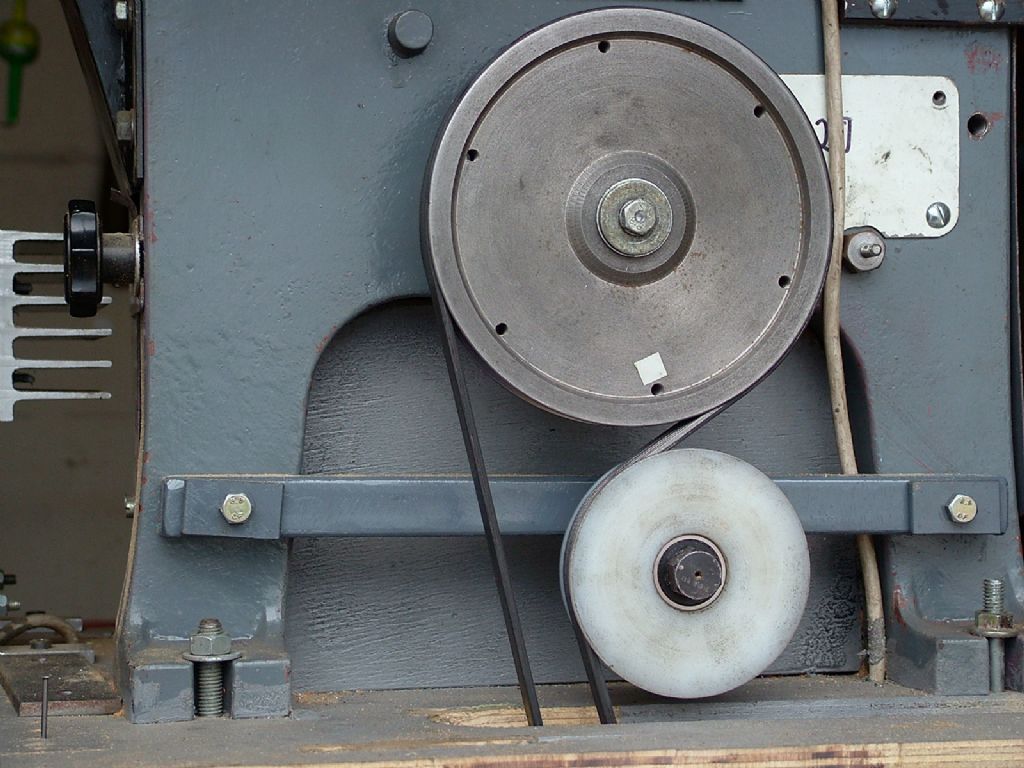

        I have an electric motor the speed is 2850 rpm , I need to reduce the speed of the motor for use on a home built power hacksaw.
        First what speed would you recommend,
        Second where can I buy a gear box to do the job.
        From Tony, thank you for your advice.

                      oldvelo
                        @oldvelo
                        Hi
                        Poly Vee Belts with a countershaft is probably a good option with 4 ribs on the primary drive and 6 ribs on the secondary drive.
                        As Howard points out the small diameter need as big as possible contact area this can be done with a flat idler pulley running on the back of the belt to increase the wrap around.dscf2355.jpg
                        Proper Alignment and correct tension is critical on Poly Vee Belt Drives as any error in alignment they will climb over the grooves as the ribs are quite flexible rubber and unable to keep the belt on the pulleys.
                        Eric
