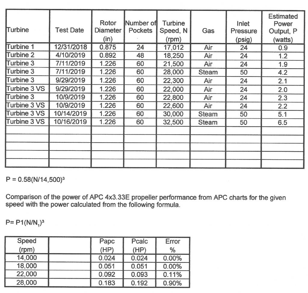

      The following chart shows the updated performance described in the preceding post The values for running with air should be good estimates. I cannot verify the powers shown for the testing on steam but believe they should be reasonably accurate.Turbines Test Results 4

        The testing of the very small propellers can be greatly affected by friction and flow blockage. The following picture shows the large portion of the propellers flow area that is blocked by the relatively large rotor housing. Since the propeller is only about 0.4in. (10mm) away from the housing, the effects of flow blockage might be substantial. I did more research on the effects of Reynolds number and found most other sources showed much less effect than I was calculating using Dr. Balje’s guidelines. Dr. Balje in his summary stated the Reynolds number effects should be minimal for most turbines, so I don’t think I am estimating them correctly. Because of these concerns, I tried another way to estimate the power that will be shown in the next post.Tangential Turbine 3 VS Test

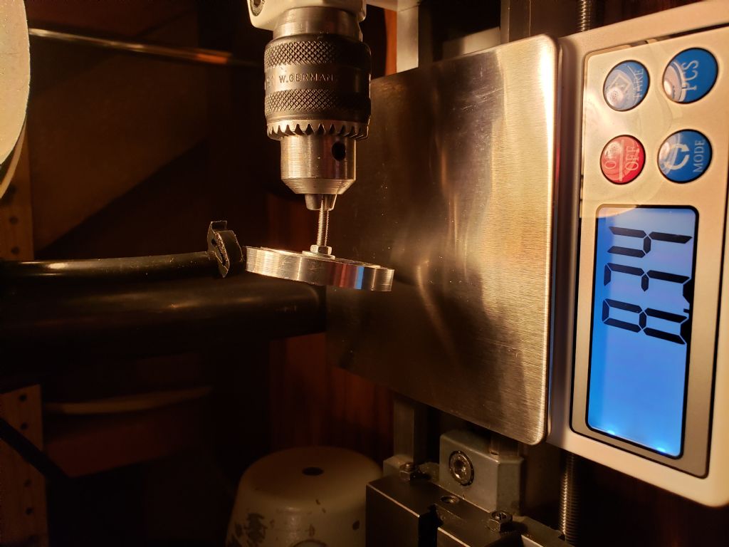

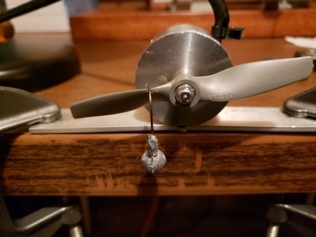

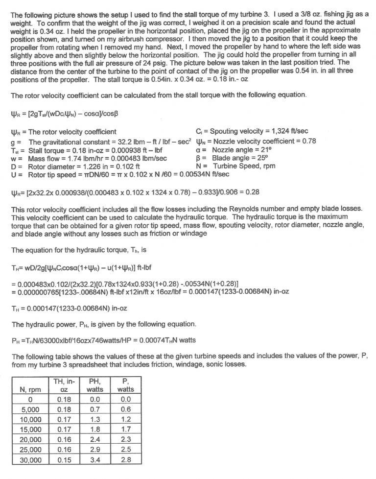

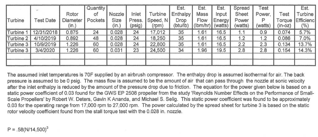

            The following picture shows the setup I used to find the stall torque of my turbine 3. I used a 3/8 oz. fishing jig as a weight. To confirm that the weight of the jig was correct, I measured the jig and used the lengths, diameters, and densities of the steel hook and lead to calculate the weight. The calculated weight was 0.38 oz. I held the propeller in the horizontal position, placed the jig on the propeller in the approximate position shown, and turned on my airbrush compressor. I then moved the jig to a position that it could keep the propeller from rotating when I removed my hand. Next, I moved the propeller by hand to where the left side was slightly above and then slightly below the horizontal position. The jig could hold the propeller from turning in all three positions with the full air pressure of 24 psig. The picture below was taken in the last position tried. The distance from the center of the turbine to the point of contact of the jig on the propeller was 0.54 in. in all three positions of the propeller. The stall torque is 0.54in. x 0.38 oz. = 0.21 in.- oz. The rotor velocity coefficient can be calculated from the stall torque with the following equation.
            ψR = [(2gTst/(wDciψN) – cosα]/cosβ
            ψR = The rotor velocity coefficient
            g = The gravitational constant = 32.2 lbm – ft / lbf – sec2
            Tst = Stall torque = .21 in-oz x ft/12 in x lbf/16 oz = 0.00109 ft – lbf
            w = Mass flow = 1.74 lbm/hr x hr/3600 sec = 0.000483 lbm/sec
            D = Rotor diameter = 1.226 in x ft/12 in = 0.102 ft
            Ci = Spouting velocity = 1,324 ft/sec
            ψN = Nozzle velocity coefficient = 0.96
            α = Nozzle angle = 21⁰
            β = Blade angle = 25⁰
            ψR= [2×32.2x 0.00109/(0.000483 x 0.102 x 1324 x 0.96) – 0.933]/0.906 = 0.21
            Torque Test

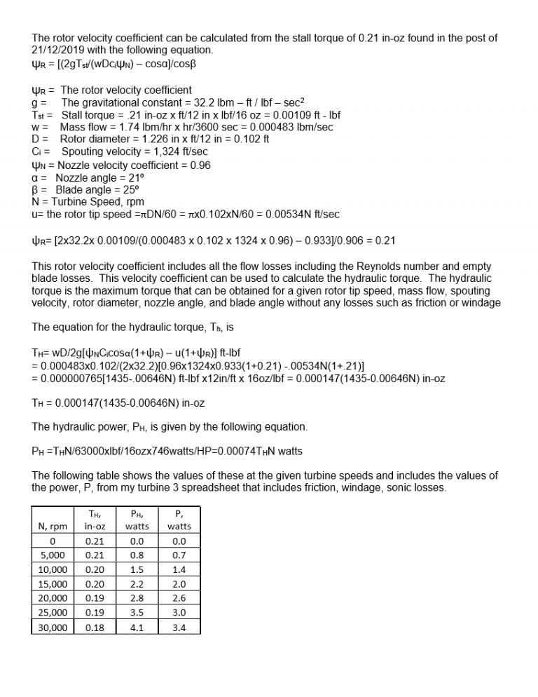

                    The rotor velocity coefficient of 0.21 found in the post of 21/12/2019 includes all the flow losses including the Reynolds number and empty blade losses. This velocity coefficient can be used to calculate the hydraulic power. The hydraulic torque is the maximum torque that can be obtained for a given rotor tip speed, mass flow, spouting velocity, rotor diameter, nozzle angle, and blade angle without any losses such as friction or windage. All of these parameters except the rotor tip speed were given in the 21/12/2019 post and are shown again below.
                    The equation for the hydraulic torque, Th, is
                    Th= wD/2g[ψNCicosα(1+ψR) – u(1+ψR)]
                    = 0.000483×0.102/(2×32.2)[0.96x1324x0.933(1+0.21) -u(1+.21)]
                    = 0.000000765[1435-1.21u) ft-lbf x12in/ft x 16oz/lb
                    =0.000147(1435-1.21u) in-oz
                    u= the rotor tip speed, ft/sec
                    u= πDN/60 = πx0.102xN/60 = 0.00534N
                    N = Turbine Speed, rpm
                    Th = 0.000147(1435-1.21×0.00534N) in-oz
                    Edited By Turbine Guy on 21/12/2019 20:10:07

                      The hydraulic power, Ph, is given by the following equation.
                      Ph =ThN/63000xlbf/16ozx746watts/HP=0.00074ThN watts
                      Ph = 0.00074ThN, watts
                      These are the equations for the hydraulic torque and power for my turbine 3 at the maximum output of my airbrush compressor.  I will add a table showing the values of these at  given turbine speeds and include the values of the power, P, from my turbine 3 spreadsheet that includes friction, windage, sonic losses.
                      Edited By Turbine Guy on 21/12/2019 20:30:51

                                I weighed the 3/8 oz. jig used to find the stall torque in the post of 21/12/2019 on my precision scale and the actual weight is 0.34 oz. The following sheet shows the update to my estimated performance using this weight and assuming the maximum velocity of the nozzle to be sonic as discussed in the last post. These changes brought the estimated performance very close to that found using the propeller power coefficient described in the post of 7/12/2019. The following is Revision A .
                                Turbine 3 Hyd. Power A
                                #450224
                                Turbine Guy

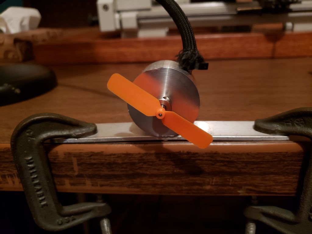

                                  @turbineguy
                                  The following picture is the one referred to in the last post.Torque Test

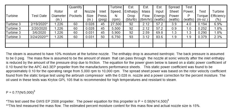

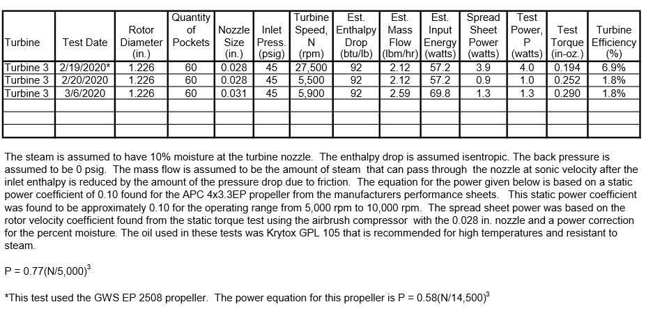

                                      The following table is the test results for turbine 3 running on steam. I added the mass flows, input energy, torque, and efficiency for comparison with the test results running on air shown in the last post. I added the torque to the chart because it is much more relevant when I use a larger propeller. The propeller speeds were getting higher than the speeds I could verify the required power of my GWS EP 2508 propeller, so I decided to use an APC 4×3.3 EP propeller for tests with steam. Because the larger propeller requires more torque to turn, the resulting maximum speeds will be much lower and consequently the power and efficiency. With the propellers, the torque is the best measure of performance. For a given energy level, any improvement will increase the stall torque regardless of the size of the propeller. Once the stall torque is determined from testing, the power can be estimated for higher running speeds using the formulas shown on the stall torque test described in the post of 01/02/2020. I tried Krytox GPL 105 oil that Werner Jeggli recommended, and it appears to be working well with my shielded ball bearing. The oil is very viscous when cold but thins out with the steam temperature. I put a small quantity of oil on the outside face of each ball bearing before each test with steam. The oil appears to be getting into the ball bearing through the shields and each run required a short time for the oil to thin out and reach the optimum amount in the bearing. Once the optimum conditions were met, the turbine ran almost constant speed for several minutes. I ran three tests with the 0.031 in. nozzle and the difference in turbines speeds was less than a 100 rpm and the total run time for the three tests was about a half hour. Now that I am getting consistent test results for the 0.031 in nozzle, I will try to come up with a method to measure the mass flow.
                                      Turbine Test Results 7
                                      #456948
                                      Turbine Guy
                                        @turbineguy

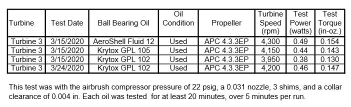

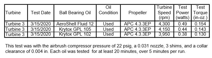

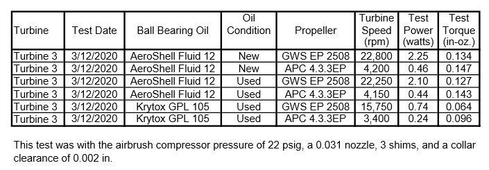

                                        The following table is a test of the ball bearing oils used in my turbine 3. The ball bearings are supplied with AeroShell Fluid 12 oil. I compared the performance of new bearings with this oil to the performance of bearings with this oil that had been run for quite a while on air and never exposed to steam. I also compared these with ball bearings that had Krytox GPL 105 oil added and had been run on steam for quite a while. Because my turbine 3 is very sensitive to the position of the rotor relative to the nozzle, I ran all these tests with 3 shims and a clearance between the set screw collar and the bearing of 0.002 in. This ensured that the position of the rotor relative to the nozzle was within 0.002 in. for each of the tests. This is not the optimum position for both propellers, so the powers achieved in this test are not as high as I have obtained running on air. The loss in power with the Krytox GPL 105 oil is due to very high viscosity at room temperature that is approximately 14 times as much as the AeroShell Fluid 12 oil at room temperature.
                                        Oil Test
                                        #456998
                                        Turbine Guy
                                          @turbineguy

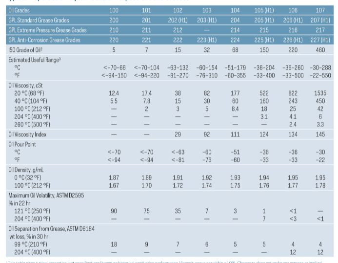

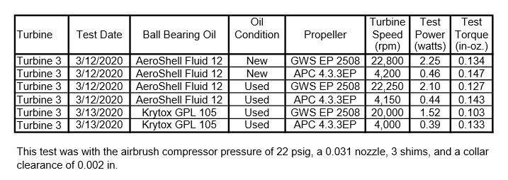

                                          The low power for the tests with Krytox GPL 105 oil in the ball bearings shown in the last post seemed lower than expected. I ran several more tests with the Krytox GPL 105 oil and each of my propellers. I found that if the turbine was run for several minutes the speed would go up in small jumps as the thick oil thinned out and got pushed into the optimum position. The first test with each propeller took the longest to obtain the maximum speed. Each later test took progressively shorter time to reach maximum speed. Once the maximum speed was reached, the speed would stay approximately the same for the rest of the time of the test. I repeated the tests several times and each time, the maximum speed stayed approximately the same. The following chart is updated to show the results of these tests and is more like what I expected.
                                          Oil Test 2

                                              I decided to test the three different oils discussed in the last post for a running time long enough to see how their performance holds up. I decided that a total run time of over 20 minutes would give an indication of their live expectency and consistency. I also decided to run all the tests with the APC 4×3.3 EP propeller since it is what I plan to use for future testing. I made one short run with the GWS EP2508 propeller with the AeroShell Fluid 12 oil at the end of the tests with this oil. The maximum speed reached was 24,500 rpm, the highest speed I have been able to obtain with this propeller running on air. This showed the maximum power was still the same after running quite a while with this oil. The maximum speeds for the APC 4×3.3 EP propeller for all the oils were at least as high as when the oil was new. The following table gives the results of these tests. The Krytox GLC 102 oil did not perform as well as I hoped. I don’t know if this is because of the way I added it or if the oil is not as suitable for my application. I can’t remove the shields from the bearings I use, so I tried removing the existing oil by soaking the bearings in Acetone and then adding the new oil by letting it seep into the bearings through the small gap in the shields. I don’t know how effective that was in removing the old oil or adding the new oil. When I added the Krytox GLC 105 oil I didn’t do anything to remove the existing oil and just relied on the steam to flush it out or the existing oil to be compatible. I applied a small amount of Krytox GLC 105 to the faces of the ball bearings before each run with steam which appeared to work for adding this oil. Even with the much higher viscosity at low temperatures, the Krytox GLC 105, worked better than the Krytox GLC 102 running with air. Based on these tests, I believe the ball bearing as supplied with the AeroShell Fluid 12 will work fine and have adequate life when running on air. The Krytox GLC 105 appears to work well with steam and results in only a small loss in power running on air. I will use the ball bearings with the Krytox GLC 105 for all my tests that don’t require the maximum power running on air.
                                              Oil Test 3

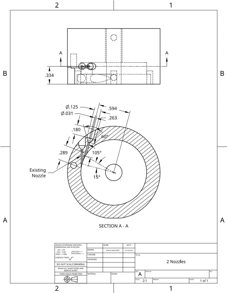

                                              Turbine Guy
                                                @turbineguy
                                                Since my turbine 3 has multiple openings required for the different options, I can’t channel all the steam into an exhaust tube and measure the mass flow by cooling and collecting the exhaust. I thought I would try making a second nozzle as shown in the following drawing. This would increase the flow and drop the pressure in my boiler below the pressure the relief valve opened. All the mass flow out of the boiler would then go through the turbine nozzles. With the wick type of burner I use, I can run the boiler until it is empty before pulling out the burners. I can then fill the boiler with a measured amount of water and make my test run the amount of time to boil out all the water. This was the plan, unfortunately even with my very careful setup the drill drifted out of position and the second nozzle could not be used. Fortunately, I am still able to use the existing nozzle. I ran a test with steam to check if there was any damage to the existing nozzle and the maximum speed stayed at almost a constant 6,150 rpm for the approximately 7 minutes of the test. This is slightly higher than the maximum speed of 5,900 rpm I was able to obtain in prior tests with steam at approximately 45 psig, with the APC 4×3.3 EP propeller, and using Krytox GLC 105 oil. More of this oil was able to get inside the shielded ball bearings since the speed running on air after the test with steam was lower than before the test with steam. I am expecting the speed to gradually increase when running on air after the oil wears and thins out like it has after prior tests with steam.
                                                2 Nozzles

                                                  Turbine Guy
                                                    @turbineguy
                                                    I updated the turbine test results for running on steam as shown in the table below. As described in the last post, fixing the safety valve on my boiler stopped the leakage and allowed the pressure to get high enough that all the flow went to the turbine. This allowed me to measure the mass flow and estimate the actual percent moisture. The estimated 15% moisture found in this test was higher than the 10% I had been assuming.
                                                    Turbine Test Results 8
                                                    #459799
                                                    Werner Jeggli
                                                      @wernerjeggli14222
                                                      Hello Byron,
                                                      I do not understand why the turbine is running at such a low speed. With steam and at this pressure, this should be in the vicinity of 30'000 rpm. The torque will stay approx. the same, but the power output will rise proportionally.
