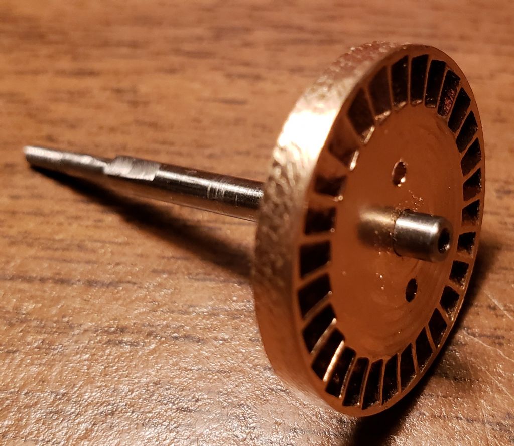

      I finished Drag Rotor 2 as shown in the following photo. Machining the rotor would have been very easy if I had done all the machining with the cast rotor not taken out of the chuck until all the critical machining was finished. Holding the cast rotor by the round part that extended from the back face of the rotor allowed enough room to machine both faces and the OD to their final dimension after reaming the bore. Because I got what I thought would be a strong enough press fit, I decided to cut off the excess length of the extension and then press fit the rotor to the shaft for the final machining. My hacksaw slipped while cutting off the extension and I ended up with not enough length of the hub to run a pin through. I had to rely on the press fit of the rotor without most of the hub. This gave enough strength to machine the front and back face of the rotor but the wave in the OD caused enough force to break the press fit. The holes added were for pins I used to go through the rotor and into a clamping collar that gave me enough grip to turn the OD. I then used part of the cut off extension that had the reamed hole to make a collar the right length to get the hub back to it’s intended length. I ended up with rotor and shaft machined to the dimensions I needed but could have saved myself a lot of work. The cast housing and end plate have been shipped from Shapeways and will arrive soon. Hopefully, I will do a better job with them.
      Drag Rotor 2-2

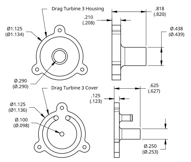

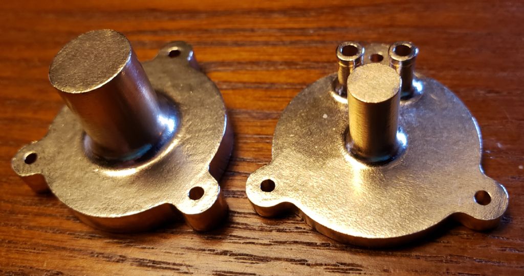

      Turbine Guy
        @turbineguy
        The castings for the Drag Turbine 3 Housing and Cover arrived and are shown in the following photos. They came in jewelry bags like the rotor casting. Before setting these up for machining, I made a few measurements to check the shrinkage. The drawing showing these dimensions will added in the next post. Overall, the castings looked very good, and when the cover is placed on the housing all the holes and edges line up nicely. I opted for a natural finish, so the cleanup might have polished some of the surfaces.
        Housing & Cover CastingsHousing & Cover Castings 2
        #521317
        Turbine Guy
          @turbineguy
          This is the drawing mentioned in the previous post. The upper dimension is the size that would be obtained by a uniform 2% shrinkage. The lower dimension in parenthesis is the actual measured dimension. Each actual measured dimension was taken in several places and the average was used. This should give a reasonable indication of what to expect assuming 2% shrinkage with these types and sizes of bronze castings. As can be seen in the drawing the actual shrinkage varies. The worst deviation was on the wide thin portion, the OD of the housing and cover flanges. These dimensions were from 0.009” to 0.011” larger than they would be with a perfect mold and uniform 2% shrinkage. All the other measured dimensions were within +/- 0.003”, which is excellent in my opinion.
          Cast Dimensions

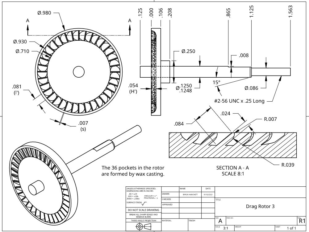

            Turbine Guy
              @turbineguy
              While waiting for my collet set to arrive, I made the following changes to Drag Rotor 3 shown in the drawing below. I cleaned up my method of forming the blades to utilize the options I have with castings. Instead of modifying the solid model made for machining the rotor with a keyway cutter, I designed the blades from the start for casting. I also changed the end of the blades from 0.3mm radius to a 0.18mm radius with a 1mm radius lead in edge. As you can see from the drawing, the 0.6mm thickness must be used for most of the length of the blade. Shapeways allows a minimum thickness of 0.35mm providing the length is no longer than 0.35mm. I was also able to reduce the maximum blade depth H’ to its optimum value. This allowed me to increase the number of blades. These changes should help if I decide to try another rotor.
              Drag Rotor 3 R1

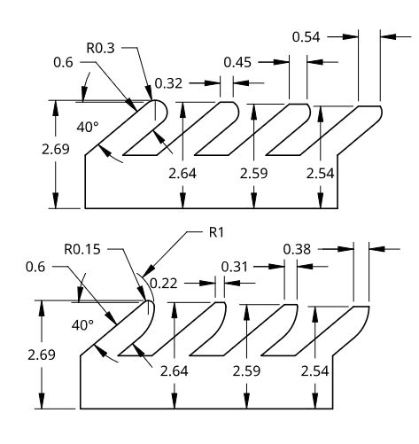

              Turbine Guy
                @turbineguy
                The following drawing shows the advantage of the smaller radius at the tip of the blade when cleanup of the casting is required. When the face of the rotor is machined, a flat is formed at the end of the blades. The more the face is machined, the wider the flat becomes. The drawing dimensions are in millimeters and the blades are shown as if they were running in a straight line. The top set of blades is with the 0.3mm radius I originally planned to use on Drag Rotor 3 as shown in the post of 06/01/2021. The bottom set of blades is what is shown on the drawing of the preceding post. I show the amount being taken off the face in 0.05mm increments as the blades proceed from left to right. The width of the flat on the existing Drag Rotor 2 is 0.38mm so only a little over 0.05mm can be taken off the 0.3 radius without exceeding this. Up to 0.15mm can be taken off the 0.15 radius without exceeding the flat width of the existing blades. The efficiency of the drag turbine is reduced significantly if the flat gets too wide so the minimum amount of cleanup of the face of the rotor should be used.
                Blade Ends

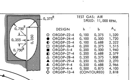

                Turbine Guy
                  @turbineguy
                  I read through the section on Drag Turbines again in ‘A Study of High Energy Level, Low Power Output Turbines’ done for the Office of Naval Research in 1957. This study concluded that the increased drag on the rotor was due to the corkscrew rotation of the flow into the bottom of the blades and out of the top of the blades into the flow channel as discussed in the 09/12/2020 post in this thread. This study also stated that the drag coefficients were independent of the rotor speed that had been confirmed with tests of the stall torque. I designed Drag Turbine 3 based on the concept used by Spencer in their Vortex Regenerative Blowers as shown in the 09/12/2020 post and below. I thought that the Spencer concept would increase the rotation of the gas due to the flow being guided back into the flow channel by a radius rather than being discharged onto a flat surface like shown for the two-sided impeller. The two-sided impeller was the type used in the study and the drag coefficients were developed for. If the corkscrew rotation of the flow is what causes the higher rotor drag coefficient and the rotor drag coefficient is independent of rotor speed, the corkscrew flow must be established even with the rotor stationary. Comparing the one-sided and two-sided impellers, I can see that any flow from the stationary channel that enters the two-sided impeller is guided towards the OD of the impeller. This would start the flow moving in a corkscrew direction even with the impeller stationary. For the one-sided impeller, any flow from the stationary channel that enters the impeller is guided toward the center of the blades when the impeller is stationary. I assumed that the centrifugal force would start the flow moving out the outer part of the blade when the rotor got to the higher speeds and provide the necessary circulation. In the next post I will show a source with test results for these two concepts.
                  Spencer Regenerative Blower

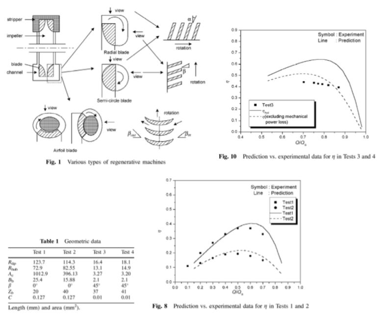

                  #526230
                  Turbine Guy
                    @turbineguy
                    The following figures and table are copied from ‘A modified theory for the flow mechanism in regenerative flow pump’ by J. W. Song, A Engeda, and M. K. Chung from the proceedings of the Institution of Mechanical Engineers, Part A: Journal of Power and Energy 2003 found at this Link. The best efficiency for the radial blades like used in Dr. Balje’s reports is shown in Fig. 8 Test 2. The best efficiency for the semi-circle blade like my Drag Turbine 3, is shown in Fig.10. Table 1 gives the dimensions of these pumps. Rtip is the radius to the tip of the blade or channel, Rhub is the radius to the hub of the blade or channel, Ac is the area of flow channels, Bb, is the effective width of the blade channel, β is the blade angle, Zb is the number of blades, and C is the clearance. Q/Qs is the ratio of the flow to the solid rotation flow. You can see from the figures that the peak efficiency of the semi-circle blades is slightly higher, but the estimated performance of the radial blades is much closer to the test values.
                    Drag Pump Data

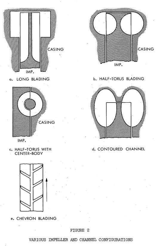

                      #529187
                      Turbine Guy
                        @turbineguy
                        The attached figure shows the contoured blading that gave the best efficiency of the long blading discussed in the last post. The tests with the Chevron blading (Figure 2(e) in the last post) showed a maximum efficiency of 43% with blade angles of 45 degree. The maximum efficiency for 90 degree blades from these same tests was 40%. This confirmed Balje’s findings that the optimum efficiency was with blade angles from 40 to 45 degree, but had much less difference in efficiency with 90 degree blades as shown in the following table. Contoured BladesChevron Blades

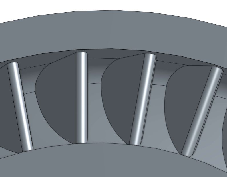

                          The following picture shows the changes to the blades of Drag Rotor 3 in revison 2. I am trying to optimize Drag Rotor 3 based on everything I learn before making a casting. The following changes were made to revision 1. I made the slope from the bottom of the blades to the top of the blades similar to the contoured blades in the last post. The intent of this was to bias the flow direction toward the top of the blades to help start the circulation. I also recessed the front edge of the blades 0.010” back from the front of the rotor so that the major portion of the front could be cleaned up before any contact with the blades. I added a chamfer at the outer edge of the back face of the rotor to give a clearance for the point of the cutting tool when turning the housing bore. I shorted the length of the boss used for adding the metal during casting to reduce the amount of material required. All these changes were made to hopefully improve the performance, make the machining easier, and reduce the cost. Unless I find any further improvements after finishing the machining on the existing castings, this is what I plan to order next from Shapeways.
                          Drag Rotor 3 R2 Blades

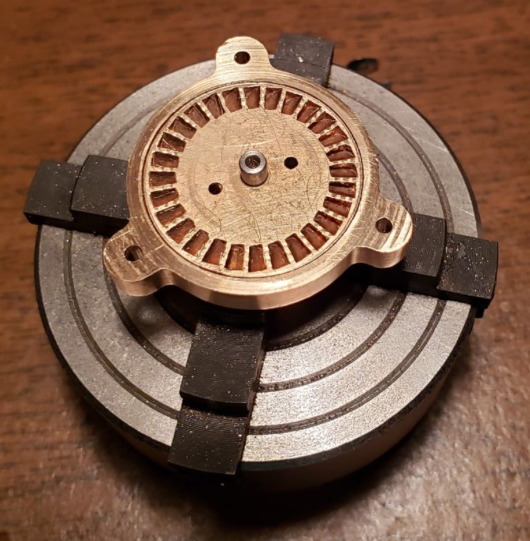

                          Turbine Guy
                            @turbineguy

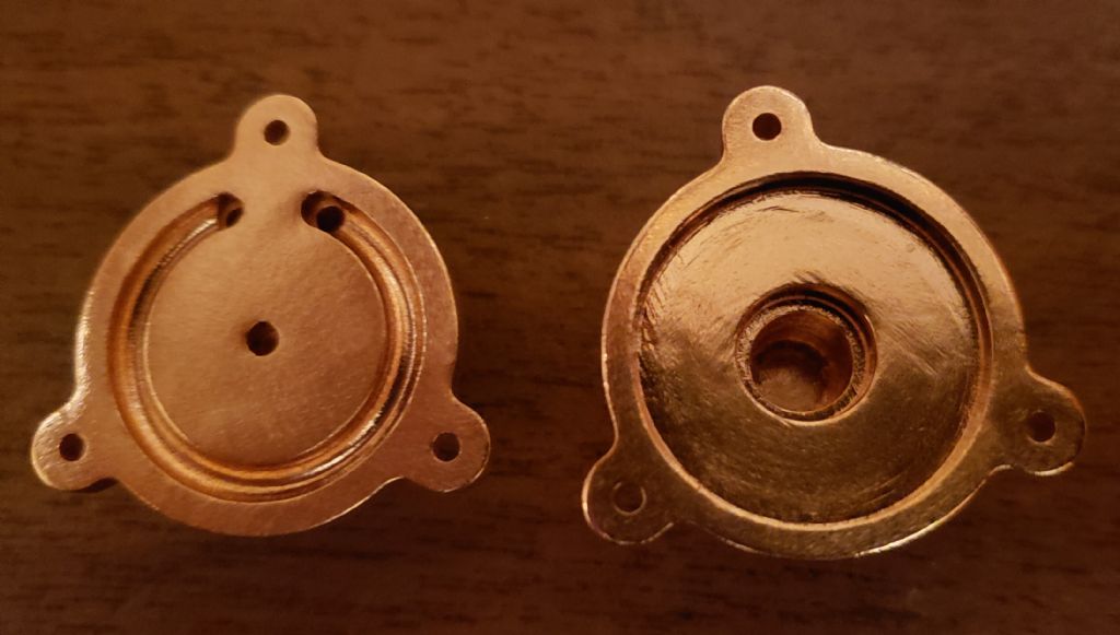

                            My new collet set arrived, so I finished more machining of the Drag Turbine 3 Housing. The housing was designed so that all the critical machining could be done without removing the casting from the 4 jaw chuck. This keeps all the bores as concentric and the faces as perpendicular to the centerline of the housing as possible. After I reamed the bore for the ball bearings, I inserted one of the ball bearings and checked the fit. It was a very tight locational fit that required a light push to insert or remove the ball bearing. After all the other machining of the faces and bores, I placed the rotor in the housing to see what the clearance of the outer face of the rotor was to the outer face of the housing. With the inner face of the rotor against the inner face of the housing, the clearance was less than 0.003” (0.08mm). A 0.003” feeler gage would not slide into the gap but a 0.002” feeler gage would slide in. This is very close to the 0.002” (0.05mm) total clearance I was hoping to get. While the housing is still in the 4 jaw chuck, I added shims between the ball bearings extended inner race and face of the rotor hub. I then pushed the assembly into the housing. With five 0.001” (0.025mm) shims, the inside face of the rotor cleared the inside face of the housing and the rotor would spin a few times when flicked with a finger. When I measured the clearance of the outer face of the rotor to the outer face of the housing, a 0.002” feeler gage could not be inserted. The following picture shows the rotor in the housing when the last measurements were made. I am very pleased with the results of the machining of the critical surfaces. It is a testament to the quality of the Unimat 3 and the EMCO accessories.
                            Rotor in Housing

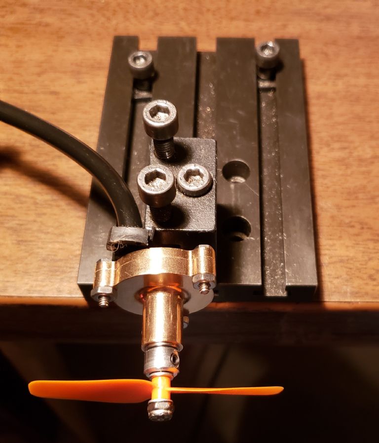

                            #532325
                            Turbine Guy
                              @turbineguy
                              I reamed the ball bearing bore in the Drag Turbine 3 housing using a drill chuck like I did on my other turbines before I decided to order the collet set. When I machined the cover plate and mounted it on the housing with the rotor and both ball bearings, there was some binding when I tried turning the shaft. After receiving the collet set, I found a way to true up the faces of the housing to make them more perpendicular to the axis of the ball bearing bore. This allowed the rotor to spin freely with the cover bolted tight to the housing. I added shims until I got the rotor as close to the cover as I could without any binding. When I tried running the turbine on air, the rotor didn’t spin. This indicated that the air pressure was tilting the rotor enough to contact on one or both faces. When I removed a single 0.001” thick shim, the rotor was free to spin under pressure, but the tilting opened up the clearances and reduced the pressure to about 5 psig. When I pushed on the end of the rotor shaft with the air brush compressor running, the pressure raised to about the 10 psig. 10 psig was the estimated pressure using O.E. Balje’s guidelines for Drag Turbine 3. The small diameter of the rotor shaft and the relatively long spacing between the ball bearings is probably what is allowing the rotor to tilt under pressure. Putting ball bearings on both sides of the rotor would probably be the best way to eliminate the tilting if the flow channel is on one side only. Putting the flow channel on both sides of the rotor would also help but would eliminate many of the advantages of the single side flow channel. With the pressure being only half of the design pressure, the maximum speed of the GWS EP 2.5×0.8 propeller was 18,500 rpm. The power required by this propeller at this speed is approximately 1.2 watts. There appears to be a lot of room for improvement of Drag Turbine 3, so don’t give up on the concept yet. The following picture is the Drag Turbine 3 setup for the first test. I want to wait until after all the changes to the housing and cover plate before I design a support bracket.
                              Drag Turbine 3 Test 1

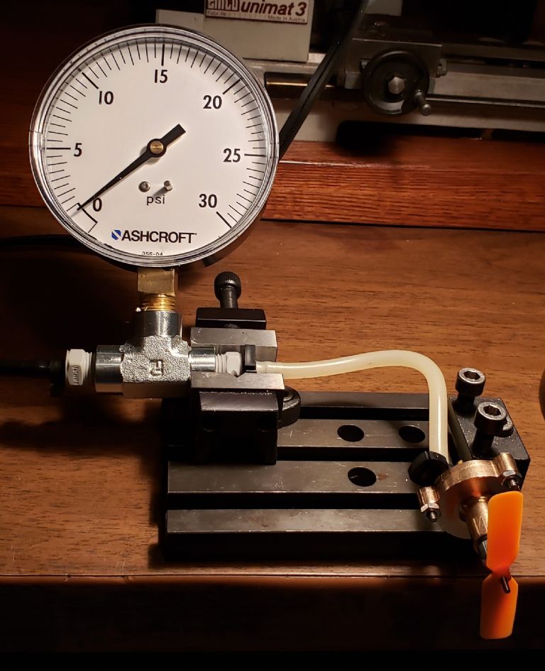

                                Turbine Guy
                                  @turbineguy
                                  I bought a 0-30 psig pressure gauge with increments of 0.5 psi in order to get more accurate readings at the very low pressures. The following picture shows my test setup with the new pressure gauge. The large 3.5” diameter dial and +/- 0.3 psi accuracy will really help. I made the following four pressure measurements. First, I measured the pressure with the cover plate removed and pressed tight against a flat surface. The pressure was approximately 2.5 psig. That is the pressure required to push all the flow through the existing channel size with smooth walls on all sides. The second measurement was with the cover plate bolted tight to the turbine housing with the rotor supported by the ball bearing but pushed tight against the cover plate. The pressure was approximately 9.5 psig. That is the pressure required to push all the flow through the existing channel size with blades and without leakage. The 7 psig increase in pressure was due to the resistance to flow that the blades cause. The third measurement was with the 0.007” total thickness of shim washers keeping the face of the rotor as close to the face of the cover plate as I was able to do without any contact. The pressure was approximately 5.0 to 6.5 psig dependent on the rotor position. That is the pressure required to push all the flow through the existing channel size with blades and with leakage. The flow channel area was sized per Dr. Balje’s guidelines to require 10 psig air pressure with very small leakage. The forth pressure measurement was with everything the same as the third measurement except with the turbine running at a speed of 18,500 rpm. I was able to reach that speed again with the GWS EP 2.5×0.8 propeller. The pressure was approximately 4.0 psig. Dr. Balje’s testing indicated the pressure should stay almost constant for speeds from stalled to design speed for his type of drag turbine. My tests showed approximately a 2.0 psi drop in pressure from average stall pressure. The leakage is the most significant problem needing to be resolved and the drop in pressure with rising speed is the second concern.
                                  Drag Turbine 3 Test 2

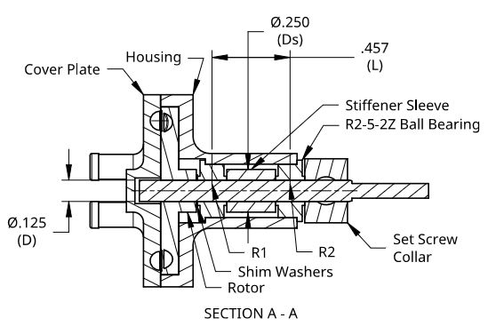

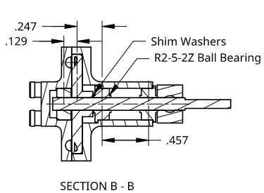

                                  Turbine Guy
                                    @turbineguy

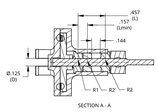

                                    The following drawing is a section view of Drag Turbine 3 showing the dimensions needed for evaluating deflection. The diameter of the shaft (D) and the spacing between bearings (L) are two things that can be changed on this turbine without changing the cover plate or housing. The deflections change in direct proportion to the change of the moment of inertia (I) and for shafts I = πD^4/64. Three ball bearings of the type used in Drag Turbine 3 are available that will fit in the existing bearing bore and have the following nominal shaft sizes 1/8”, 5/32”, and 3/16”. Since the moment of inertia varies with the fourth power of shaft diameter, changing from the 1/8” shaft to a 5/32” shaft would increase the moment of inertia by a factor of 2.44. Likewise, changing from the 1/8” shaft to a 3/16” shaft would increase the moment of inertia by a factor of 5.06. Changing the shaft size will require modifying the existing rotor but could find what shaft size works best for this turbine. The downside of increasing the shaft size is the torque required to turn the ball bearings goes up with increased shaft sizes. The spacing between the bearings (L) could be changed by inserting a ball bearing without the flange in between the two existing ball bearings. The reduction in deflection is directly proportional to L, so placing the added ball bearing right next to the ball bearing closest to the rotor could reduce the deflection considerably. The downside to shortening the distance between bearing centers is that the load on the bearings increases in direct proportion to the reduction in center spacing. Having the extra ball bearing may result in the stiffest arrangement being with the center bearing moved more to the center.
                                    Bearing Spacing

                                        #535461
                                        DrDave
                                          @drdave
                                          Byron,
                                          If you removed bearing R2' and increased the shaft diameter between the remaining two bearings, that would give you a small increase in stiffness. The biggest increase in stiffness would come from adding a bearing in the left hand housing, on the opposite side of the turbine from the existing bearings: is there a reason that you cannot do that?
                                          And keep up the good work. It is fascinating watching your development process.
                                          #535467
                                          Turbine Guy
                                            @turbineguy
                                            Hi Dave,
                                            I looked at what you suggested. The following drawing shows the way I think you intended to move the bearing. This would be the best solution but would require a new cover plate, since a ball bearing won't fit in the existing cover plate. I ordered the flangeless ball bearing and it is supposed to arrive tomorrow. I'm going to try using it between the existing bearings first since it doesn't require a change to any of the existing parts.
                                            Thanks for the feedback,
                                            ByronBearing Spacing 2

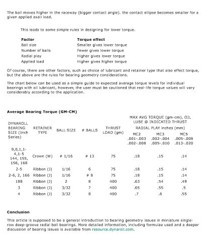

                                              I looked at the friction torque of the three ball bearings that will fit in my existing Drag Turbine 3 housing. Dynaroll is the supplier of the ball bearings and gave the guidelines shown below for the resistance torque. The 1/8” shaft size ball bearing has a total of 6, 1/16” diameter balls. The 5/32” and 3/16” shaft sizes ball bearings have a total of 10, 0.039” diameter balls. The load on the ball bearing closest to the rotor is the largest and is primarily axial with bending moment. The smallest shaft size has fewer but larger diameter balls so the reduction in torque for a smaller number of balls is offset by the larger ball size. Likewise, the larger shaft sizes have more but smaller diameter balls so the reduction in torque for smaller diameter balls is offset by the larger quantity. The pitch diameter of the balls in the bearing with the 1/8” diameter shaft is 0.227” and for the bearings with the larger shafts is 0.253” so that is not much of a factor. It appears that the resistance torque of the ball bearings will be about the same regardless of shaft size. The resistance torque of ball bearings is normally considered insignificant, but I found in the testing of my other turbines it can affect performance. I was able to gain an additional 0.8 watt of power just by balancing the rotor as discussed in the post of 30/05/2020 Link. The following was copied from that post.
                                              "When I first put a shaft in the cast rotor Werner Jeggli gave me, I was anxious to test it and ran the test before balancing the rotor. The maximum speed running on air for the unbalanced rotor was 18,000 rpm. The maximum speed running on air for the balanced rotor was 21,500 rpm. This is an increase in power of approximately 0.8 watts due to balancing".
                                              Ball Bearing Torque

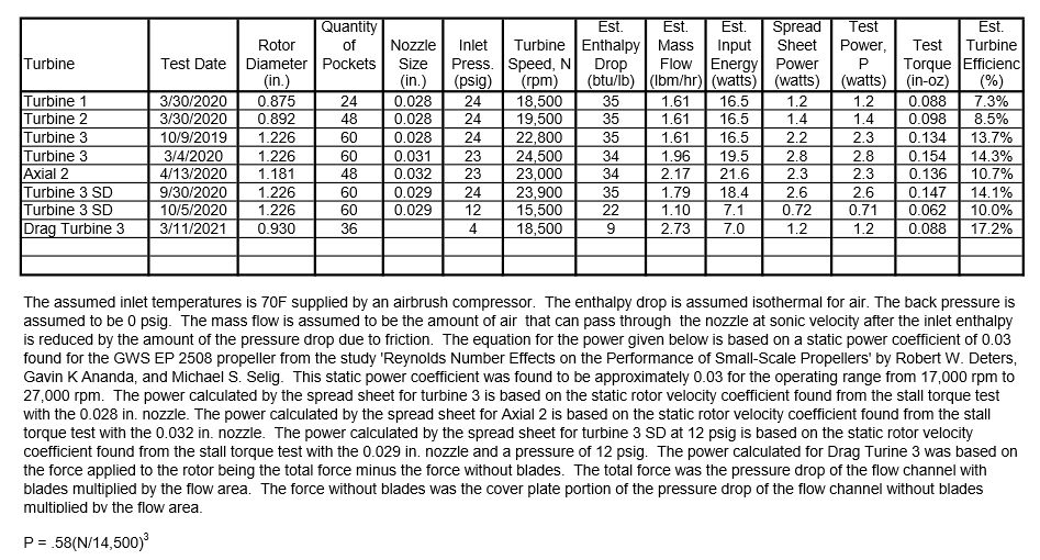

                                                    I updated the following table to include the performance of Drag Turbine 3 running on air. It is interesting that it had one of the lowest power outputs but was the highest in efficiency. The higher efficiency of the drag turbine compared with the impulse turbines at very low pressures and speeds is what attracted me to this concept. I still believe it can outperform my impulse turbines running on my airbrush compressor, if I can reduce the leakage. My airbrush compressor can't supply enough air to get the pressure up to the design pressure of 10 psig with the existing leakage. My new cast rotor is scheduled to arrive late today. I’ll see if what I believe to be design improvements and hopefully better machining will get me closer to my goal with Drag Turbine 4.
                                                    Turbine Test Results 13
