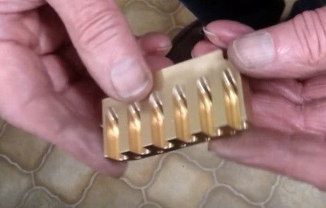

                                        The Mk3 VH on my Centec 2B can tilt 90° in either direction. I seldom use it, but one job I did would have been very difficult without it. The 6 slots in the the photo are rounded and were milled with a ball-end cutter with the head tilted at 43°. I'm not sure how to do it without tilting the head, and ensuring a smooth transition between the angles.
