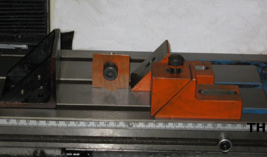

      I require some clamping for a 8" x 9" x 5" thick 2014 aluminium I need the top to be clear to machine a flat surface I don't want to drill or put slots etc. in it for clamps yet.
      Have looked at T slot clamps that would put downward pressure on the edge of the block for light milling and thought about making similar type of clamps but require simple clamps as I don't want to spend too much time making tooling for a one off job.
      Suppose if available a cheap pair of removable vice jaws to clamp on the milling machine table would work.
      For a one off expensive tools or clamps are out.
      Suggestions of a simple clamping arrangement and maybe a drawing would be appreciated.

          The simplest I can think of is use 4 to 6 standard clamps and move them out of the way as the job progresses

                For clamping larger work I use these home made clamps:
                I clamp the work between one or two angle plates and the clamps. The photo shows one clamp dismantled.

                  Could you not get 2 pieces of 1/2 inch thick bar ( could be a bit thinner) 9 inches long & pass 2 pieces of 8mm studding through them each end, each with a nut & washer on the ends, so the studding just clears the sides of the block. ( possibly have some shims to protect the side of the block from the studding threads).
                  The bars would be on opposite sides of the stock. Then really tighten them to the block a couple of mm up from the bottom. Then use ordinary clamps to hold the 2 bars down.

                    Another vote for angle plate/plates

                      Thanks for the suggestions I like Thor's clamps I tried to read JS link but get This page can’t be displayed.
                      Looking through my materials (scrap) I found some steel to make Thor's type of clamps or a crude pair of removable vice jaws.

                                        Made some clamps and used them today holding 8" x 9" x 5" 2014 aluminium really stretching the VMC but will overcome it's limitations.

                                                Used the clamps today on the ally block to machine datum faces used fly cutter removing about 0.006" to clean and align faces.
                                                Next will get the boring head out and bore the Ø85mm bearing housing and Ø166mm crankshaft mouth there will be a lot of swarf.
