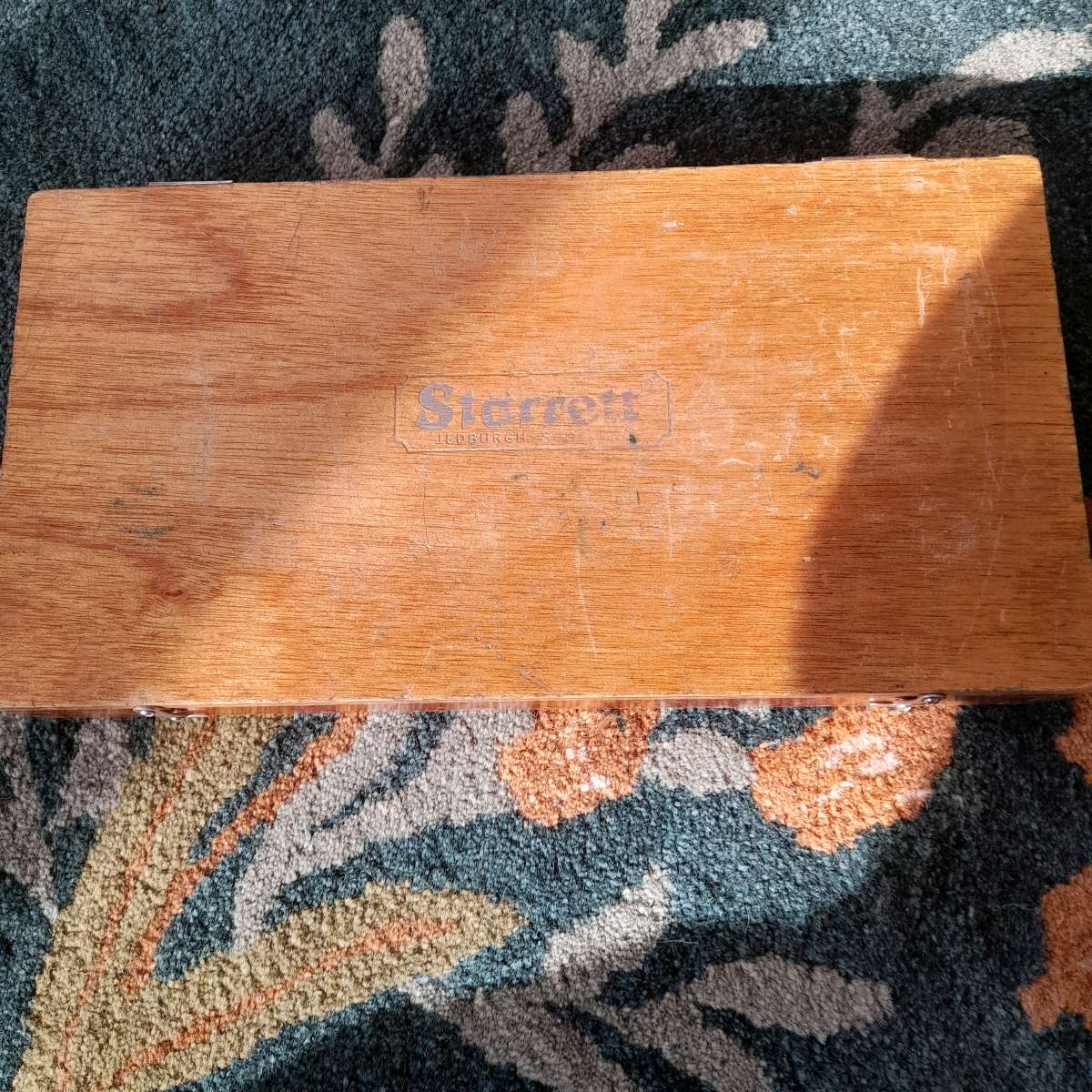

      Evening all. I’ve been lucky enough to obtain a Starrett micrometer in mint condition, Unfortunately the original box it came in looks like it had been used in a pass the parcel game around the workshop and the music never stopped! It’s absolutely filthy, oily, grease & grime. Question is how would you go about cleaning it? I would like to keep what is left of the varnish and logo so solvent, I suspect is out of the question. Would wood soap work? any thoughts appreciated.
      thanks all, regards. Paul

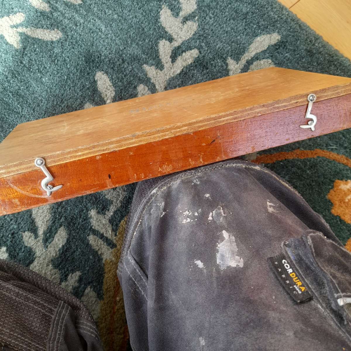

                Hi all, thanks for the replies, John the top is ply by the looks of it and the bottom is the usual routed out mahogany. I’m not bothered about it being showroom condition. I would just like it to be nice and clean without destroying what is there if you get what I mean. I had also thought about using car upholstery cleaner, the one’s in a spray can.

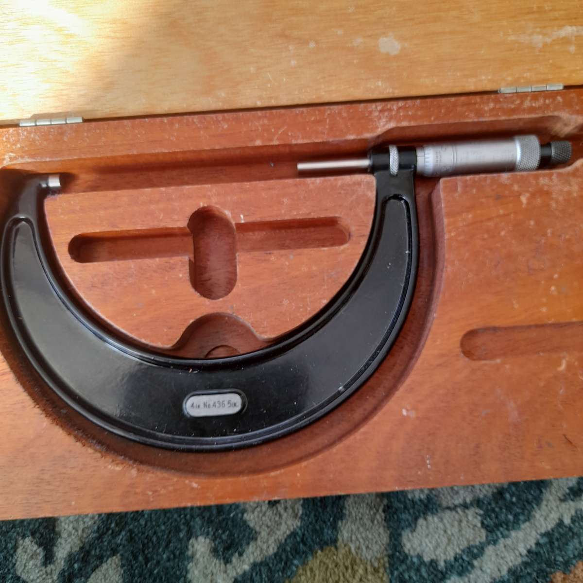

                    Martin, thank you very much for the kind offer, very generous of you. But I have just cleaned it up this morning and I’m very happy with it. I should have taken some before pictures, it was that bad. I ended up using white spirit with lots of blue roll, a quick wipe with a paper towel soaked in brake cleaner and then a bee’s wax based polish. 20251011_13112220251011_13114220251011_131211
