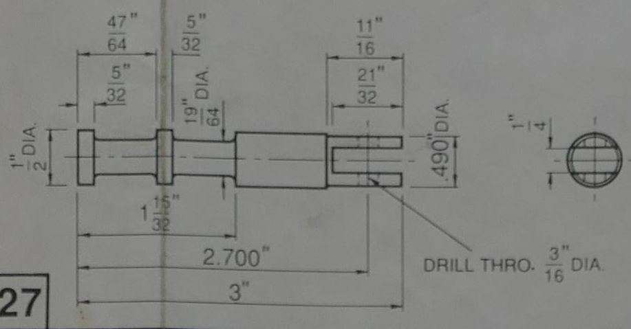

      Stuart Sirius item 27 valve
      This one worked for my Sirius.
      Martin C

          I have now been sent the relevant parts of the Sirius drawings, sufficient for a complete study of the valve gear.
          I can confirm that there is nothing wrong with the original valve drawing as shown and mistakenly complained about in the article.
          It does have lots of exhaust clearance, which I had not expected, but which I can see might well be desirable in such a high-speed engine with a small clearance volume. I will do myself a timing diagram sometime out of interest.
          One sensible point in the article is that the little sleeve for properly locating the head on the cylinder really ought to be fitted. If the head is only a few thou out of place it significantly messes up the lead.

                      The first thought I had when looking at the plans for this valve were that I would need to know where the exhaust ports were in the head and arrange everything to be symmetrical about them. After some thought and looking at other designs I realised that, in theory, this spool valve could be open to atmosphere at both ends and would still work and, as stated, as long as the exhaust ports were open it did not matter where they were positioned. The head is only there to collect and channel away the waste air or steam and do nothing else for the engine apart from making it look neat.
                      Martin C

                            However, the new scheme does significantly increase the clearance volume, which could have been an advantage if the engine was meant to run at short cutoff, not in this case.
                            I don’t follow. The smallest clearance volume is normally best for efficiency, whatever the cut-off. However, I think it is the main reason for the large exhaust clearance on the Sirius, in order to avoid excessive compression. (The exhaust is open for about 215° of crank rotation.) I don’t think the concomitant early release would be needed for breathing, rather just an unfortunate consequence of the otherwise elegant (in the Heinz Wolff sense) simplicity of the design.
                            Out of interest, I have been looking at the timing in more detail. Because this is a single acting engine we don’t have the problem of con-rod angularity making it difficult to equalise events at both ends. It should not be difficult to design for the events for both cylinders to be identical. Even the effects of the angularity of the valve drive buckle can be dealt with pretty easily.
                            It turns out that, as designed, the events aren’t equal. For example, the flywheel end cylinder (call it F) has 1/64″ lead, and the other one (R) has almost exactly none. Admission, lead, and cutoff can all be made pretty much cock-on simply by shortening the valve length by 0.008″, taking the 2.7″ distance (shown in post #779423 above) to 2.692″, leaving all the other dimensions as drawn.
                            This alteration also improves the equality of release and compression points, but not quite exactly. These can be equalised by slightly altering the length of the central valve head, but I have not yet worked out by how much.
                            Equalising the events is a design exercise that may make an engine run more sweetly, but of course it tells us nothing about their suitability. An indicator diagram from one of these engines working at maximum power would be most interesting.
