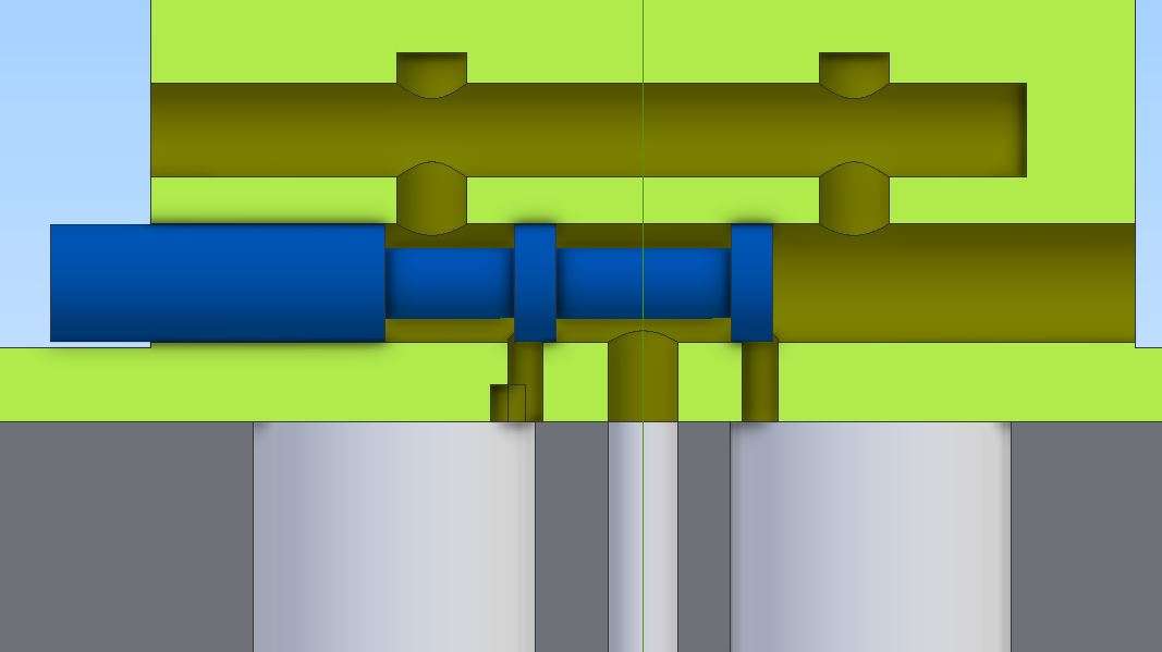

        I don’t have the Sirus drawings but if the Sun is anything to go by then  the bottom image in fig 3 has the valve in the wrong place, The widened 1/4″ section is not meant to be in the middle. This is the same way as the old Stuart drawing in Fig 1 has it.
        sun
        Also Photo 4 shows the two full diameter parts of the new piston valve the same width but the drawing says the one at the end is 5/32 and the other 1/4″
        Seems to have missed the point that it is inside admission and the inlet passage should nor be covered at any time

            I am 99% sure that the Sirius is the same as the Sun and that the ports between cylinder and valve are machined. these are the important ones not the rough cored ones to the exhaust at the top and within reason the central hole to inlet is not an important size and could probably be anywhere from 3/16″ to 5/16″  and still work without problem using the valve as drawn on either of the Stuart drawings.
            #779107
              100% sure now having looked at Tubal cain’s build in ME, the slots are milled and as he says
              “The two slots correspond to the ports found on an ordinary slide valve”
              So they are the important ones and the cast passages that the Author based his comments and the article on have nothing to do with the valve operation.

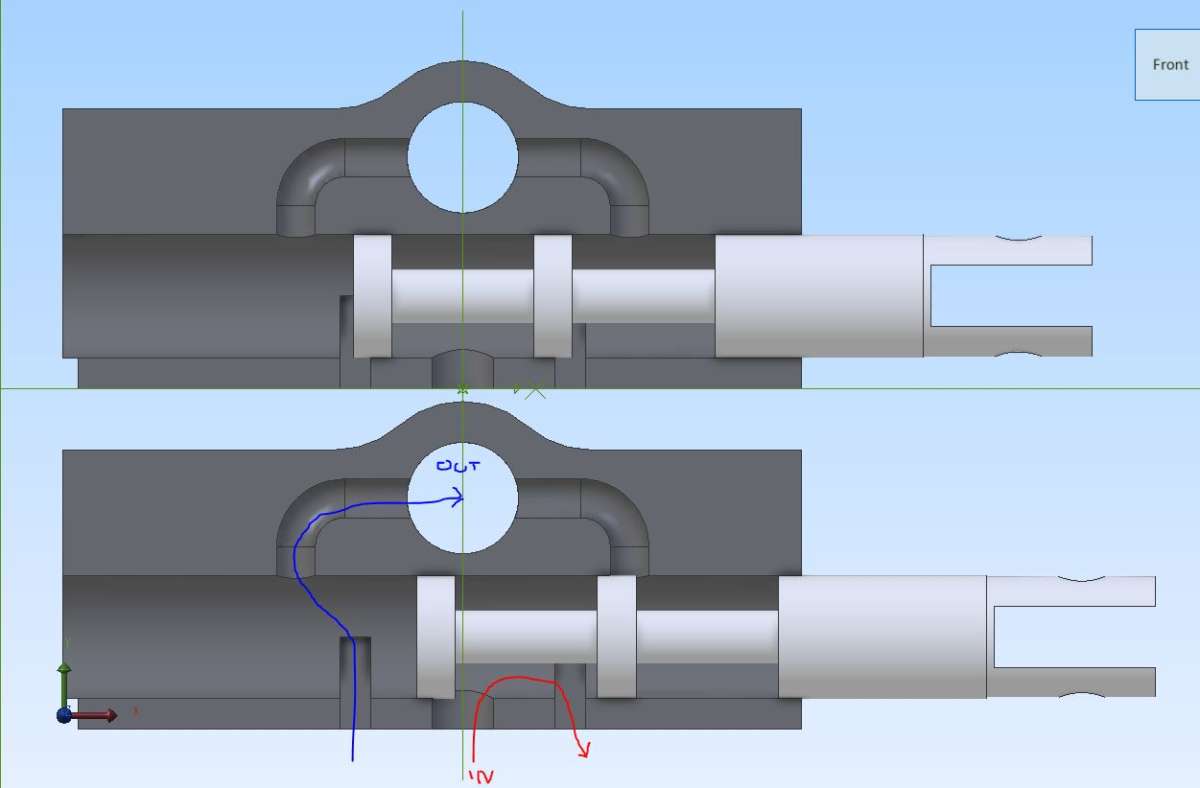

                        Well I have use the “valve chest” from Tubal Cains article as he does not mention any alterations to the lengthways position of the ports and the supposedly incorrect CAD drawn Stuart Piston Valve. All looks OK to me.
                        Top View shows the valve in mid position where both exhausts are open
                        Lower view shows it at full travel, inlet fully open and exhaust on the other side fully open.
                        At no point does the position of the cast passages at the top come into play.

                          You also show that the central steam inlet port is not part of the timing either.

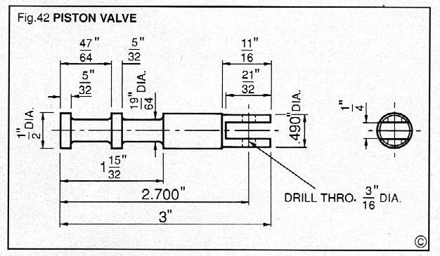

                              Hi, here’s a scan of piston valve from Tubal Cain’s article, if anyone is interested.
                              Scan_20250123 (2)
                              Regards Nick.
                              #779263
                                Thank’s Nick, that is how I have it drawn and it matches the CAD Stuart drawing.
