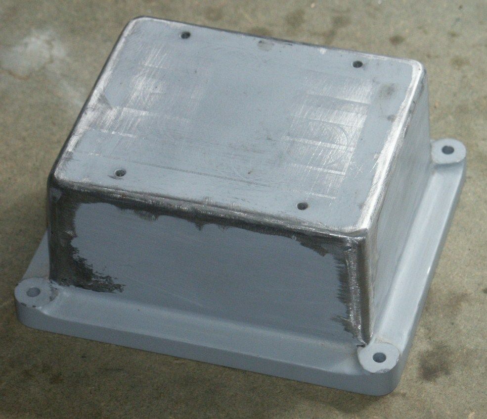

          Make it from Ali is one option as its a bit quicker to machine and you can leave the inside solid and still be able to pick the engine up. Or just make from steel plate and don't worry about hollowing it out.
          It can also be fabricated with a 3/16 or 1/4" to and 4 strips to form the side, either screw together and fill the holes or weld if you can weld. This one is 6"x4" x3" and welded, hollow inside
          You could also use a steel top and a hard plastic such as Corian to build up the thickness I did my big Benson that way
          I'm going to be doing one soon that is 16" x 6" x 1.5" if you can hang on I'll post some photos. I did have a large bit of structural steel put away for this but since getting some photos of the original engine will now go for a 1/4" steel top with 1.5×0.5 aluminium for the downstand.

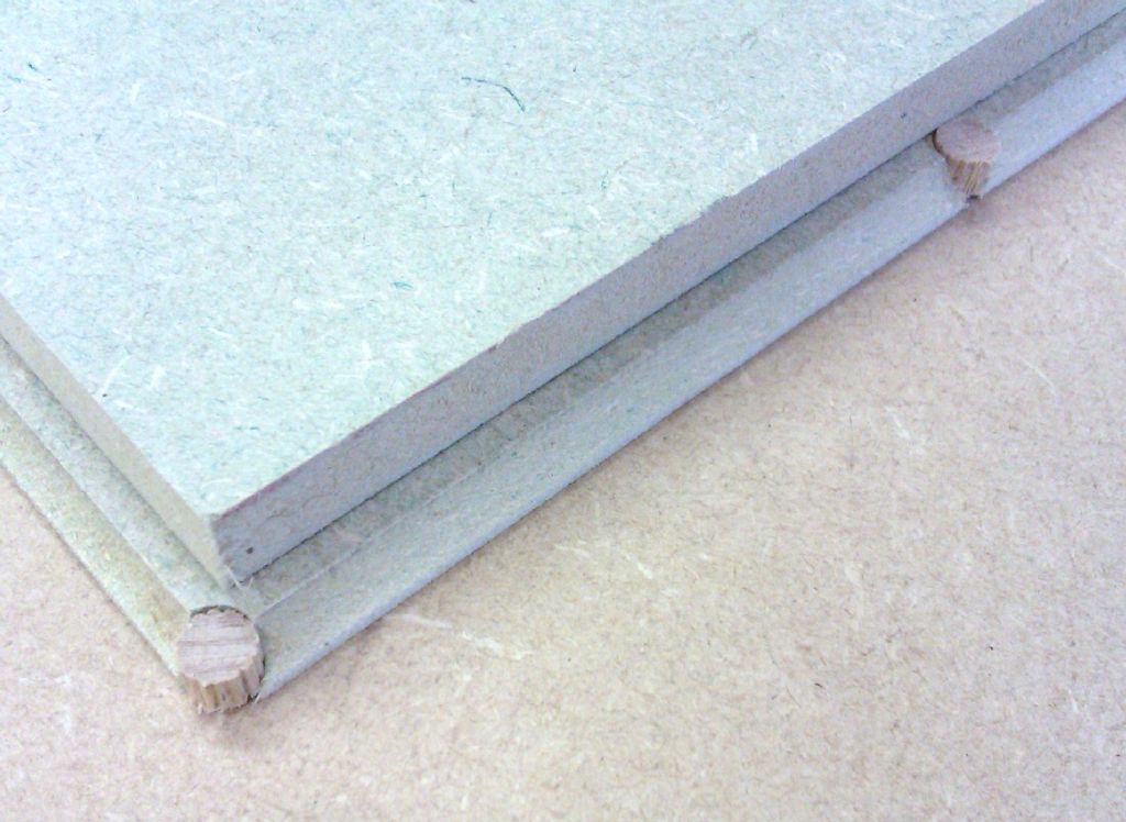

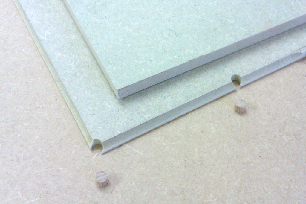

                Having just had a look at the Mary drawings on Reeves site I would say making the base from two layers of material will be the best bet.
                Cut the lower one to size and use a bull nose or home ground cutter to profile the 4 sides, drill say 6mm where the six bolting down holes go and JB weld in some short lengths of rod. The top layer can just be a smaller square edged plate fixed on top.

                        Had a suitable bit in the router this afternoon so ran this off from some scrap MDF to show what I was saying about making from two plates.
