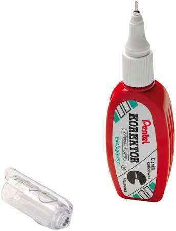

      Perhaps I am late to the subject, but I have just discovered a convenient marking out medium.
      Pentel Stylus correcting pen  (other brands are available).  It conveniently can draw lines about 0.5mm wide in white on most surfaces including rough castings.
