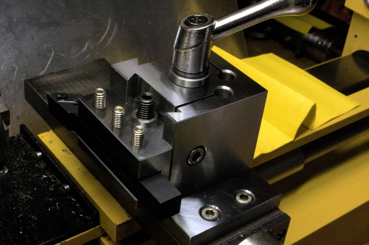

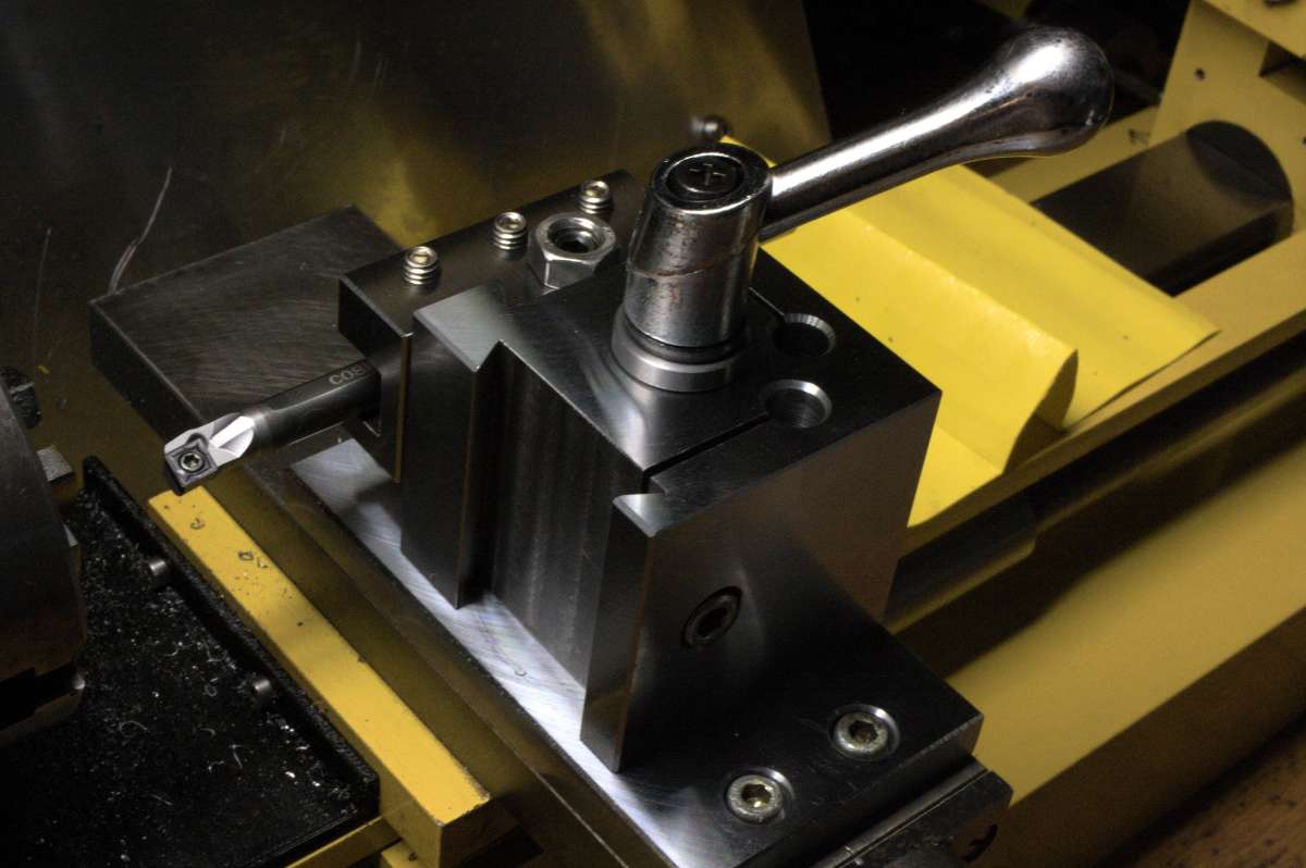

      Hi folks, I thought some of you might enjoy seeing the quick change toolpost I designed and made for my little hobbymat md65 🙂
      It uses dovetail flexture for toolholder mounting points. They hold incredibly well and with quite little force, so long as you’re careful to machine the toolholder dovetails in good tolerance.
      Link to the complete imgur album with all parts individually shown, cad mockup etc.
      https://imgur.com/a/hobbymat-md65-qctp-HoqzPm7
      Side mounted tool:
      mounted_side_small
      Rear mounted tool:
      mounted_rear_small
