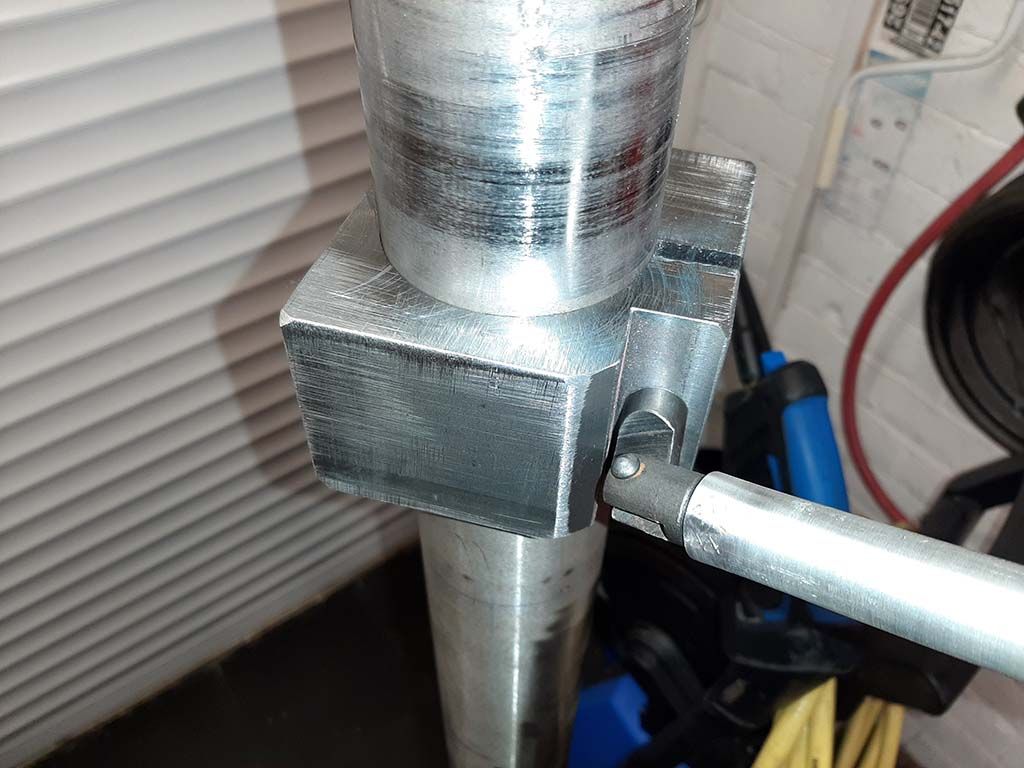

      I think i may know the answer but thought i would see how you guys would do it.
      the hole needs to 70mm dia is a 65mm block of steel
      have both lathe and mill. Have drills up to 22mm and boring tool and bars.

            Depends on how big the 65 mm (which I assume is material thickness) block is, also depends on how accurately you want to keep the hole diameter and surface finish –
            First choice – quickest and most accurate – 4 jaw in the lathe, pilot drill, boring bar. First reserve first choice substitute face plate for 4 jaw.
            Second choice if the block is too big to swing – milling machine and boring head. Slow and less accurate, or at least less reliably accurate in my hands, than the lathe
            Third choice (getting rougher by the minute) pilot drill, holesaw in a mag drill, from both sides. Pushing the limits of the technology, but it'll go.
            Fourth choice , yes the gas axe
            Fifth choice – sub it out to someone with bigger machinery that I've got

                made a start. up to 32mm dia using mill.  boring bar next
                making a pillar drill table holder that will grip around the colum

                    When I did a similar job, albeit a larger hole in thinner (2" ish I think) material I drilled a circle of barely overlapping holes and knocked the blank out. Drill 3/8" or so diameter leaving maybe 1/16" to clean out at the thinnest point sounds about right. Job for a 4 facet drill really but a pilot hole most of the way through kept the drill straight enough for me. Final bit was done with the bigger drill alone so I filled the holes with cutting lube and made sure the drill was sharp. A decent pillar drill on slow speed helped as the drill was really a bit large to go through without a pilot hole.
                    Attacked the ruff hole with a big half round file to take the pointy bits off before finishing on the mill. Rotary table and decent size cutter for me but a boring head will get you there. A bit more slowly.
                    Clive

                      got the lathe at low speed, about 300rpm, any higher and it would vibrate out the hut and just taking 1mm cuts

                        Up to 51mm, down tools for lunch

                          You might, in fact almost certainly need at that depth, to use a hole-saw from both sides, but not for the finished size whatever it says on the saw's box! (Unless the hole does not need to be accurate: a hole-saw is not intended as a precision tool.)
                          Saw appreciably smaller diameter, blunt the core's edges and pop it in the "come-in-handy box"; and bore the hole to finish either on the lathe or milling-machine (boring-head).
                          Chain-drilling: I have had to use it occasionally but the "teeth" are very unkind to the finishing-machine and tooling, so it is best to remove most of the ridges' bulk by filing or grinding. You can of course also keep a chain-drilled core in the "C-I-H-B" – but at least blunt the nasty fangs first or the core will hide, ready to ambush your rummaging hand!
                          Boring-heads: not intrinsically less accurate than a conventional boring-tool in the lathe, but a lot slower to use. I the option is available, I would suggest the most accurate would be a hefty boring-bar between centres.

                              Was thinking rotabroach but it wont cut through 65mm thick unless I started smaller and went up in diameters to make a pocket and then cut through with a second pass. Finish off with a boring head.

                                You would think so, however even though i am using a 16mm boring bar, i seem to get quite a bit of deflection

                                      The boring bar shouldn't be deflecting that much. What insert are you usng and where did it come from? Also what feedrate is being used?
                                      Even if the bar is deflecting it isn't a problem. As you get near to final size take a couple of spring cuts without moving the cross slide before measuring the bore.

                                        That 16mm bar is projecting over 4 diameters and there is the flex in the toolpost and the compound to add. I don't think I would have the nerve to go for more than a 1/2mm cut.                                                                                         Inserts for stainless are sharper than steel types and might be worth trying, and for finishing with 0.002" or less doc, the aluminium type are very good, and cheap Chinese ones are getting better all the time.

                                            The trouble with inserts for steel is they only cut nicely with deep cuts, when you start creeping up at the last bit, the surface finish drops dramatically. That's when the shiny sharp aluminium grades come into their own, still cutting with 0.0005" doc.

                                                    Machining finished and tested on the pilar drill column. It works
                                                    Ready to paint red to match the drill

                                                      That application will be better with a rough surface finish, the grip is better.
