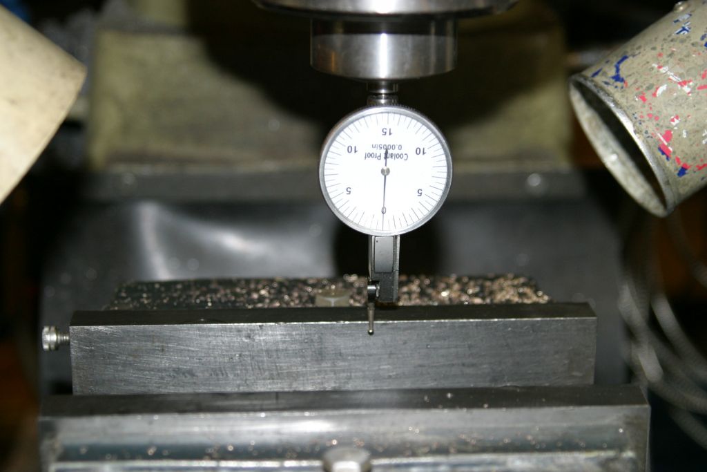

      Has anyone come up with a reliable way to fit a machine vice to a mill so its always square/parrallel

          Accurately fitted tenons work provided there is no damage to the Tee slots which also need to be machined in accurate alignment with the table axis.
          I have 1 vice with a bar fixed on the underside that butts up to the front machined edge of the mill table, works OK for most jobs.
          If the job is calling for best accuracy always check alignment before machining.

              Anonymous
                I use a dial test indicator on the back of the fixed jaw aiming for 0.01mm across the jaw width. Although all three of my mills have nominal 5/8" slots in practice they are all slightly different widths so I don't use tenons. Another issue with tenons is that they can get damaged, or damage the table.

                  The one with the rotary base needs the base removing, there should be a groove underneath the vice with two tapped holes.
                  With a lever indicator mounted in the spindle check the rear of table tee slots run parallel when you move the table.
                  If they do turn the vice upside down and grip the tee slot with the jaws and do the same indicator check on the groove. If parallel great, if not make it so with a milling cutter.
                  Make 2 tenons to fit the vice groove exactly and also table tee slots with a little clearance.
                  When you now mount the vice in the tees the rear fixed jaw should indicate parallel when tapped toward the back of the table.
                  Just don't clatter the vice about when not on the machine or Andrews warning will come true.

                    A set-square is gets close, but isn't good enough on my mill because the vice sides aren't finished accurately square to the fixed jaw. It's an inexpensive vice!
                    People have fitted pegs underneath to align with the T slots. This works reasonably well, but the accuracy depends on how well the pegs are placed, how accurately the slot is cut, and there's no wear and tear.
                    So I use a DTI held in the spindle to square the fixed jaw.
                    1. The vice is set approximately with a set-square and the bolts gently nipped down
                    2. The table is moved until the DTI arm is positioned at one end of the jaw, with about a mm movement beyond resting zero. Then the dial is zeroed, and the forward/back slide locked.
                    3. The table is moved right/left so the DTI is reading the other end of the jaw
                    4. The difference, if any, is noted. If zero, tighten the bolts and check in case doing so accidentally misaligned the vice
                    5. If not zero, tap the vice gently with a hammer so that it swivels on the bolts enough to halve the DTI reading.
                    6. Repeat from step 4 until the DTI doesn't detect any difference, or the difference is small enough not to matter.
                    This setting accuracy achieved by this method is high, and it depends mainly on the accuracy of the fixed jaw and the DTI (as a comparator). Chief dangers are accidentally turning the spindle, which is unlikely, and jambing against rather than swivelling round the bolts. First attempt likely to be painfully slow, but becomes surprisingly quick after several practice sessions.

                      I generally bump the vise up to the mill column (or with a parallel slipped to take up any slack) and bolt it down if it only needs to be rough and ready, as that is close enough for some jobs.
                      After fitting and tightening down (gently) it takes naff-all extra time to square it up with a dial gauge or dti before tightening further/fully and checking again.

                        I didn’t want to start cutting or drilling my vice so I made a couple of stepped sleeves that are an interference fit on my vice mounting holes and a snug fit in the tee slots. Simply placed on the table with the sleeves in the T slots and it’s within about one thou. If I’m really picky I clock it as well but it doesn’t take long. Luckily the design of my vice – two accurately bored mounting holes, rather than slots allowed this.

                            I leave the rotating bases on my pair of normal use vices. But I drive a Bridgeport so I've got more headroom than folk with smaller machines and the lost inch+ is no great issue.
                            Can't be bothered with keys and the like. Simply pulling the vice back so the bolts are both hard against the edge of the Tee slots before final tightening is repeatable to something between a quarter and half a thou per inch of jaw width. Good enough for ordinary jobs. Each holding down slot has its own designated set of Tee nut, bolt and washer which Intake great care not to interchange.

                              I never used tennons as they dont give reliable accuracy, you would still have to check with a dial gauge, I place a parallel bar in the vice then a steel ruler on top and grip in the vice then eye the edge of the ruler with a tee slot this will with practice get you within a couple of thou every time then finish with a dial gauge.

                                            I do as Andrew, and use a dial indicator in the collet/chuck on the fixed jaw. I have made a couple of extra posts for the indicator so it always fits whatever I have in the spindle ( well almost always! ). I snug down one bolt fairly tight and leave the other slightly loose, then tap the end of the vice one way or the other while running the table back and forth till I get the min reading end to end, then tighten down both bolts and recheck.  It only takes a minute, two at the most, to get the 6" jaw within a thou end to end.

                                              I use two squares and a 3:2:1 block for quick and easy placement of my 3" Abwood, one square clamped in the vice, 3:2:1 block up to that and the other square off the mill table to set at 90 deg.
                                              For the other vice (ground toolmakers) I use one square off the table.
                                              If I want it really accurate, 6" long ground block clamped in the vice and a DTI off that as it gives a longer travel than just the 3" vice jaws.

                                                For anyone who does not have a vice with those handy slots in the base already, here is one way of milling them yourself.
                                                Clamp a length of square bar to the milling table, set with a dial indicator to be dead true to the travel of the table and the T slots.
                                                Flip your vice upside down and clamp the jaws onto the square bar.
                                                Mill slot in base the same width as your T slots.
                                                Fit pieces of T-slot width key-steel into slot and secure with screws into holes drilled and tapped into the vice base.
                                                Alternatively, set your vice up semi-permanently on one end of the milling table and leave it there. This leaves the rest of the table for other use such as rotary table, direct clamping etc. Works best on larger mills I suppose.

                                                    It would be best to use keys in the base of the vise directly, remove the rotary base first. You could use keys on the base, but without anything more than the degree scale, you will never get it lined up well enough.
                                                    I bolted down a 2-4-6 block to the bed and used a dti to get it perfectly aligned with the X axis. Then the vise was clamped carefully upside down to the block. The rear side of the keys can then be skimmed to true them up. You can leave a gap between the end of the milling cutter and the base of the vise as the slots in the mill bed will have chamfers .
