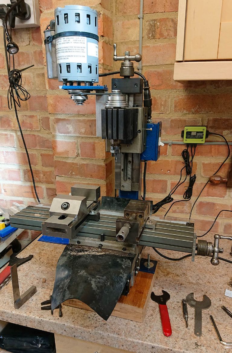

                            Hello all, thank you for the helpful and informative replies!
                            I'm definitely on the same page as DrDave & SillyOldDuffer, much rather get on with using the machine and pay for someone else to have done the figuring out.
                            A question for those with modern style benchtop mills, do you use the z axis readout or mostly use the quill readout?
                            I've only used knee type mills and my little Taig mill so using the spindle for cutting depth seems a bit odd!
                            As we all like pictures, here's my little Taig, which does pretty well! But cranking the head every time i want to drill a hole really makes me miss having a quill.
                            Thanks,
                            Pixel

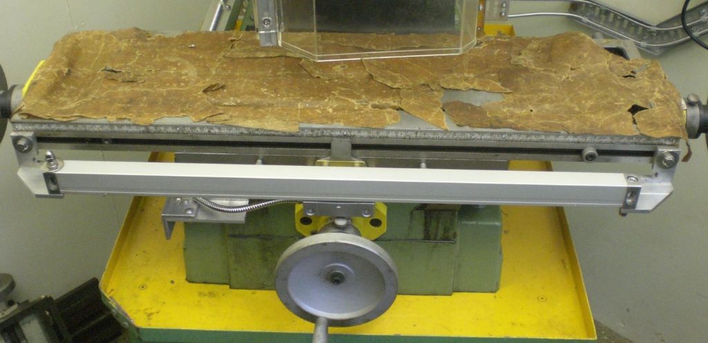

                                    Hi, I bought my DRO display and two glass scales from ArcEurotrade when they were selling them at a discount price, and I made my own brackets, which I didn't find that difficult, and I wanted to mount my X axis one on the front and still be able to use the stops.
                                    There are more photos DRO's for the Major
                                    Regards Nick.
