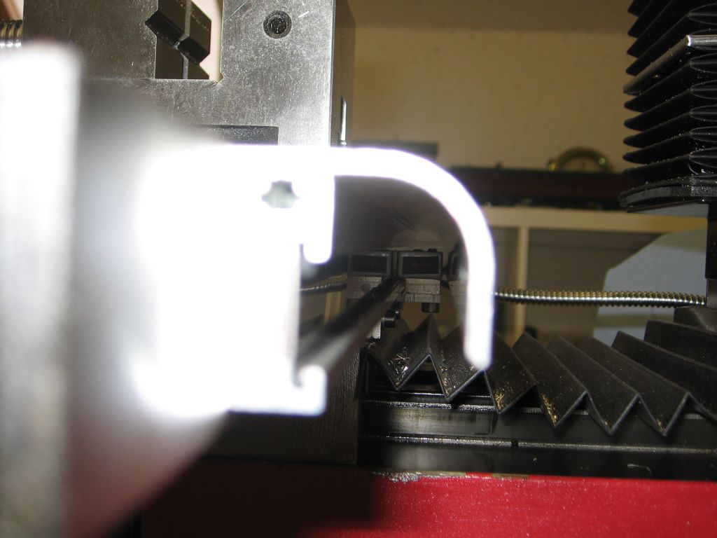

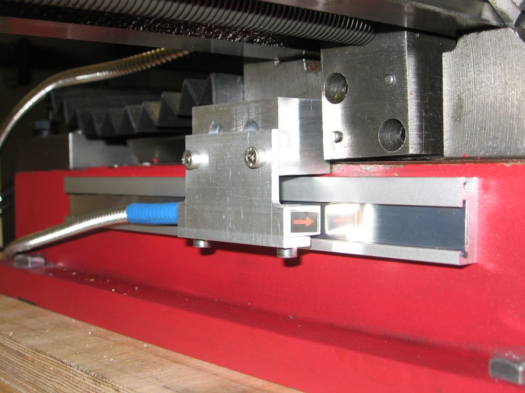

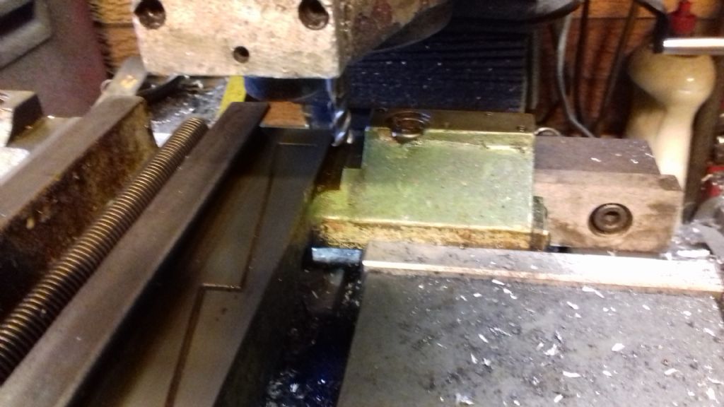

                    #459157
                    Martin Shaw 1
                      @martinshaw1

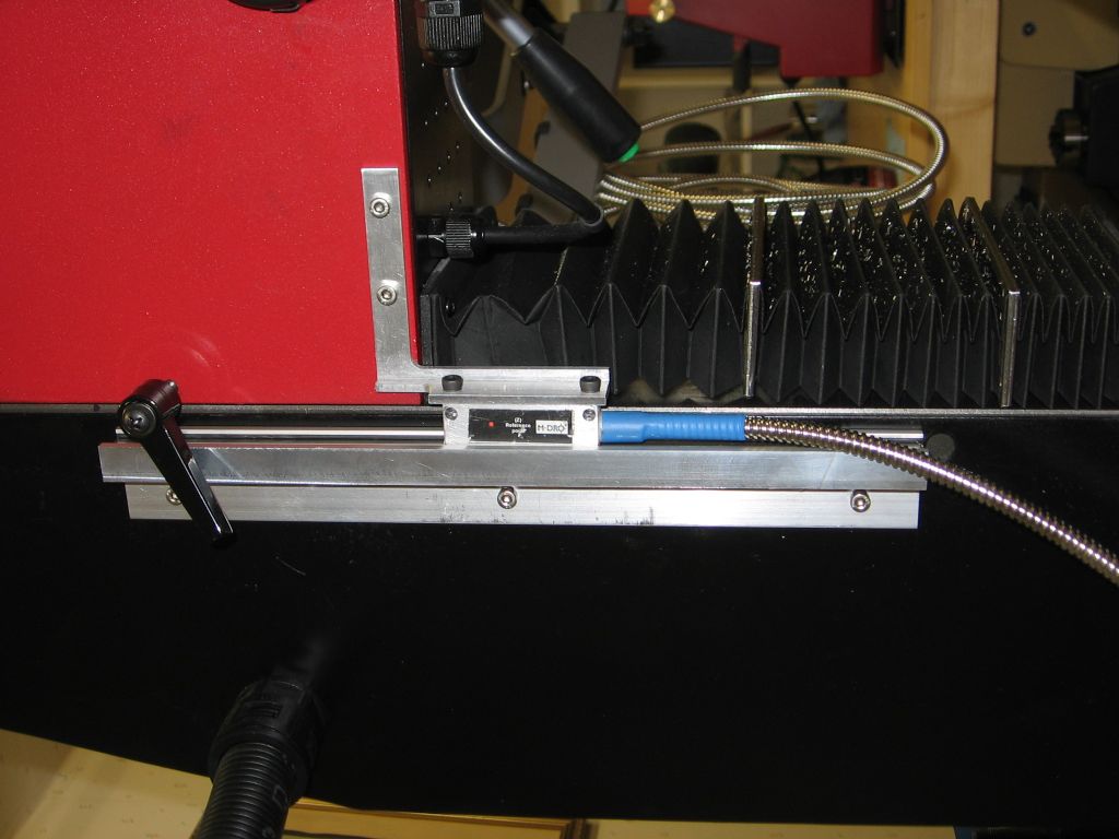

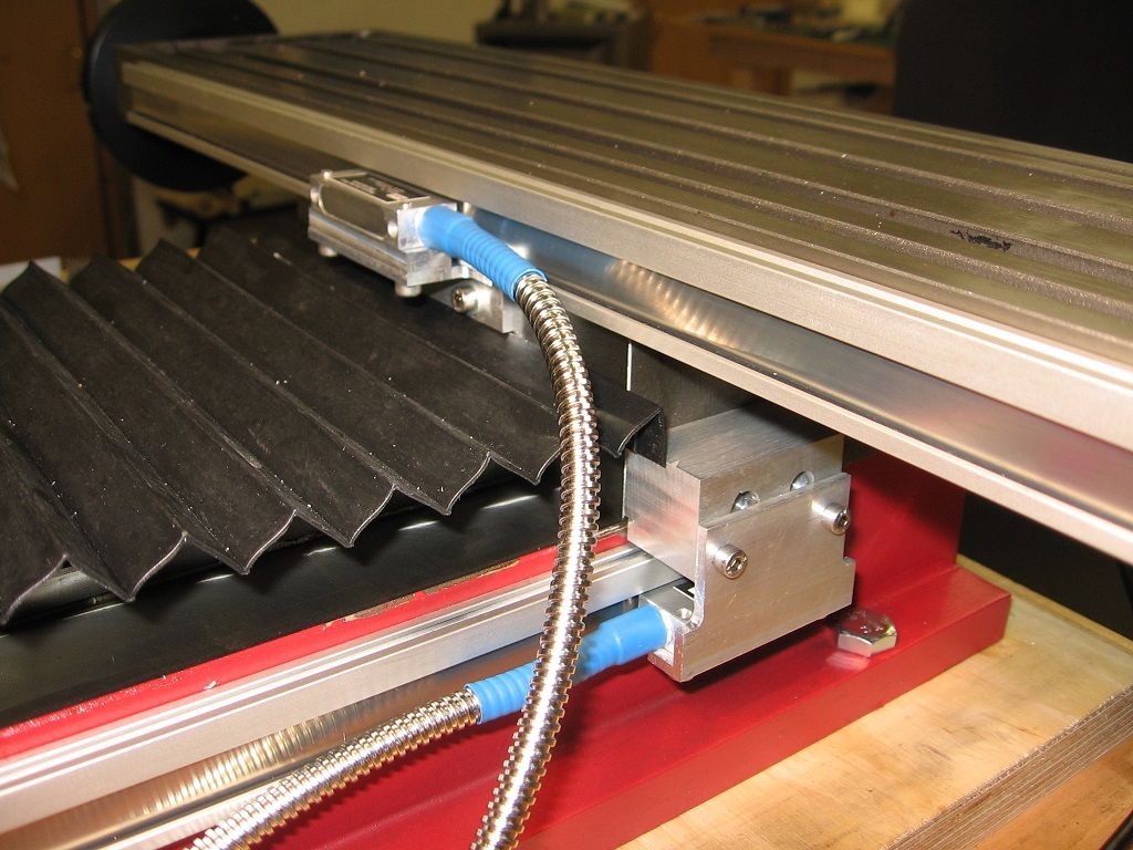

                      Ken
                      Herewith some pics of my installation
                      For some reason this is 90deg out so mentally rotate it clockwise, it is the Z axis which in truth isn't too much use on a SX2.7 I find. The other thing is that because M-DRO sell this as a universal package the supplied brackets are all far too big so I had to homebrew mountings and you do end up with a length of magnetic track surplus however I had a good deal from them so the cost of individual parts was still greater than I paid.
                      Found another better pic of the X and Y arrangement. Any questions please ask.
                      Regards
                      Martin

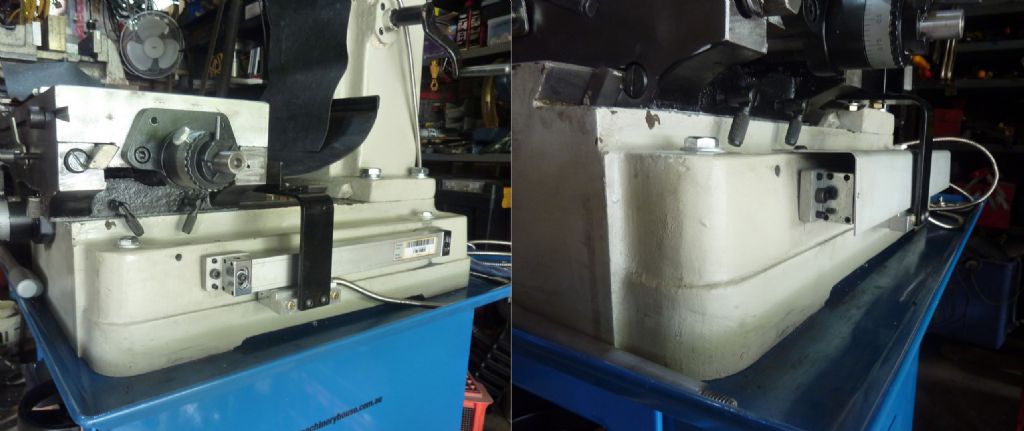

                          I installed the mini heads on my Sieg 3.5 DZP mill which had a basic DRO system. I changed to the M DRO magnetic system and found although it works well the tape is magnetic enough to attract steel swarf which can become trapped in the gap between the tape and the head. Really needs a shield over the tape to avoid this happening.

                            ‘Thanks for the information. Yes, Its my intention to use aluminium “U” channel with the opening facing down and head up inside.

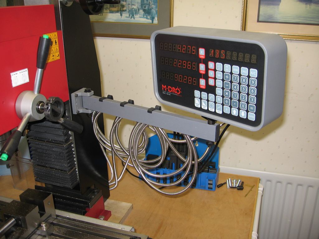

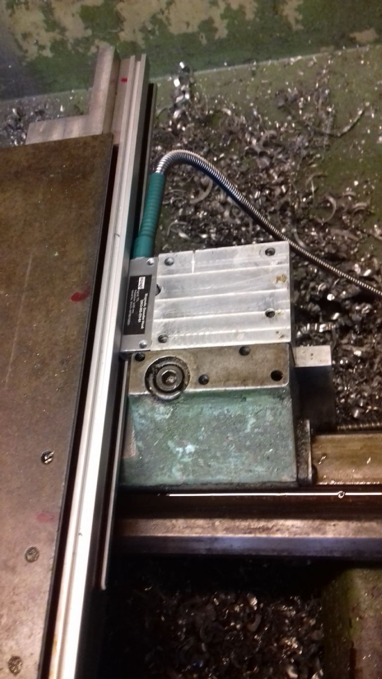

                                    KenJ: I've just uploaded photos of my installation – I bought the Easson 3-Axis with Magnetic scales from Machine-DRO and installed this on my Sieg SX3 last week.
                                    Please see the posting headed 'Sieg SX3 and Machine-DRO 3-Axis Kit' for more information. I hope there's something there that helps. For interest, I installed the Z-axis scale and reader inside the column.
                                    Cheers,
                                    Mike

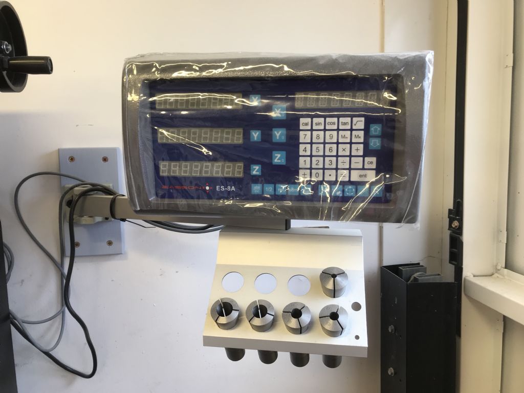

                                          I have the ES-8A Readout, so slightly different from your one. I also installed the compact heads with tape.
                                          1) The Brackets were far too large for my SX2.7, hence why I manufactured my own, which I believe is pretty common.
                                          2) The manual for the ES-8A is not too bad. I have used the basic functions including PCD, Lhole and SDM, but must admit that I have NOT used the Arc function as yet, so cannot comment on that at the moment.
                                          Good luck with deciphering the manual.

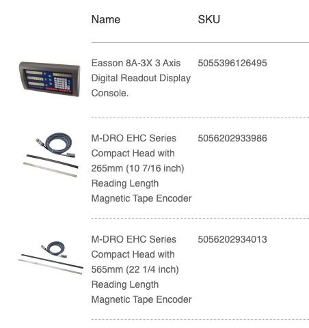

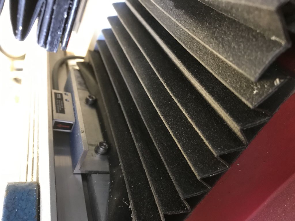

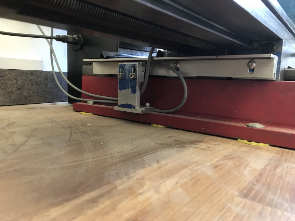

                                                      +t1q7th6s4egcw32zoz2ig.jpgootaldcfqqiu2w32dehyma.jpg%3xvbpp+stuxydzestwwpa.jpgm-dro.jpgPosted by Roger Benson on 15/05/2020 11:58:32:
                                                      Posted by KenJ on 25/03/2020 20:30:04:
                                                      Many thanks to you both for the information.
                                                      I have placed my order with M-DRO for the Easson 3 Axes Display and compact magnetic heads.
                                                      Kind Regards
                                                      Can you post some pics and details which heads and tape you bought. I want a similar system on my SX2.7 but finding that there are so many different type to choose from.
                                                      Roger,
                                                      I hope the attached details and pics are of assistance.
