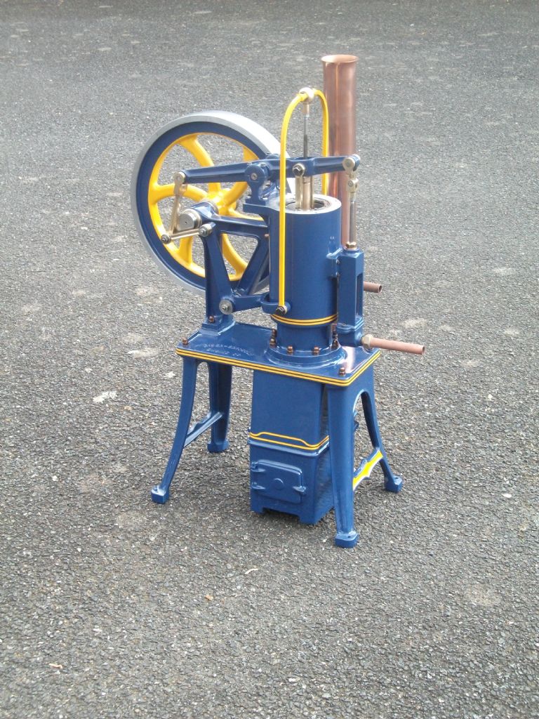

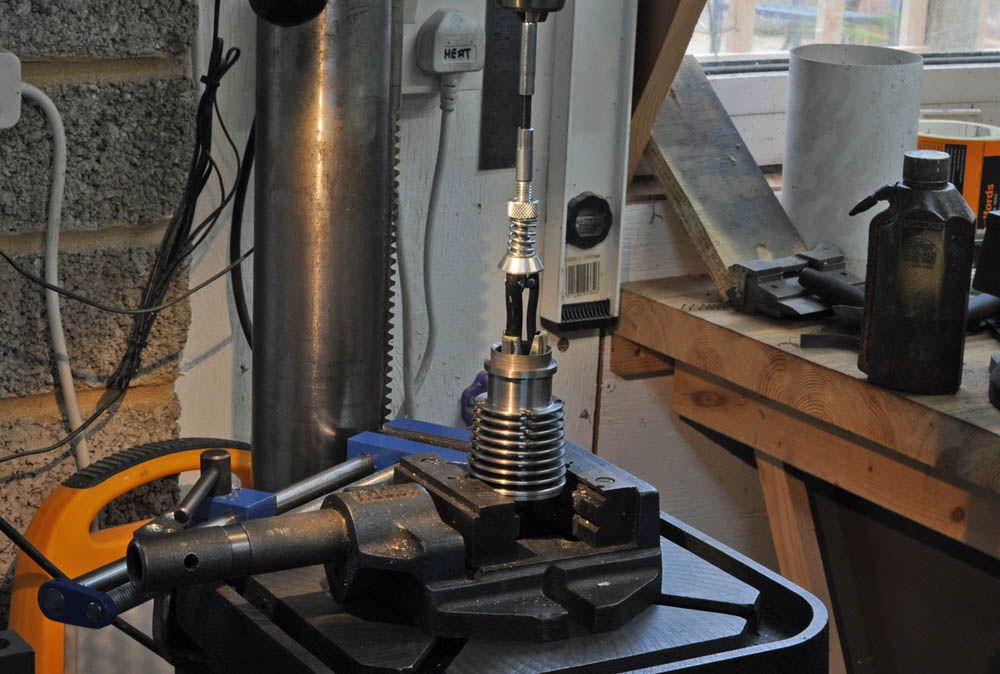

                          I made this honing tool that was published in Mew 207 .Made up
                          from scrap oddments , has strips of abrasive paper or cloth and
                          lead strips glued to pressed out pre-formed shoes .Simple to make
                          works well.
                          Used to hone the cylinder of this hot air engine.
