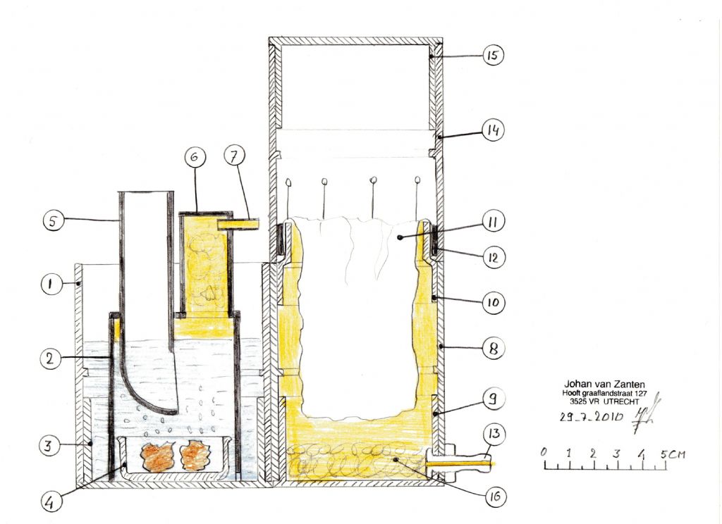

                            Hi all,
                            To answer Charlie's question: In the Netherlands they sell carbide at the end of the year in some garden shops and it is used to "celebrate" the new year. ( you have to ask for mole exterminator ). I use it for some years to run my Otto and Langen engine. I made a developer from PVC drain pipe material and this works fine for a small engine. You don't even smell it. I don't have an English explanation for the numbers on the drawing at hand but I can translate the text if you are interested.
                            Regards, Johan.
