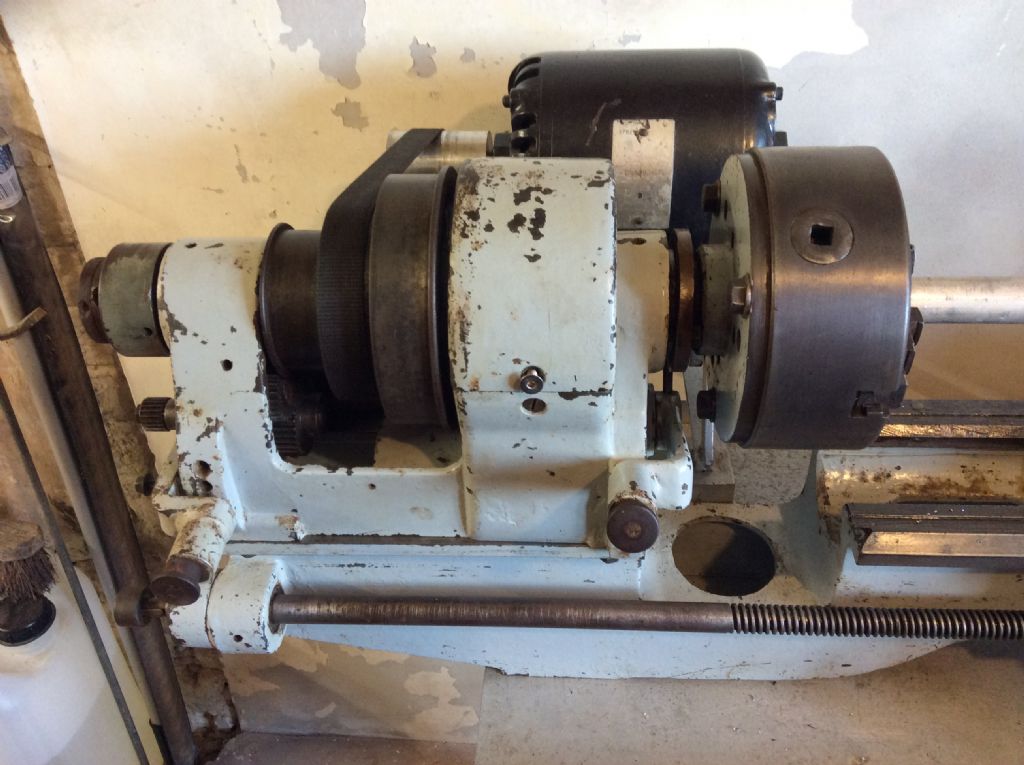

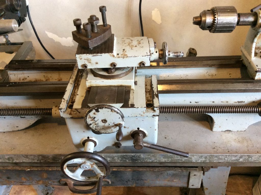

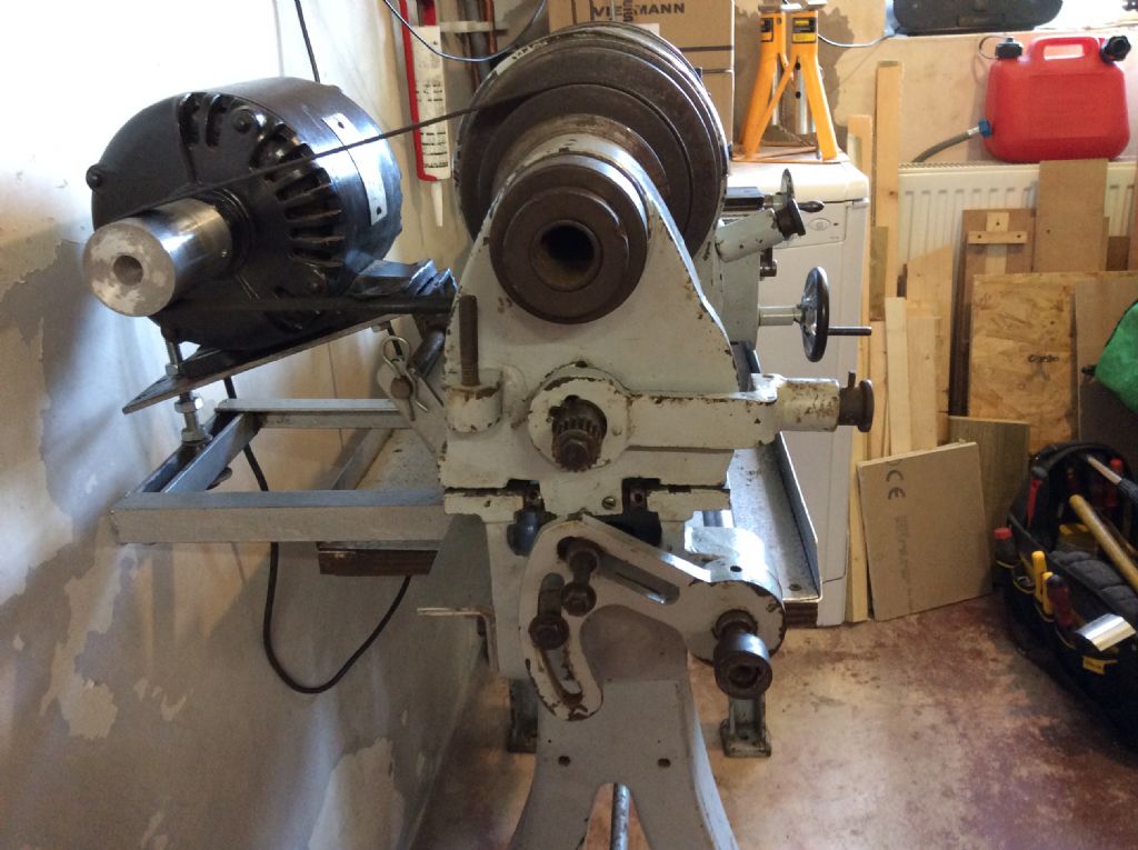

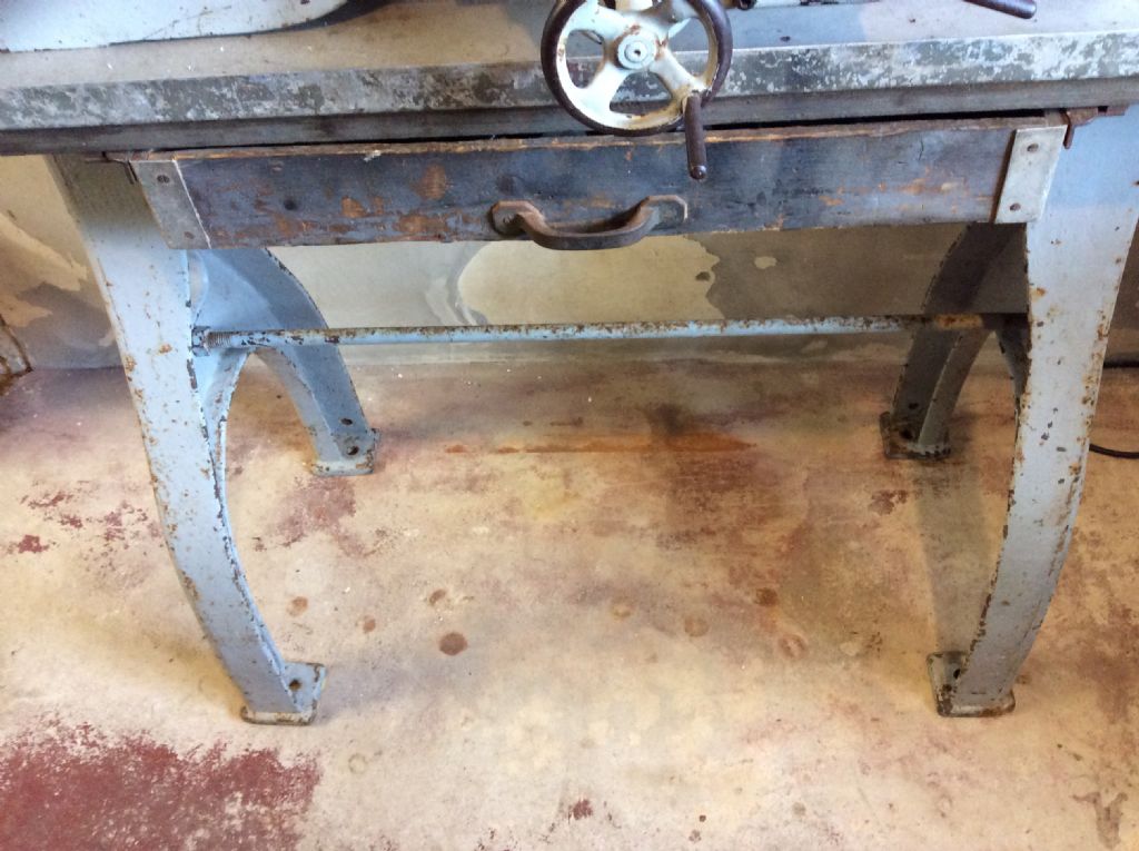

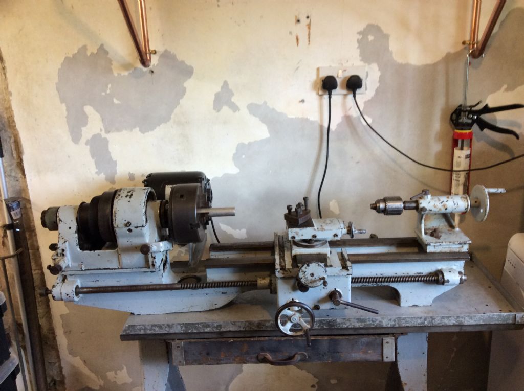

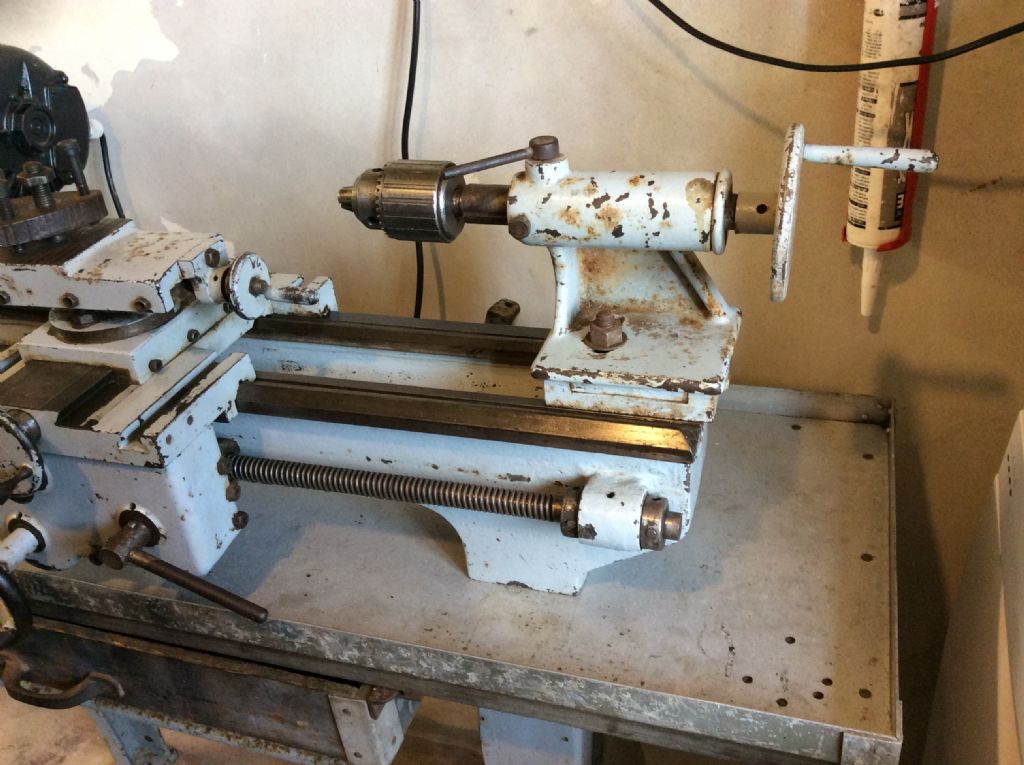

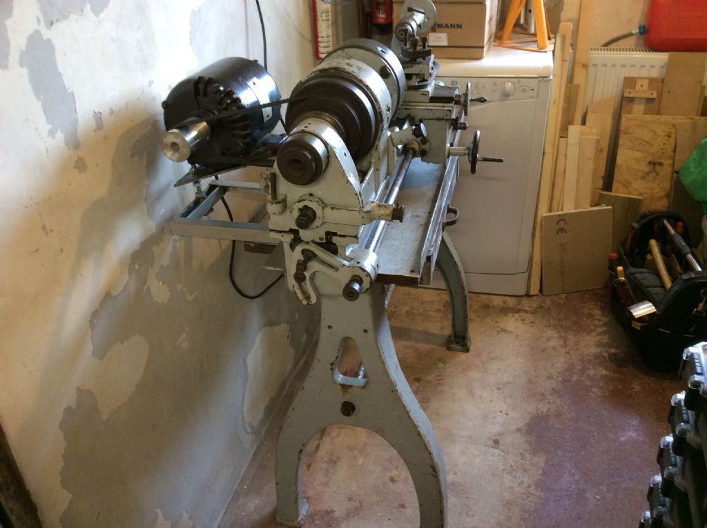

      Hello Ladies & Gents,
      Ive just signed up to the forum so hello to you all, can anyone help in the identification of this lathe I’ve just acquired, there are no markings or stamps on it anywhere, I would like to get it running better as there is quite a bit of play/slop in the cross slide and I would also like to see if I can get the gearing back together for the lead screw operation, I’m not looking for anything with extreme accuracy but if I can get it functioning better that will do me for starters. Any help/info will be much appreciated.
      Kind Regards
      Liame189ffde-480c-4515-a12b-78344f538c28.jpeg97a9c149-5ad9-4dd3-a4cc-e51d78fae0b3.jpeg8f05528b-8496-4cd6-8989-f203bb240eeb.jpeg838aa2c4-a45a-4550-b758-a707a6ed30ae.jpeg7cec23b2-fa95-4f55-8861-e9e33ba930b0.jpeg594daf23-448b-4944-908a-d634ca60e9b9.jpeg480e1d18-e7af-4768-8ada-36acc1c2160e.jpeg2a6fc004-f787-4ab5-bcf1-bb9b5855f40a.jpeg13c15481-08d8-43d8-8162-624ac6bff406.jpeg

            Greetings, Liam
            I assume you are in the U.K. [the clue is in the mains wiring], but I suspect the lathe may have been an import model: so far as I am aware, most flat-belt British lathes did not use the 'inverted vees' bed design.

            #423582
            Bazyle
              @bazyle
              It looks a bit like a Colchester but isn't quite like the ones on the lathes site. It is probably '30s but although you didn't give much detail looks to be around 10" swing. With that and the T slots on the saddle it is probably a small industrial or garage lathe. There are quite a number of these made by local manufacturers in small runs copying the general features of the age.

                  #423591
                  Keith Long
                    @keithlong89920
                    Liam – have a look at the lathes.co.uk webpage for the "IXL Leader". There is a photo on there of one from the 1930's, looks remarkably similar to your machine. The machines were mostly built in Germany hence the continental appearance.
                    The Colchester similarity is also interesting as I have an IXL lathe (dismantled at the moment), with a cast IXL name plate. and definitely an IXL Leader bed The odd thing is that my machine is a gear head and the headstock is either a VERY close copy of a Colchester roundhead Master headstock or IS a Colchester headstock re-badged.

                    #423599
                      Nice one, Keith yes
                      **LINK**
                      http://www.lathes.co.uk/ixl/page2.html
                      #423600
                      Liam Hutson
                        @liamhutson10557
                        Many thanks for all the information guys, much appreciated, Keith I have had a trawl through the lathes.co.uk but was looking at the British models page, I think your right in that it is an IXL, I know for definite that the motor and housing bracket isn’t original as the chap I bought the lathe from fabricated the frame to house a 3rd party motor which didn’t come with the lathe itself, Bazyle the swing is 4 inches (does look a lot longer in the pics) and the bed is 28 inches. MichaelG I am indeed in the UK (Dorset) I should of put that in the listing 😵, many thanks for the link, I shall have a read this evening. I just need to trawl the internet for all the info I can get on this and see if I can get it back to as near original as I can for decent money so if anyone has an IXL in there possession I would appreciate some detailed pictures of the headstock gearing to see what I need 😁 Once again many thanks for all your help in the identification and info posted, very much appreciated.

                          #423616
                          Bazyle
                            @bazyle
                            It is interesting to see the position of the half nut engagement lever on your example compared to the picture on the Lathes site. There is sometimes an comment that having it on the left is 'English pattern' cf Myford although in practice it can be either side depending on the whim of the designer. That they made both pattern's is unusual.
                            You should send some pictures, particularly of the saddle to Tony at the Lathes site so he can add this variation to the archive.
                            #423631
                            Liam Hutson
                              @liamhutson10557
                              I was thinking of adding those Ega, any recommendations on where to purchase some? Bazyle I did send the pictures to Tony at Lathes as that was my 1st point of call before I found this site, sent them twice to him for identification but got no reply, maybe on holiday or just busy?? As I was hoping he might have some assembly docs on the lathe 🤞

                                #423646
                                not done it yet
                                  @notdoneityet
                                  Posted by Bazyle on 11/08/2019 11:46:19:.
                                  Both variants are already shown – at the bottom of the linked page and on the home page.
                                  #423702
                                  Nigel Graham 2
                                    @nigelgraham2
                                    Interested to see this lathe seems to be an IXL.
                                    I owned for a while a larger lathe badged IXL, which from Tony Griffith's site was German-made, but by Ehrlich, and IXL was a dealer putting its own plate on things.

                                      #425121
                                      john brown 17
                                        @johnbrown17
                                        Well looking at the pictures of your lathe ,yes l agree its an IXL as for model l do not know ,but the bed an tail stock etc looks like my IXL 6" model AKT from 1920 and running with its old over head set up,thou not used a lot now ,well till this week when the good old mL7 threw its toys out of the pram,but thats another story ,mybe will think about giving the ixl a tidy up this winter and indeed mounting the motor like your lathe,as over head drive makes it a pain to fit the lathe in another place,but good luck with your lathe.

                                          #576095
                                          Alan Owen
                                            @alanowen42425
                                            Hi. I know that this is an old thread, but it seems to include people who have (or had) one of these IXL lathes and some of you may still be out there. I have recently refurbished one that had spent too long outside, but I have a question……
                                            Is it possible to install a continuous belt, in which case how do I remove the spindle? the casting is continuous (no half shells) so the spindle must come out to the left or right. I have dismantled the bearings at each end but can't see how to remove the spindle. I don't want to hit it or press it because I don't know what's inside.
                                            Any help is welcome
                                            Alan

                                                #576158
                                                Adrian R2
                                                  @adrianr2
                                                  If no-one else knows for sure then I will hazard a guess that the spindle comes out towards the tailstock (right), as that would be against most of the cutting forces. I would also check to see if one of the castings supporting the spindle bearings looked to be the larger than the other, and assume that it would be the larger end through which the shaft would pass to assemble/disassemble.
                                                  Some of the designs on lathes.co.uk show clamp nuts, others just a cover but not what lies underneath.
                                                  #576170
                                                  Alan Owen
                                                    @alanowen42425
                                                    Thanks for the help, yes, the bushing on the right looks to be larger than the left, and I am assuming that the drive pulleys and gears are keyed or splined on the shaft as there are no (apparent) grub screws etc.
                                                    Happy Christmas!
                                                    #576214
                                                    Adrian R2
                                                      @adrianr2
                                                      Hmm – assembling something like that with only a keyway seems a bit odd to me – usually if there is _only_ a key then it is a tapered one and if so how would you get it in/out? I would think there must be either a grub screw or some clamping arrangement on the pulley section.
                                                      Can you post a picture with that back gear cover removed? Not that I have any direct experience but it's a bit like a Christmas quiz for tinkerers.
