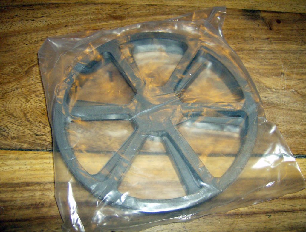

        Today I received two laser cut flywheel, courtesy of John Stevenson. They are rather nice and very accurate. The only blemishes are a tiny groove where the laser started on the internal cut-outs and a blip on the outside where the laser ran in and out. 8mm and 10mm thick they have a dish of about 5 thou, which is not an issue – the cast flywheel one replaces was useless with over 1/4" of dish
        I haven't started machining them yet and I'm aware there may be local hardening so I might need to use a carbide tool. One will simply be thinned down to 1/4" rim, ~3/16" spokes as it's to match an old plate. The other is for Lady Stephanie, and rather than copying the original I will use my imagination a bit.
        I will make a photographic records of how I get on, but my impression is that this is a viable alternative to castings, as long as the shape is appropriate in my case the original has square section spokes and rim).

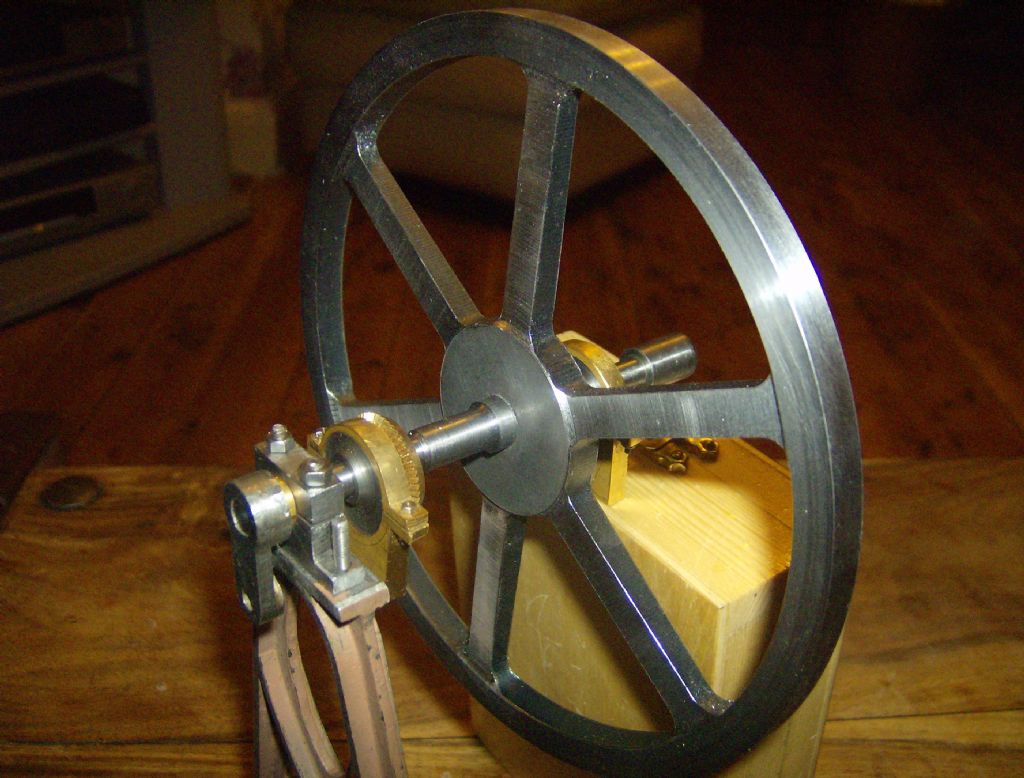

                      I've just finished machining the thinner flywheel. It did blunt my HSS tangential tool very fast
                      I used TCT tipped tools, but they have a small tip radius, so ths finish is not perfect (better than a casting though!) except the outer rim which came out perfect straight away on self-act.
                      Procedure:
                      Mount inside outside jaws and skim outside of rim.
                      Reduce width of rim by 50% of overall reduction.
                      Avoiding jaws remove some metal on spokes inside rim and around boss.
                      Drill and bore boss to tight push fit on crankshaft.
                      Turn around in chuck and finish thining rim.
                      Again remove some metal from spokes to mark inside of rim and outside of boss.
                      Mount on an expanding stub mandrel.
                      With top slide set to about 89 degrees taper spokes (required a two stage cut as the topslide handle interfered with the cross-slide index)
                      Reverse and repeat
                      Deburr using deburring tool, except around outside of rim (use emery cloth).
                      As received:
                      Lase cut flywheels as received

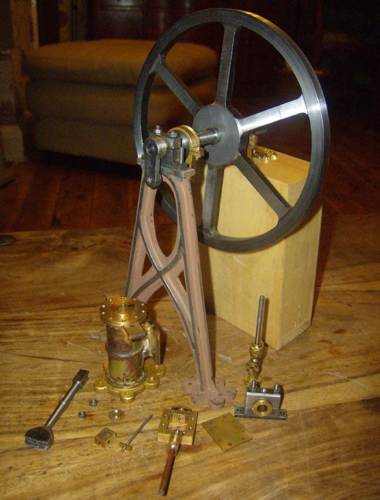

                      Mock up of engine:
                      Ancient engine
                      Close up of machined flywheel:
                      Machined flywheel

                            I just went over the spokes and the inside of the rim (i.e. what would have been the 'cast' surfaces) with a rotary tool and a 10mm sanding drum. Gave an excellent finish for these areas, but the sparks were big and bushy (most like the mangnese steel drawing in Tubal Cain's book), so i think it must be a fairly high-carbon steel. No wonder it took a bit of machining!
