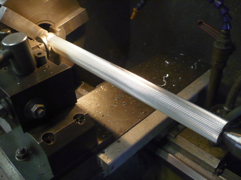

                        I have proven that diameter isn’t a factor.
                        I took a bar of steel and machined it into equal steps at random diameters, each diameter a few thou less than the previous one and ran a knurl along the whole length.
                        The whole length came out perfect regardless of diameter.
                        I do a lot of knurling that has to be accurate as regards no twist and even.
                        This is a 30mm steel bar knurled in one pass at 500 rpm and flood coolant.
                        John S.

                                      Any idea why my picture has disappeared again ?
                                      Been there all day now gone?
                                      John S.
