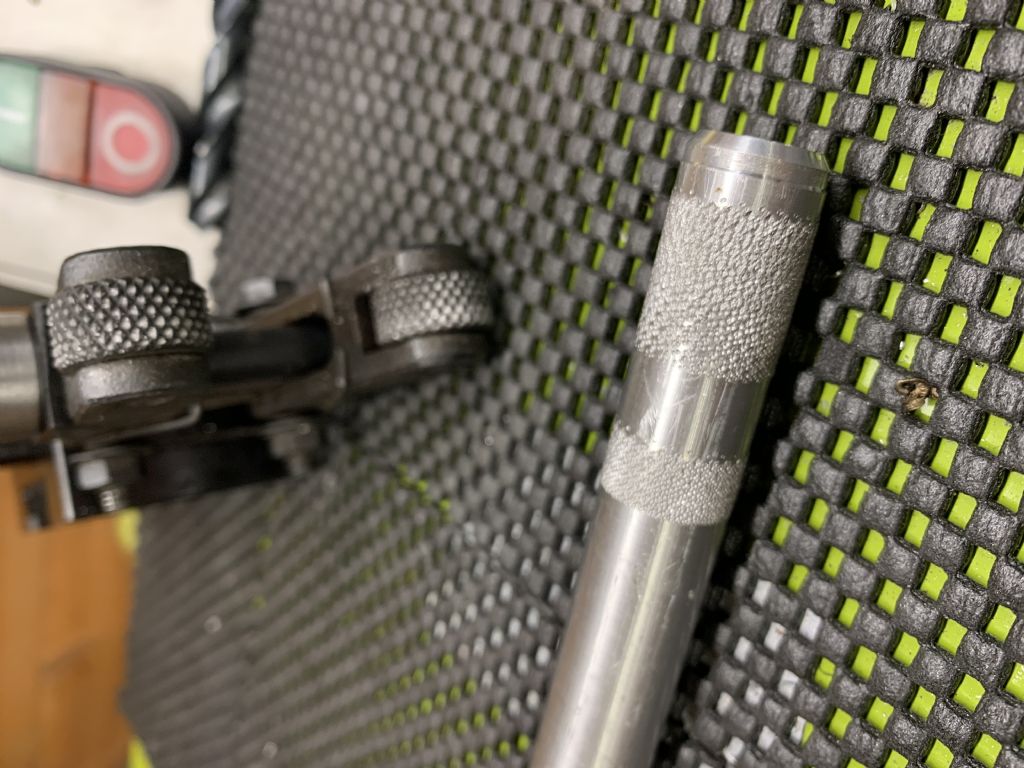

      I bought this a while ago but never got around to using it until this week as I wanted to knurl a couple of aluminium knobs, however disappointed with the results.
      The knurling wheels look different to what I have see being used on YouTube. ie the ones used are a left and right straight pattern and when combines make a diamond shaped knurl but the ones on my tool are different.
      To be honest it was only £20 so I suspect that’s why it’s not very good?

          Not necessarily the tool I'm afraid, more likely your technique. It is difficult to get right ( how do I know that) but lots of practice and the correct application will get you there. Plenty of discussions on here about good methods if you do a search.

            I would expect the type of tool you have to be equipped with single angled wheels as per your first image. The diamond pattern that you show in the second image would normally be for use in a single wheel push in knurling tool. Would suggest getting a new pair of wheels.

                      Just to chuck my pennyworth in it doesn't look as if you have gone deep enough, as your wheels look fairly coarse.

                          I have a similar SOBA tool from RGD, it came with the angled slotted knurls as your first pix. When I ordered it I also ordered a set of fine wheels from RDG, both work fine on steel, ali and brass. Put a bit of 3in1 oil on the wheels to keep them running smoothly…
                          It looks like you haven't quite got the wheels square to the job by the witness marks on the wheels.

                            I have what looks like the same tool, with the same wheels, and it works OK.
                            How are you using it?
                            I set the wheels just protruding off the end of the rod, positioned hard finger tight just off the centre axis. On starting the lathe the wheels are wound harder into the job by the top-slide to get a deeper cut. And the lathe is set to power the saddle towards the headstock, so the tool runs along the rod knurling as it goes.
                            Petro1head's photo suggests to me that the tool was pushed straight on and left to turn, and it rolled over the knurl repeatedly and mangled it. If so, I never do that – the knurling tool is always driven sideways as well. With plenty of cutting fluid.

                              What has worked for me is this: Increase the pressure on the knurls until they track properly. I admit I have never used the diamond pattern rolls. I have a left and a right knurl in my knurling tool. I am not sure how the diamond pattern rolls work when traversing the work. I know the right/left combination work well when traversing the work.

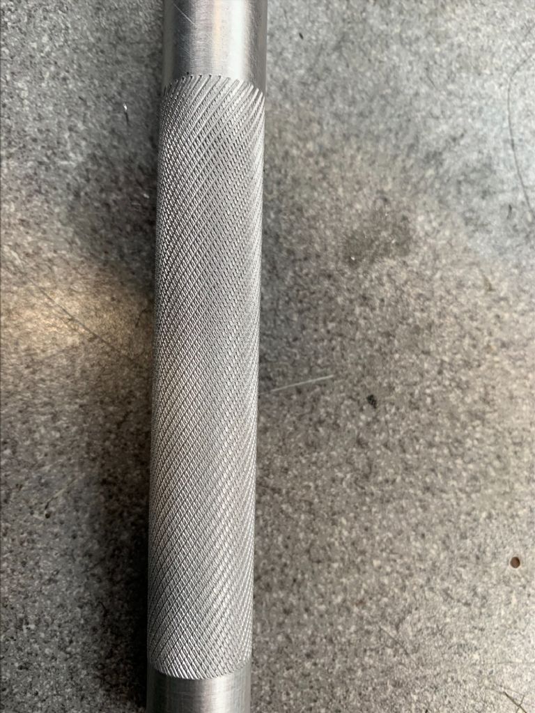

                                I thi k i have cracked it

                                    Posted by petro1head on 31/03/2023 10:18:02:
                                    Nearly but not quite there yet, showing a double cut, look at bottom illustration in Sonics post above.
                                    #639733
                                      You have – I'd be happy with that. Although not perfect diamonds, which the tool will do (practice!), it has the important merit of not being too sharp. Knurls exist to improve grip without abrading flesh, and many smart good-looking knurls are actually failures! Even though their owners are delighted with the appearance!

                                        Contrary to Sonic's text book I always start with the knurls off the work. That is after first touching the knurls on the diameter at 12 and 6 o'clock and applying a cut to the knurls with the adjuster incorporated in the knurling tool. The work should always have a chamfer to lead the knurls into the work.
                                        The faults in the above OP's knurling are more than likely due to sideways play in the knurling tool arms. There needs to be no lateral movement at all. The pivots should be a true diameter and not the crests of a threaded bolt like so many that I have seen. Poor fitting pivots contribute to the lateral movement.
                                        By starting on the work as shown by the OP, each wheel will adopt its preferred position. Which will be anything other than in line with one another. As I said recently on the same subject the knurls are no different to helical gears with the same forces acting upon them. This is why in the above shot by Petro1Head one knurl is predominate.
