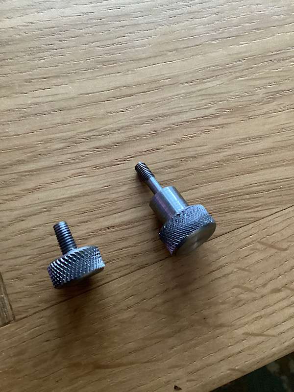

      made a couple of knurled knobs but when knurling them I couldn’t get a very nice knurl , I couldn’t get knurling very deep and it was better on both outer edges but the middle of the knurl was rubbish , I have a scissors type tool in the rear tool post on my Myford 10, the shorter one I am very happy with and was done some time ago from the front but the longer one I made today using same tool but from the rear, I thought maybe the knurles were the wrong way round so turned then over but I didn’t try moving bottom one up top and top on bottom could that be the problem?

        I’ve found with knurling that it takes quite a bit of pressure, a fair bit of spindle speed and lots of oil. The orientation/order of the knurling wheels shouldn’t matter I think as long as they’re a matched pair.

          looks like not enough pressure and also the pressure not applied quick enough so the knurls time themselves together. Your knurl has the knurls mistimed. I find that better knurls are to be had by being quite agressive with the pressure applied and a mid range spindle speed with oil. This is an aquired skill similar to parting off.

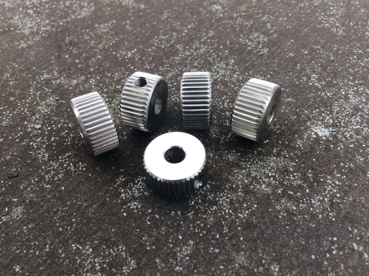

                I much prefer straight knurling as it always seems more comfortable to use. I do a job in 316 which is knurled and find that it turns out better if long blanks are made on the shaper first (much kinder on the tools)IMG_3532
                #719556
                Bill Phinn
                  @billphinn90025
                  They look very good indeed, Bernard.
                  I share your preference for straight knurling, though if you can’t get your fingers on the knob very easily because you’re coming at it from a strange angle a diamond knurl may be easier to use.
                  What is the tooth count and diameter of the knurls you used in this case?
                  #719579
                  bernard towers
                    @bernardtowers37738
                    They are 20mm dia and 40 tooth count with a depth of 0.45 mm, I also do a similar one at 16mm dia and that has 36 tooth count and a depth of 0.45 mm so they match up as they are close together. By the way not knurled but shaper cut.

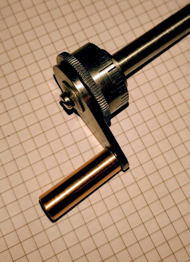

                            Low Level Clocking attachment
                            Since downsizing my Compact 5 has become my principle lathe. While I have made a single straight knurling wheel holder using a 1/2″ diameter wheel. Getting a good result takes a long time. I have now moved away from using the lathe and instead mill my straight knurls using the Emco Dividing attachment, (see above). This method may take a little longer, but the reward is consistent results.
                            Regards

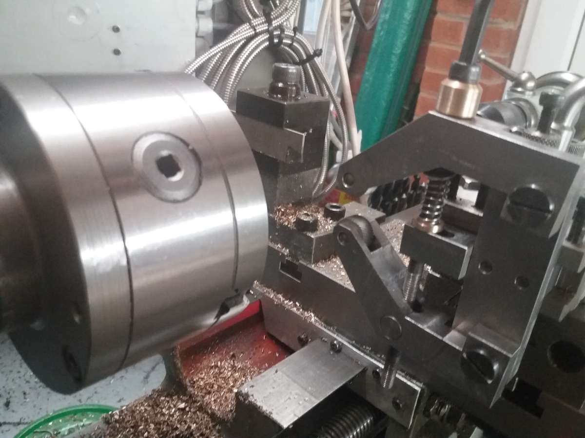

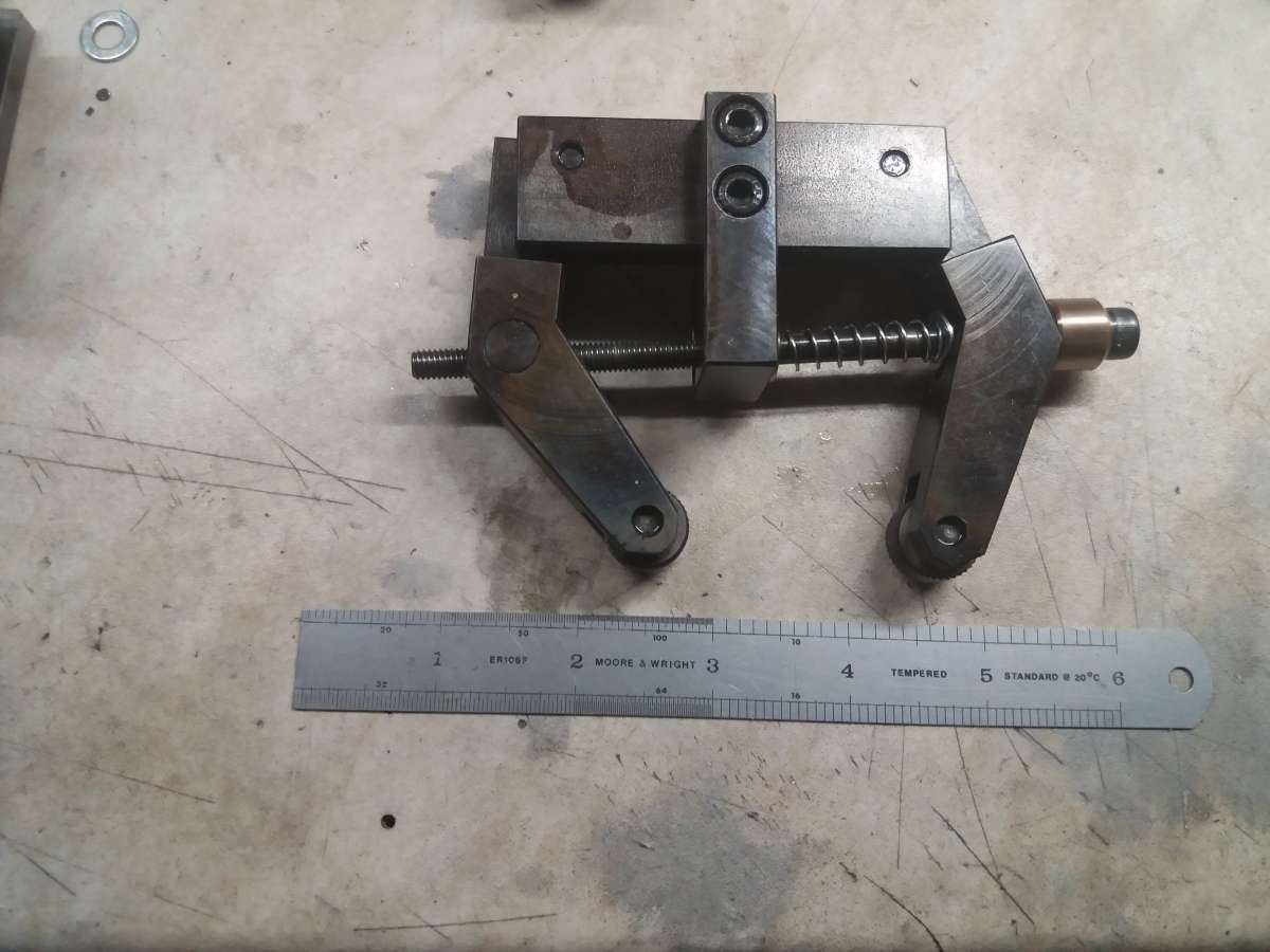

                                              This is my own design Knurling tool. It has offset wheel so so I can get nearer to the chuck and three sets of knurls Rough, medium  and fine. It is able to go from very small to about 2inch diamiter.
                                              20190801_174236
                                              20190731_104615
                                              The screw has been changed to a Knurled nut since photos taken.
                                              David
