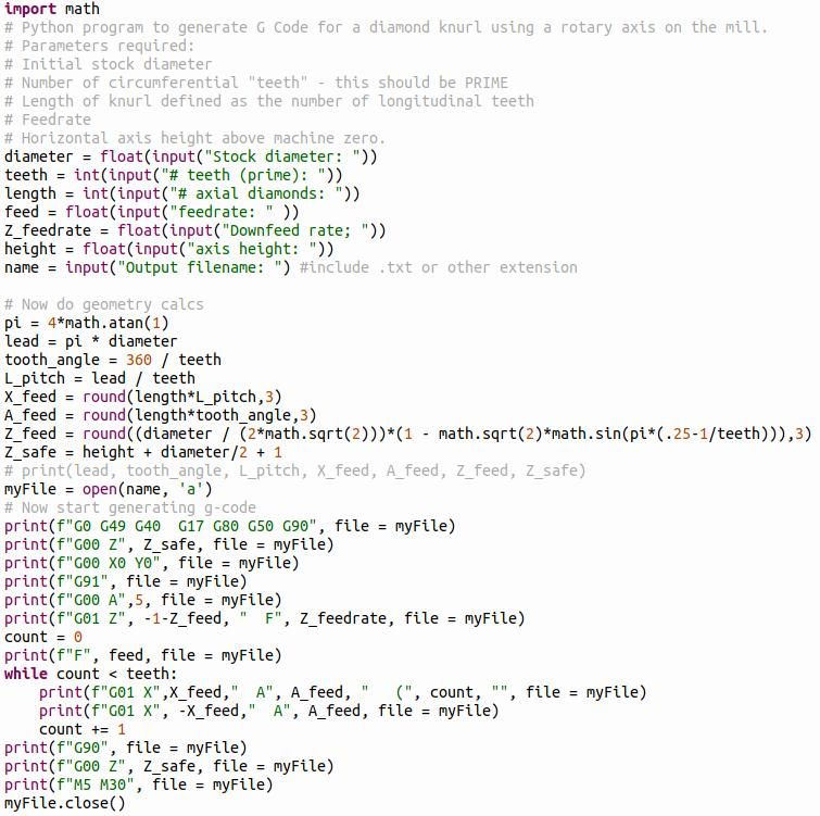

      Well, thanks to SoD and Dave S I have written a little Python wizard to generate g-code for knurling for any length. The first try for simplicity as shown above I just cut a full lead length, which for a diamond knurl is pi x diameter of stock. Even for 12.7mm this is nearly 40mm long which is much too long for practical purposes – larger diameter knurls would be very wasteful. I realised though that if one made a knurl with an integer number of diamonds in the axial direction you can cut each "tooth" with just a zig-zag motion where the work rotates for say N teeth axially while it moves N diamonds axially, then continues to rotate for another N teeth while it moves back N diamonds. What one would then like to do is just cut another zig-zag an carry on until one has gone right round the blank, without having to make a pure rotational move to index to the next tooth. With a bit of playing around for this to happen the number of teeth and number of diamonds have to be "relatively prime", that is have no common factor other than 1. Or, one can just make the number of teeth "M" prime, in which case any number of axial diamonds up to (M-1) can be cut just with repeated zig-zag moves. I think this is the easiest approach since there isn't a particular reason to have any specific number as long as the knurl looks and feels right.
      For my previous example M=37 is a nearby prime to 42 – I wanted something rather smaller than 42 to get a coarser pattern, 37 gives about a 1.08mm pitch. Here's the Python code.

      ******ing Smileys!  They should be closing brackets.
      Thonny is free and comes as the built-in tool on the R-Pi, but I also use it on my PC. When you run it it asks for various parameters of the cut as listed, and the name of the file you want to put the results in (which will be in the same folder as the code). To get a text file include .txt on the end of the name. Note that the machine should be referenced so that X=0 is at the start or the knurl and Y=0 is on the A-axis. Z=0 for the tool tip is the machine table.

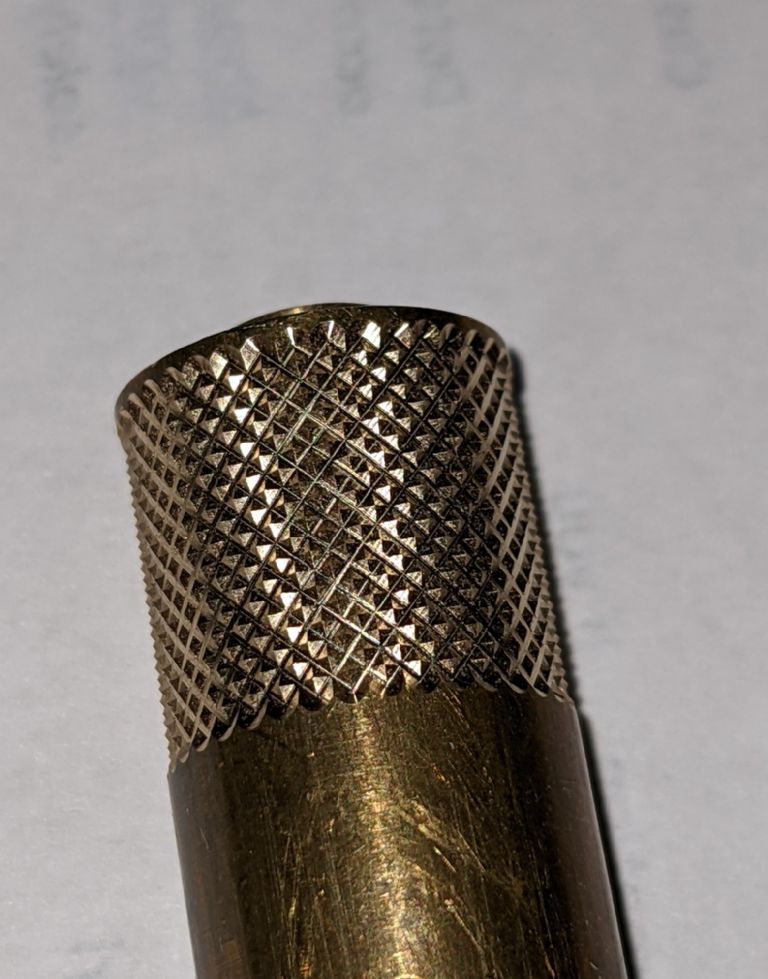

        #562472
        John Haine
          @johnhaine32865
          And the finished result.

            Looks good. Only real difference I can think of is knurling doesn’t “sink” below the original surface – which may or may not matter. At least with this you can guarantee a good knurl and not worry about it not tracking in.

              Posted by Dave S on 12/09/2021 16:55:44:
              Got to love the forum smilies in code
              Here's John's code in glorious technicolor, smiley's exterminated:
              Couple of small points.
              May not make any difference but I would use:
              myFile = open( name, 'w' )
              rather than:
              myFile = open(name,'a' )
              'a' opens the file 'name' in append mode, and if name already exists, the new G-Code will be tacked on the end, which probably isn't wanted. The 'w' open() always creates an empty new file so there's no danger of confusing the machine tool by feeding it two or more blobs of g-code in the same file.
              Second, again not making any practical difference, John uses format strings mildly inappropriately in his print statements.
              print(f"G91", file = myFile)
              This is unnecessary:
              print("G91", file=myFile)
              f"strings" useful for another purpose:
              print(f"G01 Z", -1-Z_feed, " F", Z_feedrate, file = myFile)
              can be written:
              print(f"G01 Z {-1-Z_feed} F {Z_feedrate}", file = myFile)
              The second form is particularly neat because formatting, not required in John's program, can be applied to whatever is between the curly brackets.
              PS I like Thonny too.

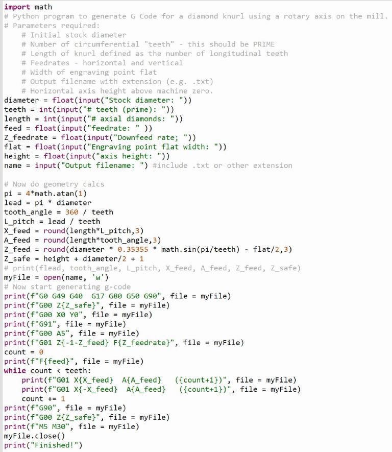

                  #562886
                  John Haine
                    @johnhaine32865
                    Latest version with above changes. Also asks for the width of any "flat" on the end of the cutter (reducing feed appropriaetly, and corrects the formula for the depth as I initially misunderstood the geometry.
                    Posted pic to avoid the smileys, but happy to provide file on request, or download from **LINK**
