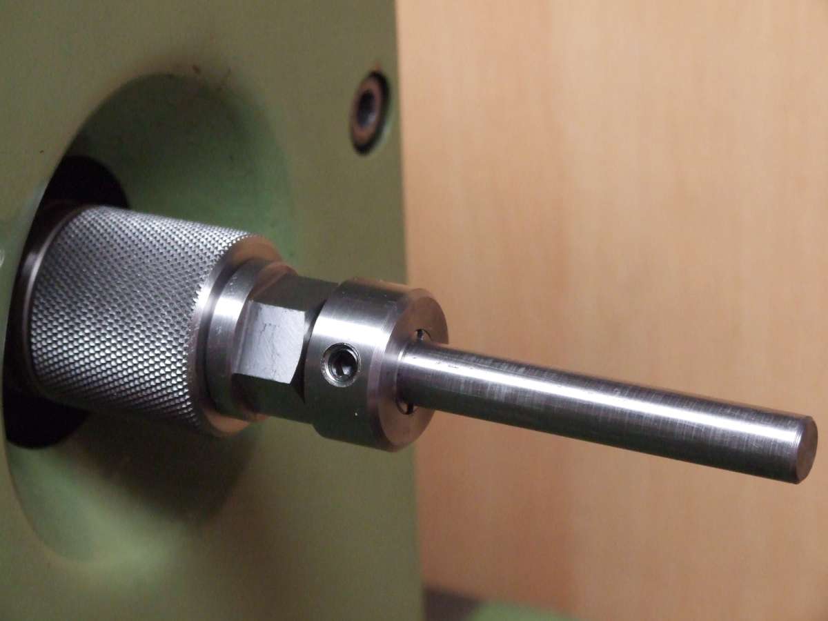

        Fig 4 Backstop in position
        Once this point is mastered Knurling is no longer a nightmare, just another machining operation, (see above).

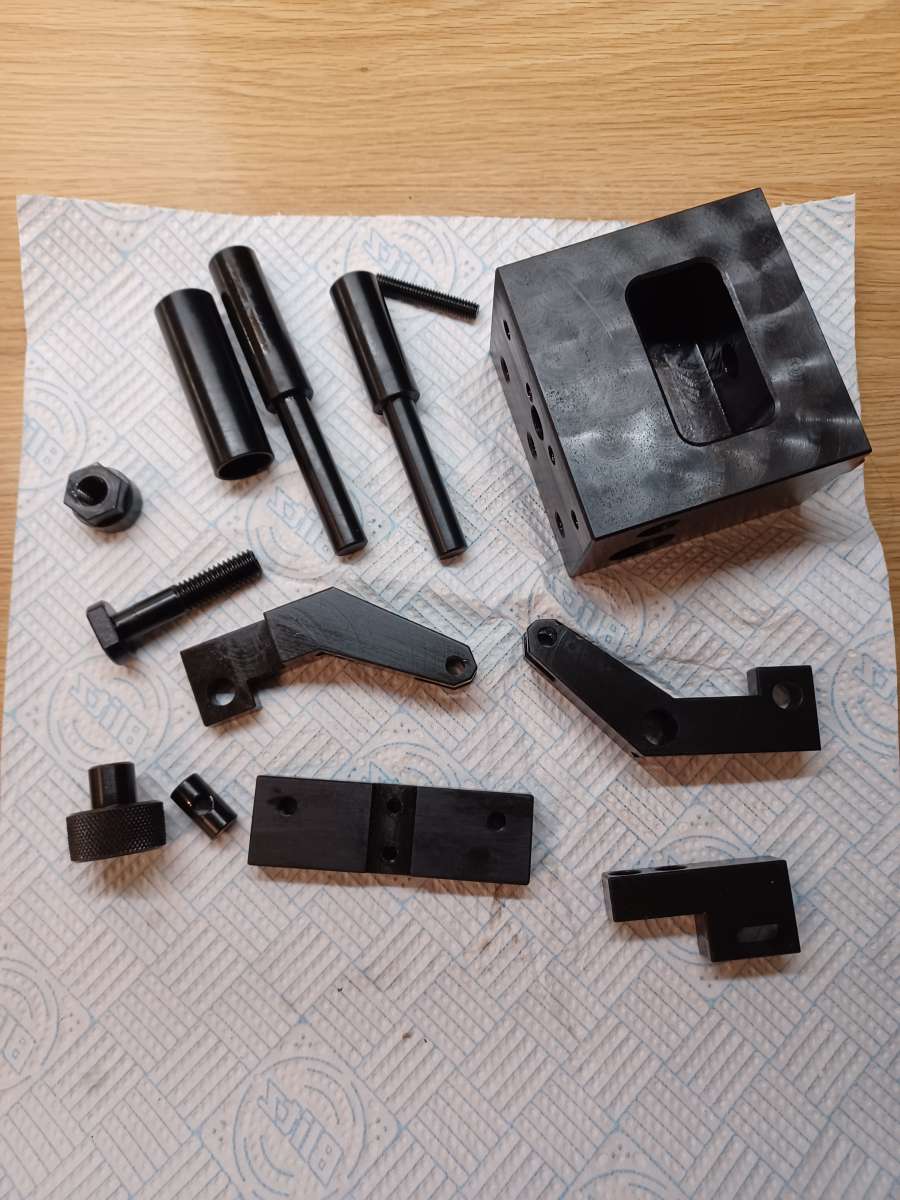

                  The blacking om my knurling tool was done by heating and oil bath diping and repat till it was black. Recently I have had it chemical blackodised at a company in Long Eaton not far from me. With a few other parts

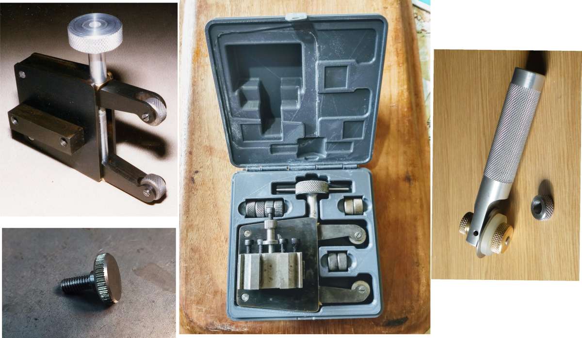

                        I’m with Fulmen and Howard on this one – for form knurls at least (cut-knurling is different). If the initial pressure is sufficiently aggressive then the knurling wheels will slip into correct synchronisation after the first revolution of the workpiece. A convenient way of starting with a high pressure is to commence with the knurl wheel(s) halfway on the end of the workpiece and moving sideways when the pattern has been established. If you start to get it cross-knurled then simply increase the pressure.
                        I use my home-made and designed scissor knurl shown in the photo, together with a nice 3D-printed box for it that also holds some different wheels. All the knurling shown was done with the tool – in steel, brass, and aluminium.
                        Knurl box

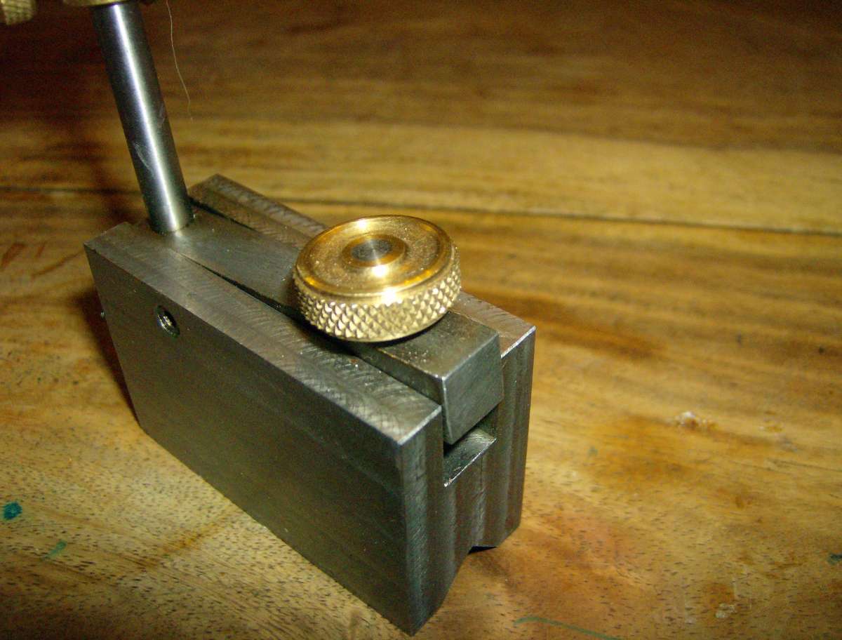

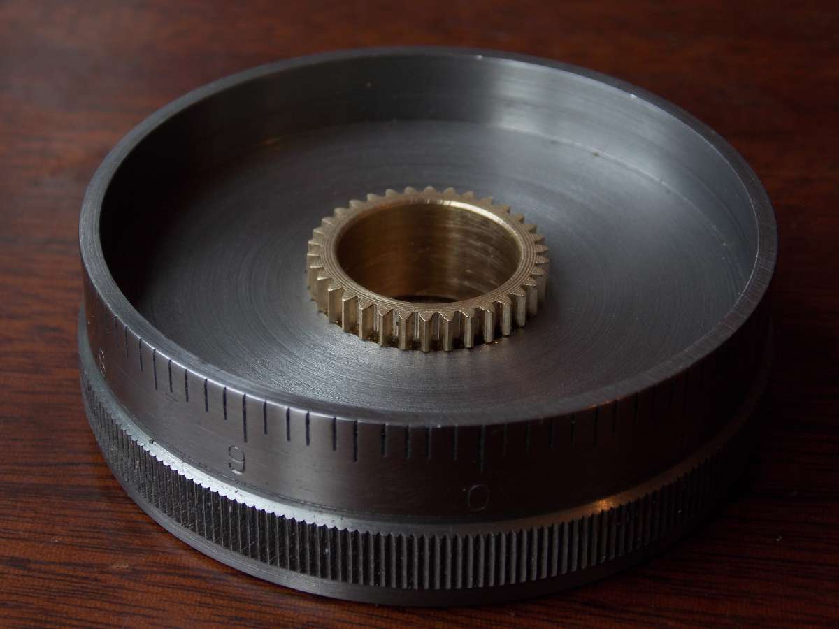

                                Handwheel Dial to Graham Meek Design (5)
                                Close up of tilting screw
